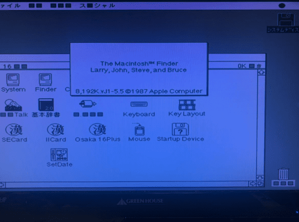

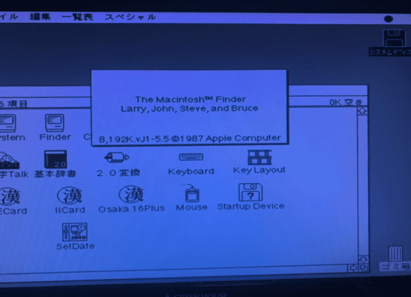

We did this on X(Twitter), not here, but the method for using this card was quite simple. The reason is that this small capacity ROM card is a ROM card that is used only to store font data even if you do not install Japanese fonts. So, in order to save a little space, if you do not install kanji fonts and use another environment for kanji talk, the characters will be displayed without garbled text.
Kanji Talk 2.0 was released in 1987 along with Macintosh II and Macintosh SE. Based on System 4.1. Two fonts have been added: Kyoto (Mincho style) and Osaka (Gothic style). It also incorporated the concept of FEP and provided "2.0 conversion" in the INIT file.
As usual, you will have to reinsert the disk several times during the installation, but when the message "フォントディスクを挿入してください(Please insert the font disk)'' appears, press "キャンセル' to cancel.
If you do that, the kanji font will not be installed on your system, so you can read the font from the card.
Therefore, in Kanji Talk 2.0, where no card is installed, there is no font, so the characters are garbled.
With Kanji Font ROM card
All that is left is that it doesn't qualify as a historical heritage, and I don't think many people are interested in it:LOL:
