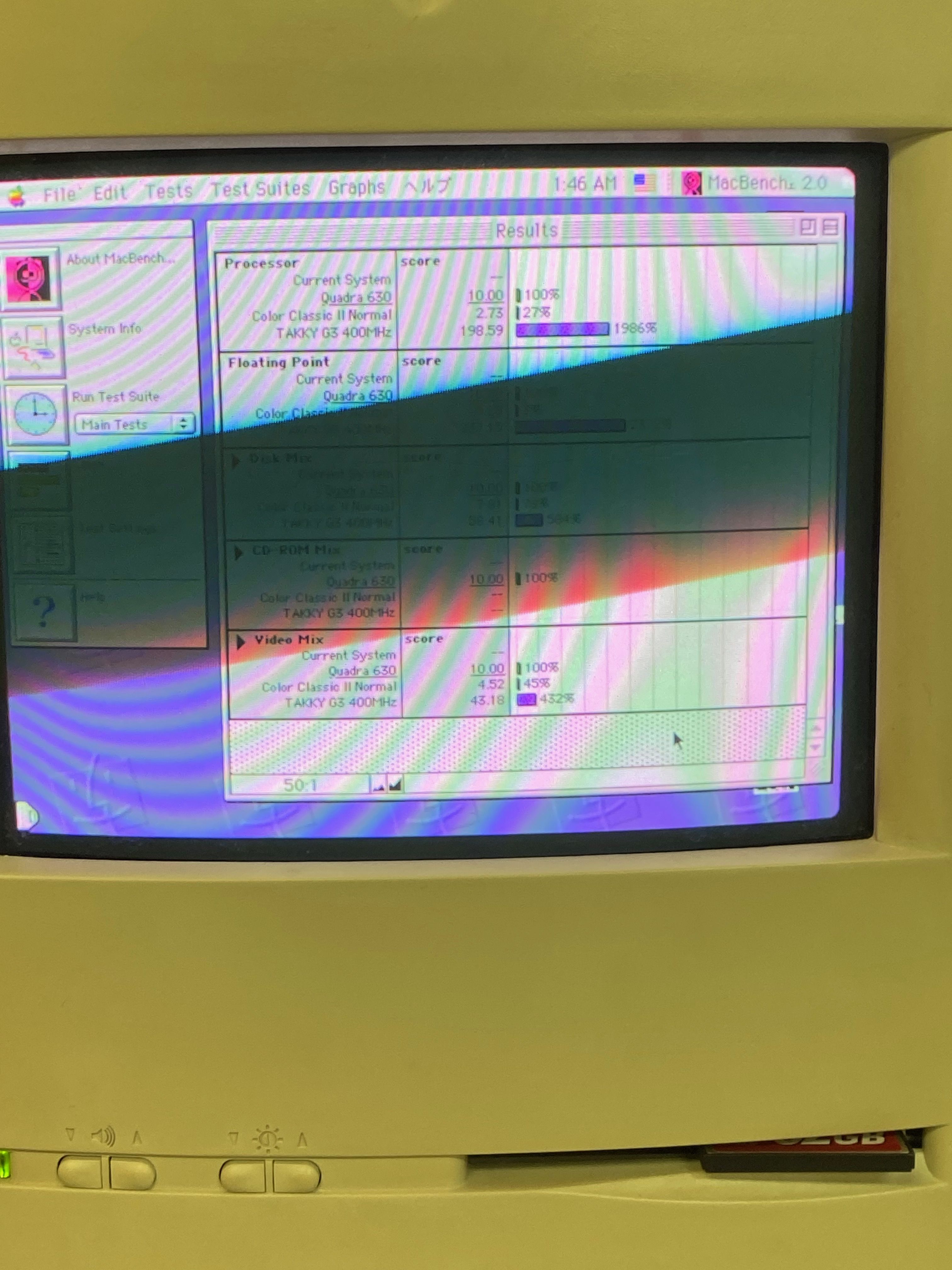

I have two Mystics, which is the Mystic (No.1) that I modified a while ago.
Tested for "Spicy O'Clock!", the original post is here
Spicy O'Clock! is adjustable oscillator used silicone oscillator chip. I think it's the first time it's used on a 68K Mac.
It has a variable range from 35MHz to 51MHz.
For the time being, it is important to create all the data, so I have not tried overclocking above 42MHz...
However, the LC475 is known to work at 42.6MHz. course, serial will not work, so practically it needs to be a clock that is 42MHz or a little slower.
*This may depend on ROM.

Hahaha, this is my takky(No.2). Do you think this is slow :LOL:
I love the fast things, but 68K is a wasted dream, I love them. I enjoy 68K more than PPC now😊

What’s with the CF card in the front? How are you doing that?
This Takky No.2 had IDE socket cause it's Gazelle 275MHz logic board. Gazelle and Alchemy has IDE and SCSI both connecters.
CF cards r compatible with IDE(ATA) w/out a controller chip. U can buy CF card adapter from anywhere, Amazon, ebay...
