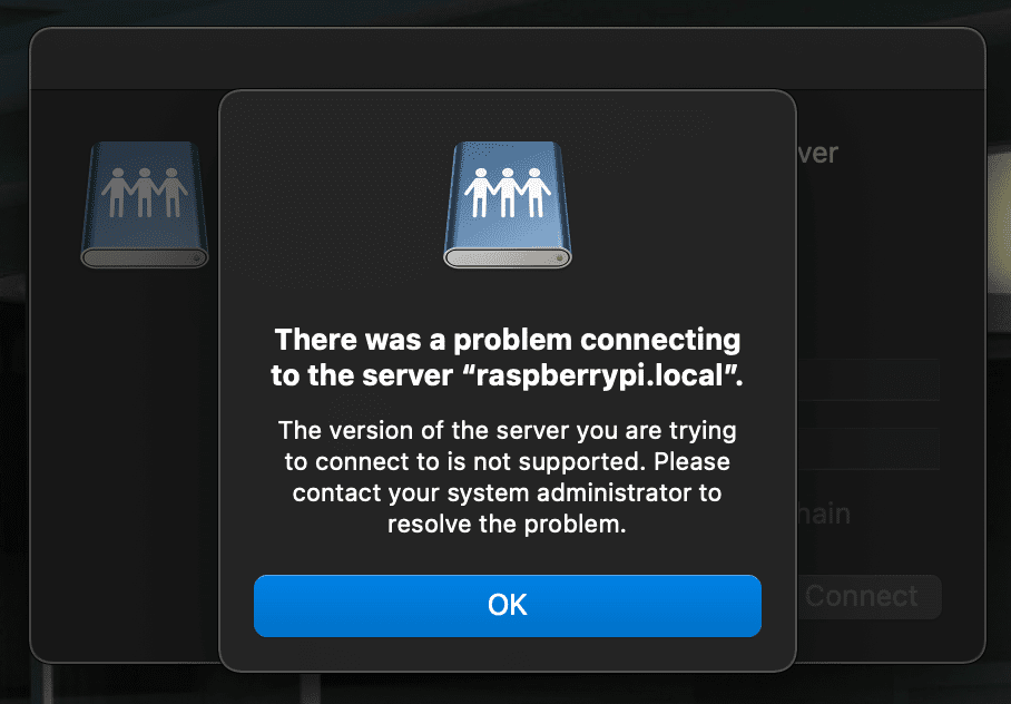

I'm using Big Sur and I get this:
(I'm using Netatalk 2.2, with the setup via the RASCSI easyintall.sh. It works fine from my Classic Macs)
I'm running Netatalk 2.2.6 with NetBSD's pkgsrc patches (and a patch or two of my own) on Mojave with System 7.6.1 and Mojave/Big Sur clients, so it's possible to get working depending on the setup. I'm guessing that error is because you're using an unsupported (by Big Sur) UAM. What are your active lines in afpd.conf? What does ps -ef | grep afpd show? What is the output of asip-status.pl x.x.x.x (where x.x.x.x is you server's IP)?
I’ll check this when back at home and give you the details.
In the meantime maybe @rdmark can see this, as he prepared the install script for the RASCSI project.
Hi,
it took me a while...
content of afpd.conf:
"RPi Server" -transall -uamlist uams_guest.so,uams_clrtxt.so,uams_dhx.so -defaultvol /etc/netatalk/AppleVolumes.default -systemvol /etc/netatalk/AppleVolumes.system -nosavepassword -nouservol -guestname "nobody" -setuplog "default log_maxdebug /var/log/afpd.log"
running process:
root 733 1 0 2021 ? 00:00:45 /usr/local/sbin/afpd -U uams_dhx2.so -g nobody -c 50 -n raspberrypi
EDIT: I never tried before to connect as "guest". With Guest I can connect, but only in read-only mode, so not useful.
