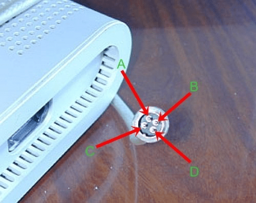

I don’t recall seeing a write up, but you basically just need to figure a way to mount the new PSU inside the shell and wire the connector as follows:
A = +28V
B = +28V
C = Common (or - side of supply)
D = Common (or - side of supply)
the outer shell of the connector is ground
A = +28V
B = +28V
Ok, that seems doable. Thanks for the information.
A = +28V
B = +28V
Yeah, I ended up following the guide that picture is from: https://www.edretrotech.com/2021/02/power-mac-g4-cube-power-supply.html
Works well, but not an original look because the PSU is too long to fit inside with the 3d printed extender. My fit wasn't perfect, so I have some white electrical tap holding things together.
