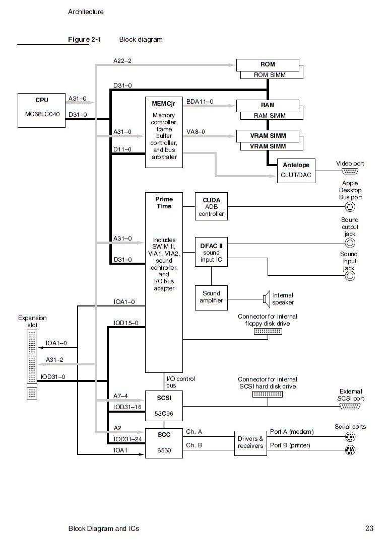

Developer Notes for Macs have Block Diagrams to compare components/architectures. Q605 was handy:
1,160
343
Yep, they're wildly different under the hood, entirely different architectures. I'll see if I can drop an LCIII Block Diagram in for comparison to the Q605/LC475.
