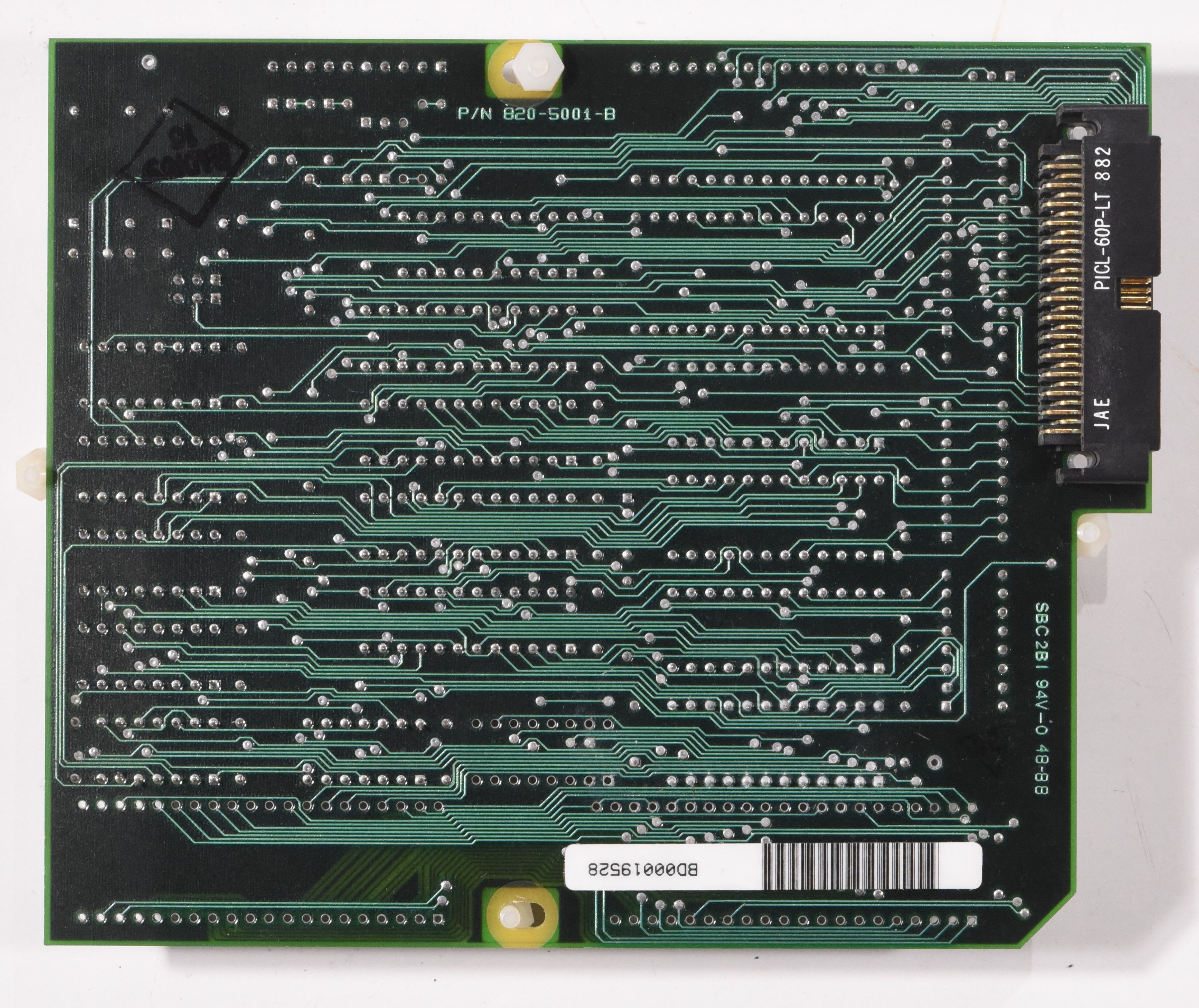

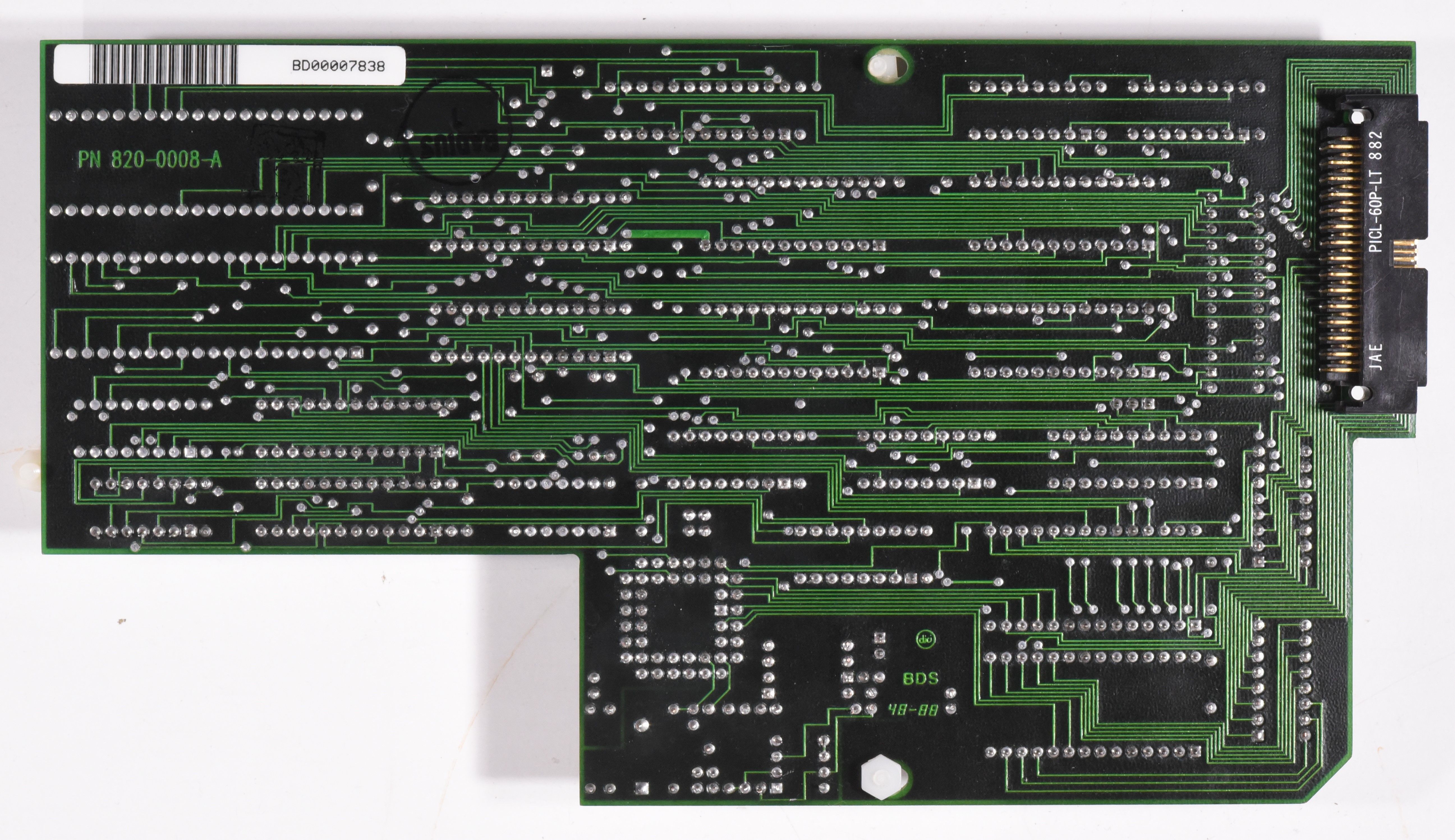

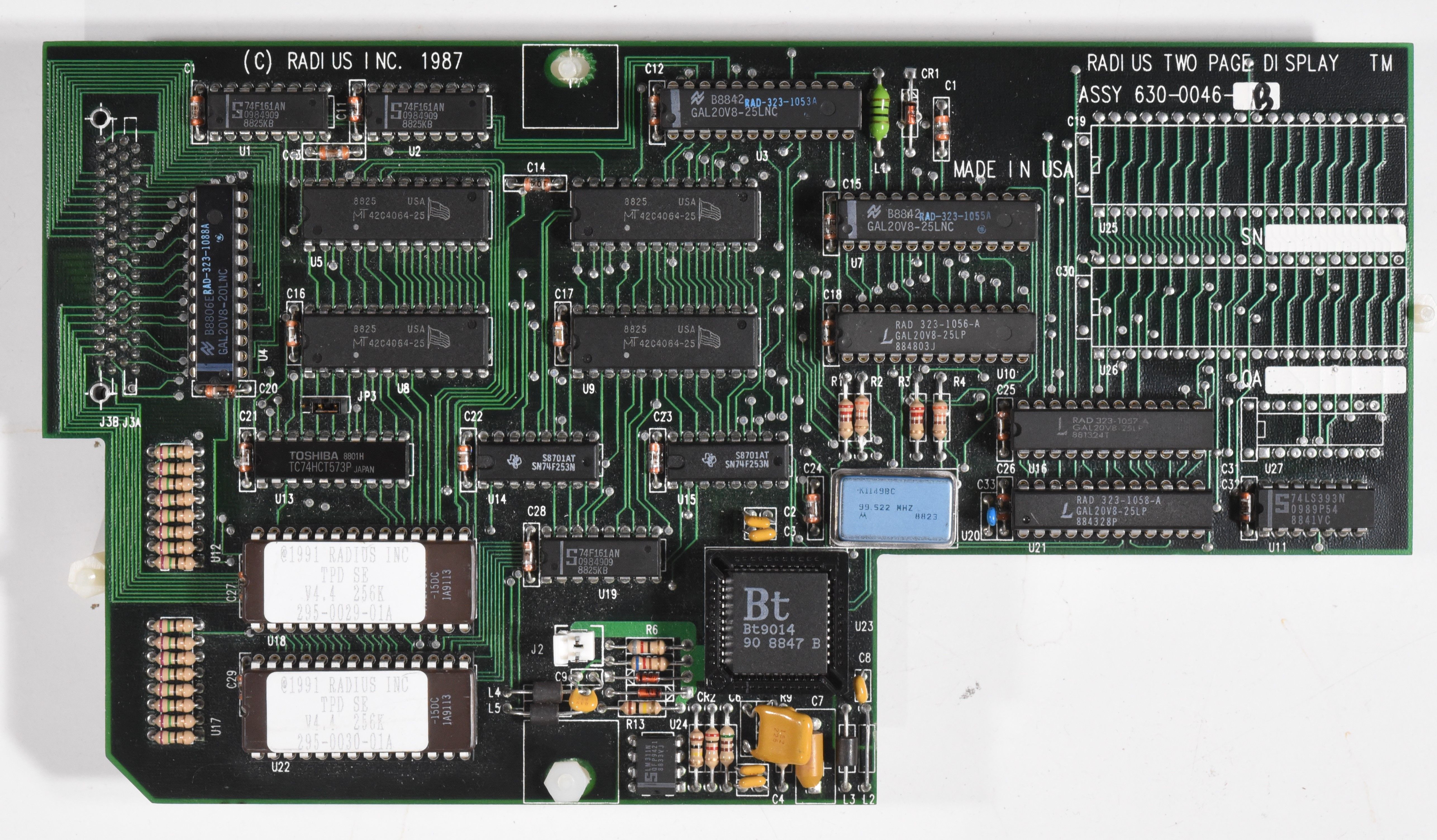

Finally got the copy stand set up and the D750/Macro Lens fired up!
Cards are set up on Nylon Standoffs so traces on Solder and Component sides are on the same plane at same distance from sensor. The pics wind up in AI8 at same size, if scaled down to 25% due to lack of sufficient memory on the my son's first computer, a TiBook he gifted me.
Gotta get one of the G4s back up and running a/o max out the memory on the TiBook. OS9 forever and RentWare never!
Hoping to isolate the multitude of digital signals that are mashed together mercilessly in this mess for Mini Co-Axial output. Crossing fingers, vainly hoping that the nasty Bt9014 programmable Logic IC can be eliminated. No such critter necessary on the FPD/SE above with this pinout?

So three VidCards on the benches in decreasing order of difficulty:
- TPD/SE - horrid Bt9014 44pin Programmable Logic
- FPD/Mac Plus - Middlin' nasty PLDC20G10 24pin Programmable Logic
- FPD/SE - every IC is either a readable GAL or standard 74LS Logic IC 😁
Let the games begin! 🤪
