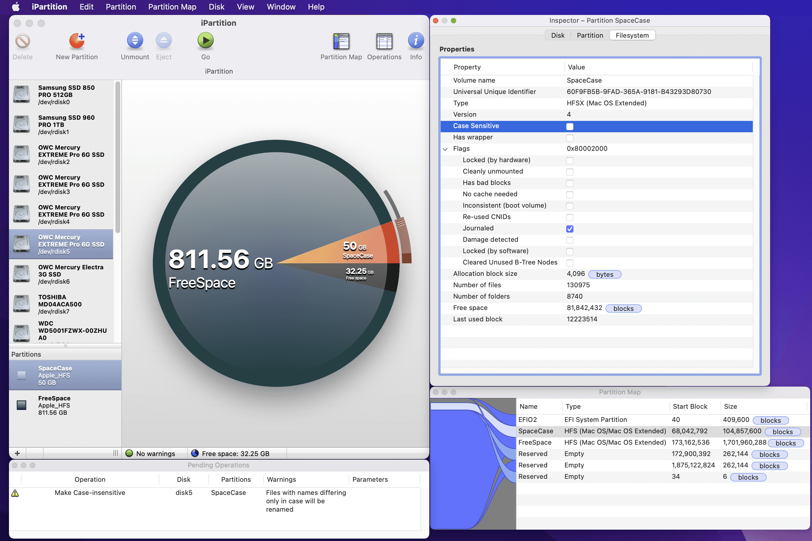

I haven't tried iPartition.app's case-sensitive conversion function before. Do a backup before attempting.

Yeah, I ended up finding iPartition independently, and it worked fine.
