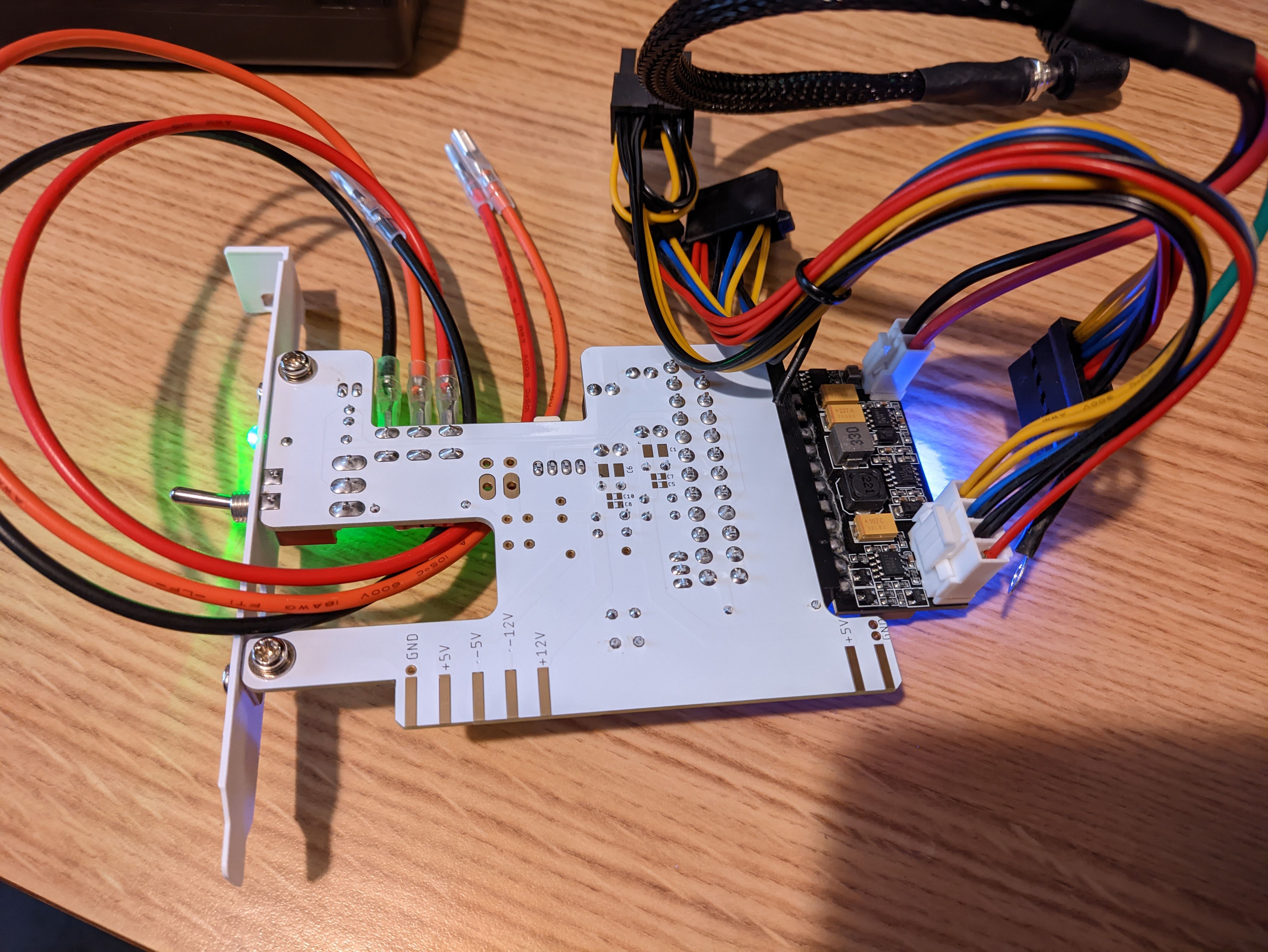

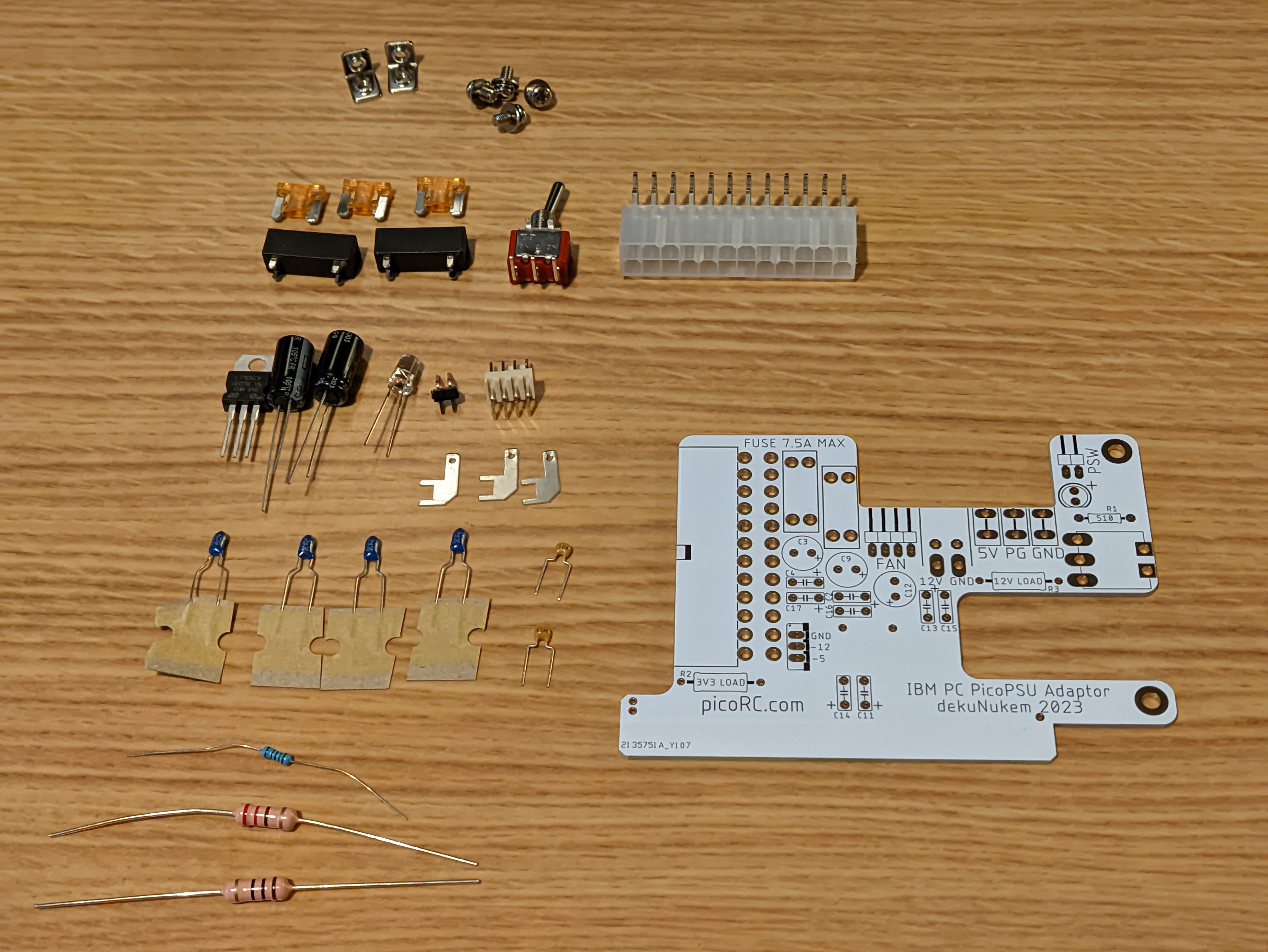

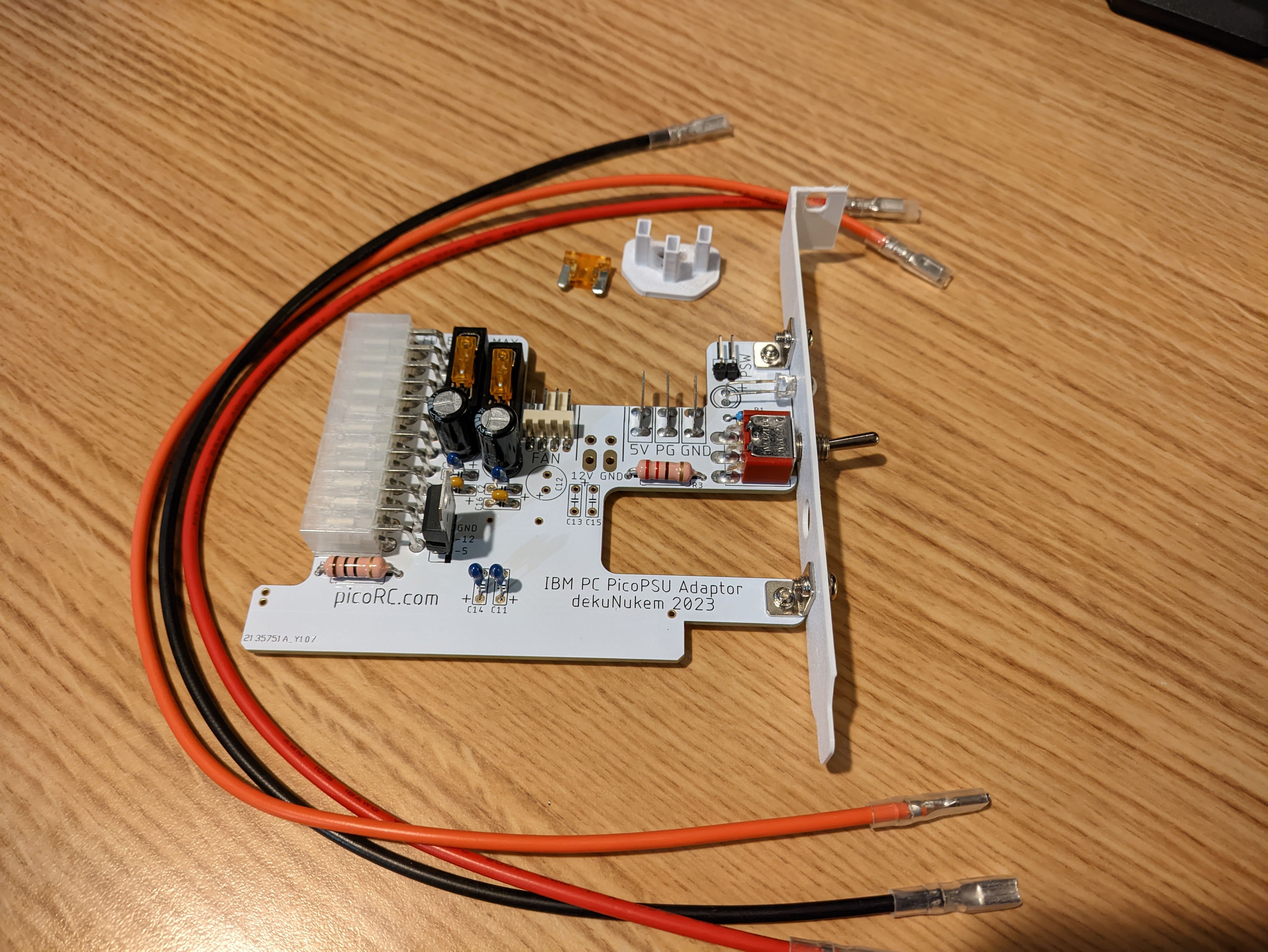

Next up is power. I don't have AT power supplies to spare right now, nor do I want that volume of wasted space so I went with the dekuNukem IBM PC PicoPSU Adapter in kit form. Don't recall where the PicoPSU and power brick came from, probably Amazon?

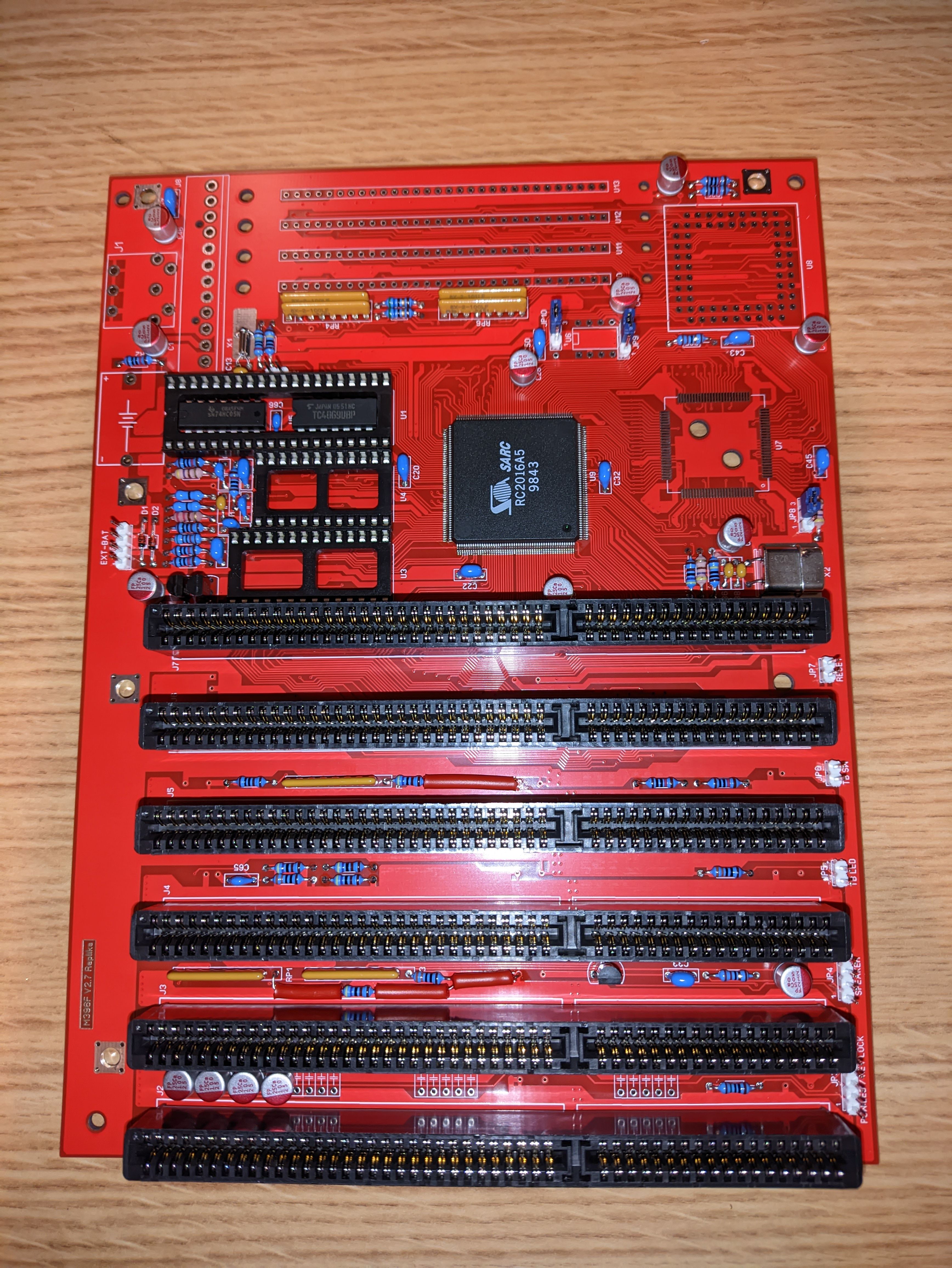

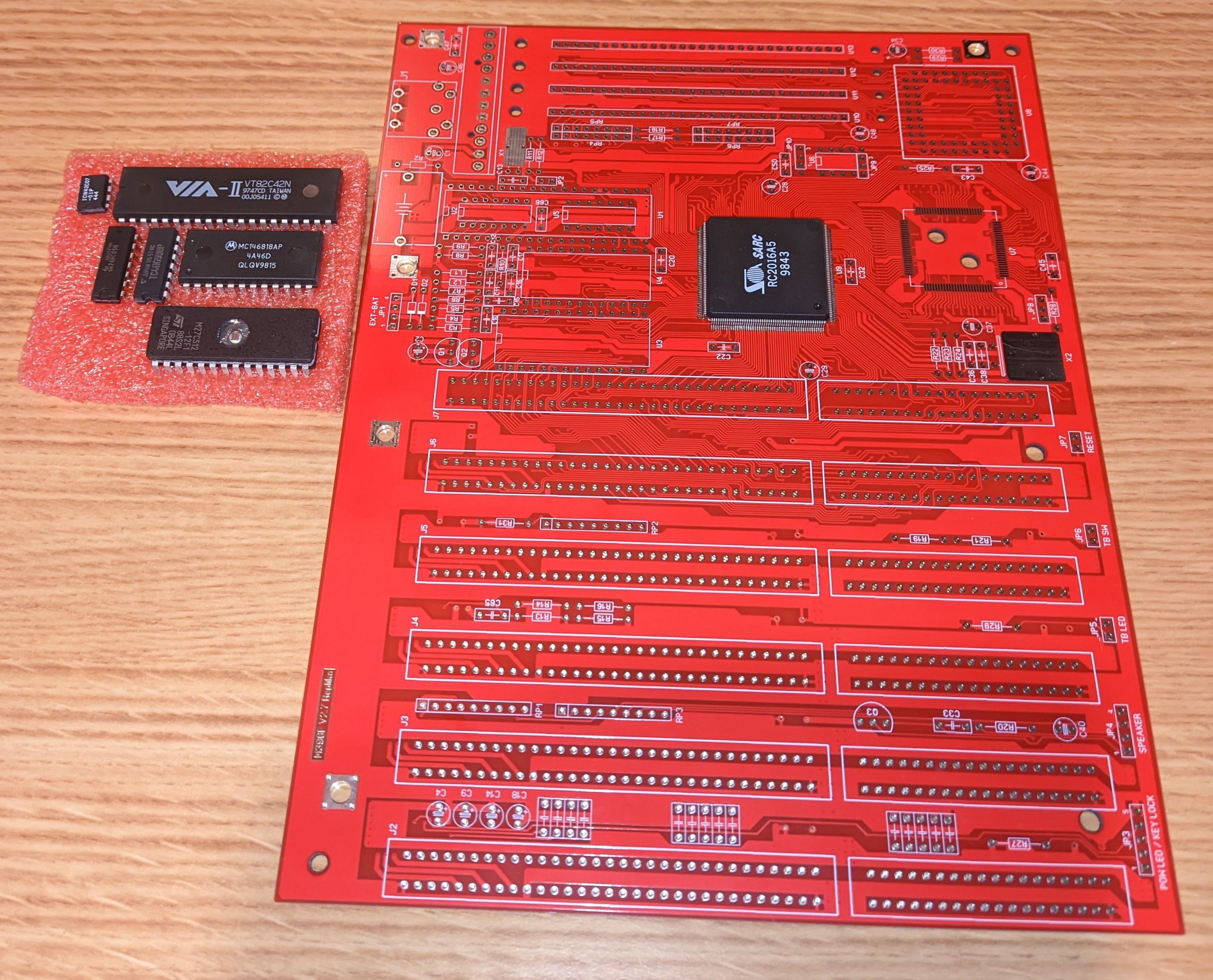

Right. So lets kick things off with the board and chipset(sans-CPU) as shipped to me, and a Digikey order, shall we? Assembly was fairly straight-forward with only minor hiccups induced by me.

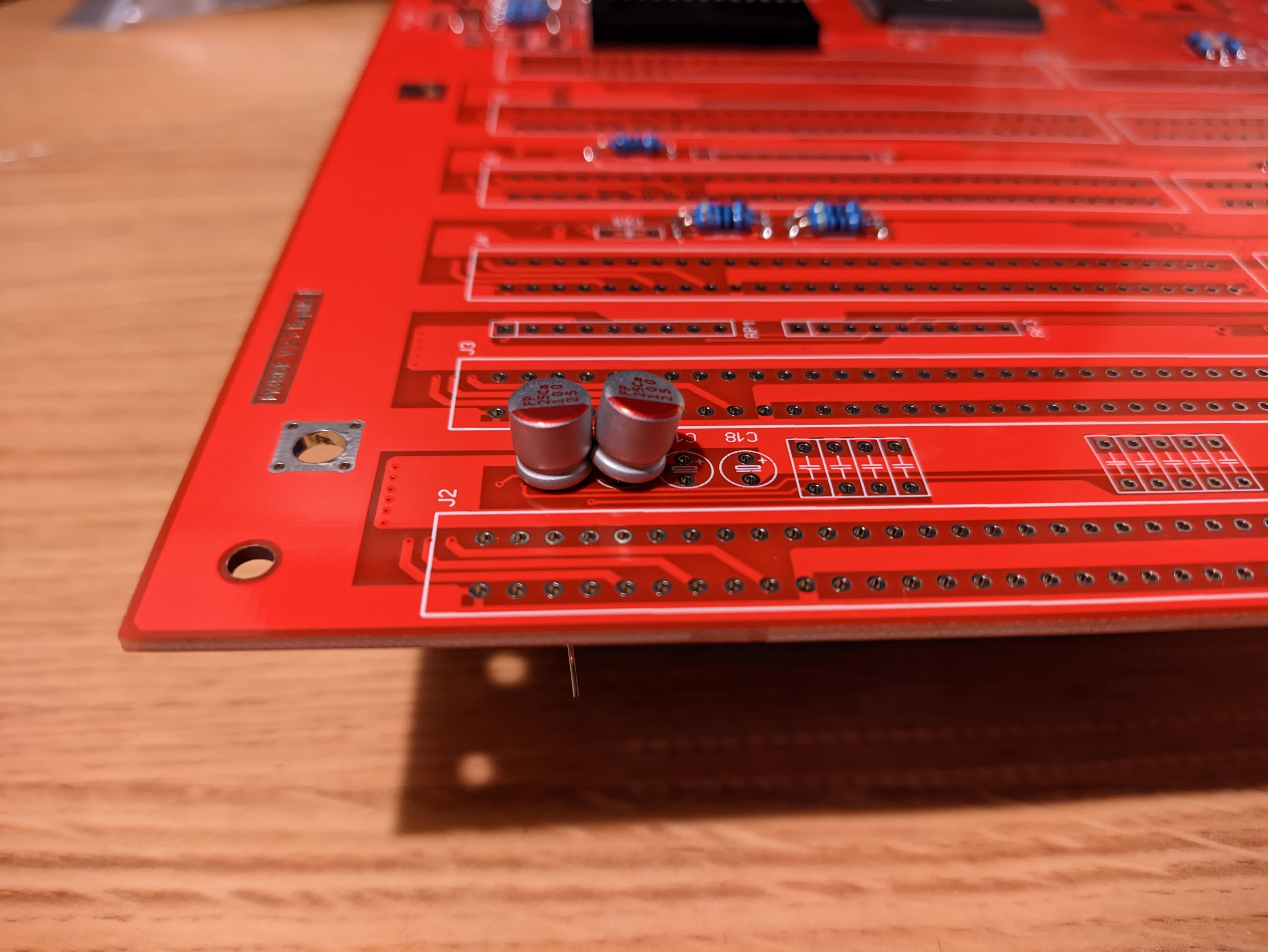

The capacitors I had ordered were wider than the original design specified... So I fondled their legs a bit to fit so closely together. Having a BOM is great, but you really need to examine the board for clearances when ordering components.

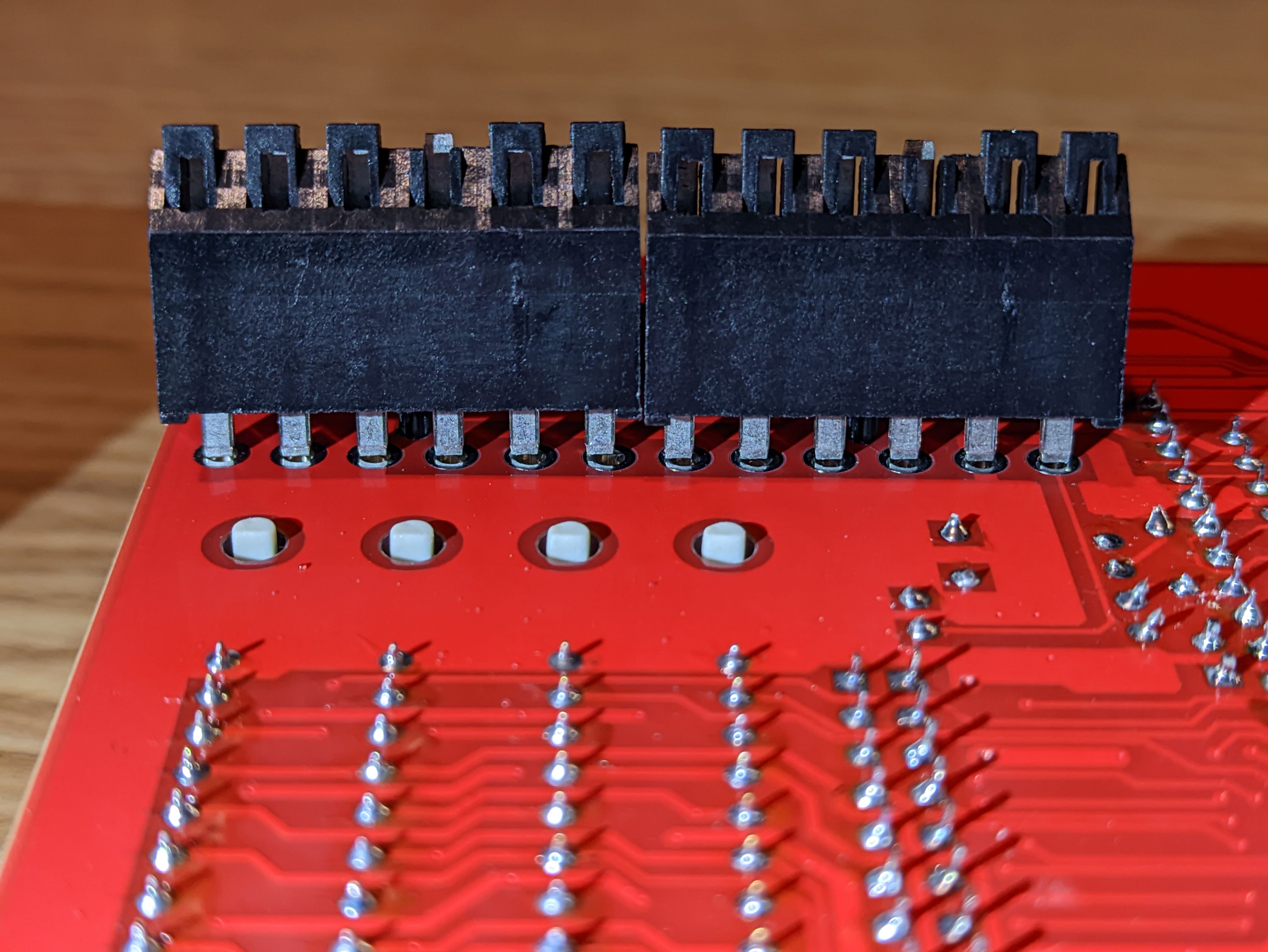

The resistor packs located between the ISA slots are one pin wider than the ones beside the RAM slots, naturally I managed to bungle that due to rushing during part selection and having searched for the shorter ones first. The fix was bodge-resistors and some tiny dual-wall heatshrink tubing for class. Good thing I had ordered extras of almost every component, the extra resistors came in handy.

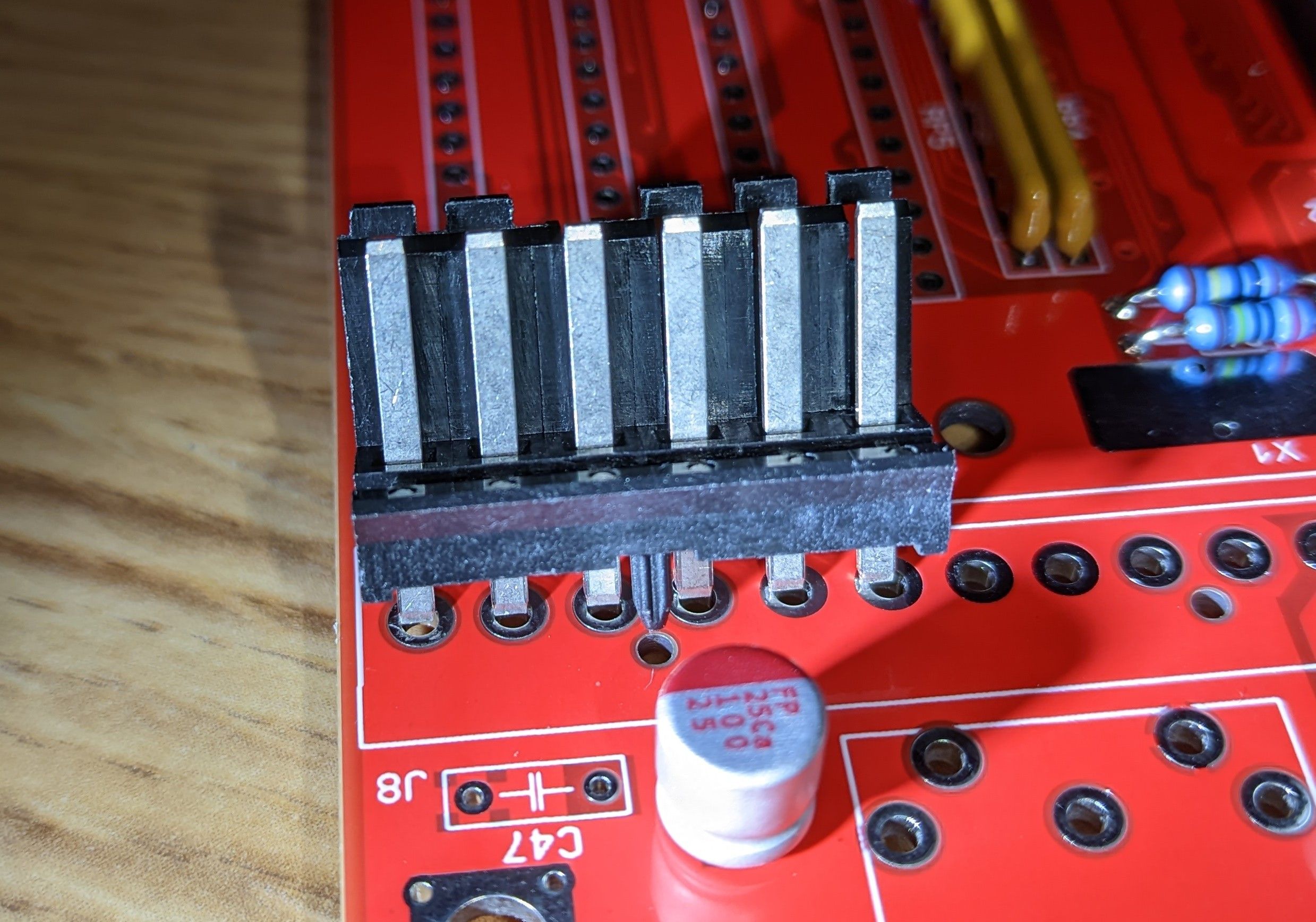

The AT power headers I'd ordered didn't match the board's design either, not just rectangular peg in round hole, but also slightly incorrect spacing. Some time with a file fixed those up.

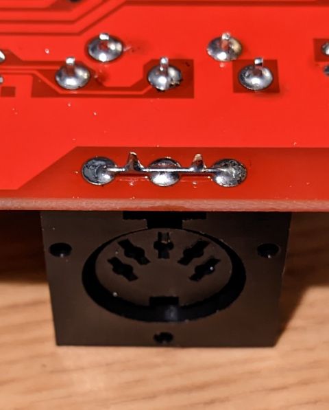

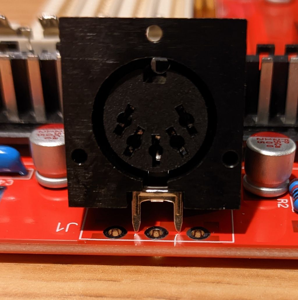

And finally on the list of faceplaming was the DIN connector for the keyboard. Board layout had three holes for the shield, my connector had two. Oops! Two newly drilled holes, one bridge wire, and some solder later the issue was resolved.

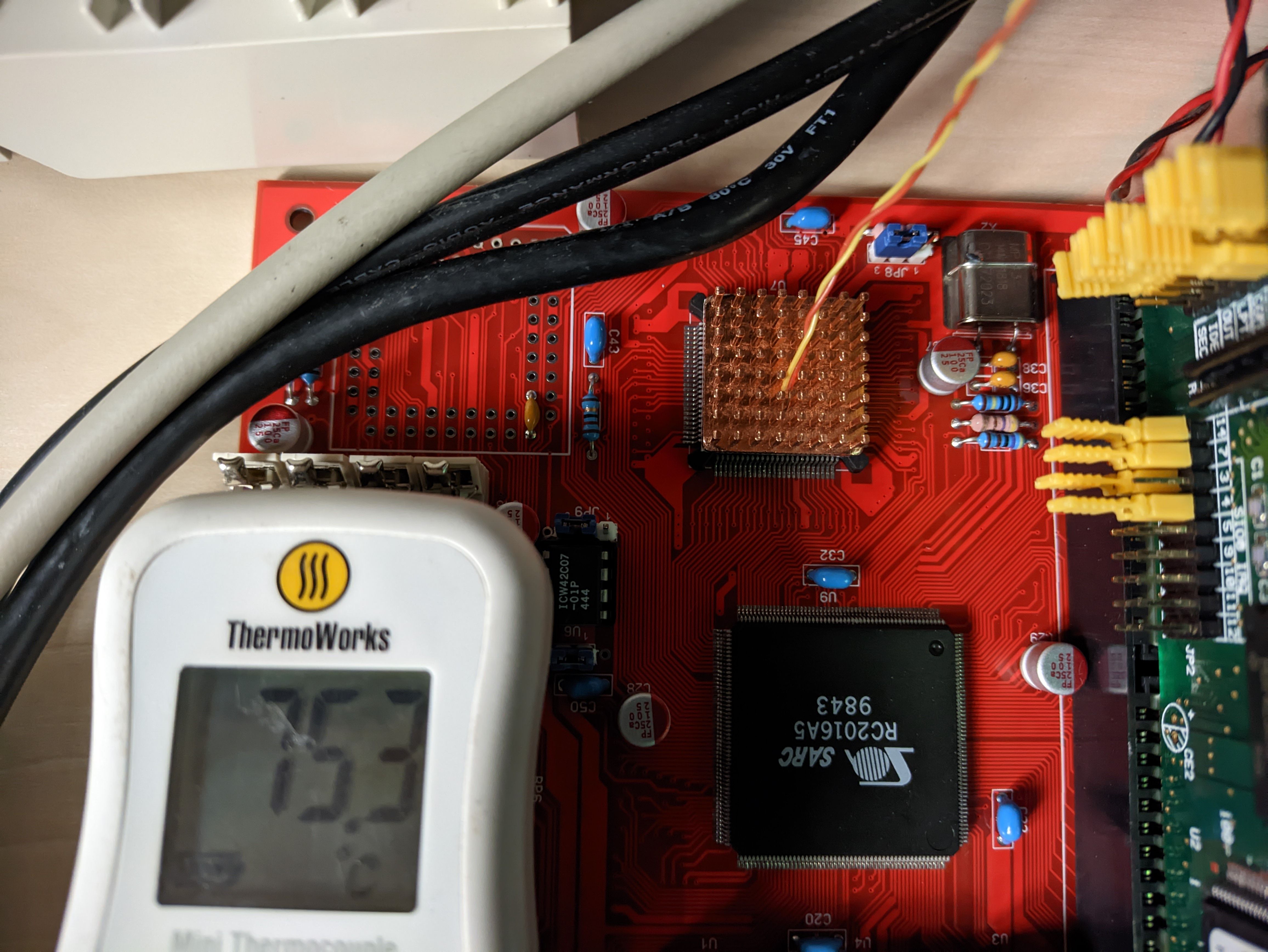

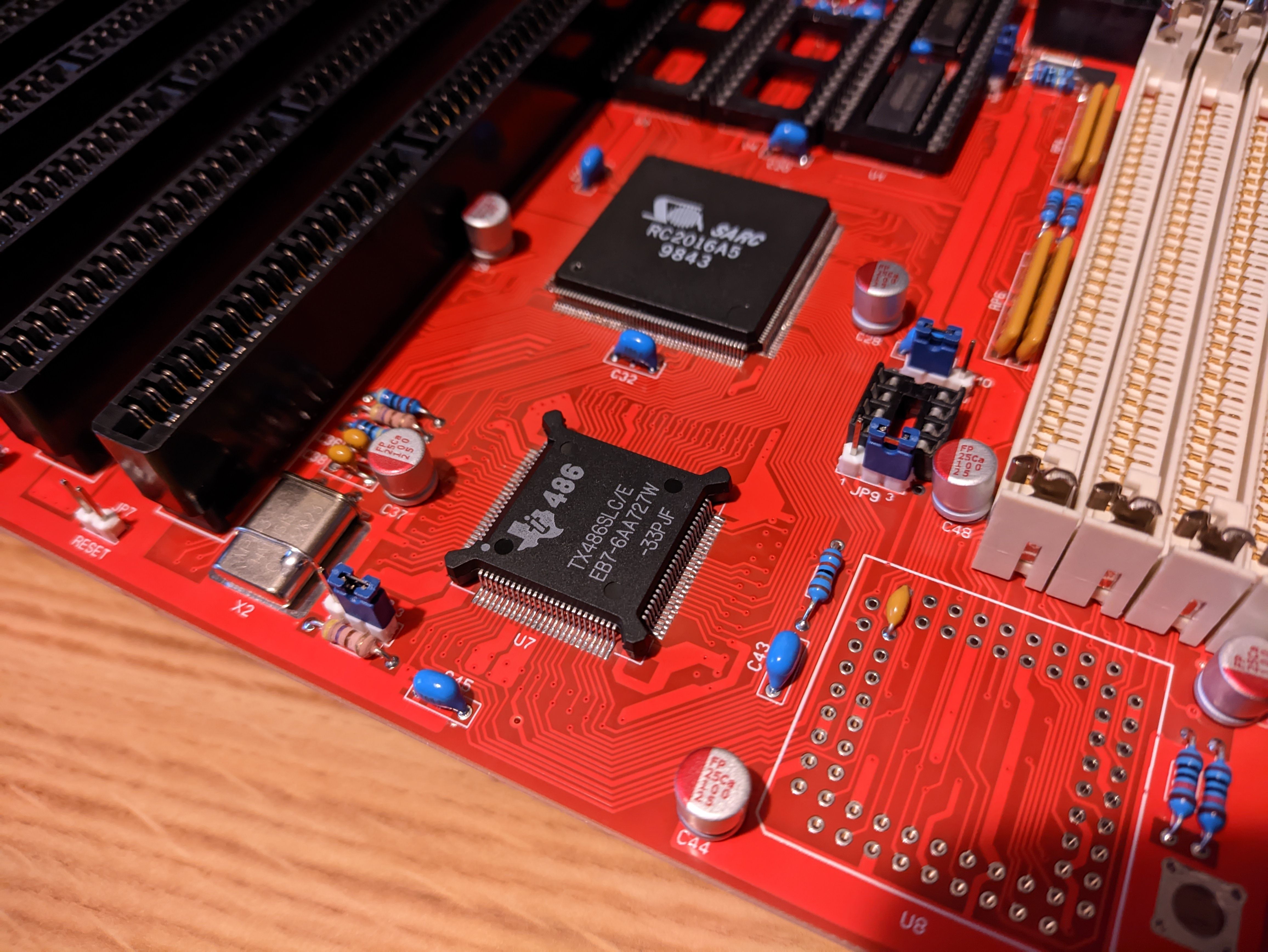

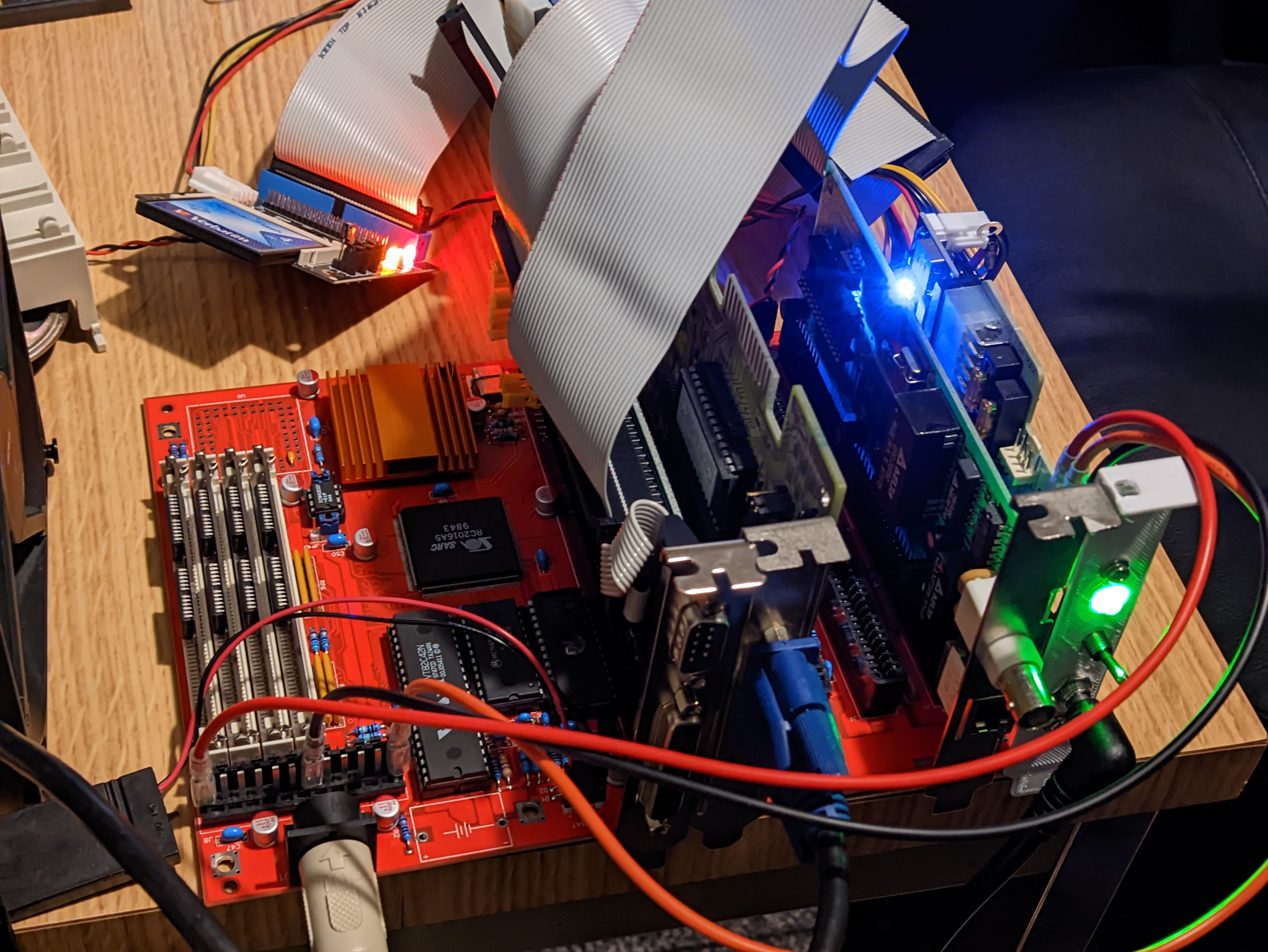

At that point I tacked down some important-looking CPU pins, pushed down really hard, and applied power. Thankfully there was activity displayed on a POST card, so at this point I was reasonably sure the CPU was actually some sort of CPU and finished soldering it. In use this CPU gets wickedly hot. For initial testing/playing I was using a random old heatsink just stuck in place with thermal compound, but later sourced a different style with (hopefully)thermal tape. The CPU still gets pretty hot in stagnant air, but the heatsink helps a lot with any airflow at all.

Running the thing

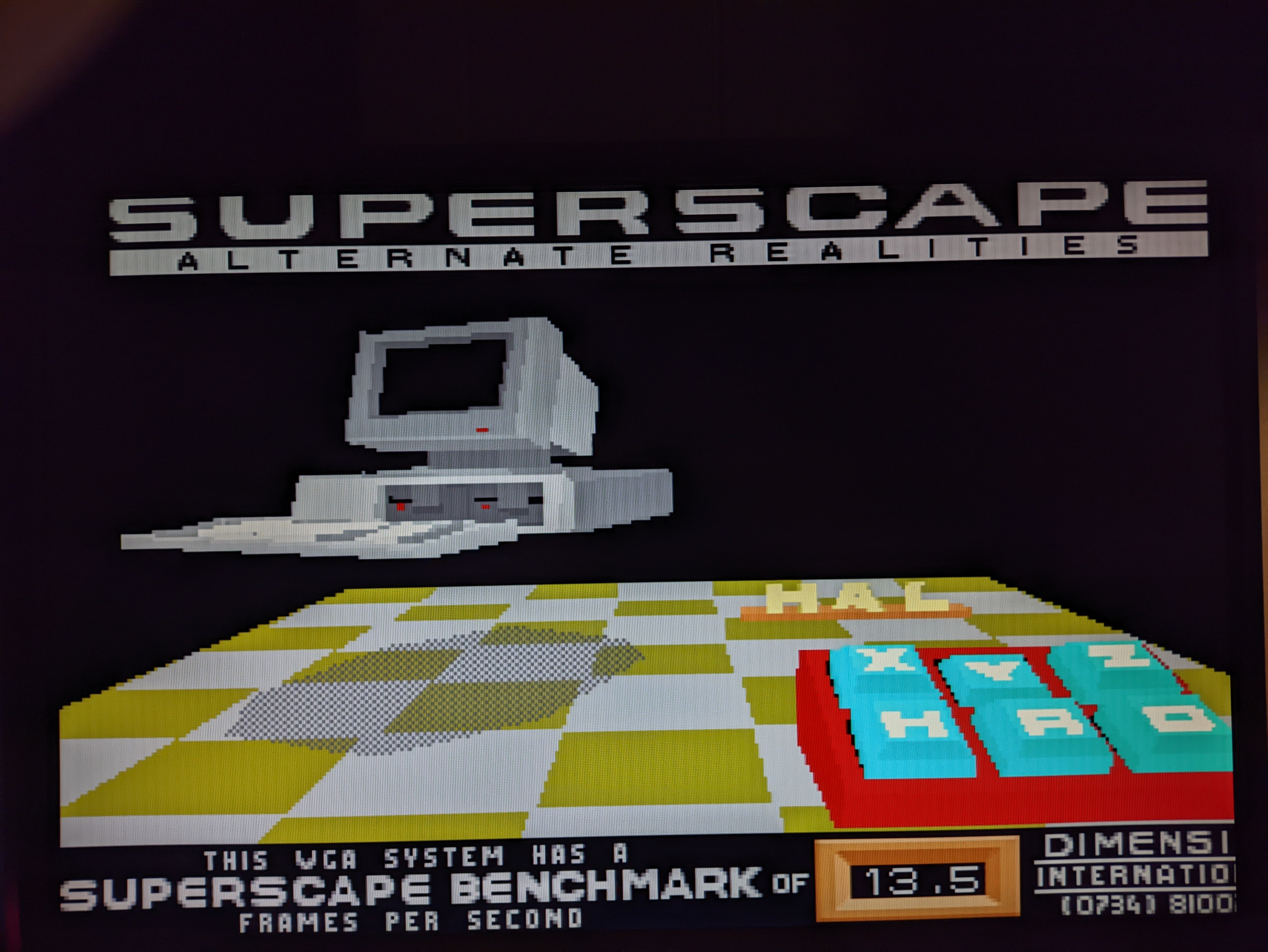

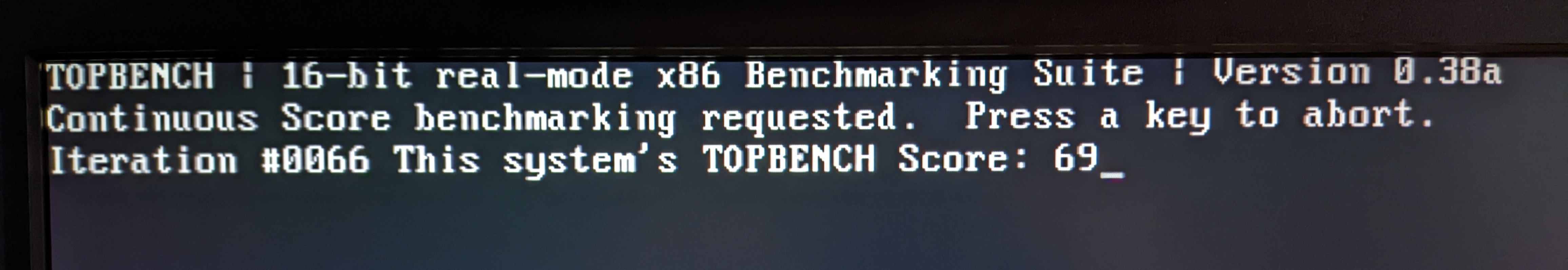

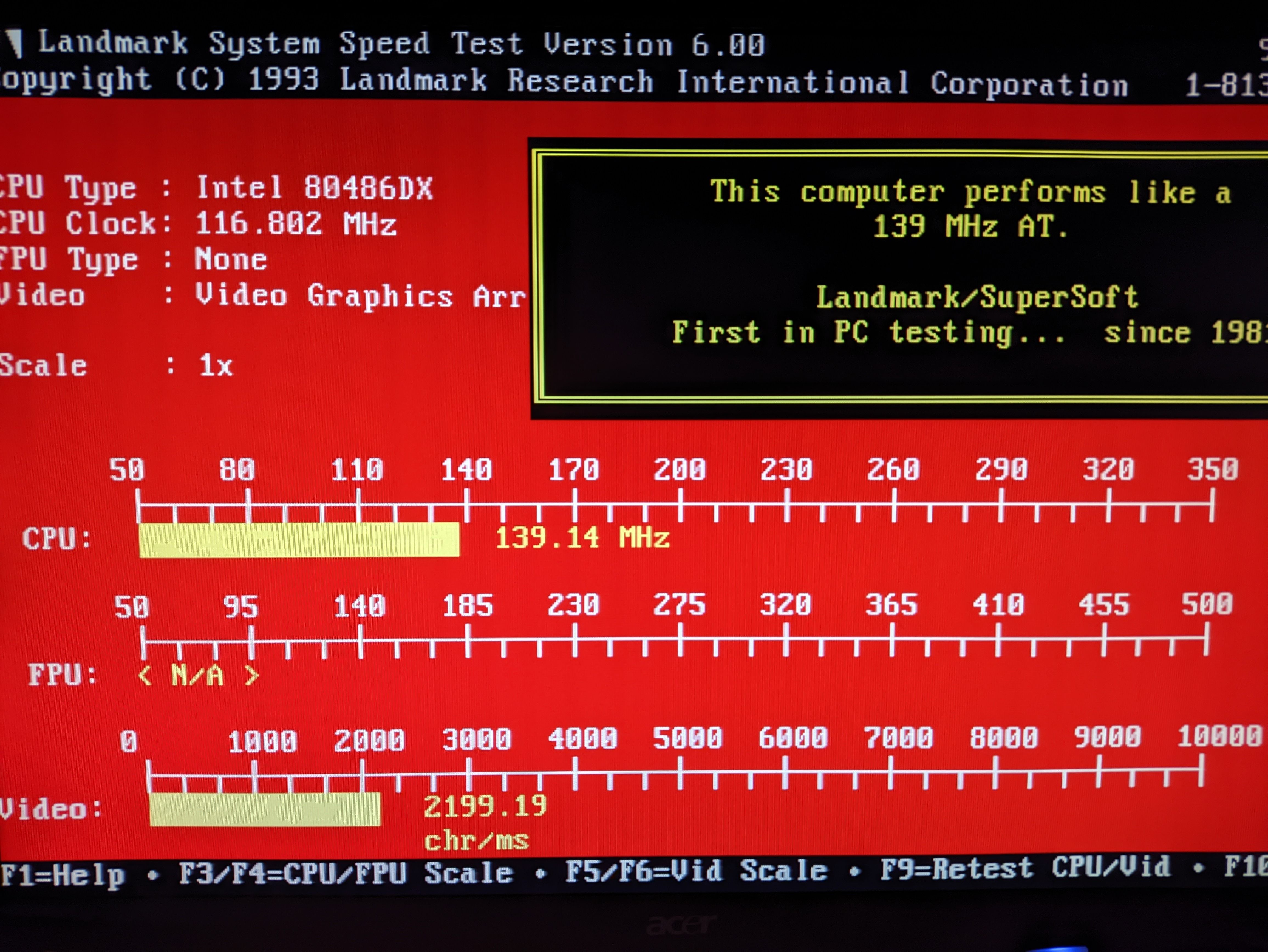

It's currently booting DOS 6.22 from a CF card in a cheap IDE adapter right now. Some classic favourites include StreetRod, SkyRoads, and Operation Neptune. Operation Neptune's music really shines when played through the beeper, using a sound card with this game simply doesn't sound as cool. The blips and beeps are just right.
Demos have been pretty neat to run on it as well! However with the 486SLC just being a heavily caffeinated 386SX, finding programs beyond it's capabilities isn't difficult.

Always cool to see a "kit bash" PC build. I'm curious why you went the dekuNukem IBM PC PicoPSU Adapter vs. one of the ATX->AT wiring harness adapters. Was it mostly for aesthetics and/or having a spot for the 12v barrel jack?

I think mostly because it exists in kit form, looks cool, has negative voltage rails should they ever matter, and slots in nicely so I don't have five million more dangly things falling everywhere. Bonus points for being sold by a real human and not generic amazon seller BigWhooshSwoopingPowerPhwoar.
Of course if I end up needing to use that slot I might need to do something different, but cross that bridge if I come to it.
The onboard fan header is also convenient and saves the amount of adapters to deal with later. I despise chaining 4-pin adapters and splitters and because they are all garbage quality these days with poor crimps and pathetic gauge wire. I use them because I have to, not because I want to. And haven't we all been there where you want to unplug a fan, but it's a 4-pin passthrough ahead of your boot device on a live system? 🤣
I should probably just get my own crimping tool&parts and do custom adapters for everything....

That's fair. I have a couple of the wiring harnesses, and for the -5v, I built several of the necroware VoltageBlasters (handed a few out to folks in the local community). It still consumes a slot but I usually pop it in one of those wOnDeRfUl PCI/ISA combo slots or an 8-bit ISA slot. It's good to have options though. :)
