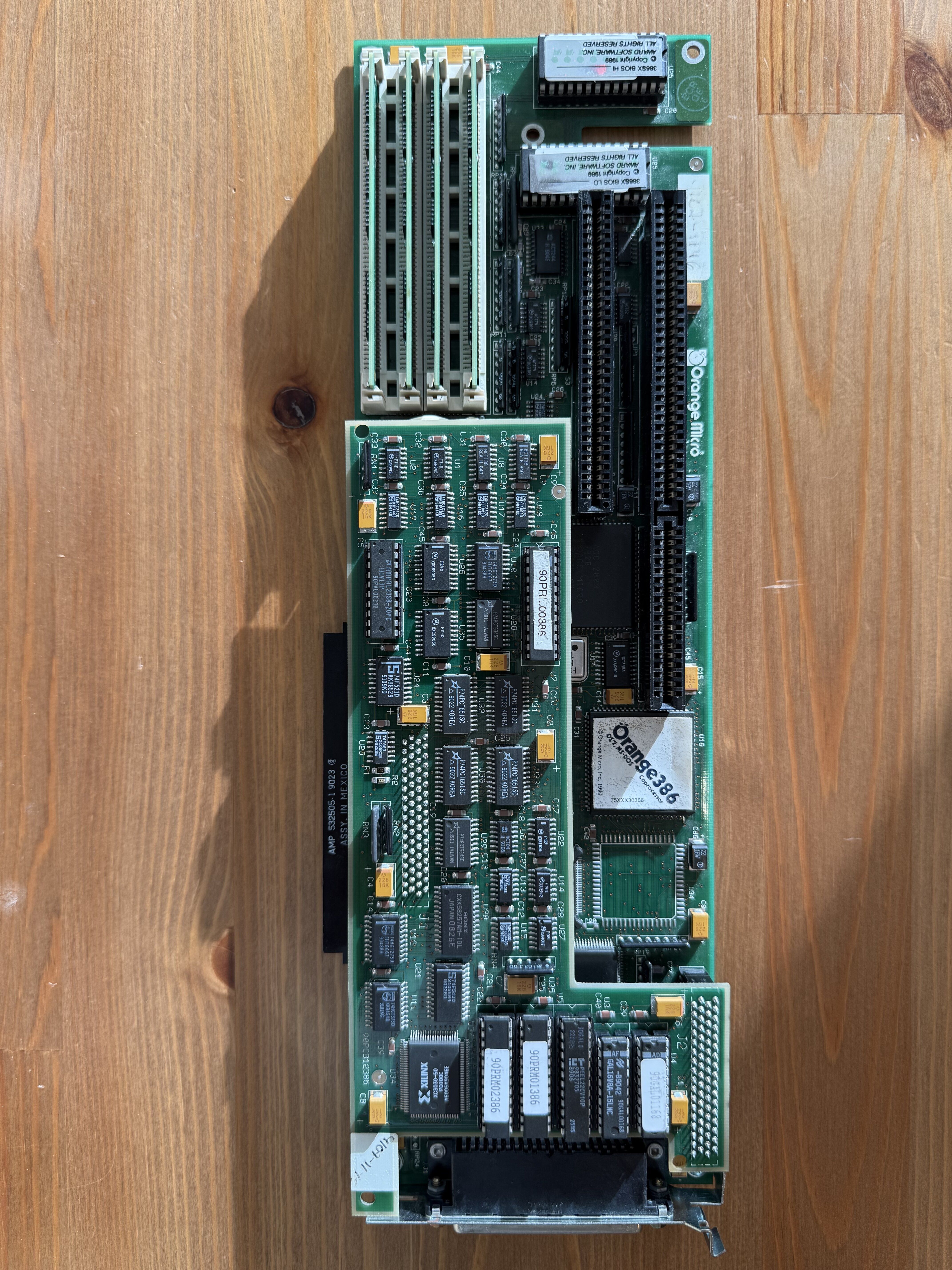

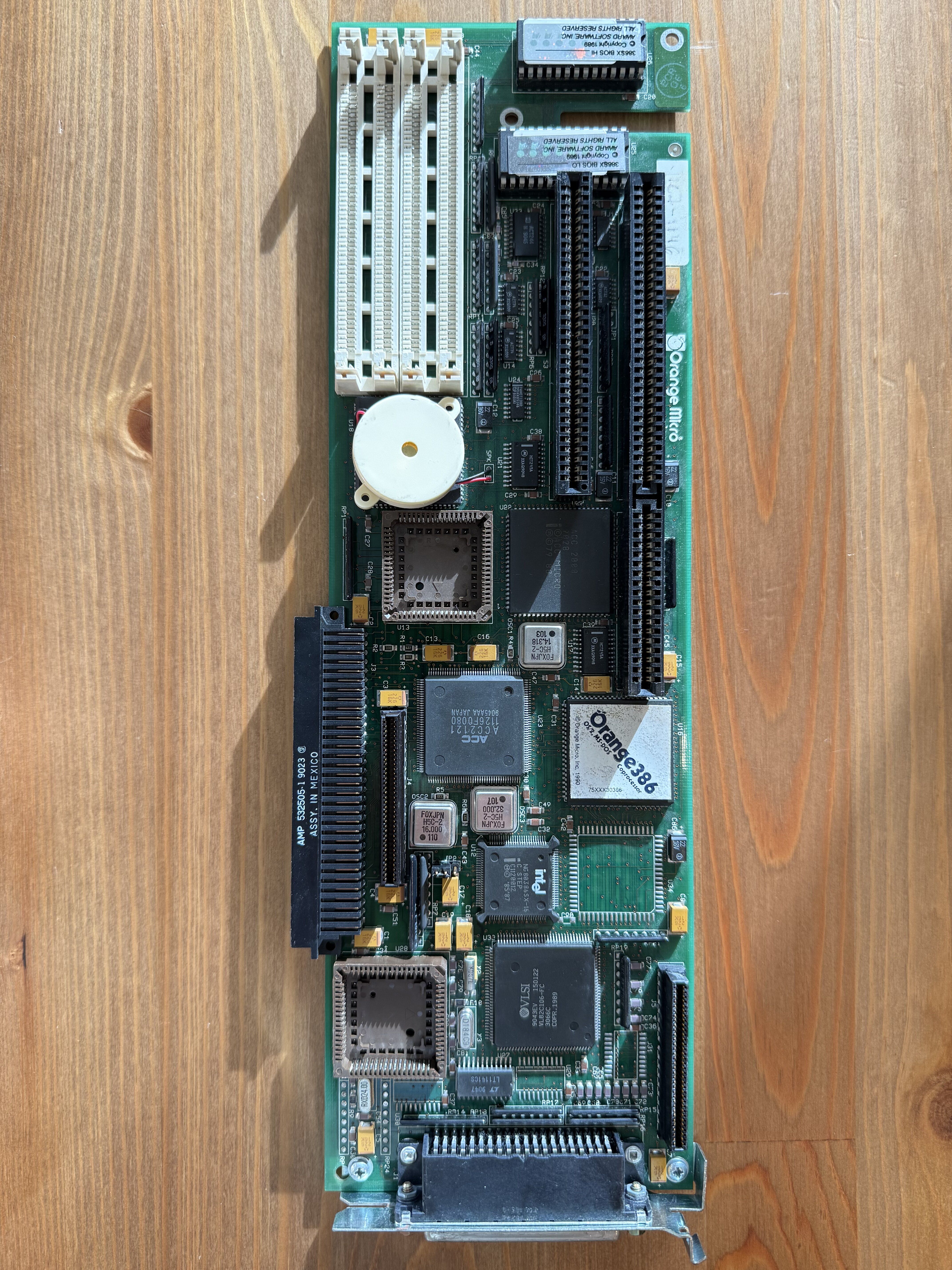

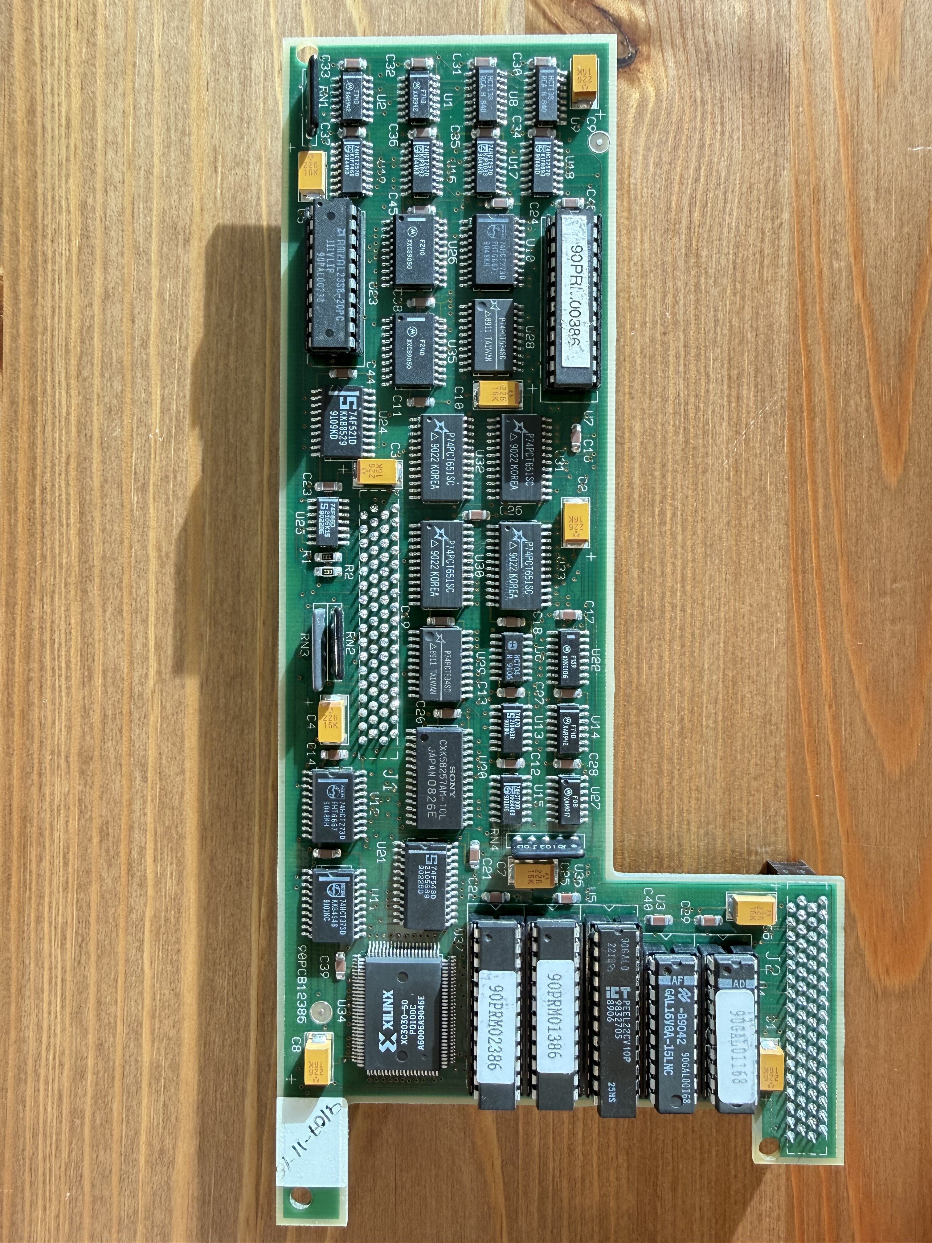

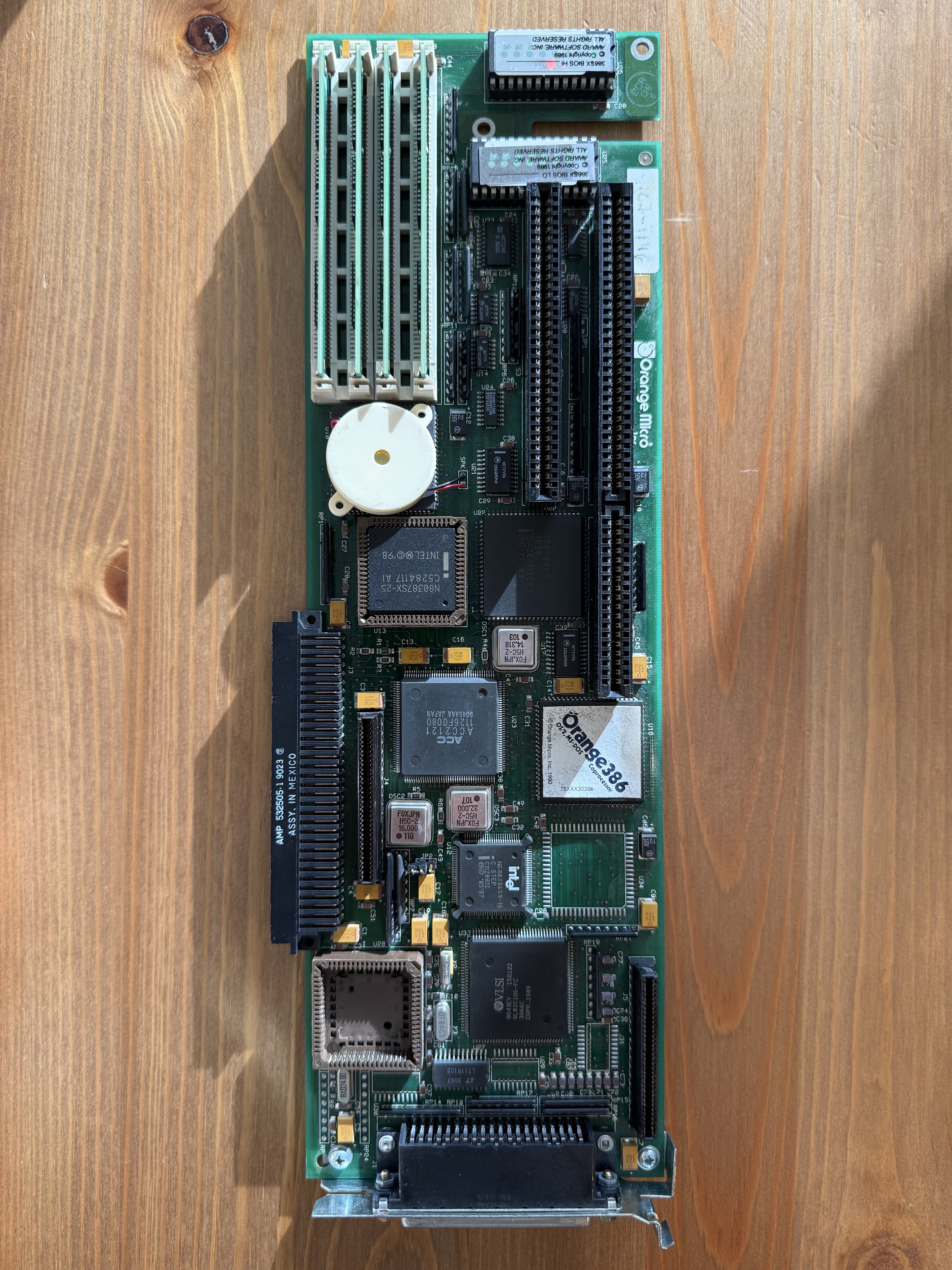

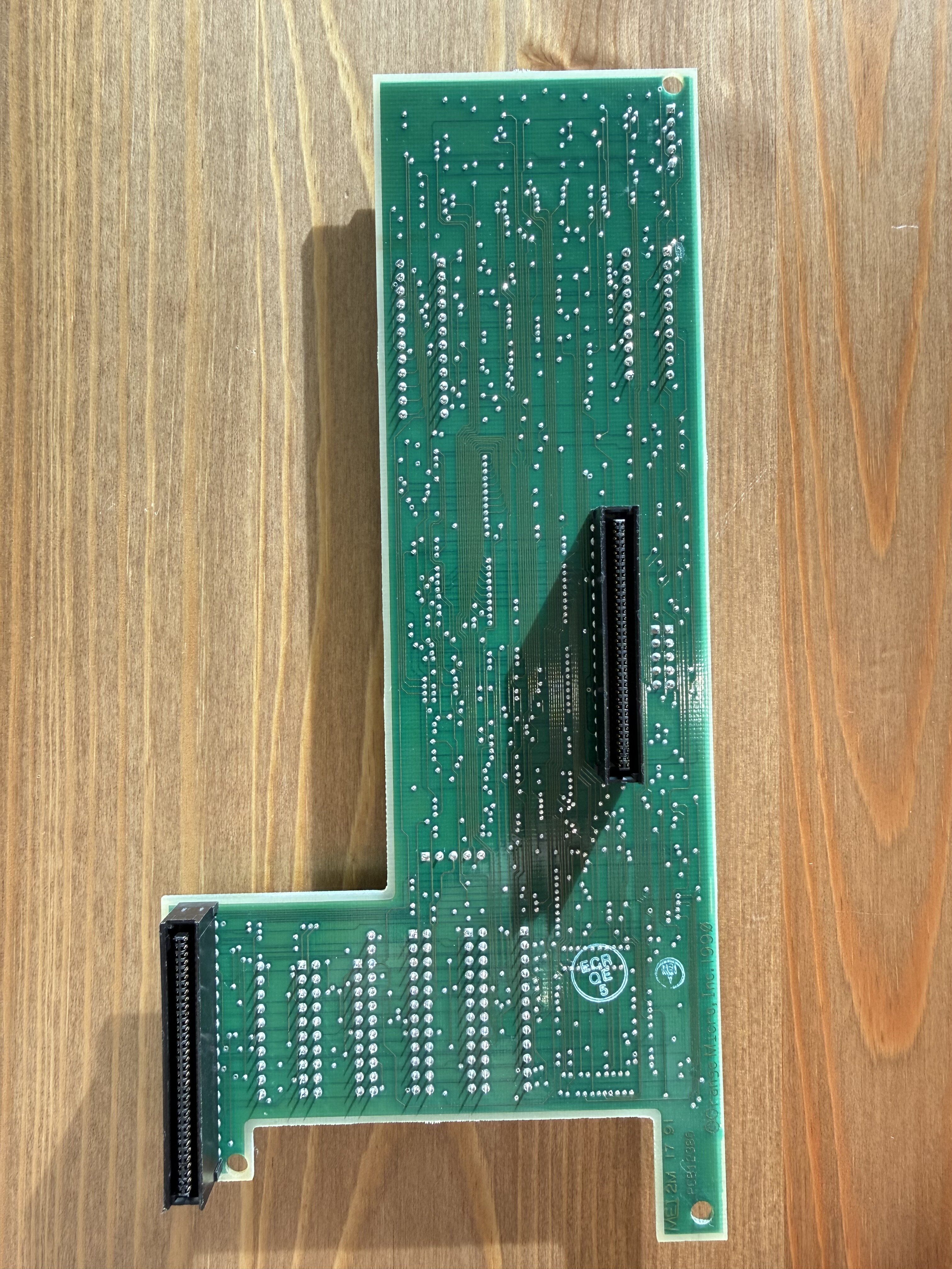

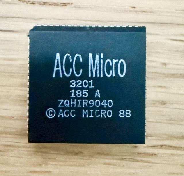

This week I received another DOS on Mac card -- Orange386. I decided not to mix it with another topic that I opened earlier, because this card and software seem completely different.

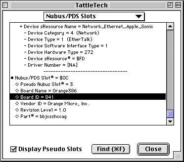

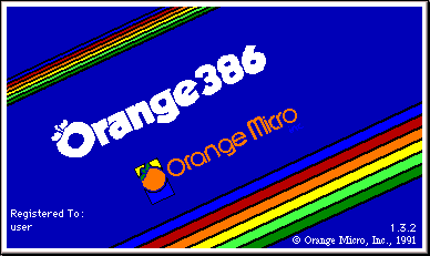

For tests, I installed it in Q950. At first, I couldn't use it because I used the wrong software. OrangePC of any version does not work with this card.

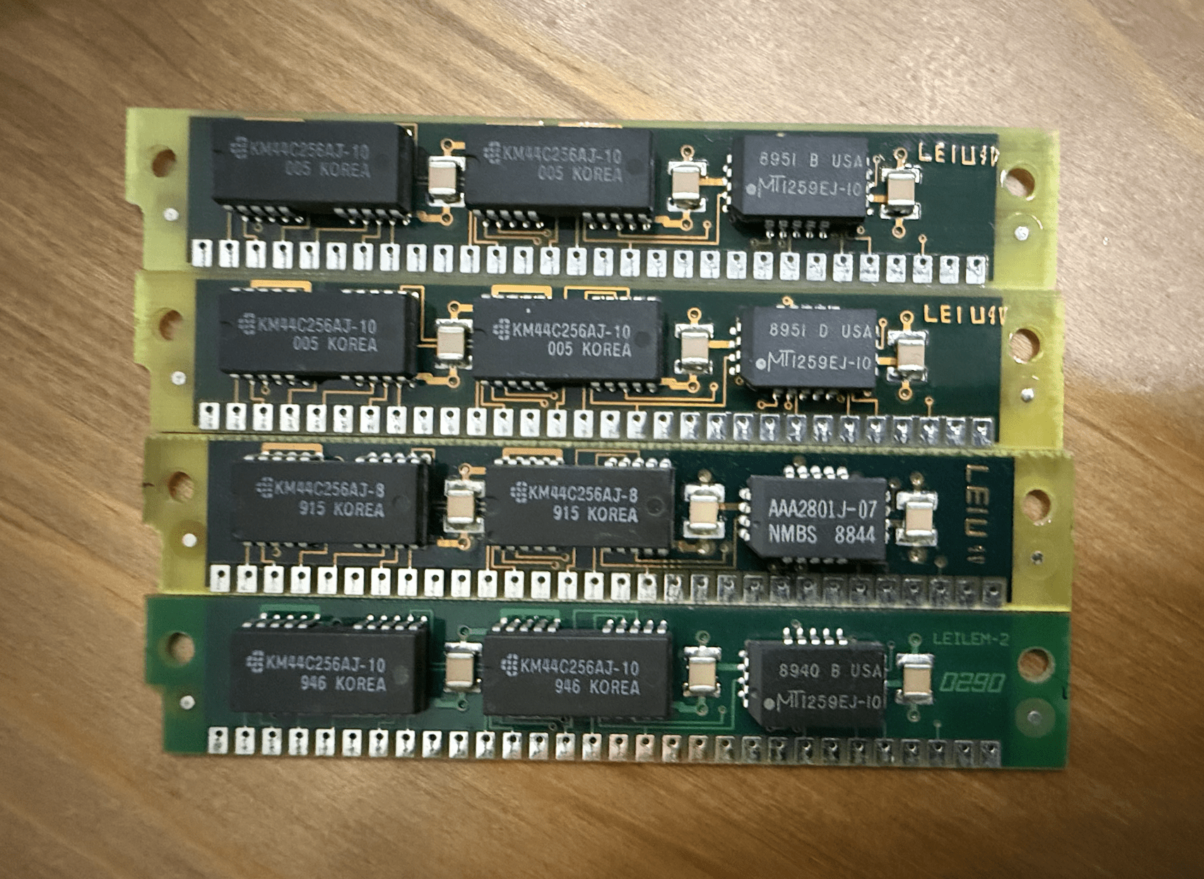

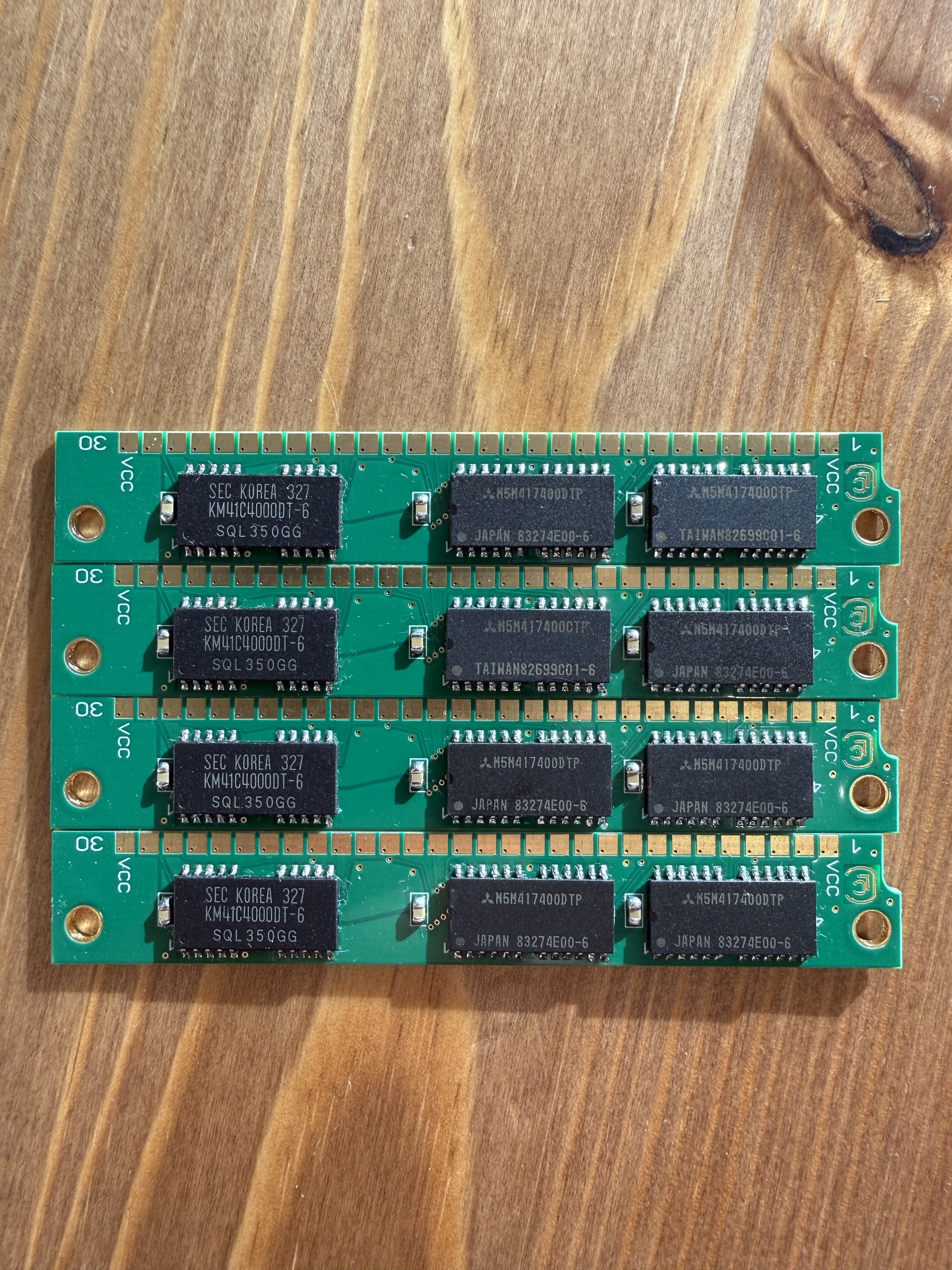

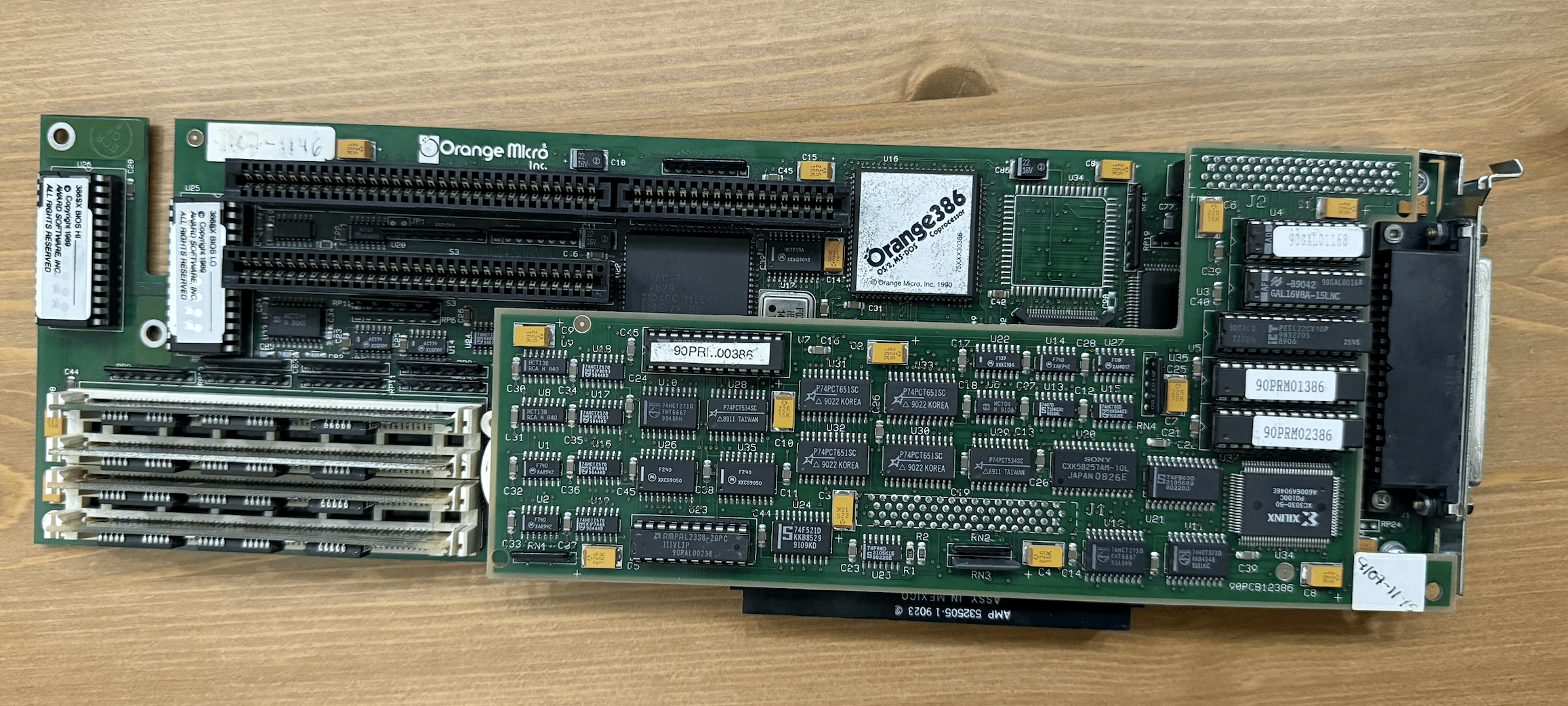

Who knows what memory can be installed here and what is the maximum capacity supported?

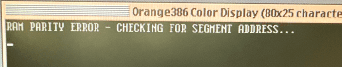

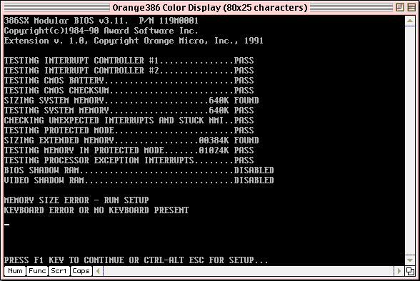

I tried to put the memory that once worked in Q950, but the card does not initialize, I suspect that it does not fit.

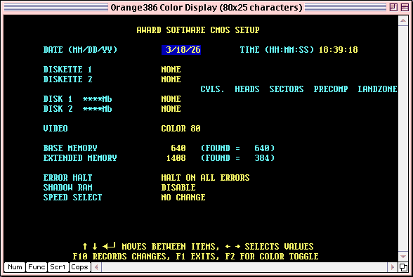

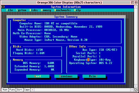

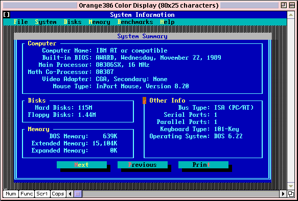

Are there newer versions of the application, drivers, firmware/BIOS? Comic situation, after installing MS-DOS 6.22, the shared directory driver displays only files, directories are not displayed. It seems that due to the small amount of memory, you can forget about attempts to unpack archives with retro7zip.
