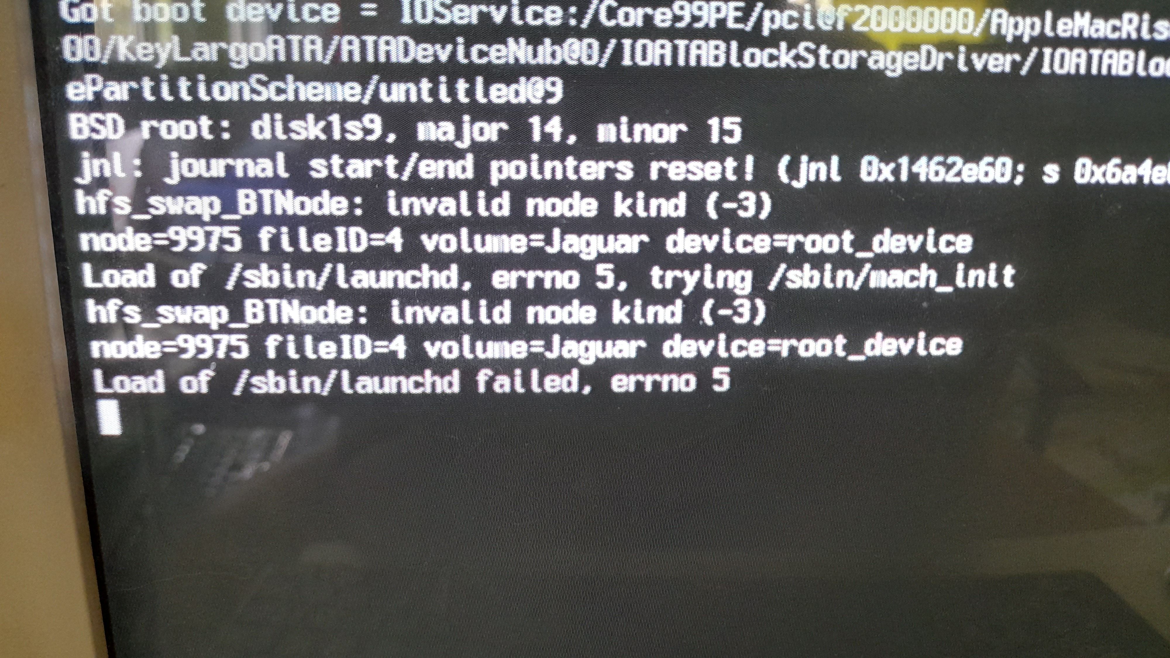

Try booting into verbose mode by pressing and holding „cmd v“ during the boot chime. What‘s the last message you see?
647
453
46
First thing that I noticed was the invalid node error - when I see node kind/structure type errors, that often points to the hard drive where there is an issue with its ability to catalog & retrieve files. You could try repairing the install in disk utility or maybe disk warrior if you have it but you might be looking at a new hard drive. I actually have a iBook g4 with this almost exact issue lol. The old rusty hdd is most likely borked. I plan to replace the hdd with an SSD.
