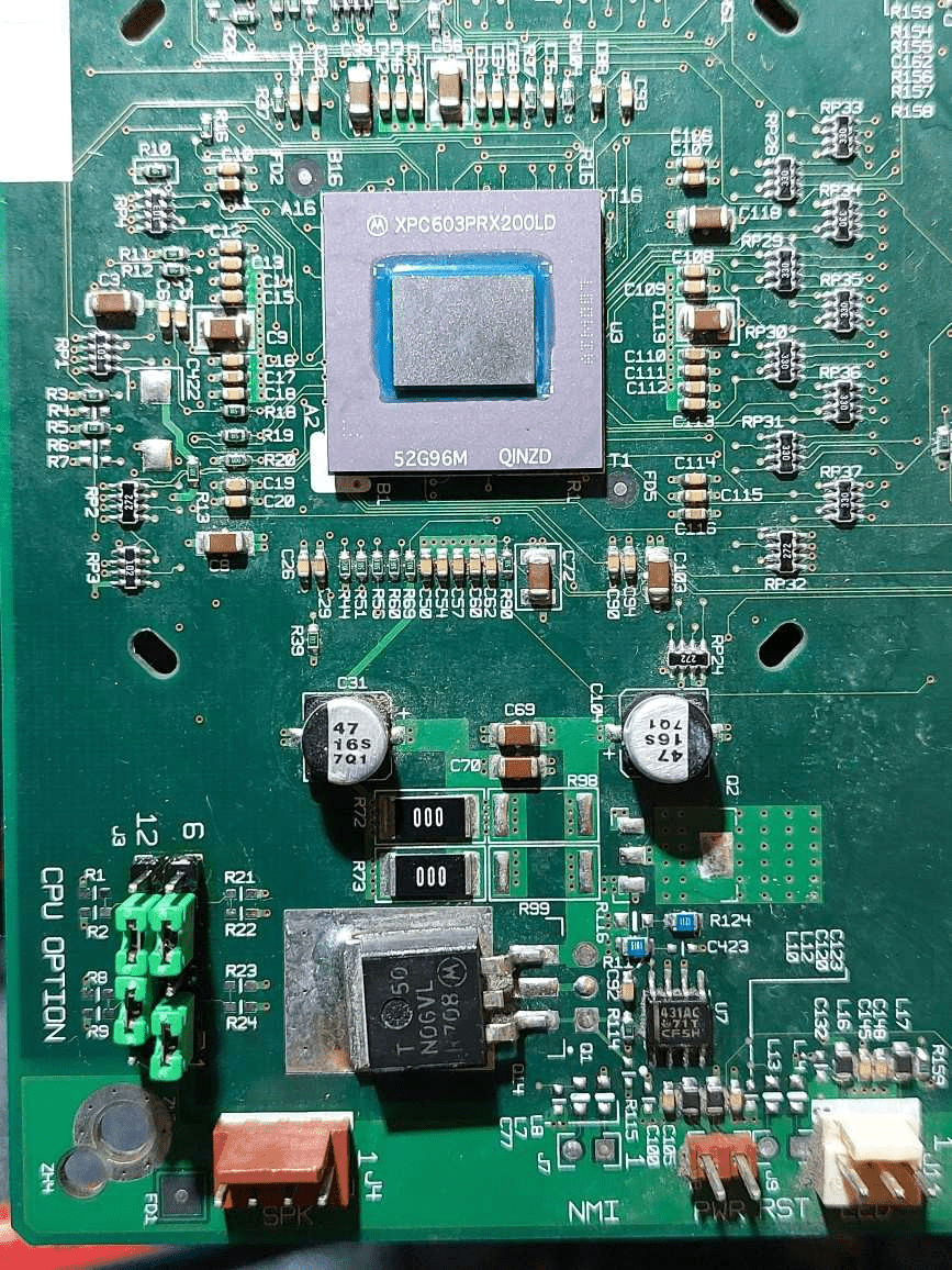

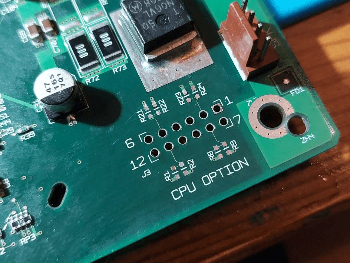

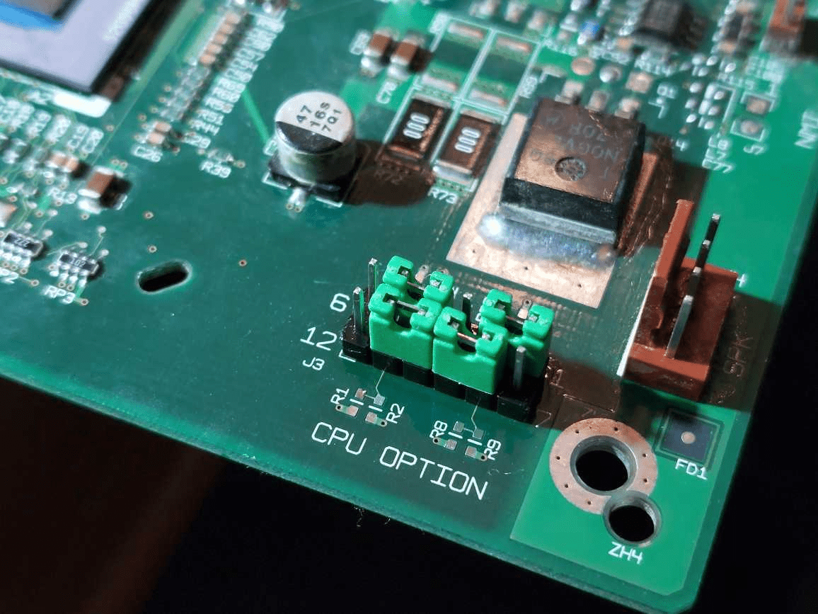

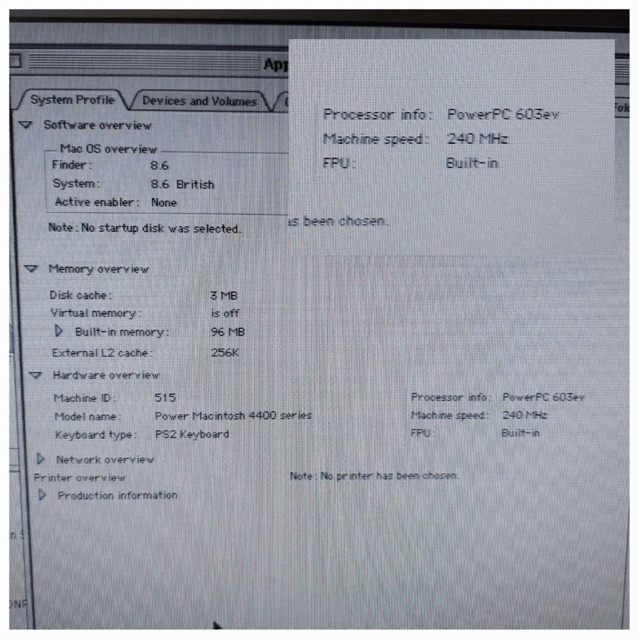

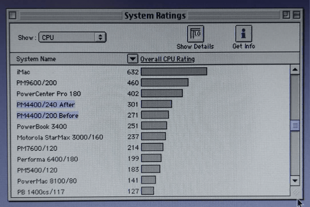

I managed to speed bump my PM4400/200 to 240MHz. Turns out the answer was written on the silkscreen of the Motorola StarMax! You can set the speed to anything between 80MHz and 240MHz (in mostly 20MHz steps).

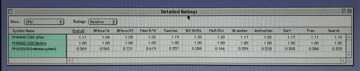

I got an 11% improvement in Norton System Info's CPU benchmark overall (from Norton Utils 6). The limitation is that RAM doesn't change speed so the RAM heavy benchmarks don't see the full 20% increase. See the breakdown.
Should work with the various Tanzania Motorola StarMax, Power Computing PowerCurve, UMAX/SuperMac C500 C600 machines as well as Apple's 4400 / 7220. Assuming you're not already running at 240MHz.
My CPU runs cool enough to comfortably leave my finger on the centre of the heatsink and I left it running at 240MHz for about an hour (I stopped restarted to benchmark back at 200MHz).

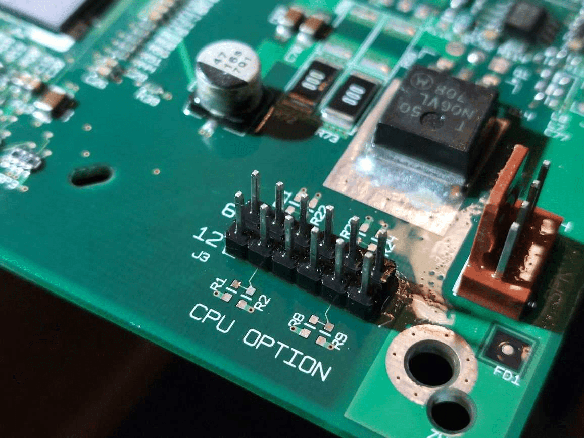

Instructions are available here if anyone wants a go - basic soldering skills required, but nothing fancy. Basically if you can solder a standard 2.54mm header and clear out solder flooded through holes.
