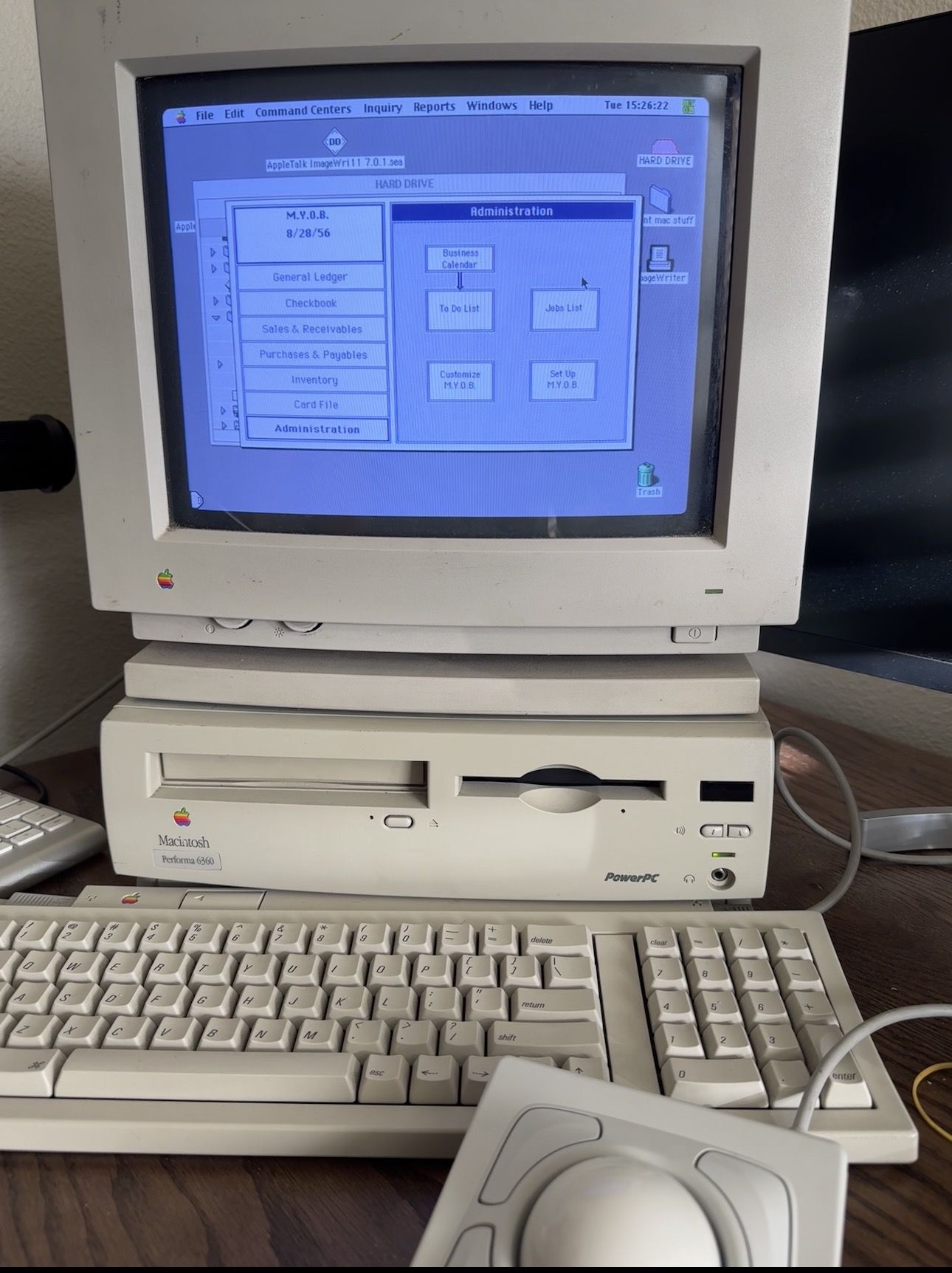

So, ... I ended up with a Performa 6360 nearly free ($25), along with a purchase of an Apple "Trinitron" CRT and another vintage computer a local seller was offloading very inexpensively before moving. )He even through in a 6116CD with a missing HD for free. I took it because the pizza box case was in good shape.
The 6360 is not something I was seeking, but it is a bit nostalgic for me as I had the 6200CD as my main computer when I went out on my own as a solo lawyer in 1995. that machine got me through a year or two, along with some peripherals and a HP 5MP printer that worked for me until into the 2010's sometime (amazing machine from when HP seemed bulletproof). Along with work, I enjoyed my 90's alt rock music on the Launch CD-ROM mags, and played Myst (poorly, but enjoying the scenes and vibe).
So anyway, the collection grows.

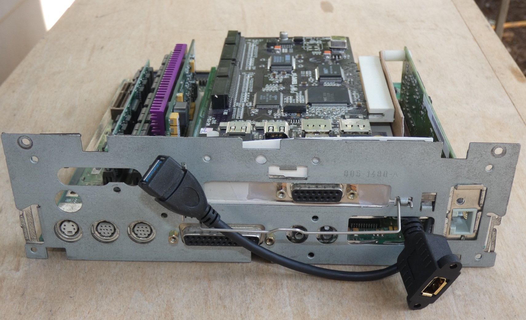

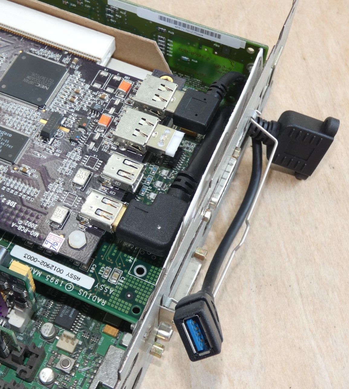

That doesn't work out so well, took a look at it. But if I finally get around to learning to use current PCB layout tools or rope someone into designing the boards for me this TwinSlotPCI riser for 6360/5400/5500 and another just for TAM are eminently doable:

It's been a long time since I put a dual slot riser in my 6360, but I remember it colliding with the frame where the TV tuner board sits. I remember being able to make it work, as long as the upper card didn't need any external connections, if the metal frame was removed. This limits its usefulness to things like disk controller or wireless cards. Or if some soldering was involved, rerouting ports to different locations.
I was more thinking along the lines of having a split board with a ribbon cable between the two, with the upper slot being in the bay where the TV tuner would go. This of course would mean you couldn't remove the logic board through the back of the case, you'd have to remove the lid first and disconnect parts before you could pull the logic board out.
Not entirely sure how the PCI bus would deal with signal integrity on a ribbon cable, but with weird backplane shapes with the likes of LPX and NLX risers, I'd figure it'd be fine for just a couple of inches.

Yep, I took out the shelf space for tuner, but the fan is in the way for a full height card IIRC. A low profile card in the top slot worked for you? The bottom slot doesn't align with the backplane cutout when using the 6x00 PCI Riser if memory serves.
Cable based PCI risers for 1U conversions are commonly about five inches long and work fine for a single card. I need to chop mod a pair of them to lay the personality card over for my BeigeG3/2U build. ATM it's a 3U experimental which works fine, but 2U is the goal . . . with a custom PCB to lay the card over.
