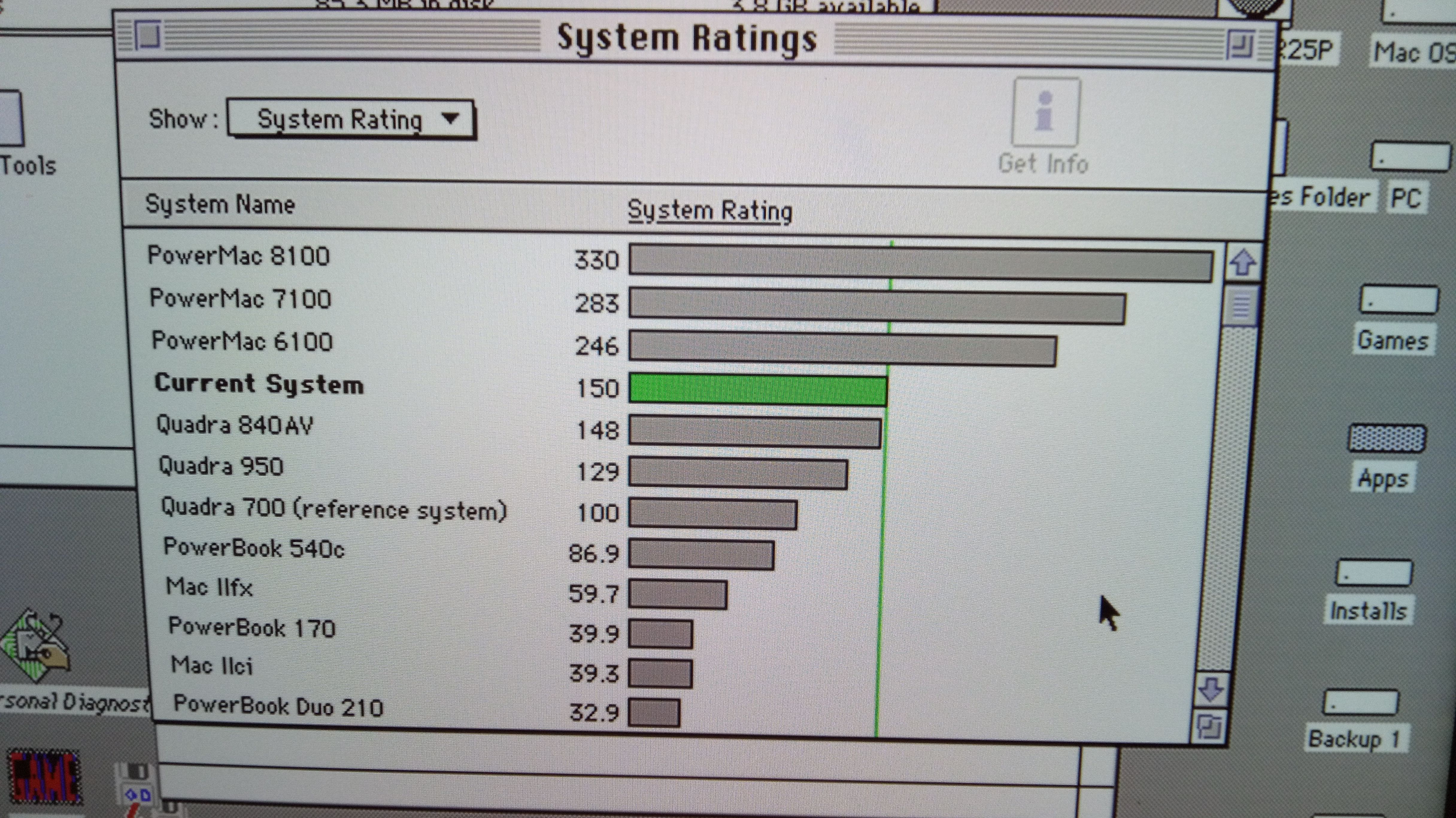

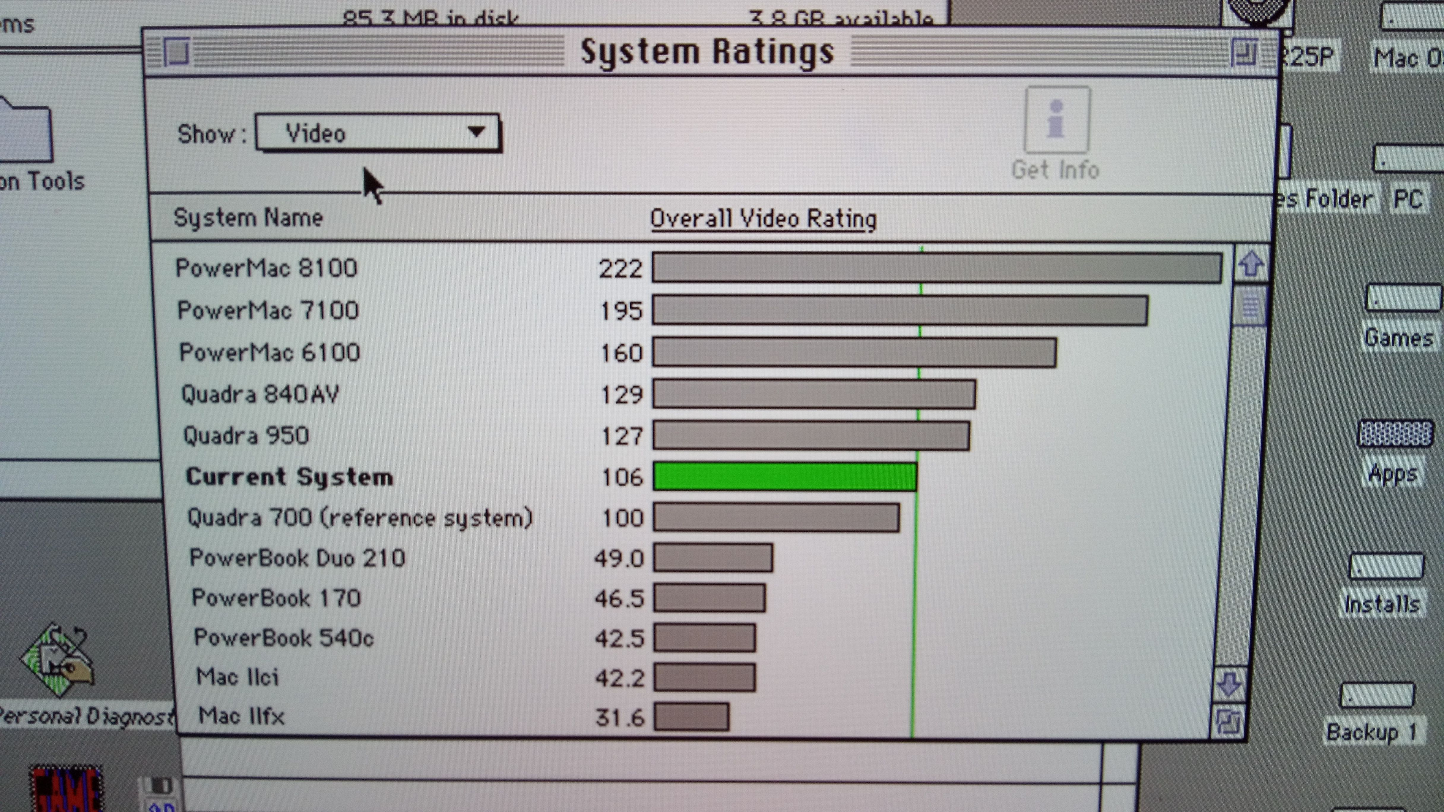

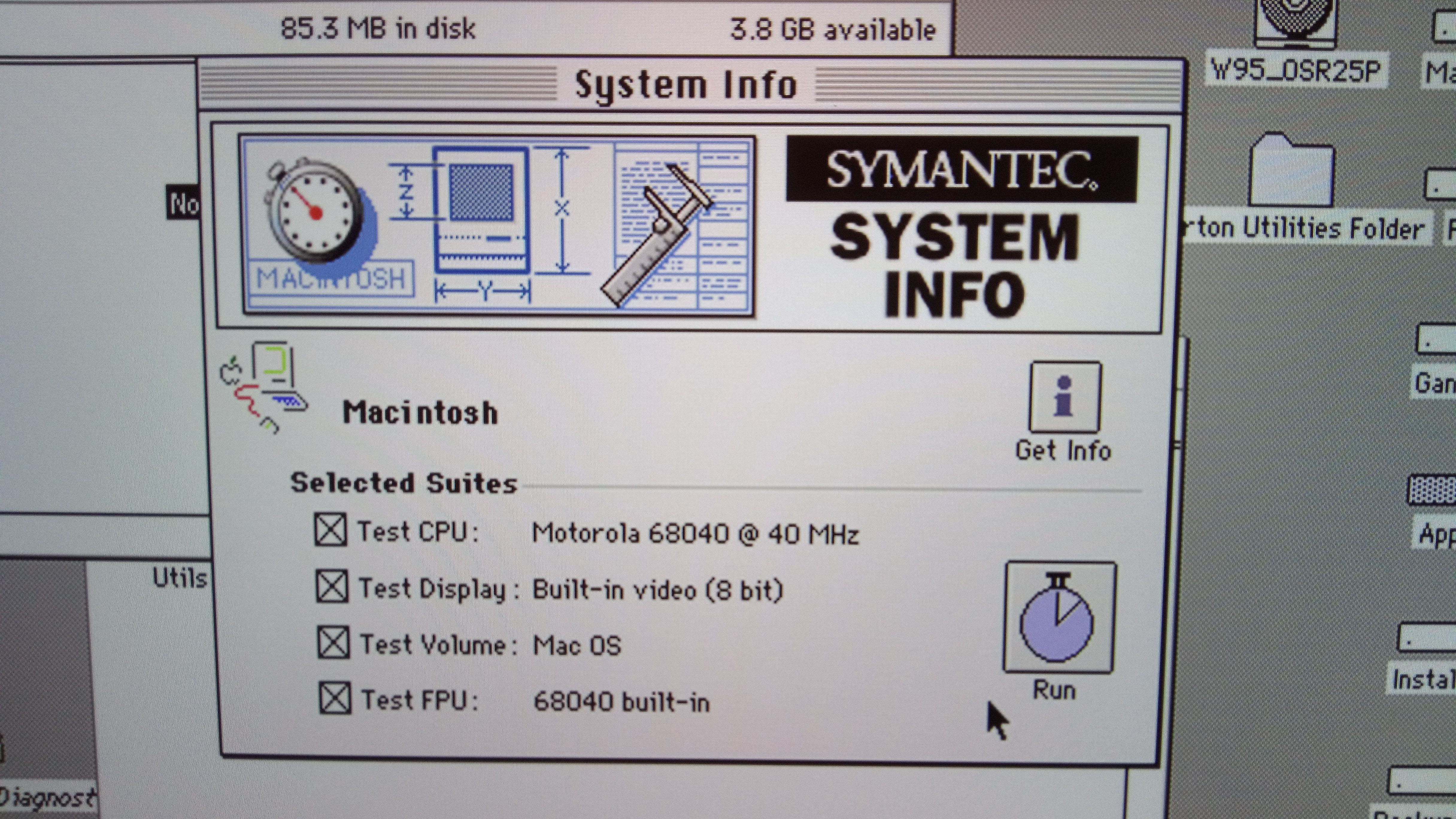

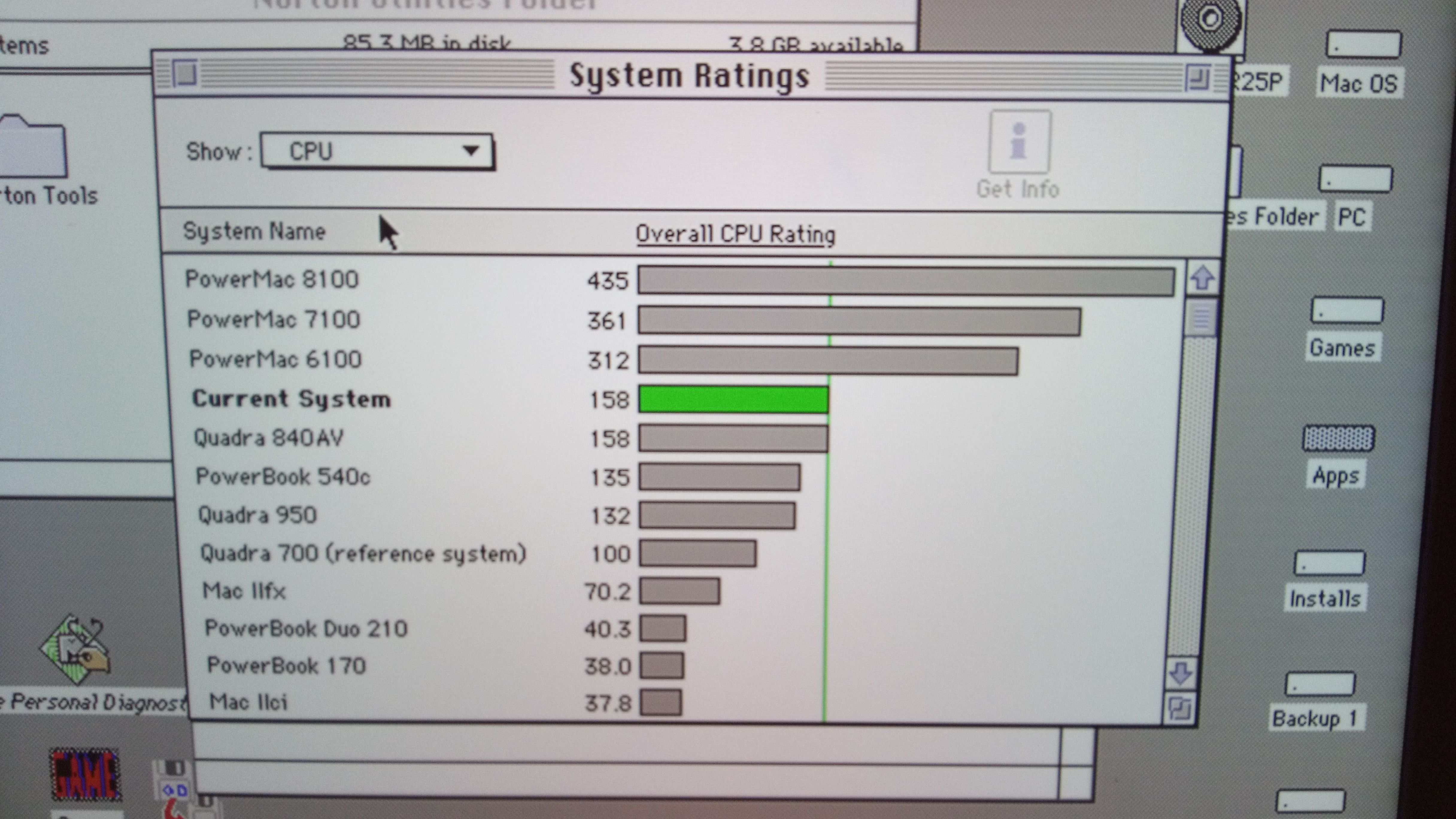

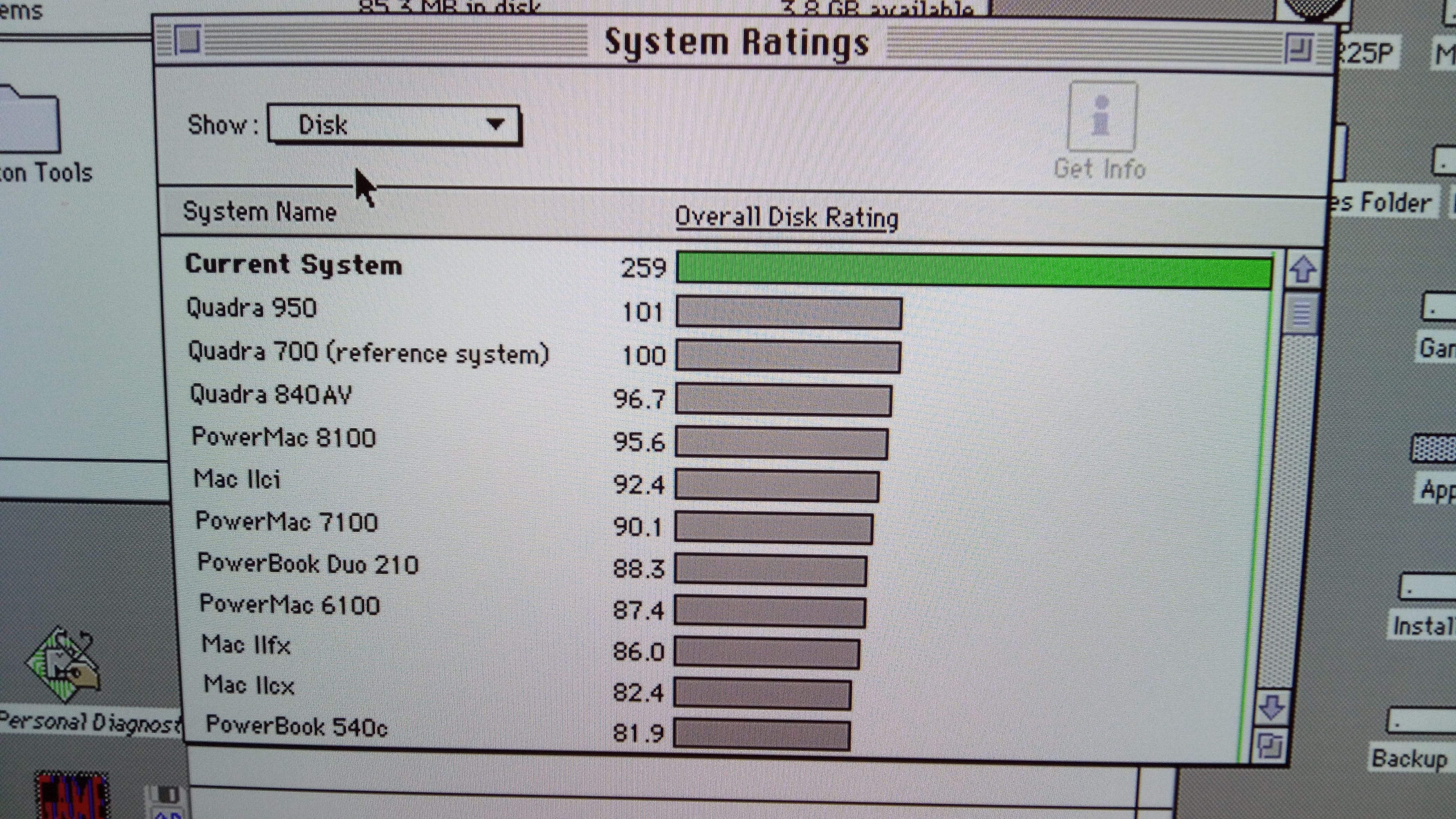

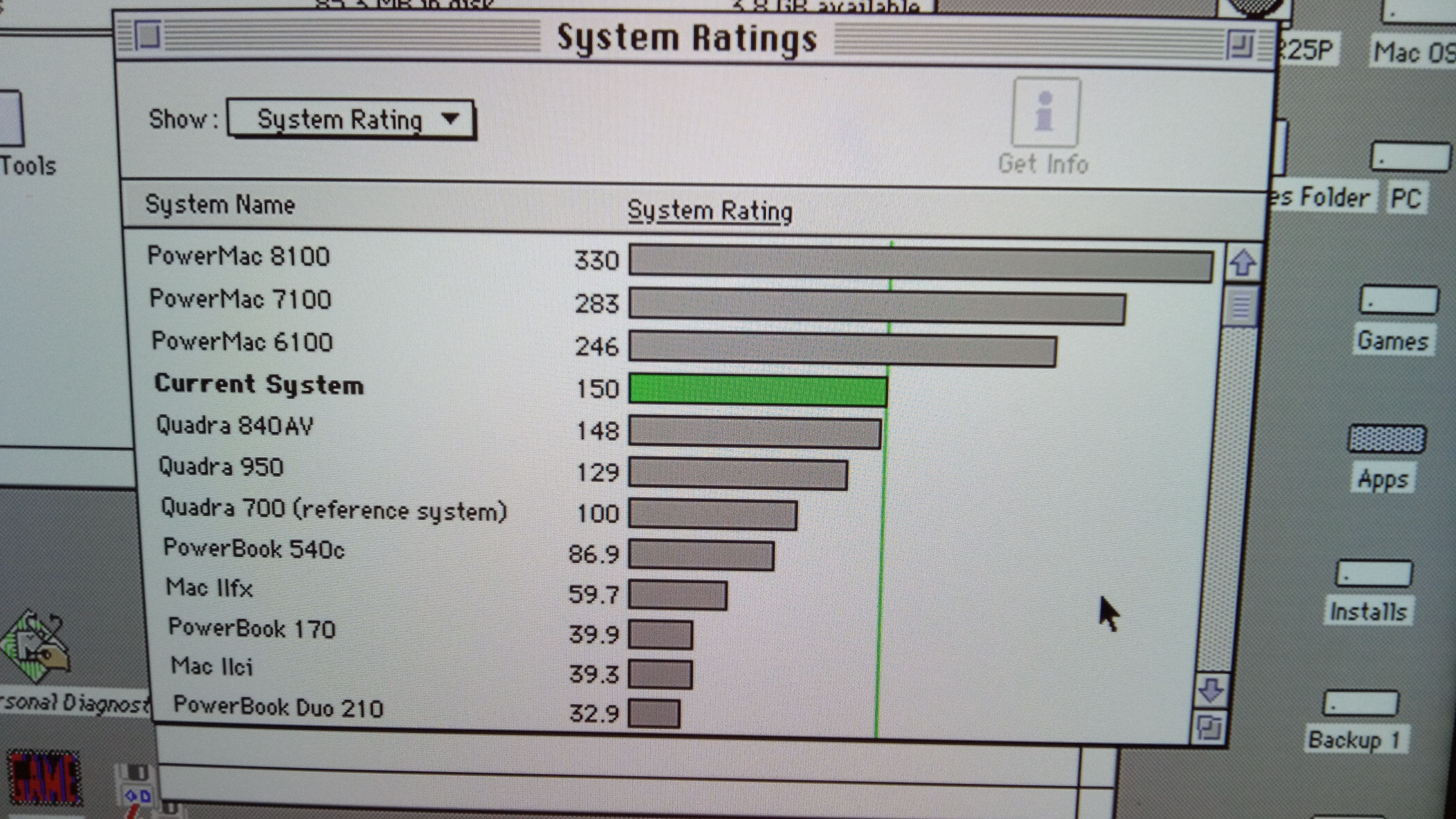

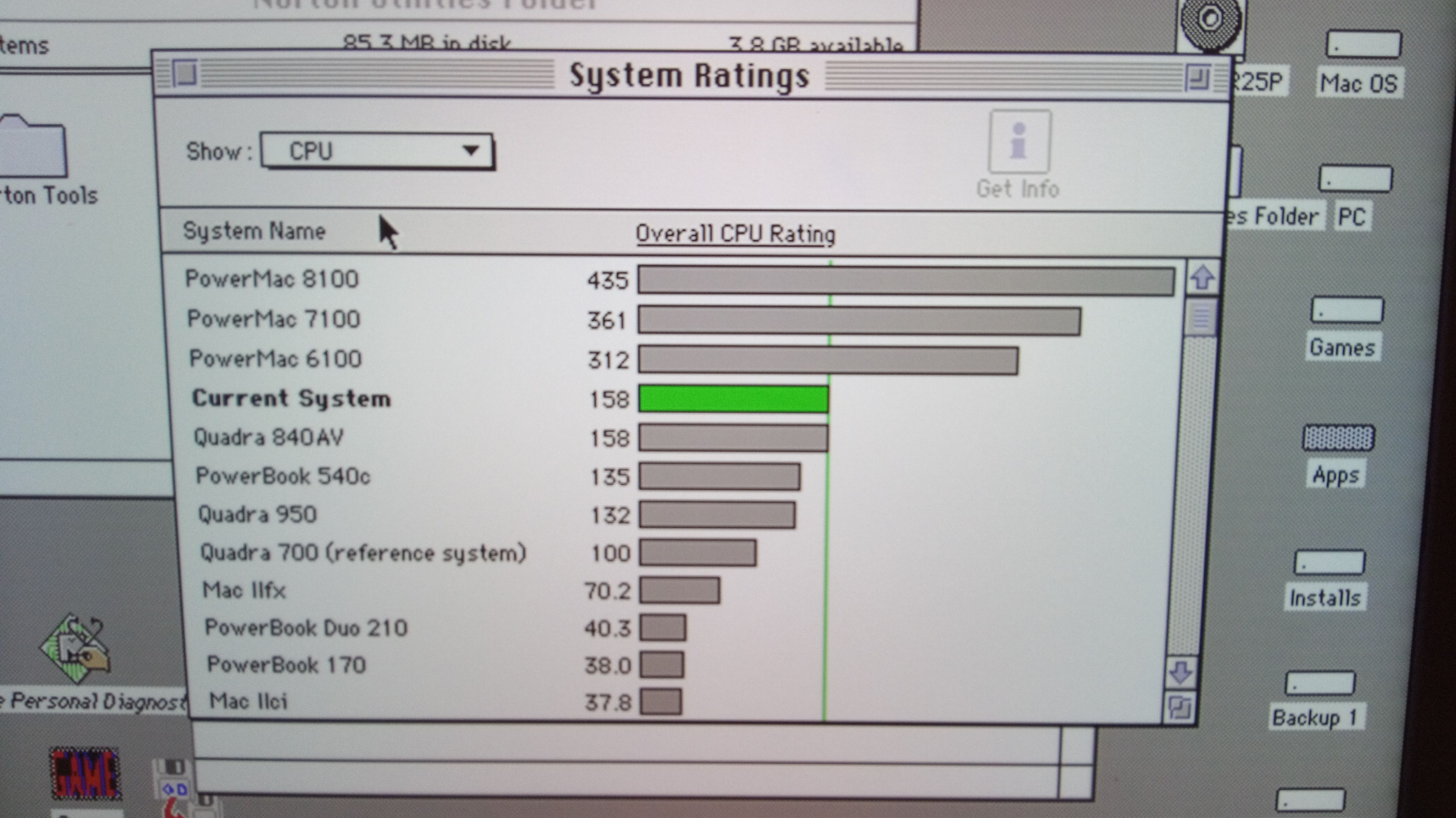

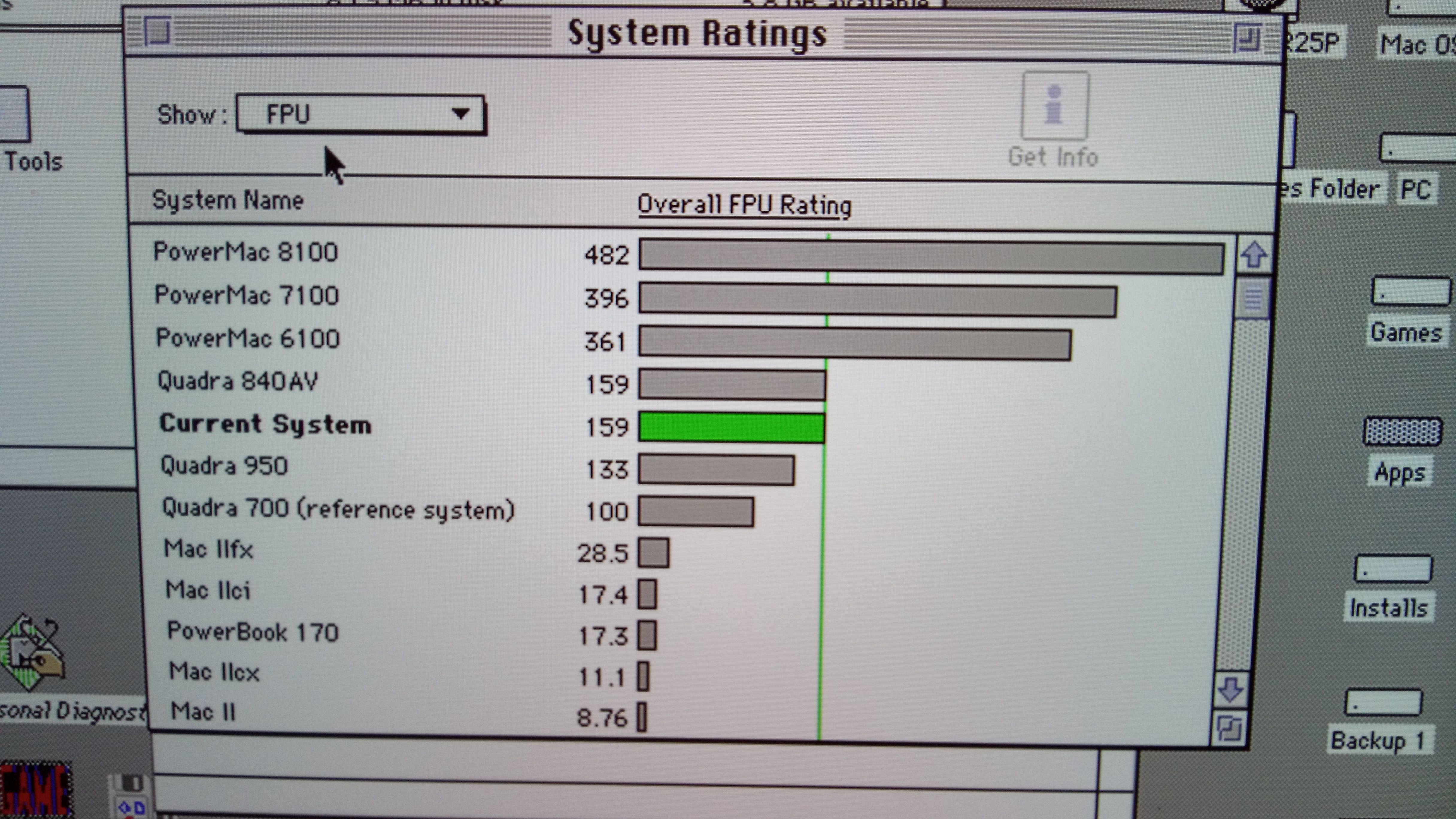

Here's the Norton Utilities 3.1 640x480 8bit benchmarks:
