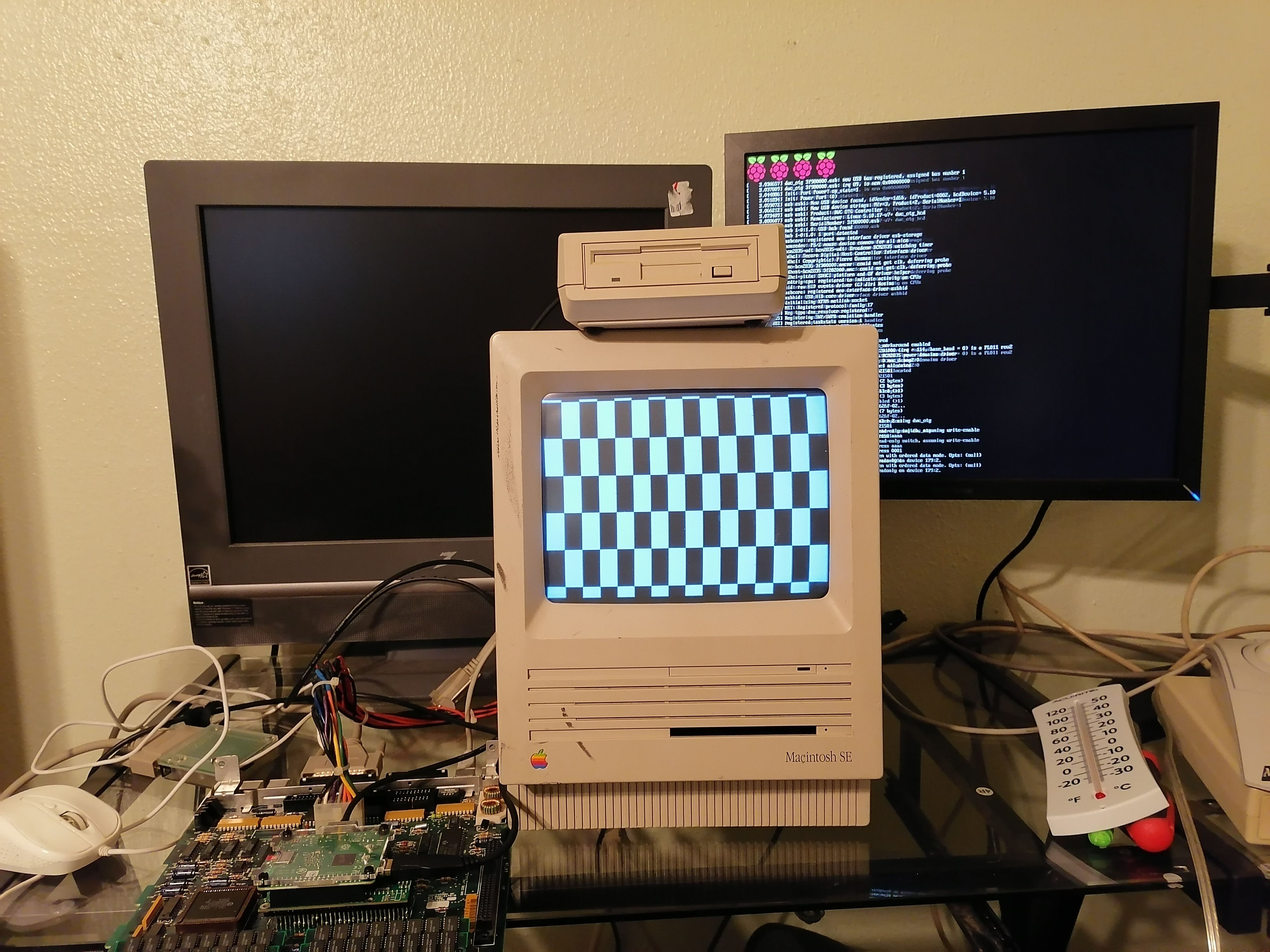

I'm not at home but the photo above is from Discord a while ago.
I bought a power/video cable from eBay and extended the wires so I can work on the motherboard on the outside of the case (and the high voltage CRT).
This is how the computer looks until I start the CPU emulator on the Raspberry Pi.
One of the creators of the PiStorm used a Raspberry Pi Zero 2 W and was able to install it in his Mac SE and close up the case...mine is probably too tall with the extended socket...
