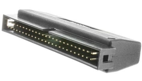

The only thing on the SCSI bus right now is the CD-ROM. I have a Sonnet Tempo Trio installed, which I run my hard disk on. Now it isn't even booting from the CD drive. I literally have spent a week on this computer. I just wish it would stay consistent. It's always doing random weird crap. It's more unpredictable than predictable.
The CD drive has done this before, but snapped out of it. I used to think it was a bad CD drive, but when I put the space before the extension filename back then, loading the extension earlier fixed it. But even in Mac OS 9.1, it does weird things sometimes.
