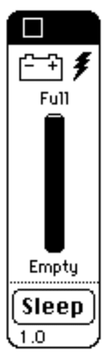

You can also see whether the computer thinks the charger is connected by opening the Battery Desk Accessory or Control Panel, usually available in the Apple menu. How it looks depends on the version, but usually there will be some sort of lightning bolt or plug icon that appears near the battery symbol.
The default ROM code for sleep only has the function to disable sleep if that setting is set and it thinks a charger is connected. You could manually set the sleep time to the max of around 63 minutes by manually editing the timeout in the PRAM or global variables. Setting it to 0 unfortunately causes it to reset to the default.
Perhaps you could edit the "charger connected" global variable, but I'm guessing another piece of code would change it back.
My test is finished. My first discovery was that the "Battery" DA in System 7.1 doesn't look like your screenshot. It looks like this:
So I booted into System 7.5.5 and found there is no DA named "Battery". That compelled me to reinstall 7.5.3. But even then, no "Battery" DA. I installed the 7.5.5 update, but still no Battery DA. And while there is a control strip that pertains to battery, it doesn't look like yours. Even so, no lightning bolt.
I then rebooted into System 6.0.8, but I cannot find any Battery DA that looks like yours. Yours is a real mystery. Where did you get that vertical one?
While booted into System 7.1 and installed MyBattery and rebooted, but that didn't give me a Lightning Bolt icon either:
After that, I installed PBTools and restarted. No Lightning Bolt in its menubar icon either! I then did a test where I set "Backlight Dim" to 1 minute and "System Sleep" to 2 minutes in the "Running on Battery Power" section, and I set the "Plugged into AC Power" section all to infinity, as shown below.
If my Portable was on AC Power, it would never dim or sleep. But precisely after 1 minute, the backlight dimmed! And after 2 minutes, it went to Sleep! (Note that I had removed the PowerBook Control Panel prior to this, so I know for a fact Dimming and Sleep were under the full control of PBTools.)
Not yet convinced, I did a second test where I set the Battery Power section to 60 minutes as shown below. I then waited for 32 minutes and came back to find my Portable still awake with backlight at full brightness! In other words, it didn't sleep like it does when you set the PowerBook control panel to "never sleep on AC Power".
These tests prove that the Portable Battery Eliminator is in fact replacing the Battery and NOT REPLACING the AC Adapter. Meaning, the Portable thinks it has only a Battery but that the battery is full. The down side of that is that anything which is setup for "AC Power" will be ignored. Instead, your Portable will be treated as being on Battery.
Because PBTools is a nice workaround for the Portable Battery Eliminator "problem," I will just use that with 60 minute settings, which is long enough to be away from your Portable before it sleeps.

Thank you for mentioning that hidden trick. Unfortunately, that does not pertain to the AC Adapter, Battery or Sleeping. The trick you mention is only to prevent System "Rest" which normally drops the CPU clock speed down from 16MHz to 1MHz when nothing happens after 15 seconds.
However, in your screenshot, I spotted the same exact Desk Accessory? that @SuperSVGA posted earlier...
But for the life of me, I don't know how to invoke that in System 6. I've gone through all the System 6 installers and I don't see anything named battery. So if you or @SuperSVGA know how to invoke it, please let me know. It's probably super easy, but right now, I can't see the forrest for all of the trees!

So, I resolved to figure it out on my own. It took a huge amount of time, but I did figure it out.
Here are the steps to follow when you can't see "Battery" in your Apple menu while booted into System 6:
1. Download the Apple Restoration CD
2. Open: US Software Configurations > US Service Bundles > 694-0222 > 694-0222•0C637BE4• > System Folder
3. Launch Font/DA Mover.
4. Click the "Desk Accessory" radio button.
5. Select "Battery" in the left sidebar.
6. At right, click the "Open..." button and choose your System 6.x "System" file
7. Click the "Copy" button to move it to your System file.
It's a convoluted mess, I know, but it works. If there's a faster an easier way, please share that knowledge.
Ultimately, once you boot into System 6.x with a System file that actually has the "Battery" DA installed, then and only then will you see "Battery" appear in the Apple menu, and then you can finally see that ever elusive battery Full <-> Empty widget.
