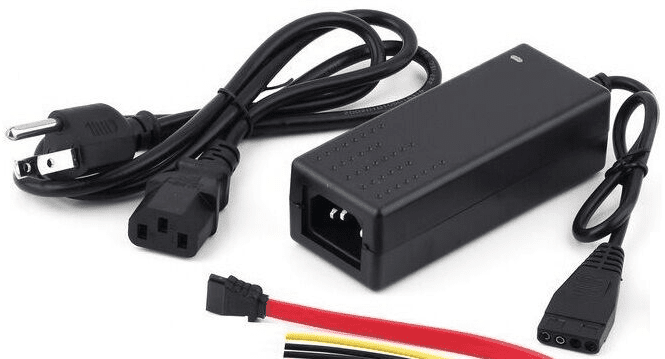

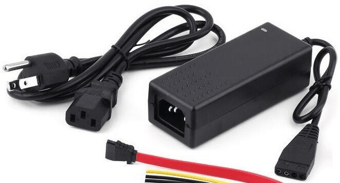

This power supply seems readily available and very cheap: https://www.ebay.com/itm/311327132800
The only thing it would be missing is a -5v DC. How difficult would it be to build a PCB with the components needed to also have -5v DC? These could easily be inserted into an existing LC PSU housing, and are very inexpensive. Thoughts?
Unfortunately, this PSU cannot be used.
To know all the currents used for + 12V, + 5V, -5V, refer to the original PSU label.
W= V x A
In the case of LC475, a total PSU of about 45 to 60W is required. *I used 90W...I think it was😅
Use an inverting regulator to generate -5V.
Furthermore... one thing to keep in mind when using a normal ATX power supply is that a 68K Mac has a much higher current at + 5V than at + 12V.
If you wait for about 12 hours, I will calculate this and reply again.

Oh I didn't know -5V unplugged and boot, Can it certainly boot on the LC475?
If that is true, you have to apologize for the wrong information point 😅
However, when I checked the wattage of the small AC-DC adapter (same as Mr.F's link) I had, it was 32W, which is not enough for the rating. Moreover, 5V has only 2A output.
I have to confess I'm not 100% sure there, I was testing it on a LCIII when I did my test's, I would expect the 45 would be the same but I haven't personally tested it.
Yeah it's proabley enough for a LCI with a SCSI2SD, but your crazy souped up LC475 might require a tad more juice than one of those bricks can provide :)
