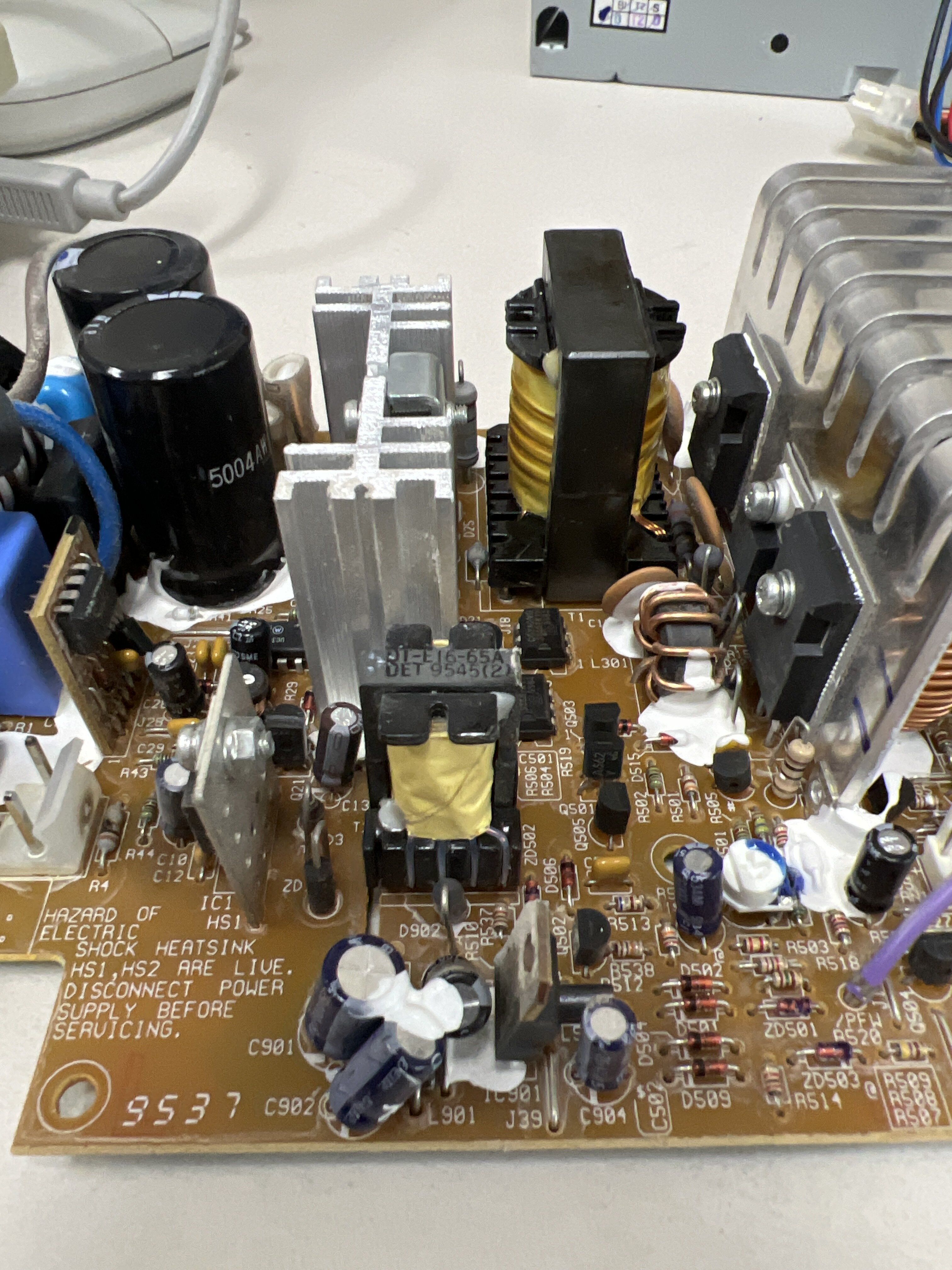

The power supply on my vintage Power Mac 7600 must have given up the ghost. It worked for a month in the machine and now has sadly become non-functional. So, the PSU is removed for an examination and recapping. I will need to get a list of those capacitors. :)

Look like the use of some white adhesive.

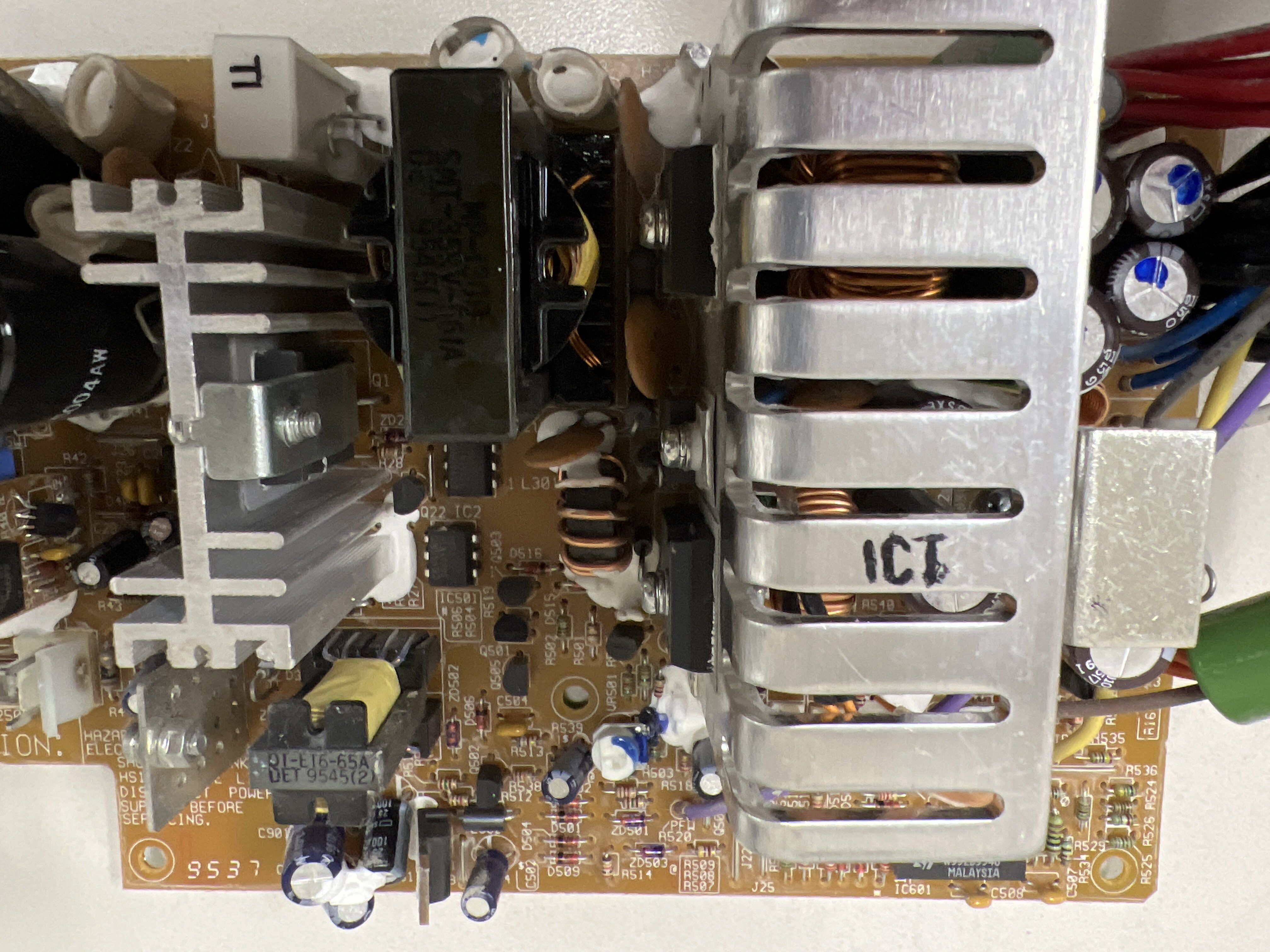

I can already see that IC1/TOP200YAI is dead, R4, the fusable resistor is blown, meaning that IC1 is dead. this is the self switching fet for the standby powersupply, what you have there is 2 PSU's, one for standby and one for power. this is a common fault, sometimes caused by an issue further down the line. i have just recapped 3 of these, and caps were all not leaky and measured OK, one unit had the same fault, R4 blown and IC1 blown. i did not find any further issues with it, as in caps all good, checked all diodes/transistors and no fault was found, ill report back once i have my replacement TOP200YAI in.
