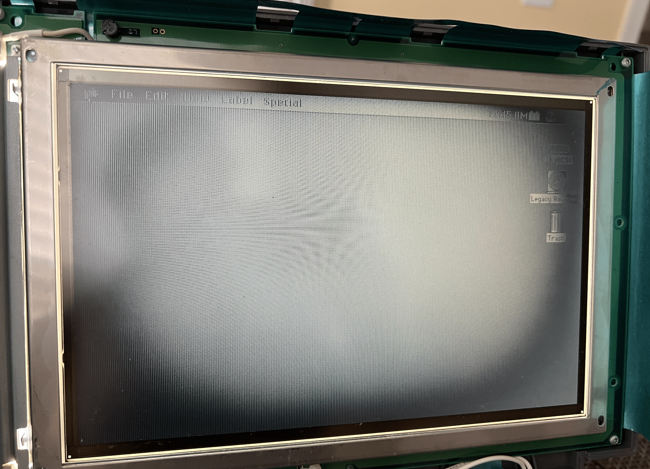

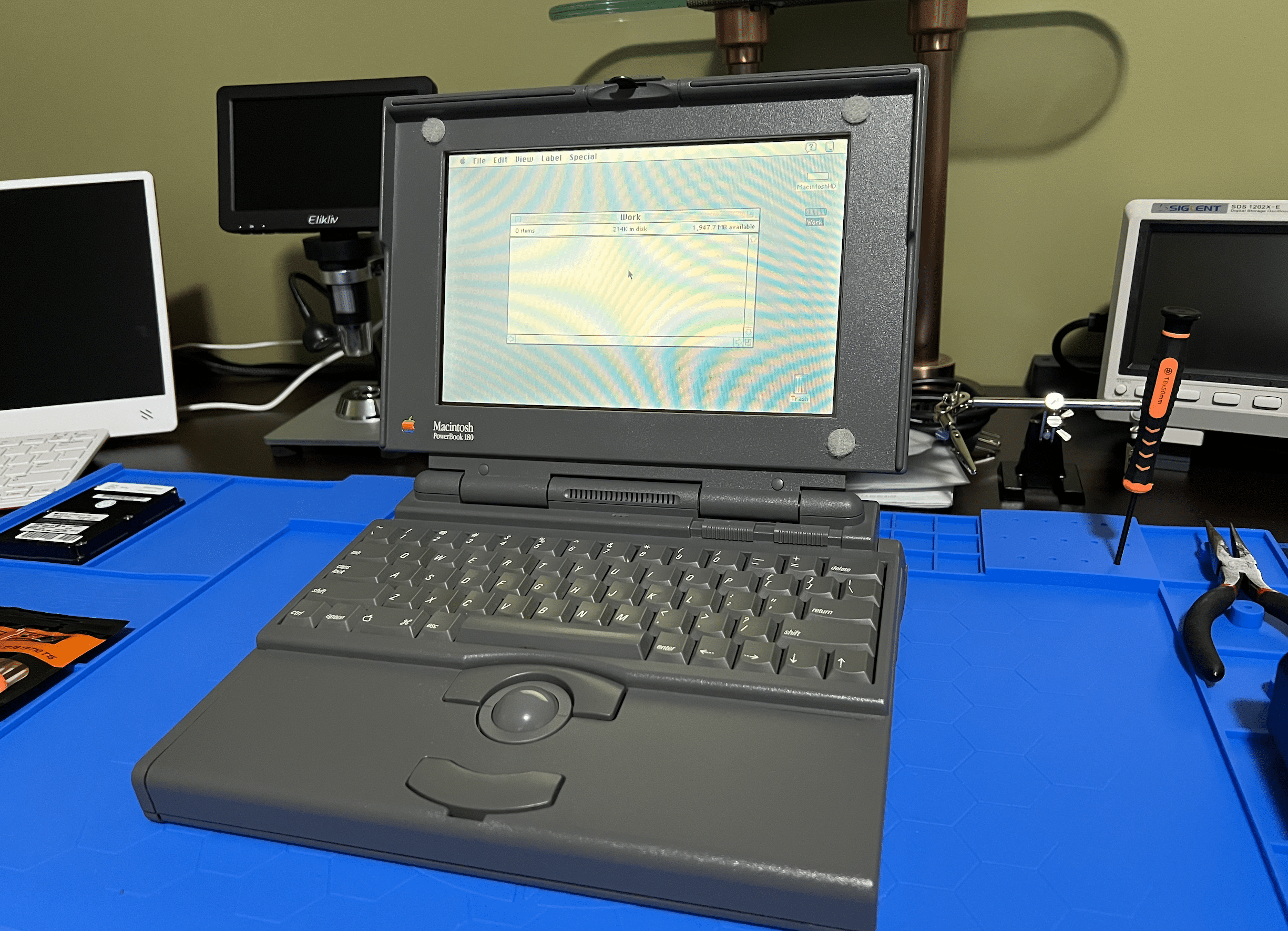

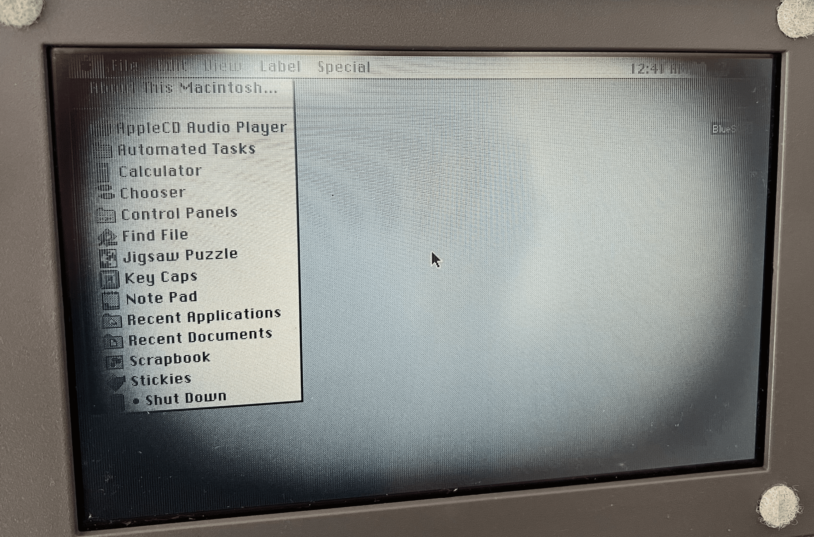

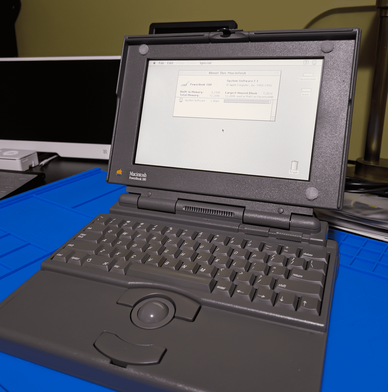

I recently came into possession of a couple of Powerbooks and started working on refurbishing them. The Powerbook 180 had a tunnel vision problem with the lcd screen as can be seen in the picture below (condition at 41 minutes after startup):

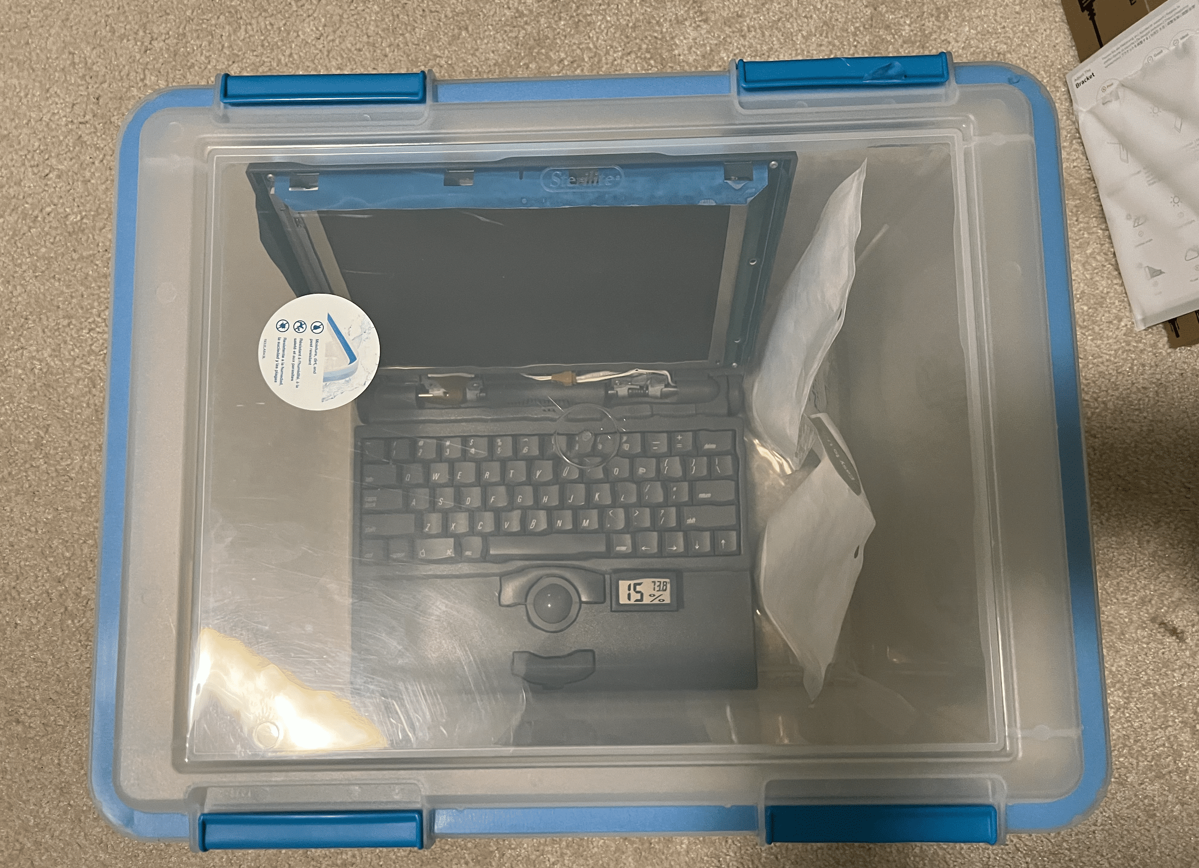

I decided to try to fix the tunnel vision issue and read some articles on the internet about potential causes. I found two potential fixes so I decided to try them in order of difficulty. First, I tried placing the lcd in a closed container with desiccants for ten days to see if that had any impact on the lcd tunnel vision. The picture below shows the laptop and lcd in a dry box with a humidity of 15% where it remained for ten days:

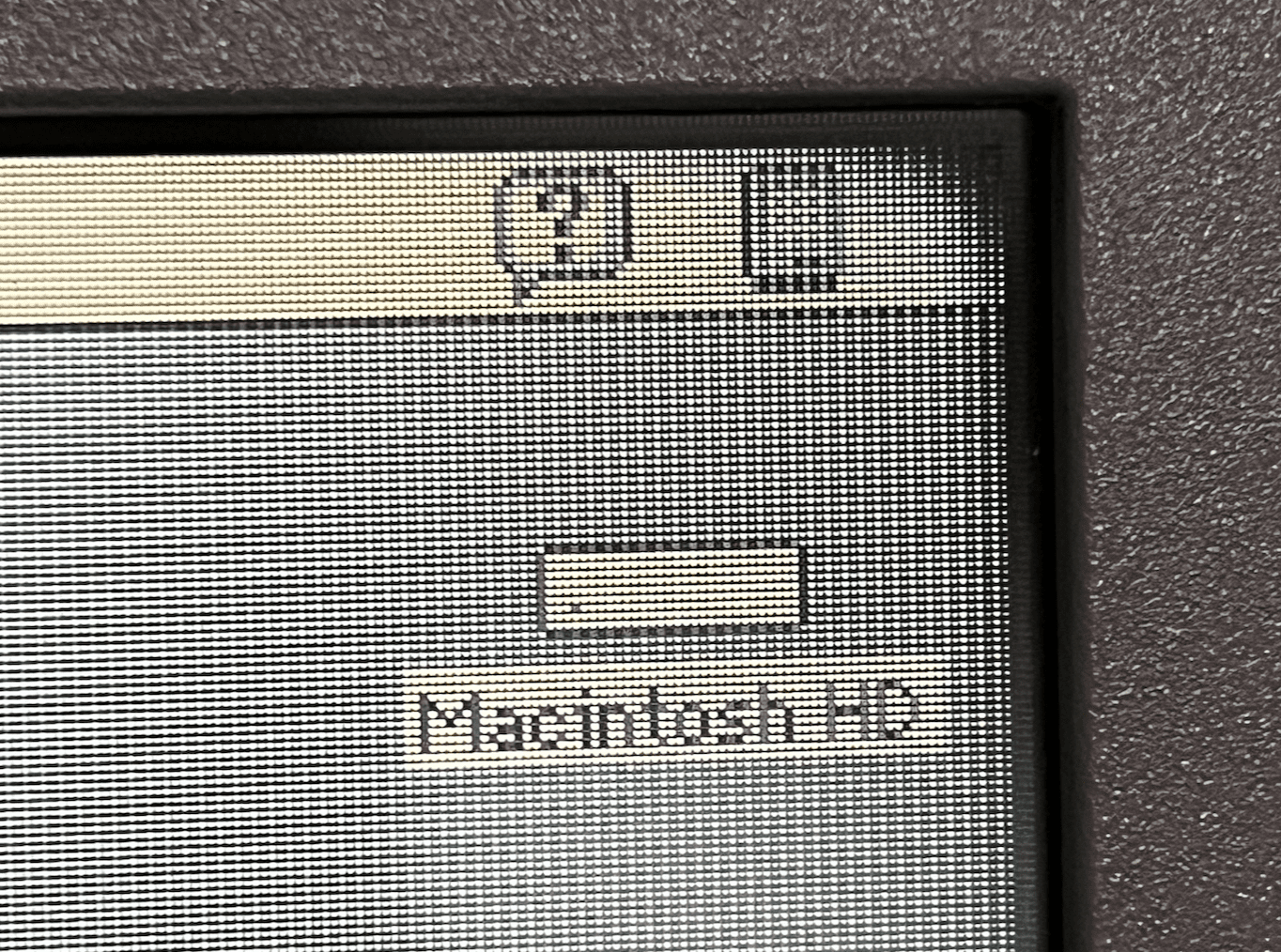

Unfortunately, after those ten days, I saw no real change in the lcd as shown in the picture below (condition at 45 minutes after startup):

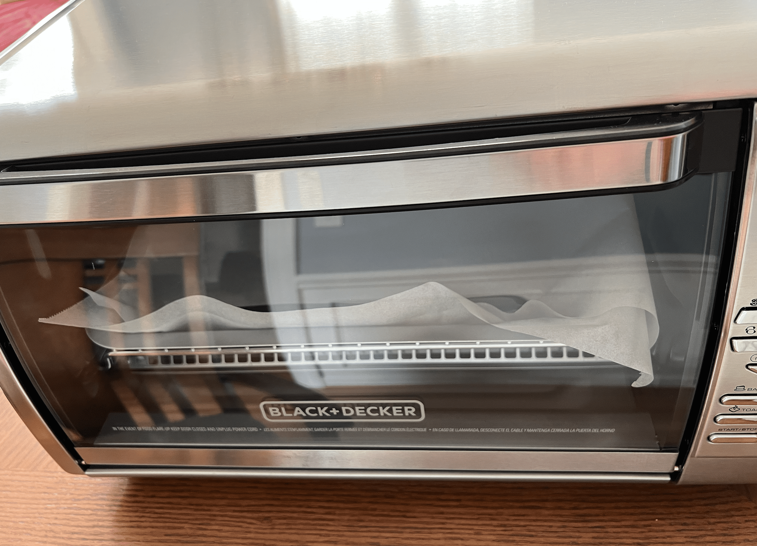

Next, I decided to try baking the lcd as I had heard that baking could possibly help with tunnel vision. I removed the lcd from the laptop. Note that the half of the metal tabs twist clock-wise and half twist counter-clock-wise for removal. Then I setup an old toaster oven that I had (I didn't want to use an oven that would ever again be used for food in the future as I didn't want to risk contaminating it.) Below is a picture of the toaster oven with tray and parchment paper:

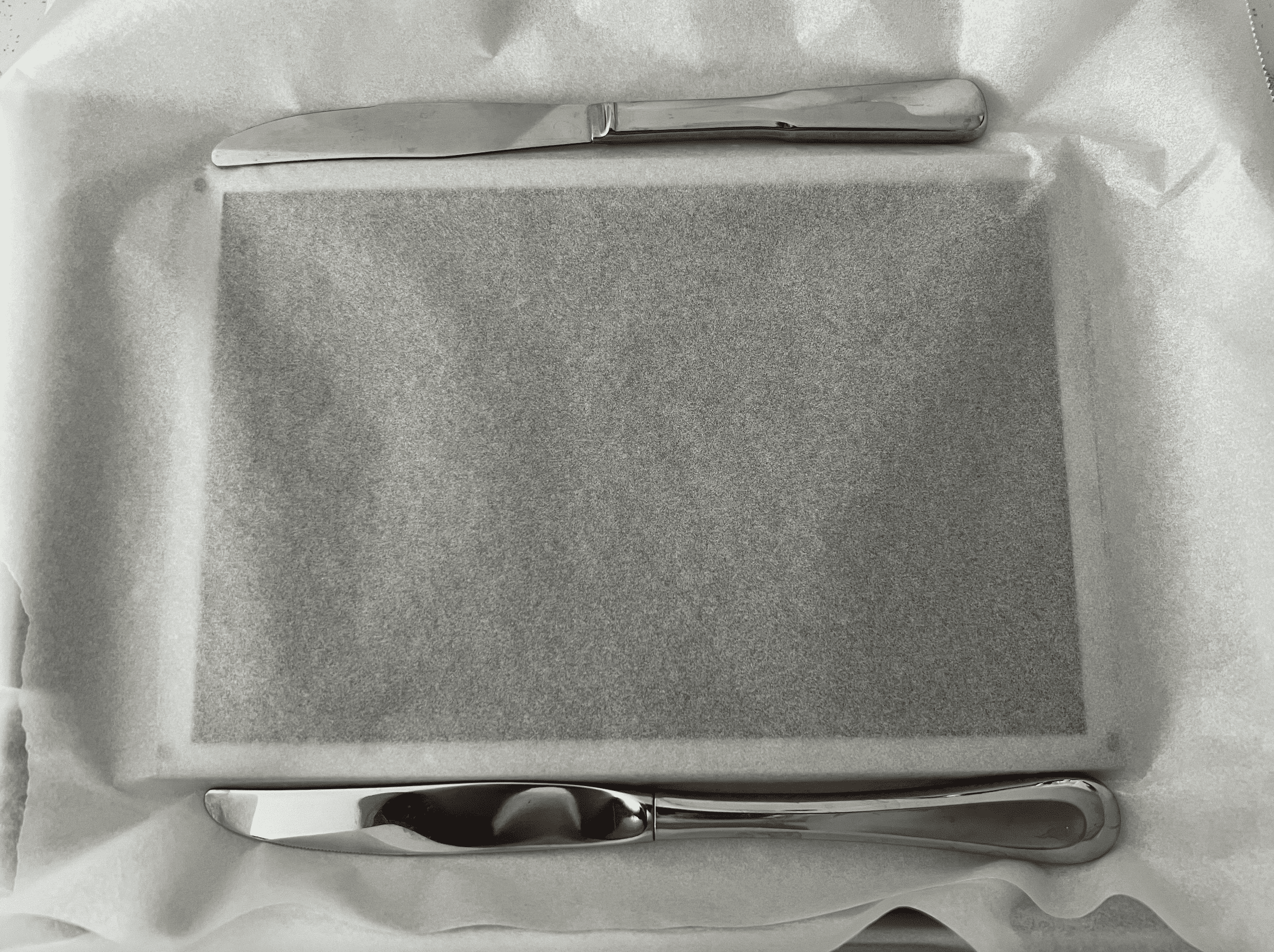

I ran a test with the toaster oven without the lcd to see how stable the temperatures would be. The lowest temperature setting for the toaster oven was 200F. I used a wired digital grilling thermometer to measure temperatures during the test. When the oven was set to 200F, the temperatures varied from 185F to 197F sinusoidally over a ~10 minute period. In order to stabilize the temperatures somewhat and prevent localized hot spots on the lcd, I placed the lcd on a sheet of parchment paper on a tray, then I placed another sheet of parchment paper on top of the lcd (neither sheet of paper touching the lcd screen.) By placing the paper on top and below the lcd, it created a pocket of air between the sheets where the temperature was stabilized to roughly 191F +/- 3F with a ten minute period. Below is a picture of the lcd and parchment paper in the tray:
Note that weights were necessary to keep the top sheet from being blown around during oven operation. I ran the oven for 5 hours with this setup (lcd experiencing 191F +/- 3F with a ~10 minute period.) The oven wasn't designed to operate for this length of time even at the lowest temperature so the exterior got hot, and I burnt my finger. After that, I allowed the oven and lcd to cool to room temperature naturally with the oven off and power unplugged.

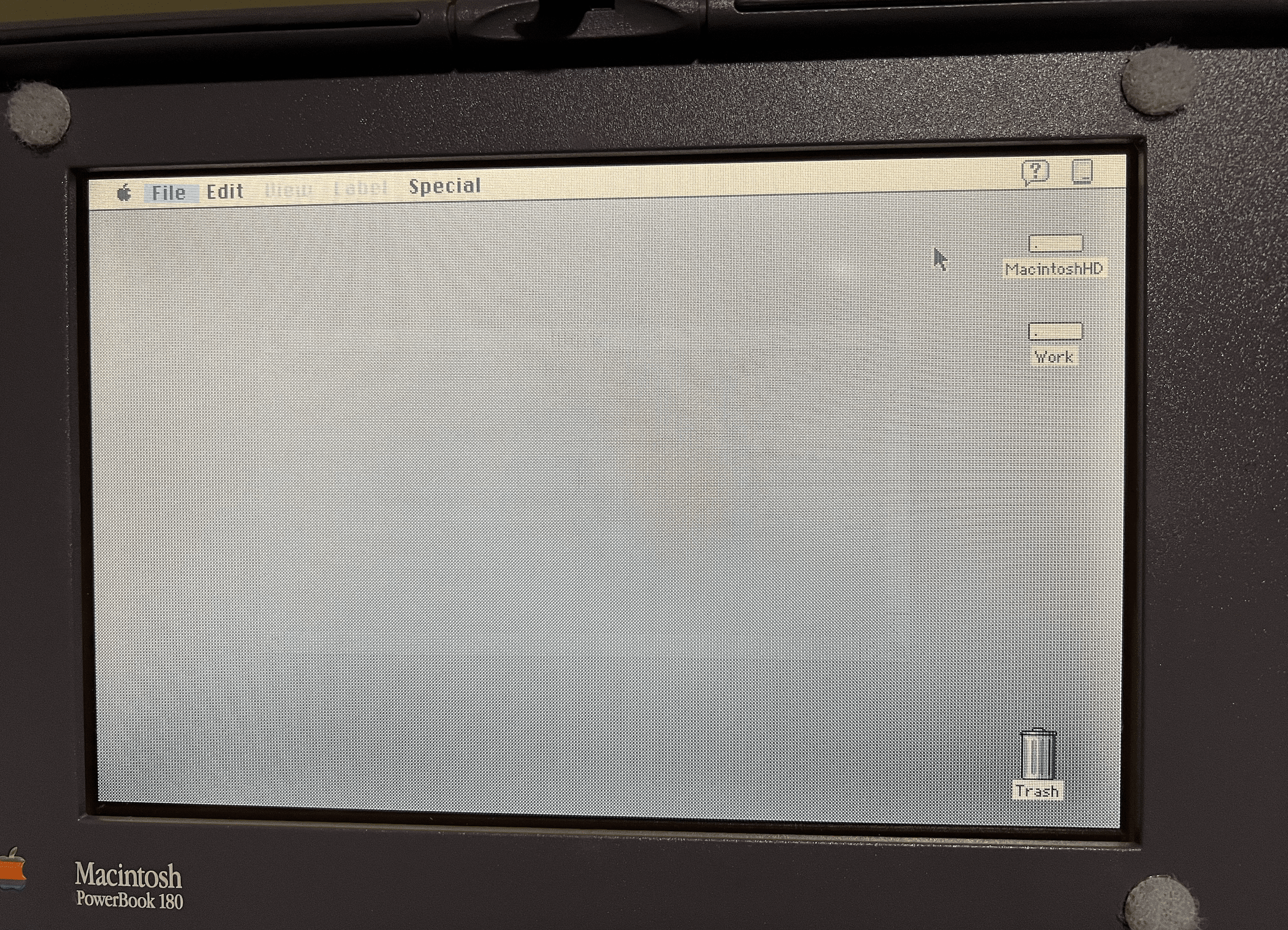

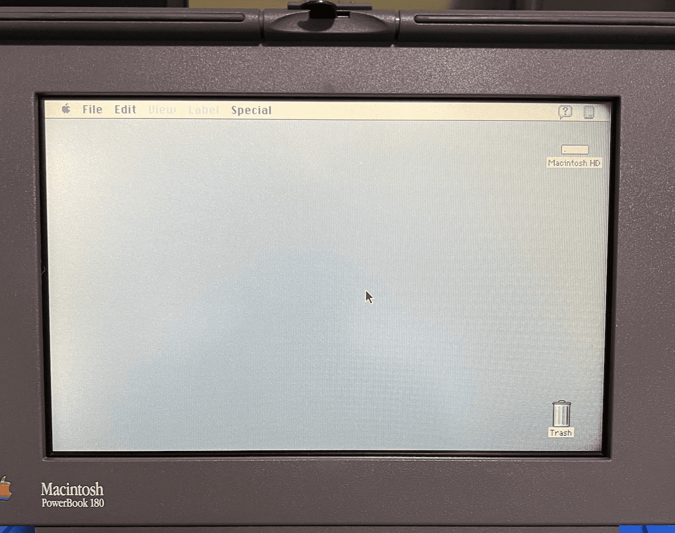

After the lcd and oven reached room temperature, I reinstalled the lcd in the laptop so I could see if there was any improvement. Note that as I mentioned before that half of the tabs twist clock-wise and half twist counter-clock-wise so there wasn't much / any slop in the positioning of the lcd during installation. Once everything was reconnected, I turned on the laptop and discovered that there was significant improvement. Below is a picture of the laptop lcd after 42 minutes of operation:

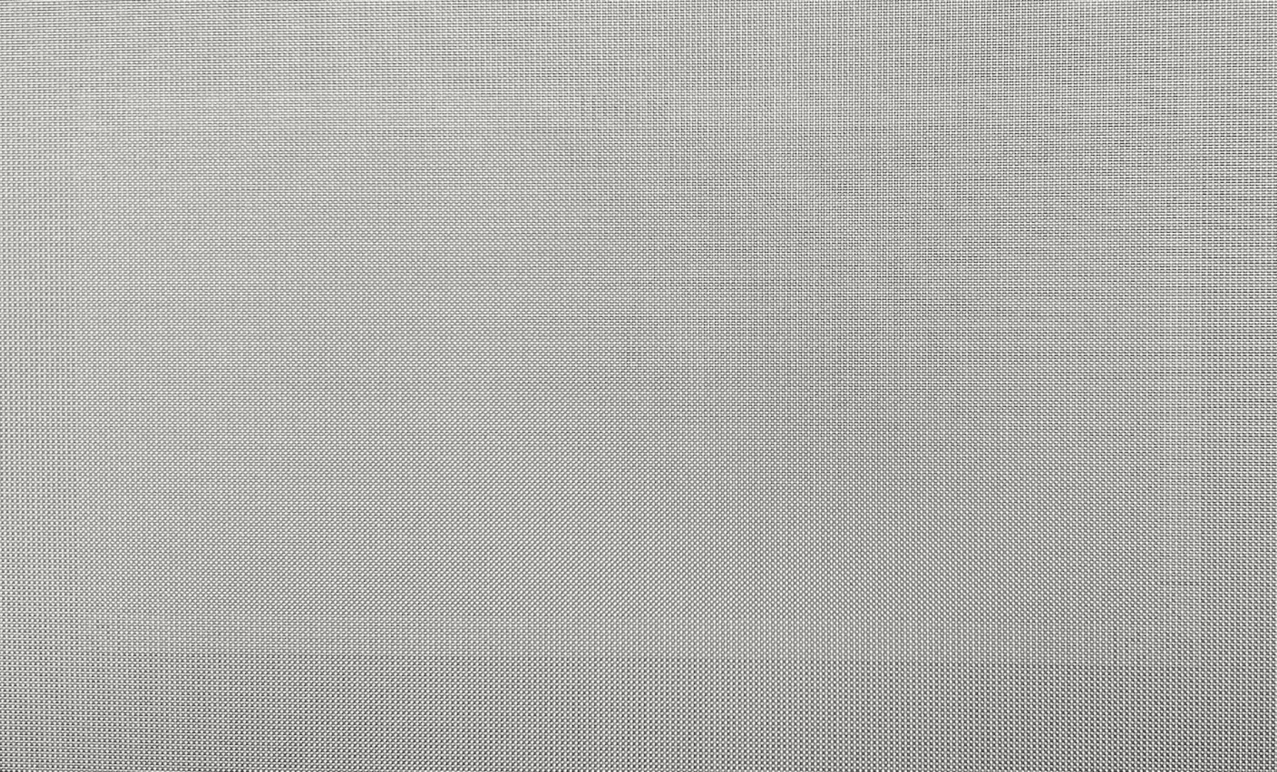

Oddly, the lcd continued to improve over the approximately 3 to 4 days after baking despite just siting in the laptop not being used. In the end, this is what the laptop lcd looked like after those 3 to 4 days (note that the interference pattern is not visible to the eye - not sure why the camera shows that):
Note that this picture is after an hour of operation.

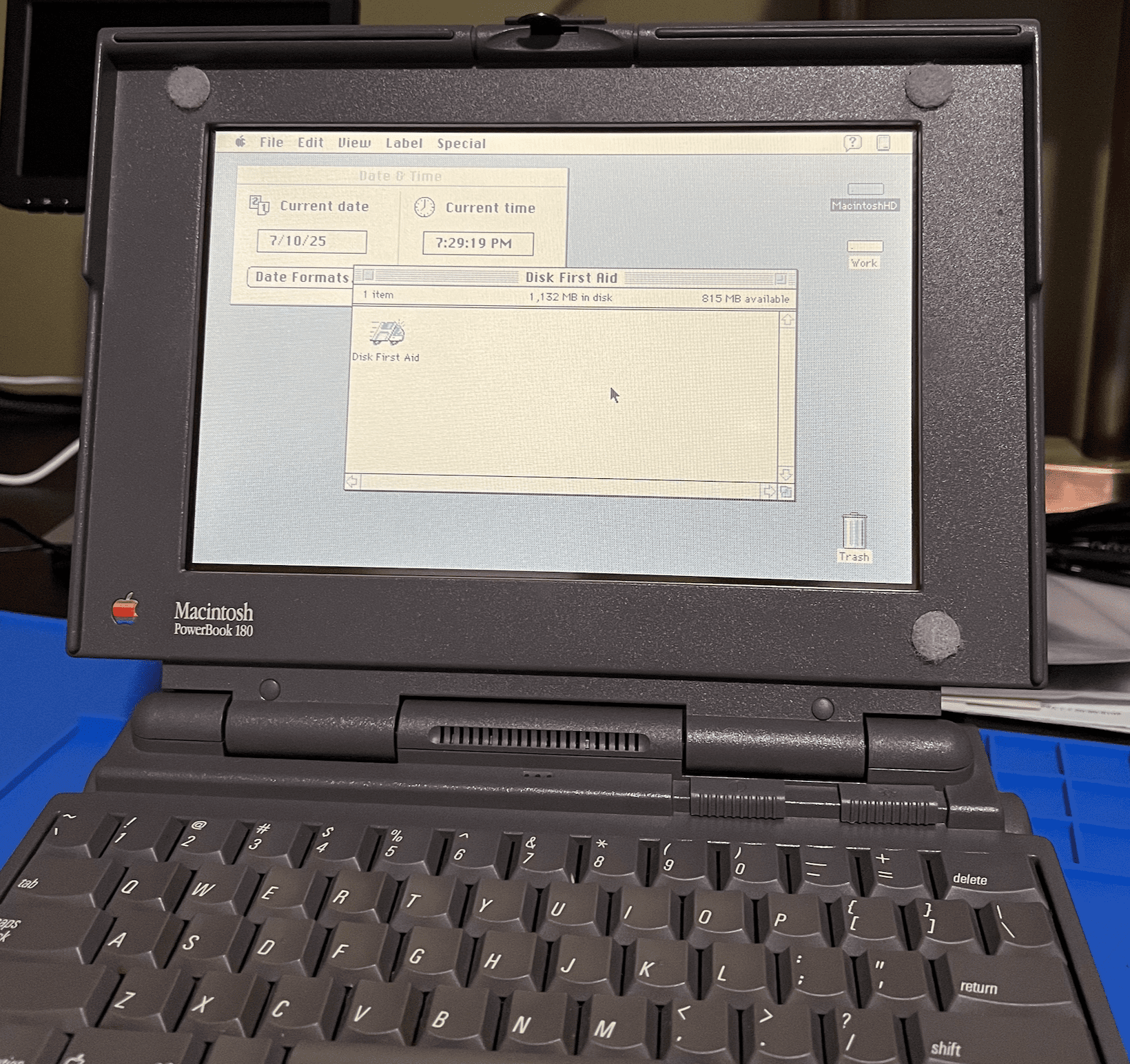

4. After the baking of the lcd, I have noticed a faint ghosting of windows that have been displayed for 40 to 60 minutes on a dark background. Is this due to the baking of the lcd or is this just the nature of some of the early active matrix displays? Barely noticeable in person to be honest and disappears fairly quickly. See the picture below for an example of a ghosted window after being displayed for ~60 minutes on a dark background:

You seem to be talking about this very faint ghost window...
How long before it vanishes completely, or does it never vanish until power is cycled?
Neo117
May 26, 2025
If you power cycle it, then it vanishes instantly. If you don't power cycle it then it takes about 6-10 minutes to disappear. It is a little difficult to get an exact time because it is so faint as it disappears. Also, if you move another window across the area containing the ghost image, it is gone, and you can't see it anymore. It really doesn't impact usage and you have to really look for it to see it, so I may be asking too much for perfection given the age of the computer.

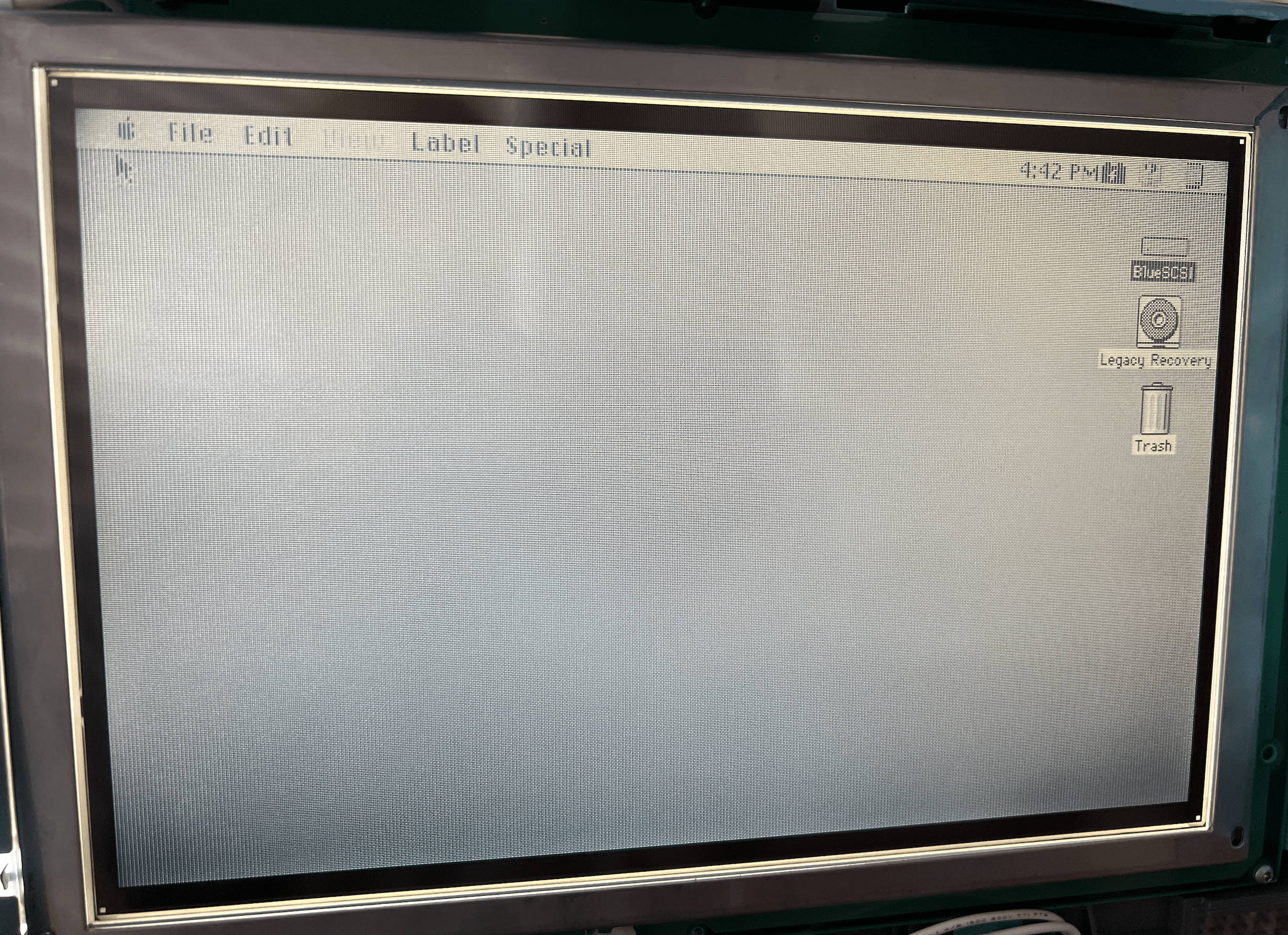

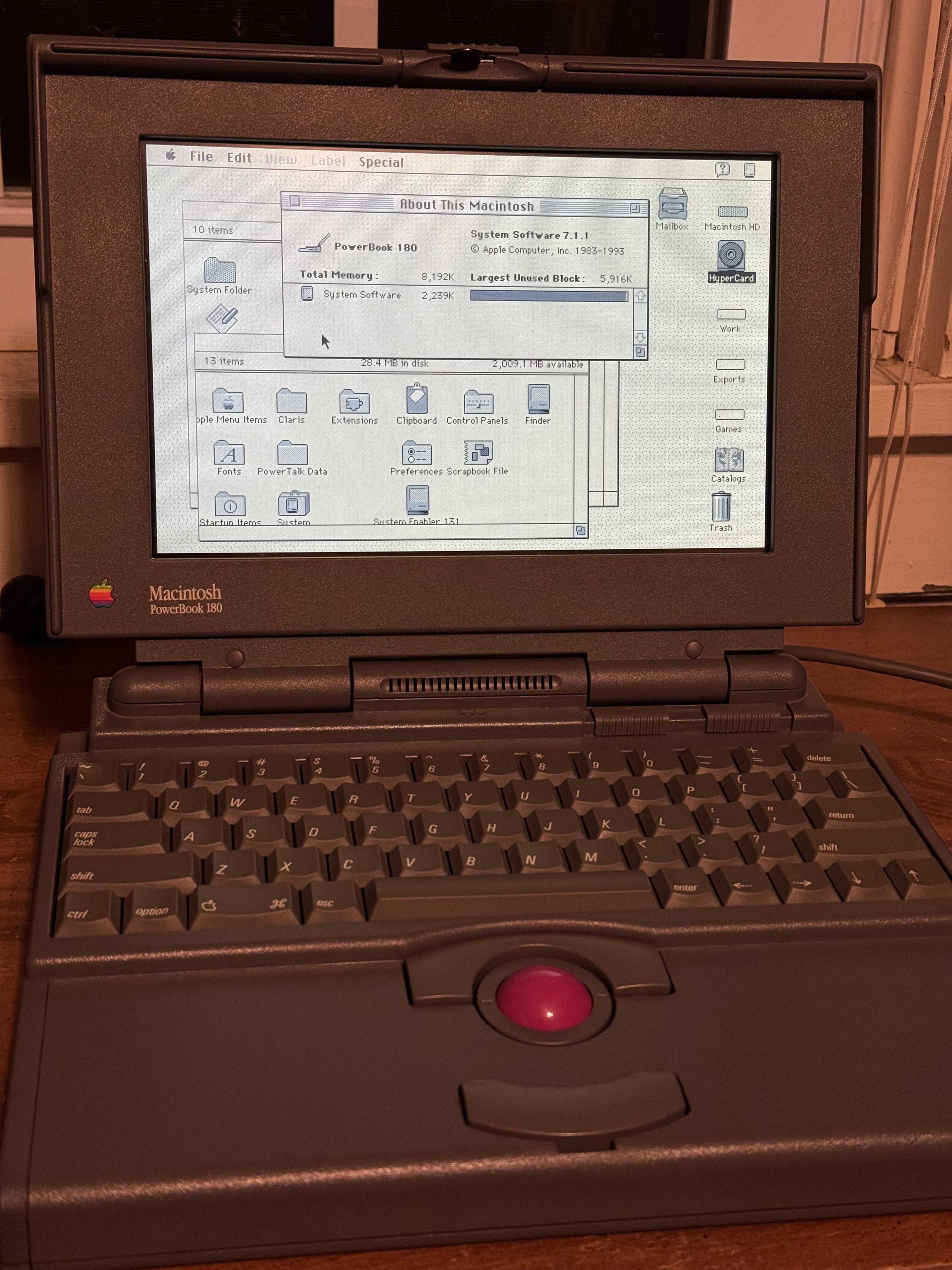

However, I think it is tied to the tunnel vision and not the baking of the lcd. I was able to look at a friend's powerbook 180 that is in better condition than this one but has a slight issue with the lcd. See the pictures below for the 2nd powerbook 180's lcd after 30min:
This is as bad as the lcd gets on this 2nd powerbook 180, and there has been no baking or desiccant treatments on it (or any refurbishment for that matter.) One thing that I noticed on this one is that you do see the faint ghosting on the very right side of the display if you leave a window up for a long time, but not on the left side of the display. As a result, I'm thinking that the ghosting may be related to the tunnel vision, but it isn't impacted by the baking of the lcd. I tried to get a picture of the ghosting effect on this one, but I couldn't get the camera to pick it up as it is extremely faint.

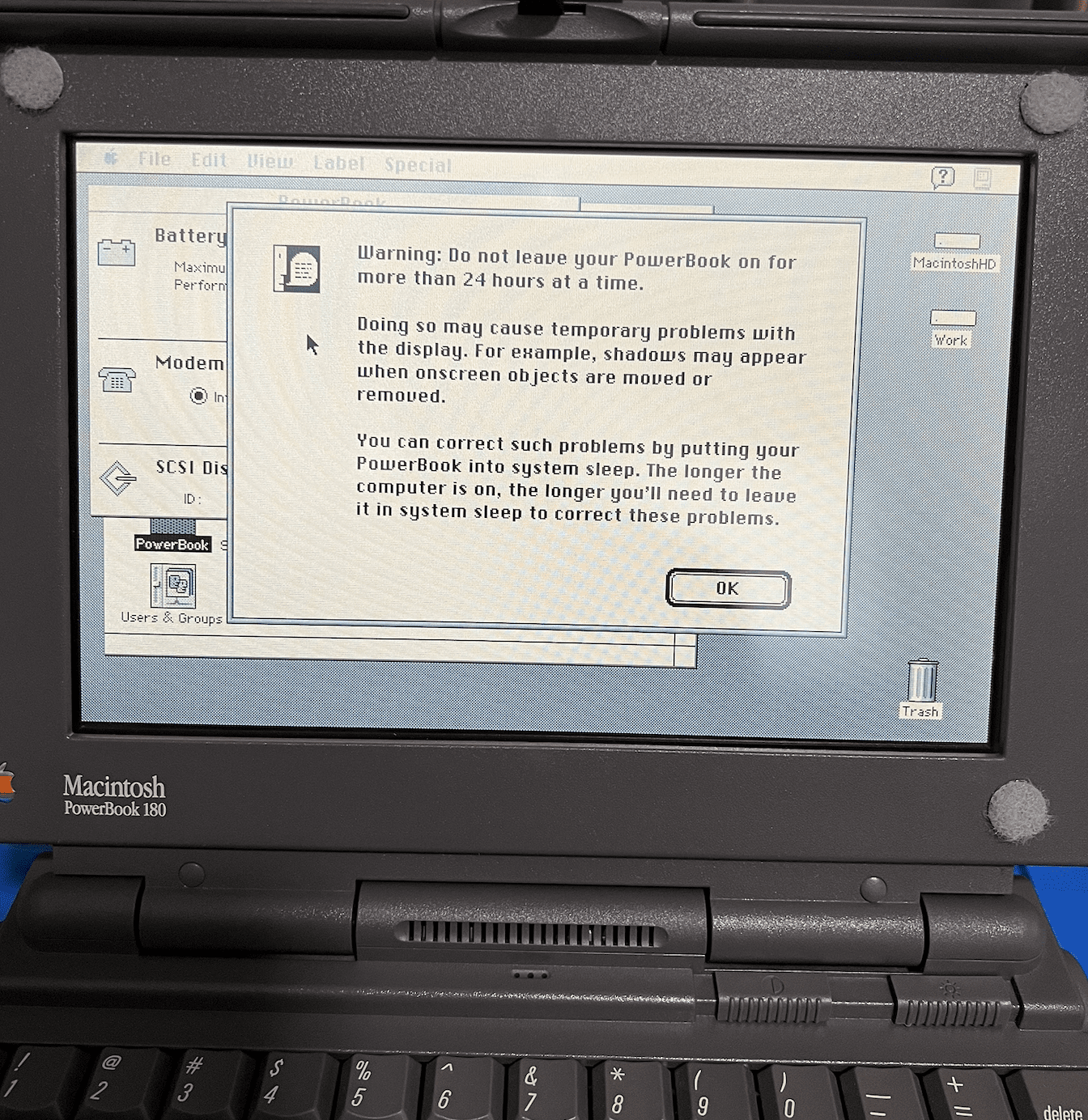

I have a PB180 with an essentially flawless display (if you look extremely closely after an hour and a half of running, you can see the faintest of faint darkening in the left corners, faint enough that it's impossible to see on camera). I'll see if it ghosts at all tomorrow. I'm fairly certain it's a normal thing for this type of display though, I believe that Mac OS actually has a warning about this built-in for the Macintosh Portable. I forget how to trigger it.
