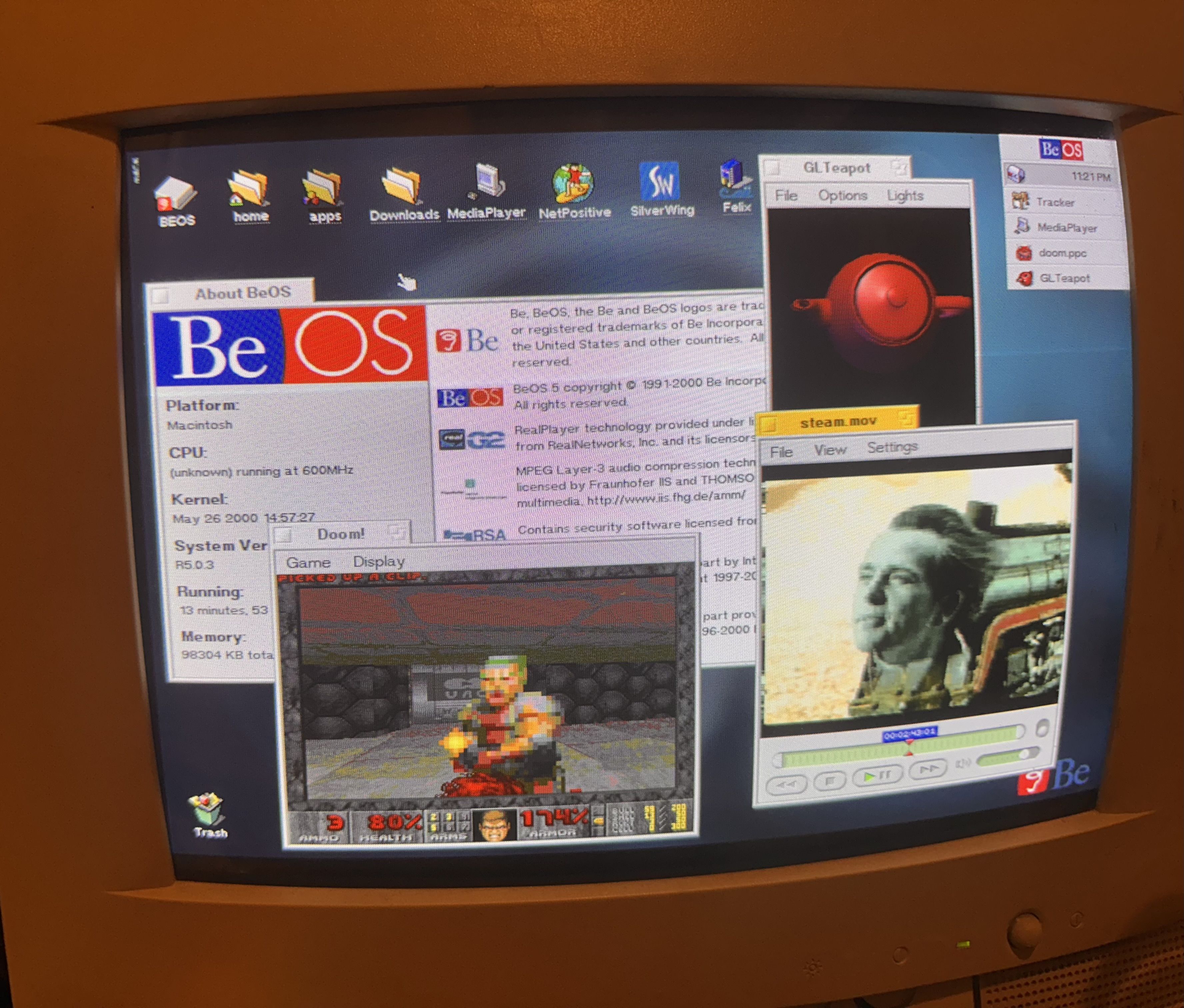

Welp I have a funny update, I decided to redo my Mac Drive to have some few other partitions, and with that had to reinstall beos and suddenly audio worked, only thing I can assume is that the third-party partition tool I used befoes somehow messed up something (i used that before bc i didn’t wanna redo my system 7 install but for this i backed it up
to my at server) that beos didnt like but uhh beos audio works now lmao

Heres a pic, also found out another quick quirk, if you ever try to install any of the forbidden be betas like bone, it will just make the partition unrecognizable by the boot loader so don’t do that lol

Pretty sure there wasn't a PowerPC version of BONE, though I'd love to be proven wrong. I think it was only ever x86 only.
