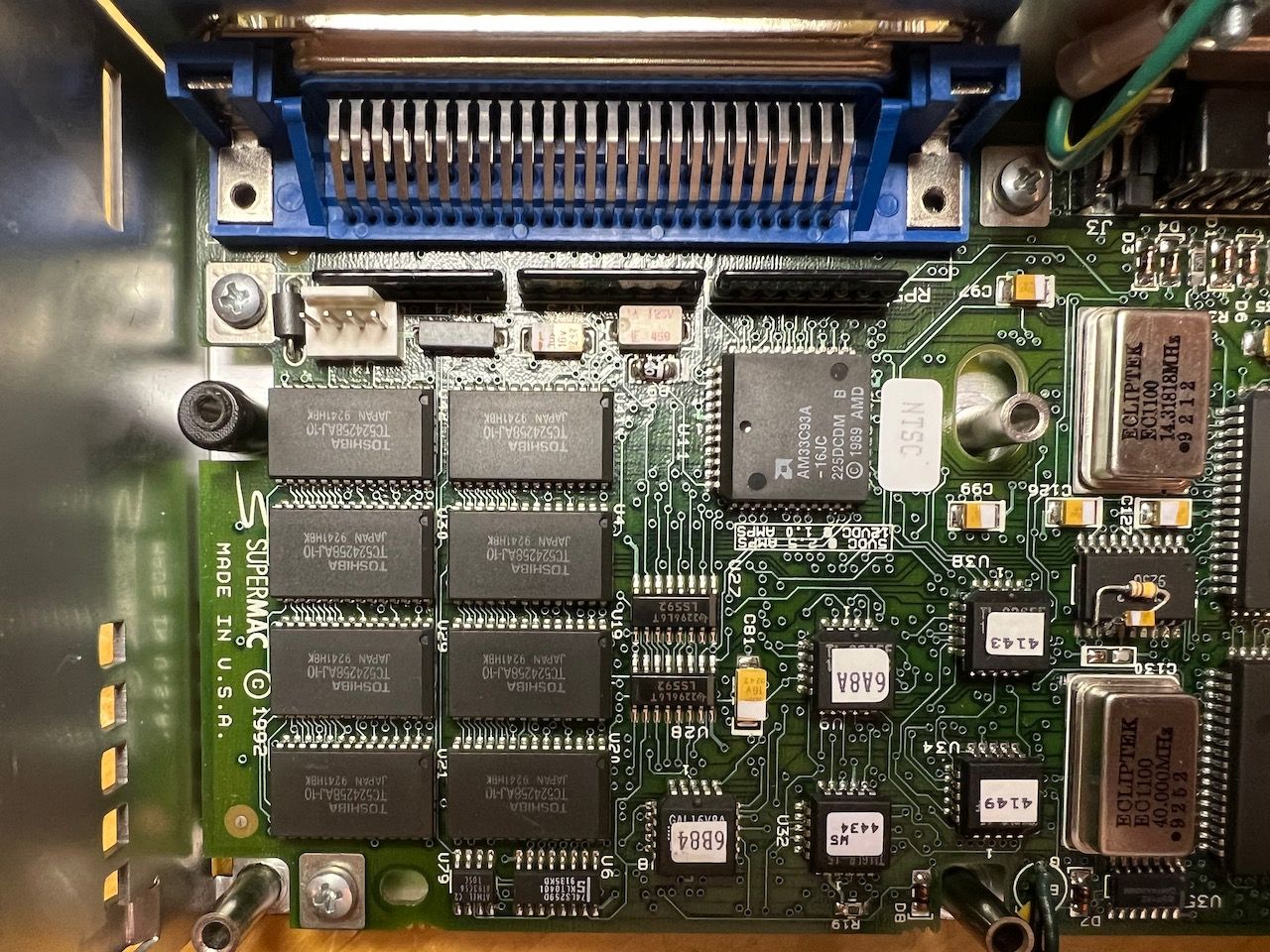

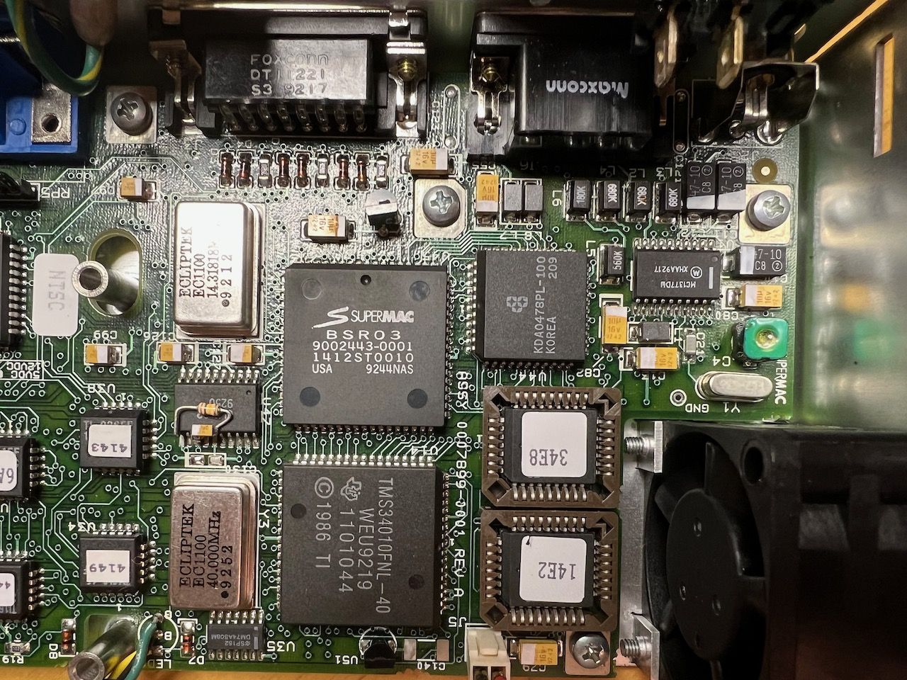

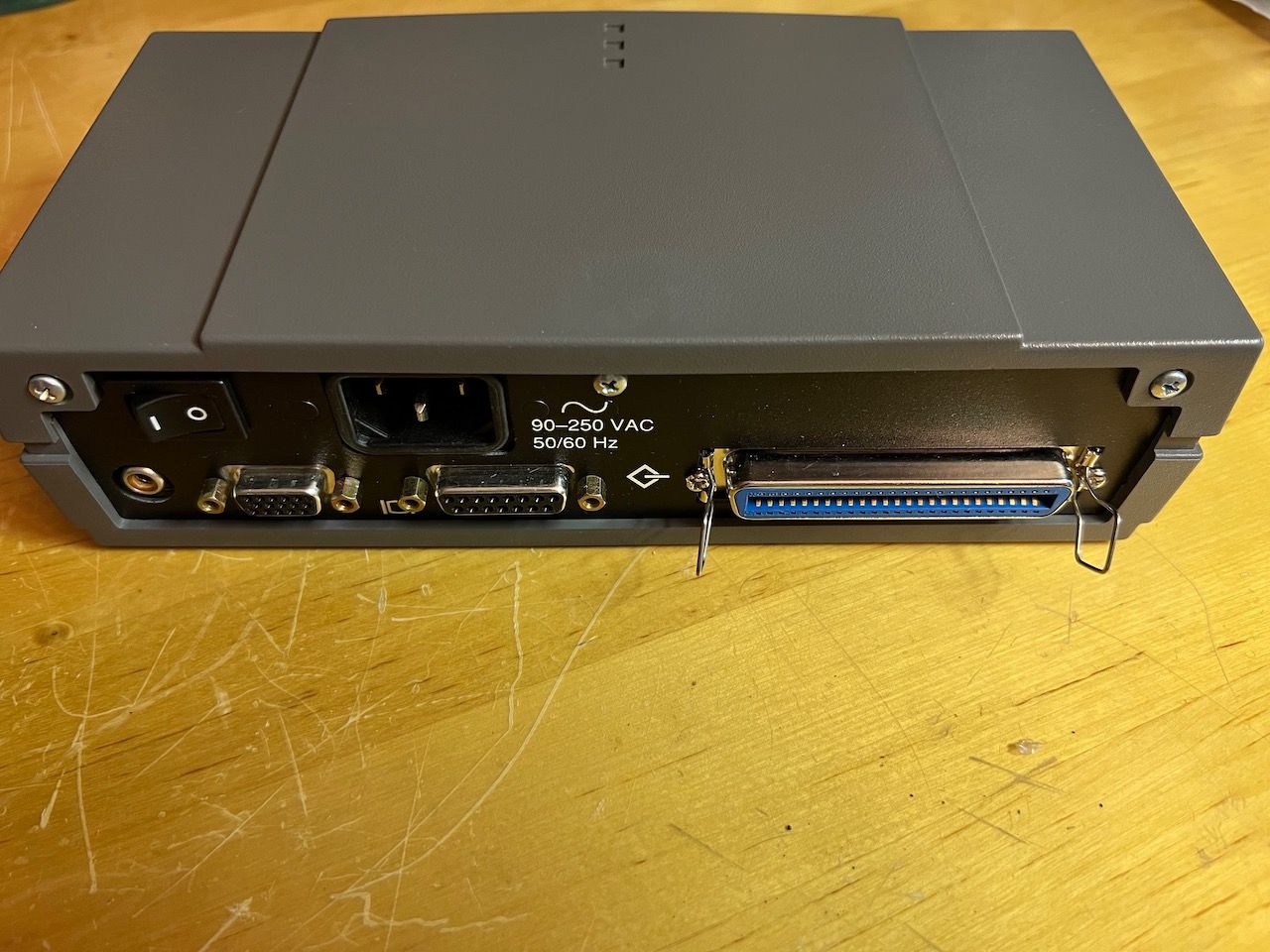

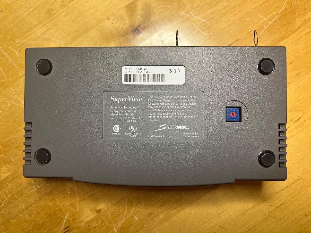

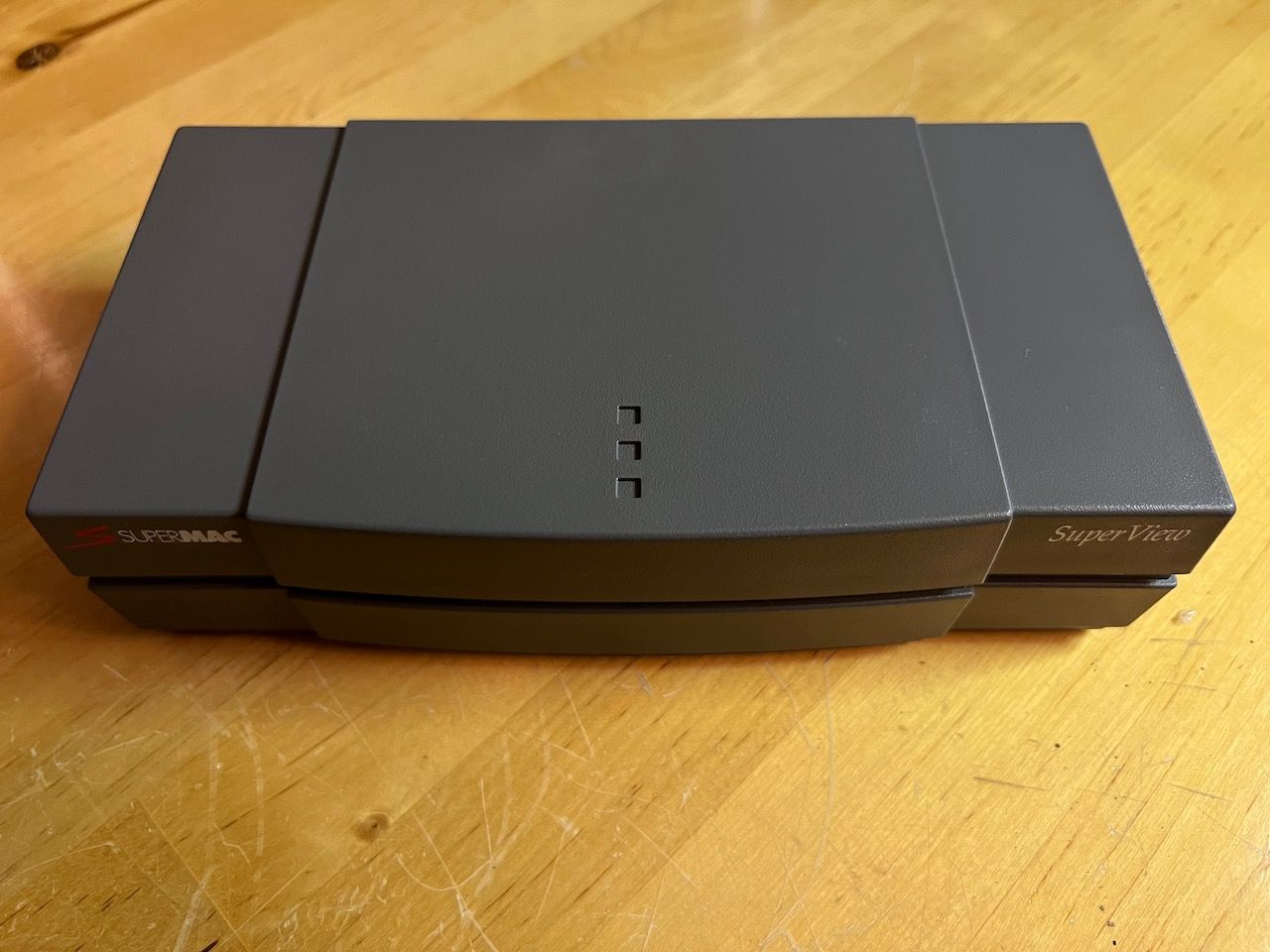

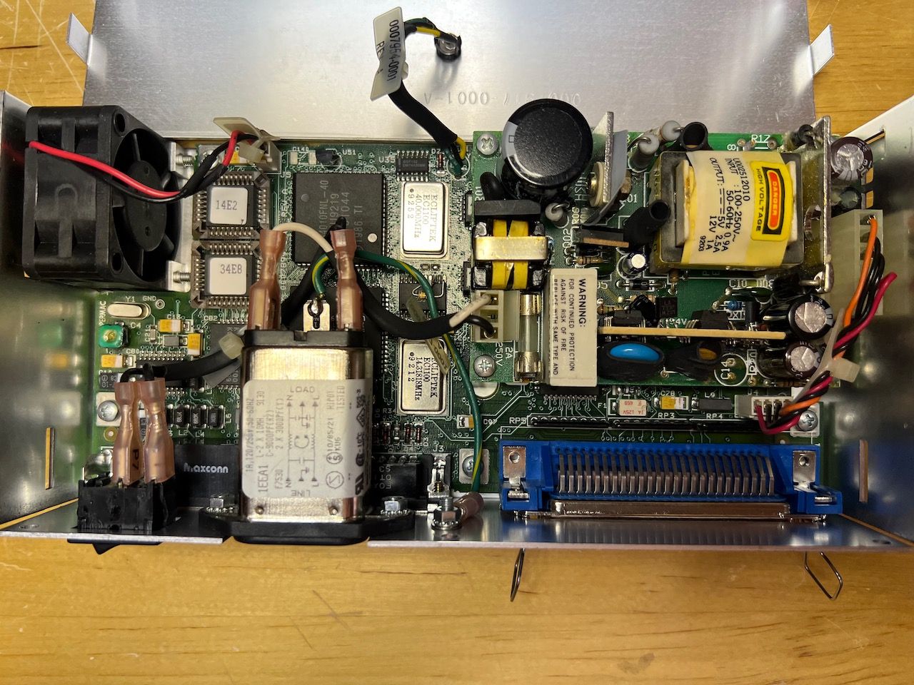

I just found almost the same product in my deep storage, but it is made by SuperMac. The SuperView! I dug up this old post since it is almost the same product.
It is interesting it only has one SCSI port with the ID selector on the bottom, internal power supply and composite video out. The manual says that it supports NTSC and PAL. It looks like this was possibly never used.

IEEE did an article on the Texas Instruments TMS34010 GPU found in the PowerView and SuperrView. See attached. :)

One interesting note of the TMS Gfx processor - The PowerView doesn't use ANY of its capabilities. The Mac does all of the video rendering in RAM, then copies the frame buffer over SCSI. They could have made the performance SOOO much better if they had actually used the Graphics chip as it was intended.
