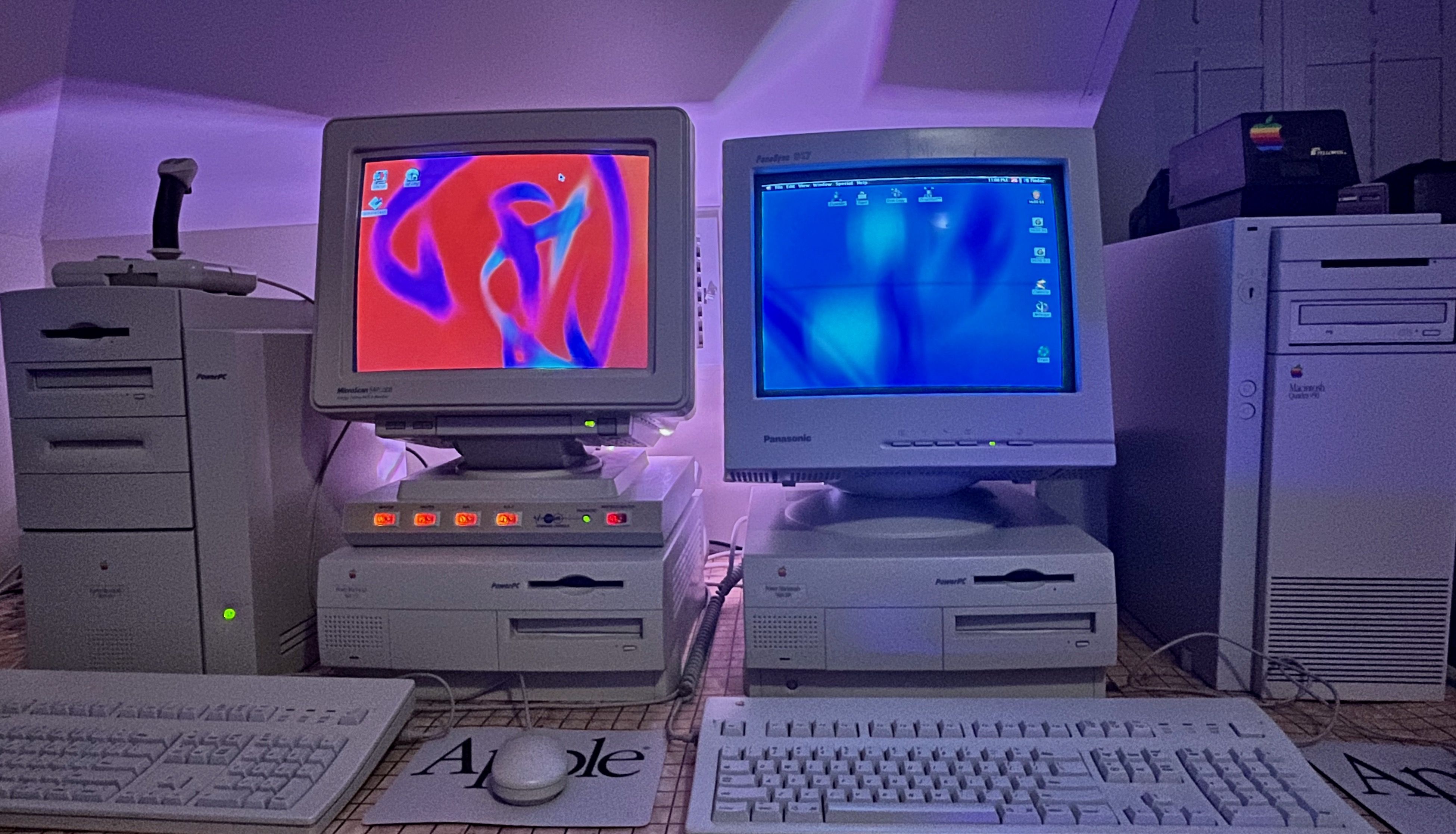

I wanted to take a moment and share my #Marchintosh2026 project that bridges 90s Mac workstation muscle with modern avian research: transforming my Power Mac 9600/500 G3 into a dedicated Nocmig (nocturnal migration) recording and analysis station.

Computer:
Power Mac 9600/350 (500MHz G3 card 320MB RAM) and BlueSCSI v2 with high-endurance SD card for 8-hour continuous 16-bit/44.1kHz writes.
