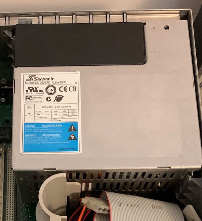

Here's my attempt at a 'stealth' IIci PSU, which uses a 250W Seasonic SFX unit inside the original housing. I even moved the Seasonic sticker across to replace the Astec one, so it looks like it's always been this way.
The Seasonic PSU has a built-in thermometer sensor so the fan speed is controlled from that.
Since replacing my PSU, I've had no issues with soft power - it acts really fast when the ADB keyboard power key is pressed, just as it should.

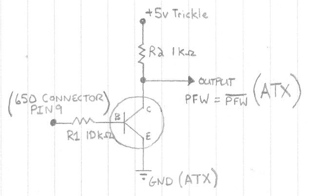

The soft power circuit I used:

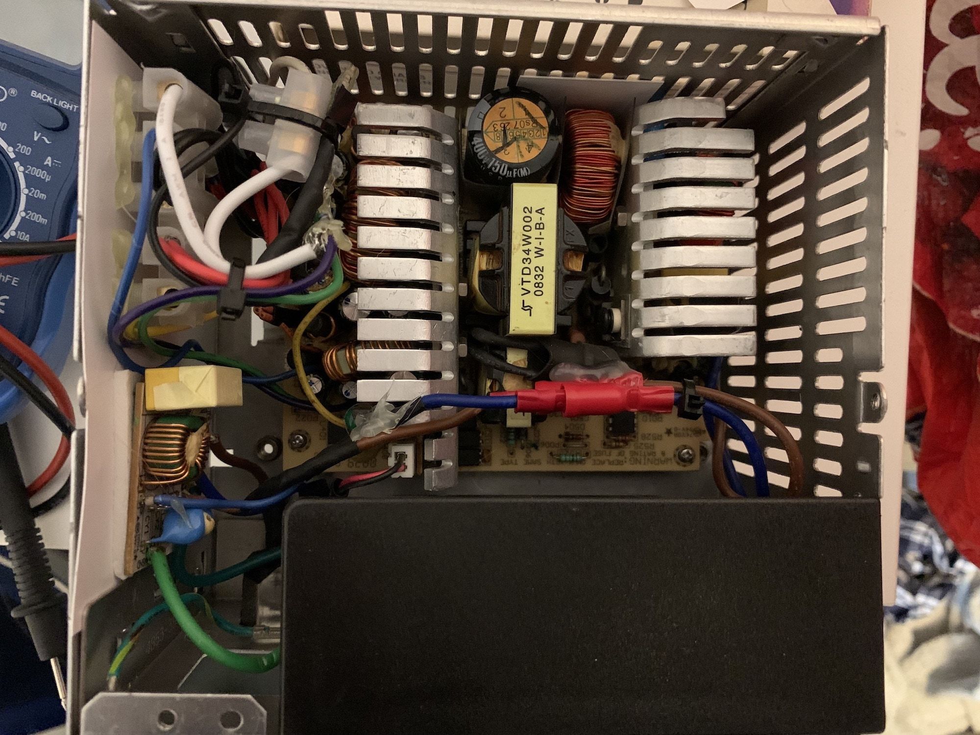

My original PSU:

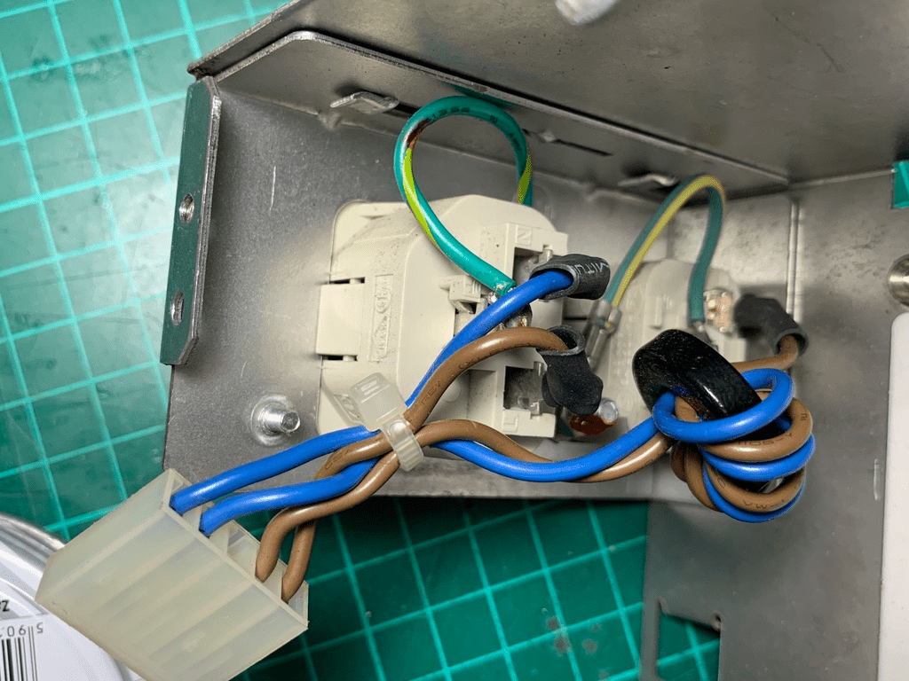

The Seasonic had its own filtering on the back of the AC socket, so I moved this across to the Astec housing.
The original Astec sockets were removed:

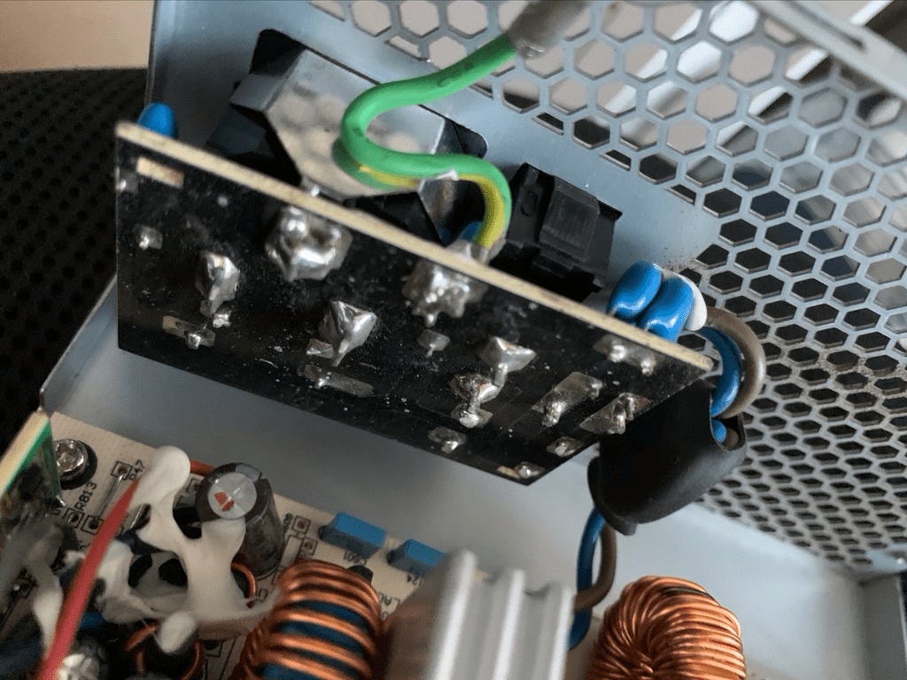

I installed new stand-offs into the bottom of the Astec housing. Went through two drill bits doing that, oops. But this meant I could dispose of the Seasonic PSU housing and just keep the Seasonic PCB and move that into the Astec housing.
Here it is all wired up to the original motherboard connector:
And all done, you can't tell anything was ever changed.

Yup. The drilling was the hard part, I used a decent Bosch drill but I guess I was using the wrong drill bit as it was really hard to get it through the metal case.

I noticed that the small circuit of the transistor is exactly the same as the Beezul-bulb we made earlier. I made it to control a Bi-color LED for Blue SCSI.
