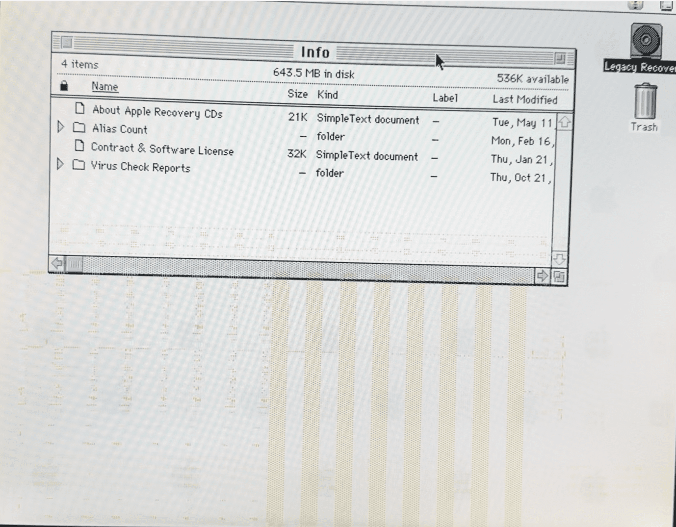

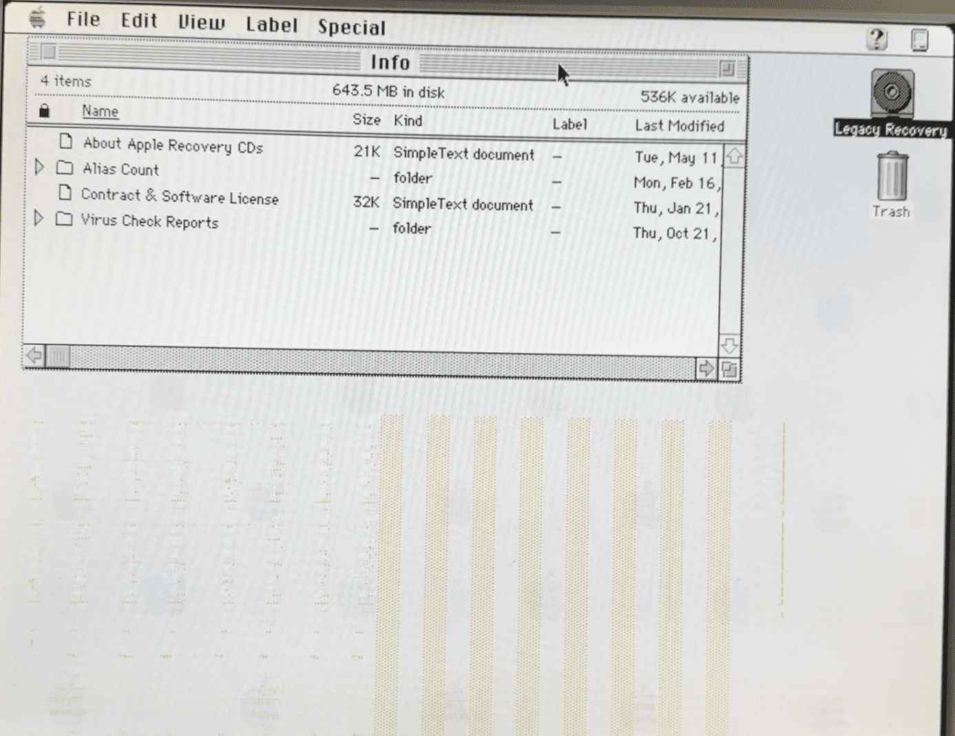

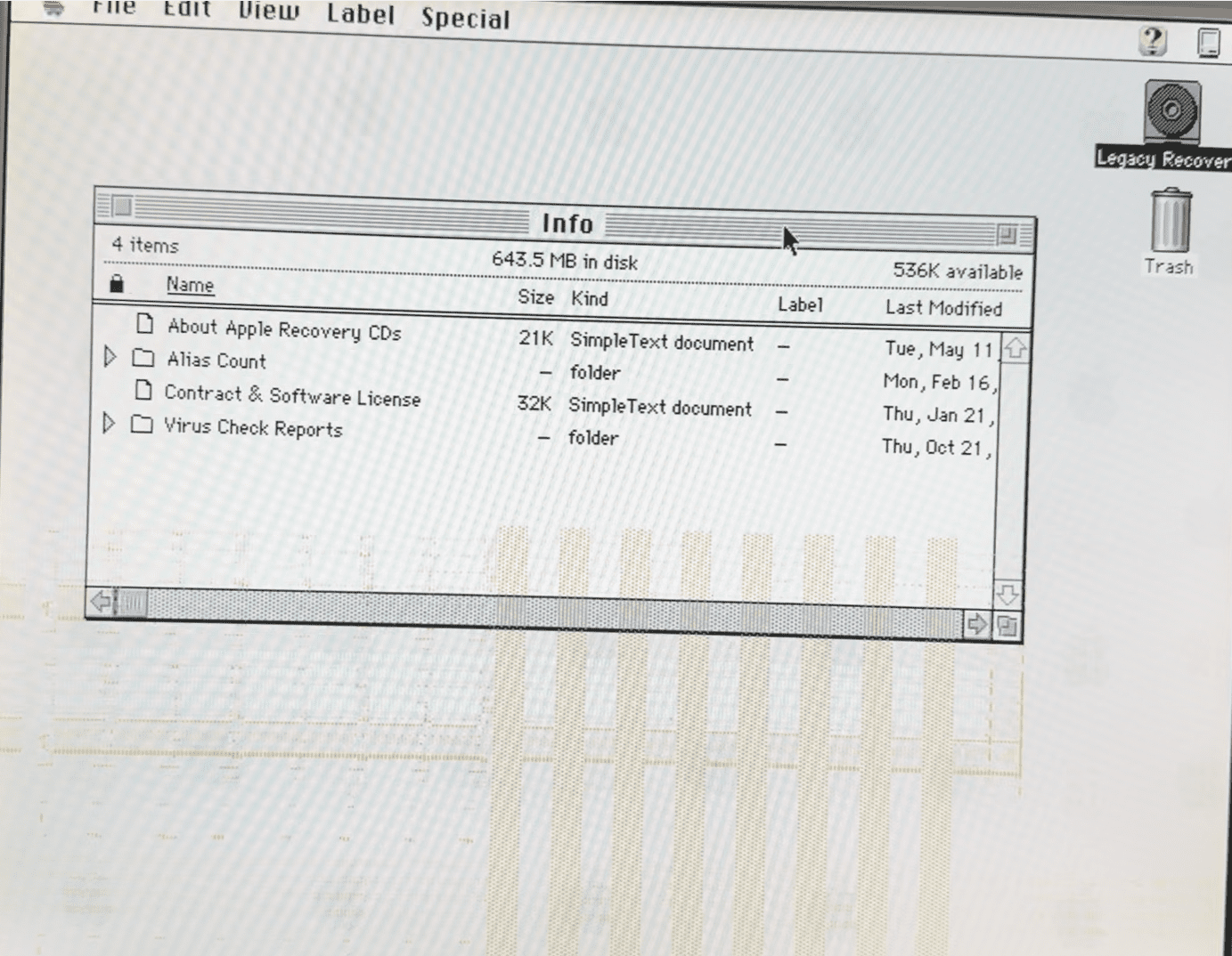

I have a Q610 whose lower video is corrupt when running in thousands of colors. Interestingly, dragging a window from the bottom to the top brings some of the corruption with it.
Here is what I've tried in the last few weeks:
1. Different VRAM - no change. I even bought new "purple" VRAM.
2. Continuity checks for VRAM SIMMs and chips - nothing broken. I checked between VRAM and CLUT, VRAM and djMEMC and the bus transceivers U20, U23, U24, U25.
3. I got a cheap USB 24mHz 8 channel logic analyzer, so I hooked it up to all pins on the VRAM SIMMs. All +5V and grounds are working, and the rest have changing signals. I also hooked it up to the CLUT and the PD pins all have signals on them. I suspect my logic analyzer may not be fast and big enough to a useful, decodable signal but I'm new to logic analyzers so I'm not completely sure. I saw enough to see changes in signals everywhere however.
4. MacTest shows onboard VRAM is fine - when testing with no SIMMs. The VRAM test fails with SIMMs.
With SIMMS:
Video RAM Failure at address $F9080200!
Failed data pattern = $FF0000!
The only thing left I can think of is that U25 - which I had to replace because it was taken out with a cap - is somehow out of spec. But since the machine otherwise boots and operates normally I'm thinking this probably isn't the case. If I'm not mistaken it handles D0-D7.
Does anyone have pointers on what else I could try to fix this issue?

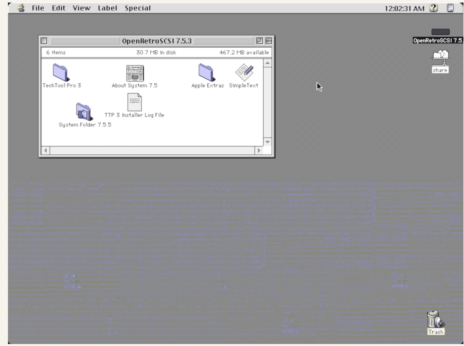

The image has the corruption in it, so it looks to be the "data in" side of things.
thanks for the pointer!
iigs123
Oct 13, 2025
6
The screen shot I posted was captured on the Q610, then displayed on my macbook. I couldn't save as JPG or something else, so I took a screen shot of that screen shot. :/
