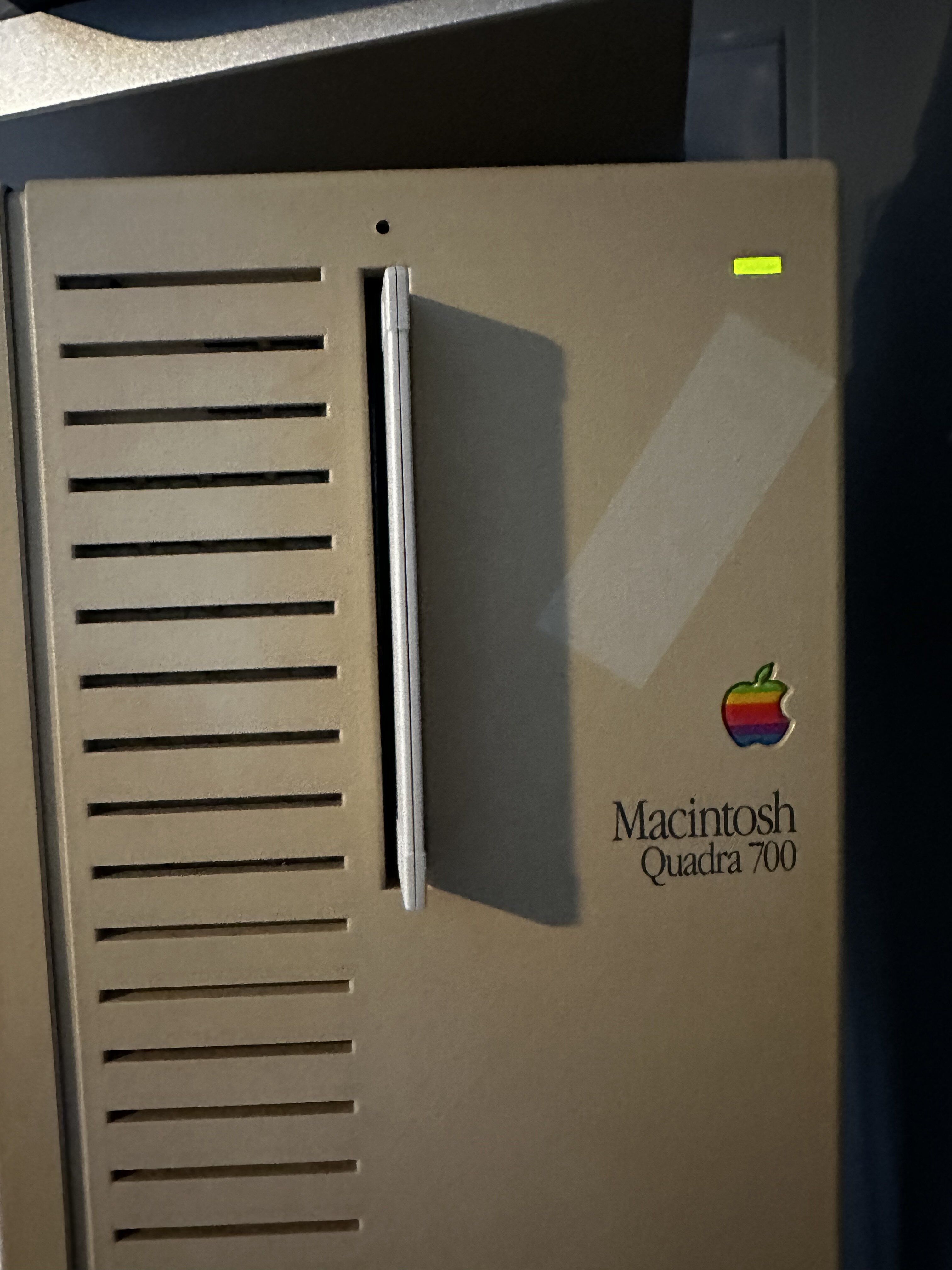

My Q700 is green (I had to turn it on to verify) but amber or yellow seems appropriate too.
That is the power LED :)
The HDD activity LED is in the opposite top corner in the groove.
I guess its actually the light pipe for the LED, on the inside of the case mine looks like this:
I think the light pipe itself is sometimes missing or broken.
