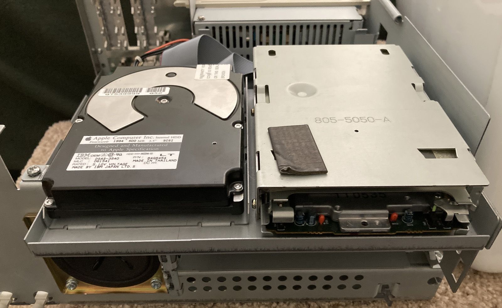

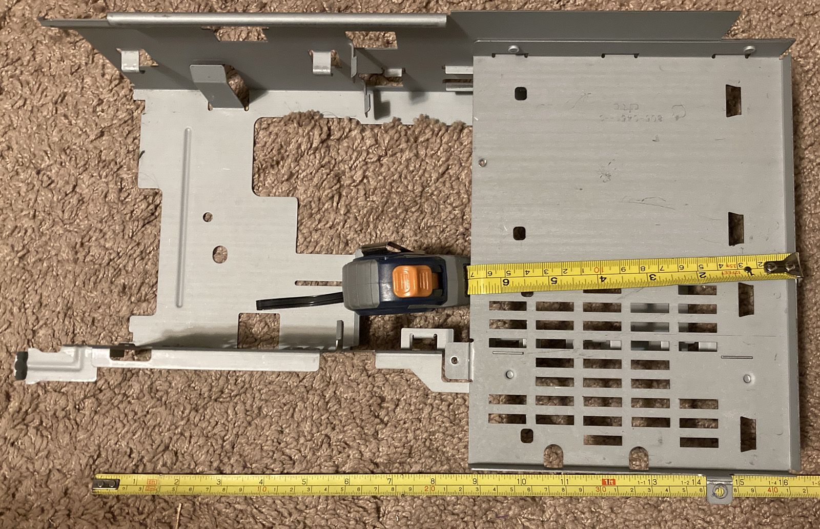

It may not be perfect, but it'll get the job done. Now I just have to finalize the design of the floppy drive sled and print it.
jimfrob
Mar 21, 2023
30
29

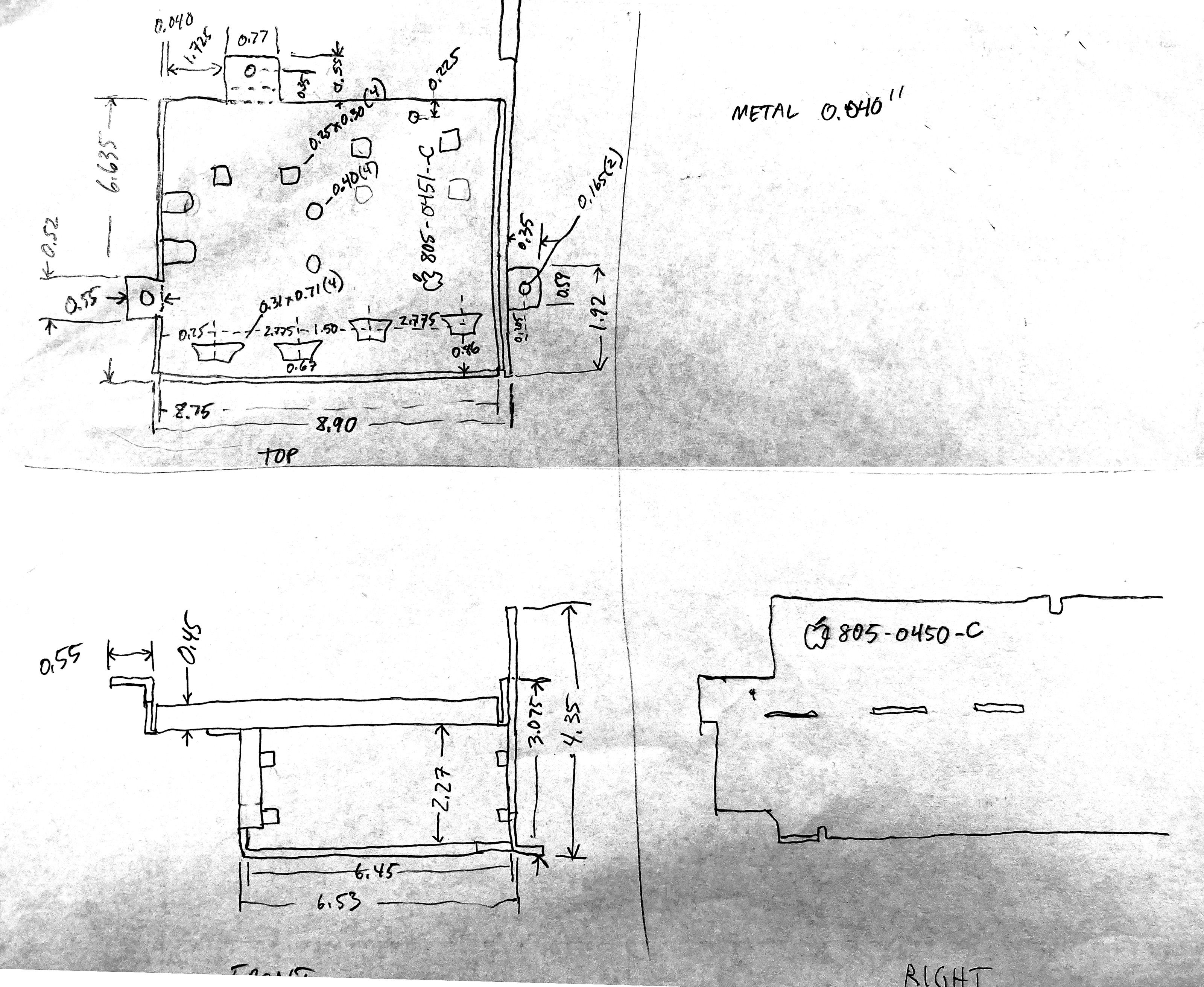

I'm now fully up & running with the floppy drive. Thanks again to @phunguss for providing the measurements that got me where I needed to be. If anyone is interested in my design files, let me know and I'll upload them to GitHub. My design for the floppy drive sled probably won't work for everyone because I'm using a floppy drive that I had just lying around (not the original for this computer).
As a bonus, iterating the floppy drive sled until I got it just right finished off 6 filament spools that had hardly anything left. At least I was able to use them for something.
