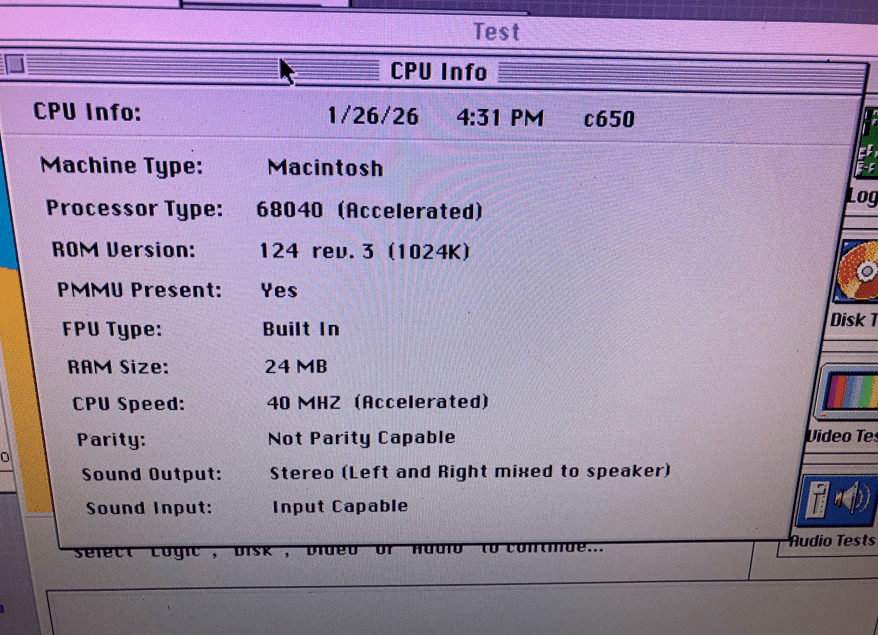

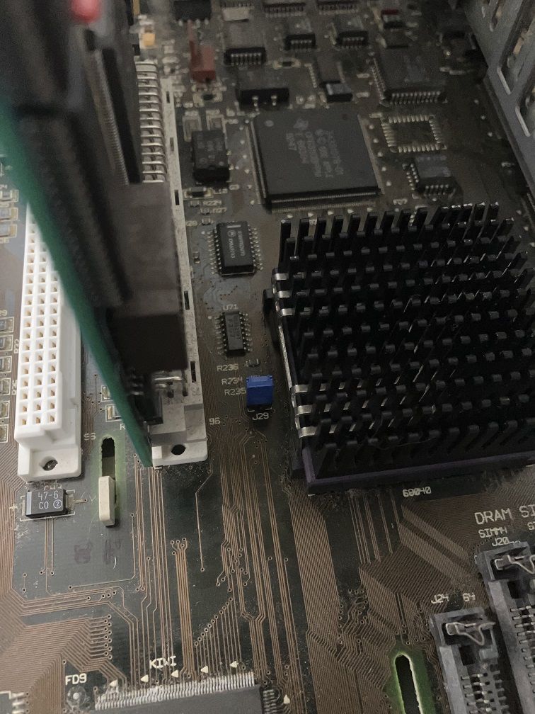

Worked first try! That was super easy, thank you! Trickiest part was getting the jumper in without it falling out :) but got it.
Excellent news - that was quick :) Your Centris should now be just a hair faster than a Quadra 840av!
What System version are you using? Did you use my System Enabler?
What type of jumper did you use? Do you have a picture of the jumper you fitted?
It is just a regular 2-pin header. That picture was with System 7.5.3 which I was able to run overnight without crashing. The CPU gets hot but not too hot to touch.
I just tried your enabler on a 7.1 Disk Tools floppy, and it seems to work fine. I got a "bad F-line trap" bomb when loading the desktop (after Welcome to Macintosh) the first time but it worked the second time... I don't think there's anything wrong with your enabler though, might have been a fluke or maybe my overclock isn't as stable as I thought... will test more.
