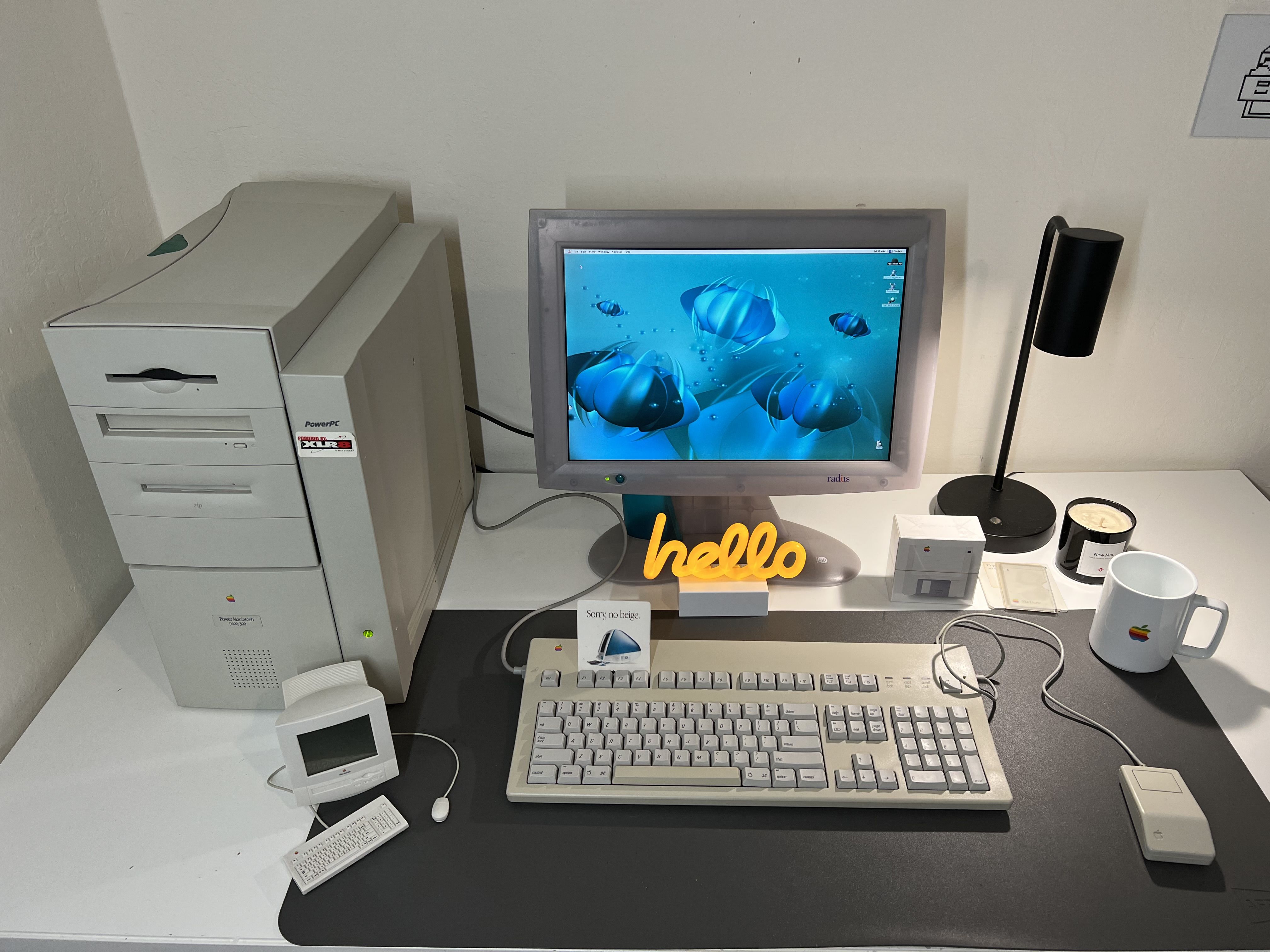

Just a little follow up on this. I did end up recapping the AC adapter, but it was still dead and I wasn't sure what was wrong. I ended up getting a generic adapter with the same specs that worked fine. Here's the display running..
