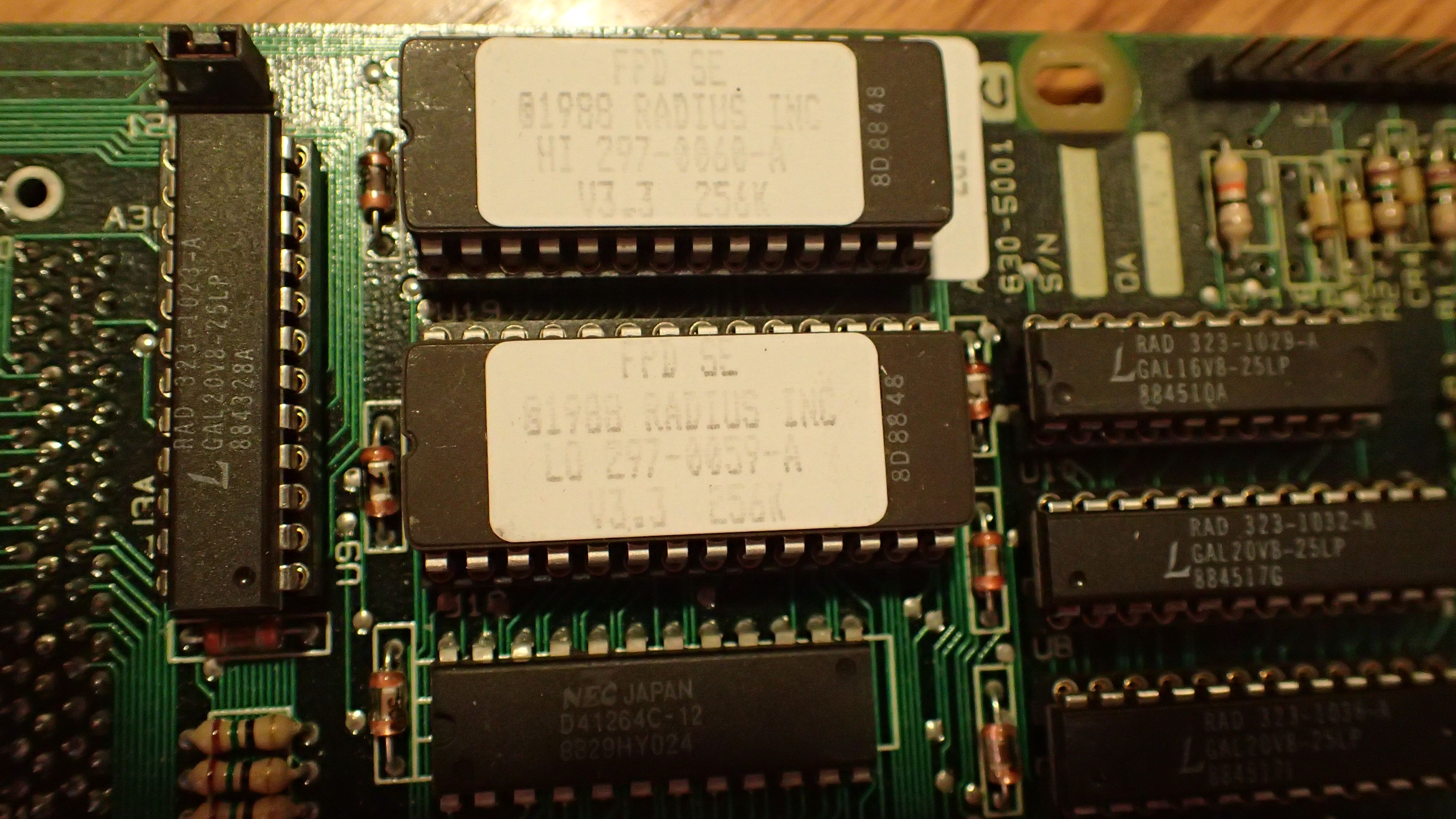

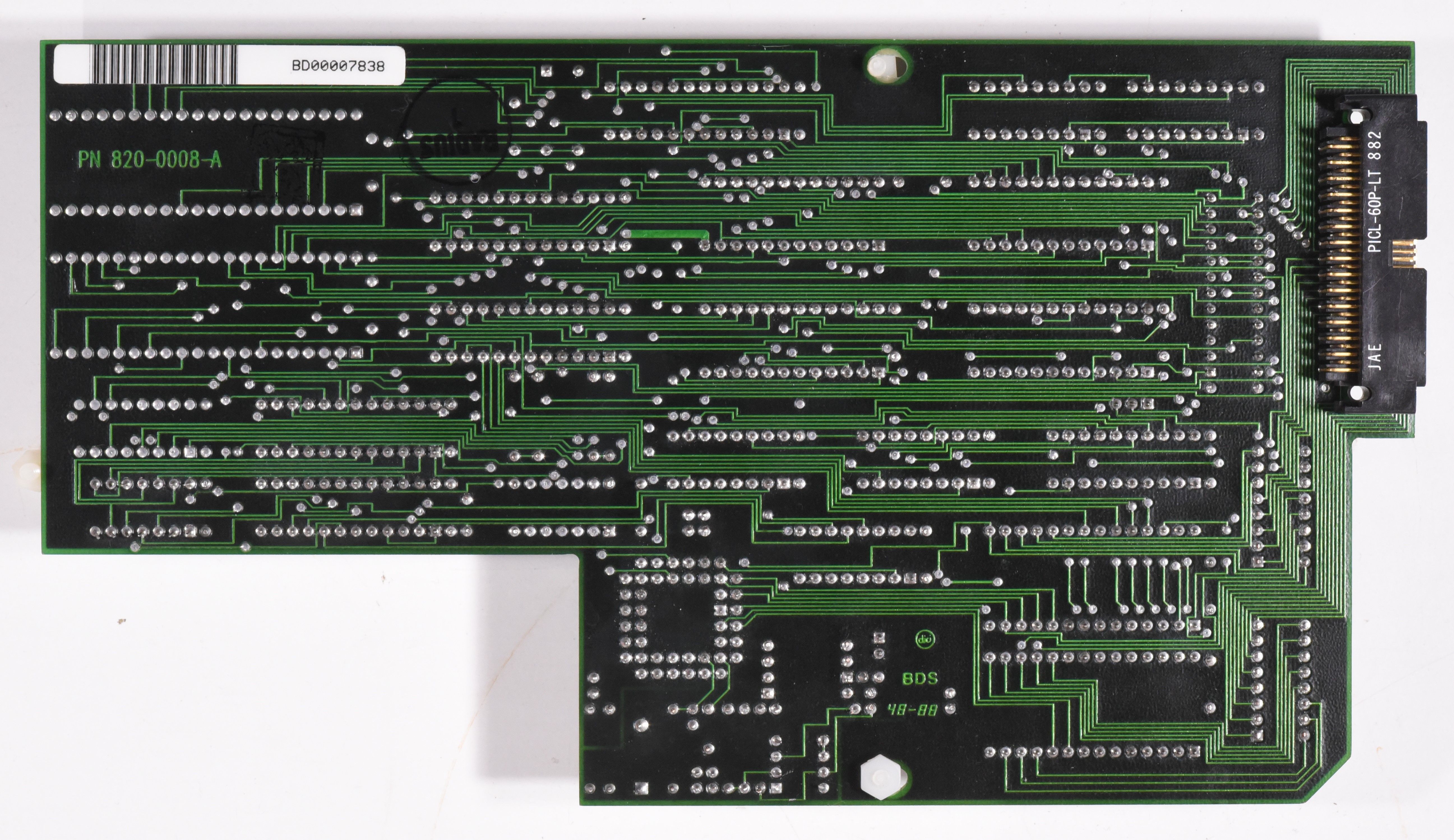

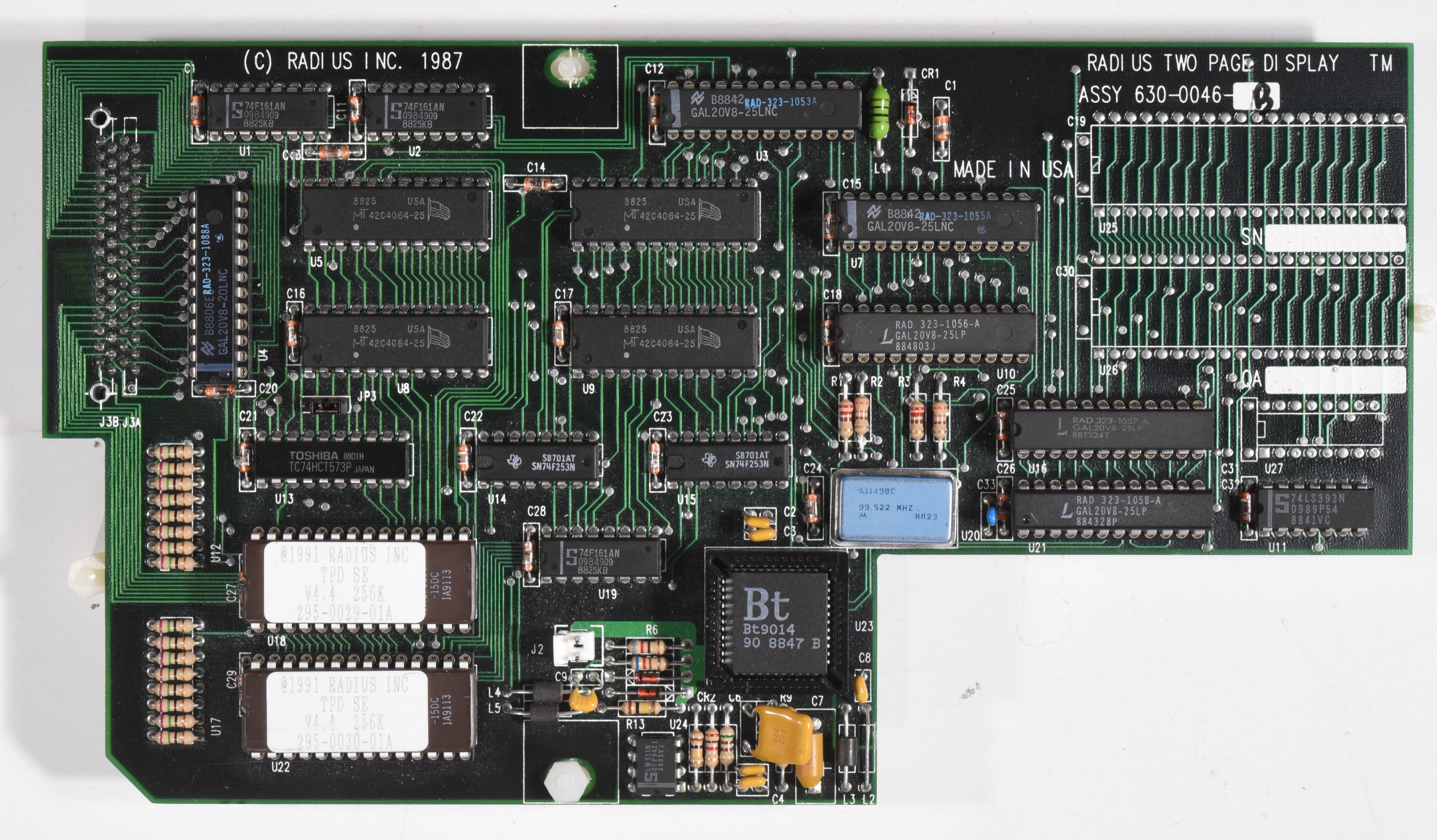

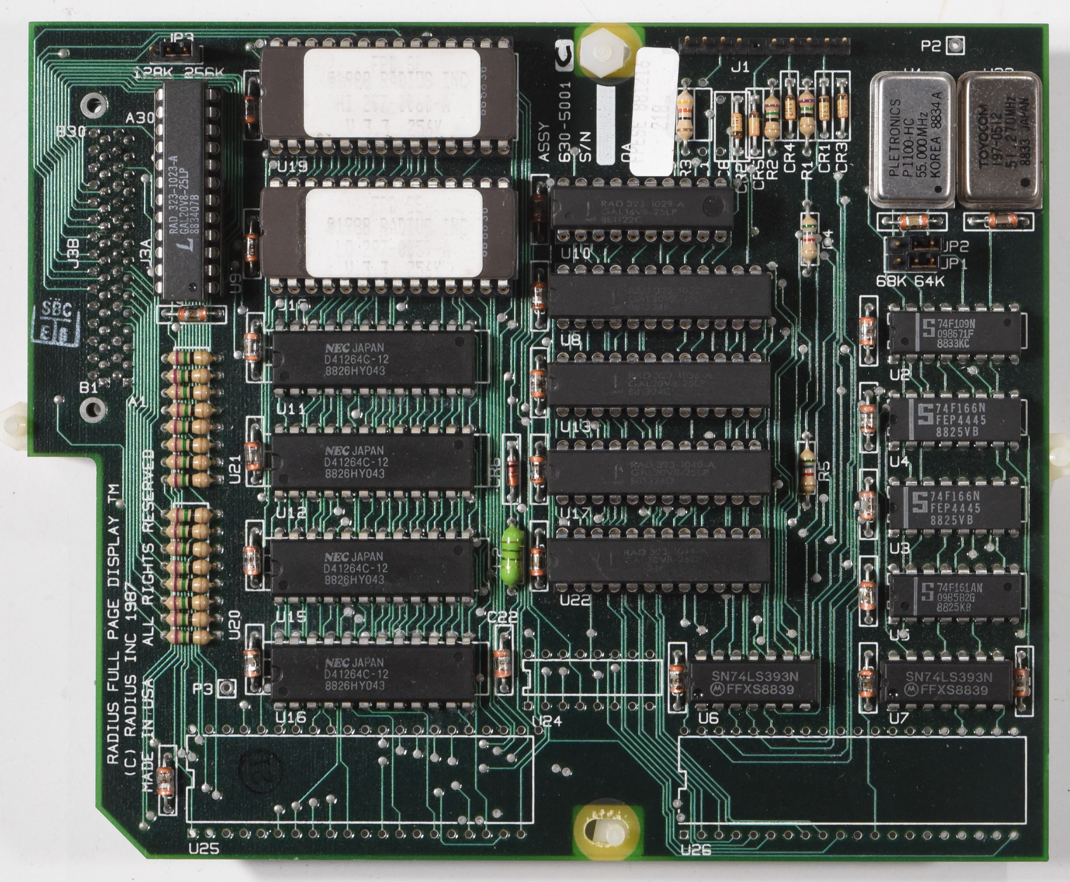

Does anyone have this VidCard available for a photo session?
It's Radius' first product and one of the very few Radius cards I've yet to collect. Got TPD card for SE in hand and the BT9014 on it appears to be the only problematic Programmable Logic on the board?
NuBus Mafia appears to be down over on 'fritter, but I found this pic:
Given today's progress, that looks eminently doable?
@max1zzz of course your ITXPlus would be the target. ;)
Crazy AM wakeup mode has me thinking in terms of a later version of your masterpiece that puts the 68000 on a riser card in the equivalent of the ITX PCIe slot spec. Passthru for horizontally mounted expansion cards a la IIsi provided of course. PCI connector is perfect for MoBo and Riser.
Caffeine has kicked in some rational thinking, A Killy Klip version of the FPD should work as is for your board and standard Plus board?

Curiosity is getting the best of me here. This is the second time I've seen a 68000 used on a card of this era as an embedded processor.
This one uses it @10MHz for generating graphics. WAG would be that system clock can be phase lock looped in the GALs to provide 10MHz? I seethe 51.270MHz Can being involved in oddball timing of video output for the CRT?

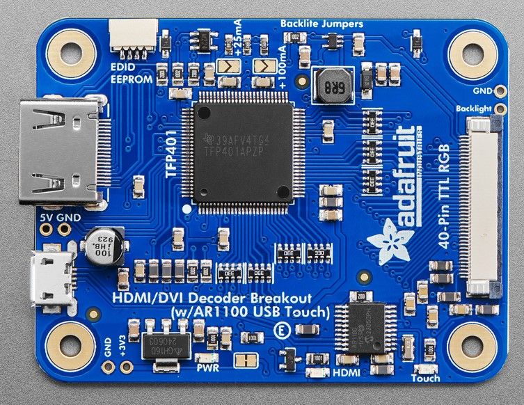

DuckDuckGo fu has uncovered a significant number of TTL->digital video output solutions and an interesting one which might be vastly simplified to run in reverse on the FPD Clone. I Guess having DVI and HDMI outputs on the backplane of the board would be good.
Anyway, can someone please let me know if all components on the Radius FPD card can be duplicated for a new parts build?
1,222
1,215
Worthing, UK
The board would be easy enough (*cough*) to duplicate if it's a 4 layer, obviously it'd be destroyed in the process. Then it's a matter of reversing the GAL's. You wouldn't necessarily use like for like parts, like the EPROMs, you could replace with a single one.
Also that board isn't likely using the 68000 as a processor, it looks like the board is a pass through, the systems own cpu, slightly offset.
1,079
312
Yep, the board in the Video is an original, factory installed card, the cards in the pics I've posted not so sure. But the 1O and 12 red herring numbers on the CPUs don't appear to mean anything?
Sourcing a board to reverse engineer will be the next hardest part of the project.
- GAL16V8 - cracking is a done deal, no?
- GAL20V8 - ISTR causing some problems, but also a done deal by now as well?
Sticking point will be the PLDC20G10 at U10, its datasheet here:
https://media.digikey.com/pdf/Data%20Sheets/Cypress%20PDFs/PLDC20G10B,%20PLDC20G10.pdf
Damn security feature prevents logic pattern duplication . . . or did so back in the day?
Wondering just how difficult it might be to brute force that pesky PLDC20G10 sucker if worse should come to worse?
Attempt is to a do a ground up new build using no original parts as there pretty much aren't any in the wild.

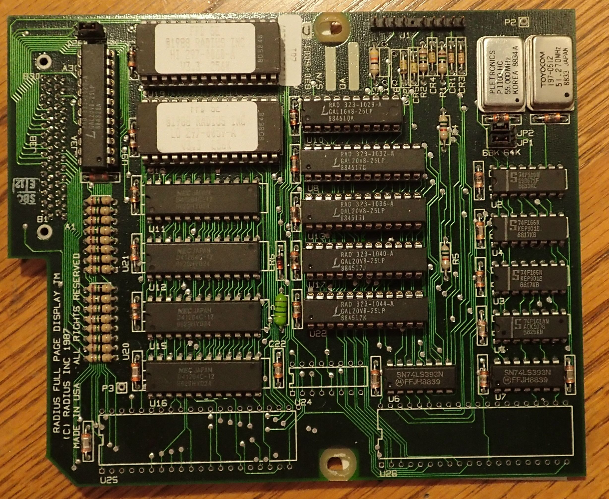

Been looking at the Radius FPD and TPD Cards for the SE for the possibility of cloning them.
Started with the TPD, with its Bt9014 PLCC44 Programmable Logic Array complication. Was hoping it might be involved only with combining all the signals into just the one Mini BNC signal setup. But to no avail, it connects to the ROMs, which bodes ill for such dreams of simplicity.
Looking at the TPD for SE next, appears to be a "refined" version of the TPD/Plus/512ke with no programmable logic at all, just readable GALs and two empty spots for huge ICs. They're on (unpopulated) the TPD/SE card as well.
What the heck could the purpose of these ICs have been?
Hoping these cards might be convinced to work backward compatible with the Plus. Dunno, but the hardware is coming together to test the possibilities.

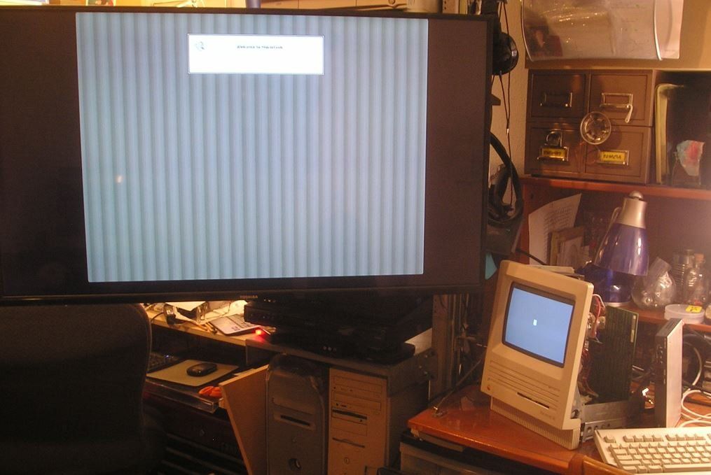

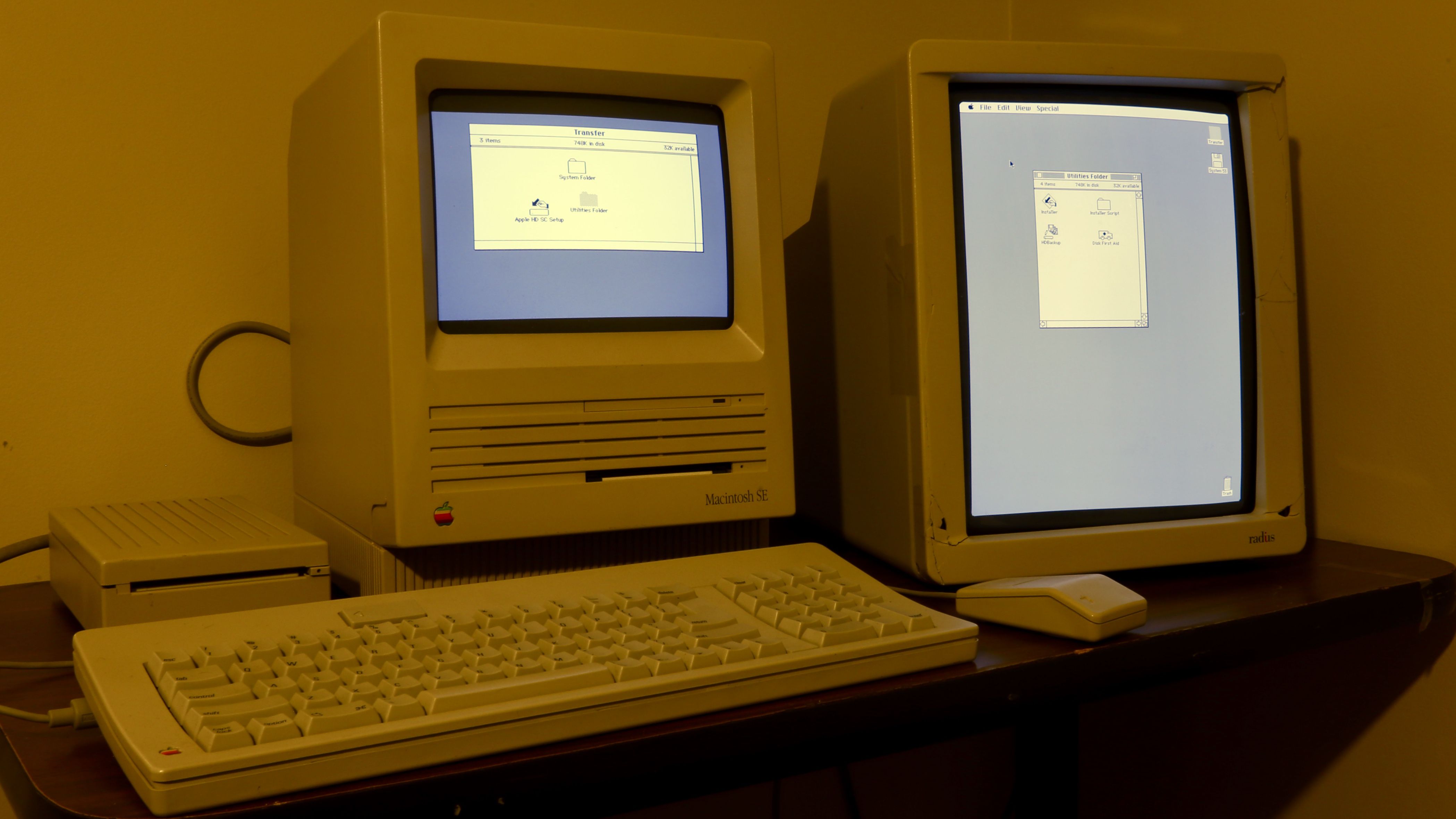

First, on the fly run at the Radius TPD with Extron Scaler. Managed this right out of the box, without reading the manual or any experience at all.
Got SuperMac Spec8 SI running just about right with image at lower right corner of the 42" 1080p TV next to the SE over HDMI. No banding at all, front porch is off a tad, so no rounded corners bit on left side of image.
Pics taken with a relatively rudimentary digital camera.
Misplaced my link to the YouTube Vid of setting the FPD up using RGBtoHDMI? No image rotation available at that point.
Big hopes for dumbing the 6-bit TTL version down to a single bit. Rotation is a thing at the very high end, but for high end video streaming. Maybe scaling the single bit Portrait image and flopping it over on its side to fit a 1280x1024 LCD (standing on its side) will be a more reasonable goal?

Wondering about that pair of unpopulated chips again, 8Mbit ROM came in that 40pin DIP package. Wondering if they were there just in case the code couldn't be optimized to fit into the ROM that wound up on the board?

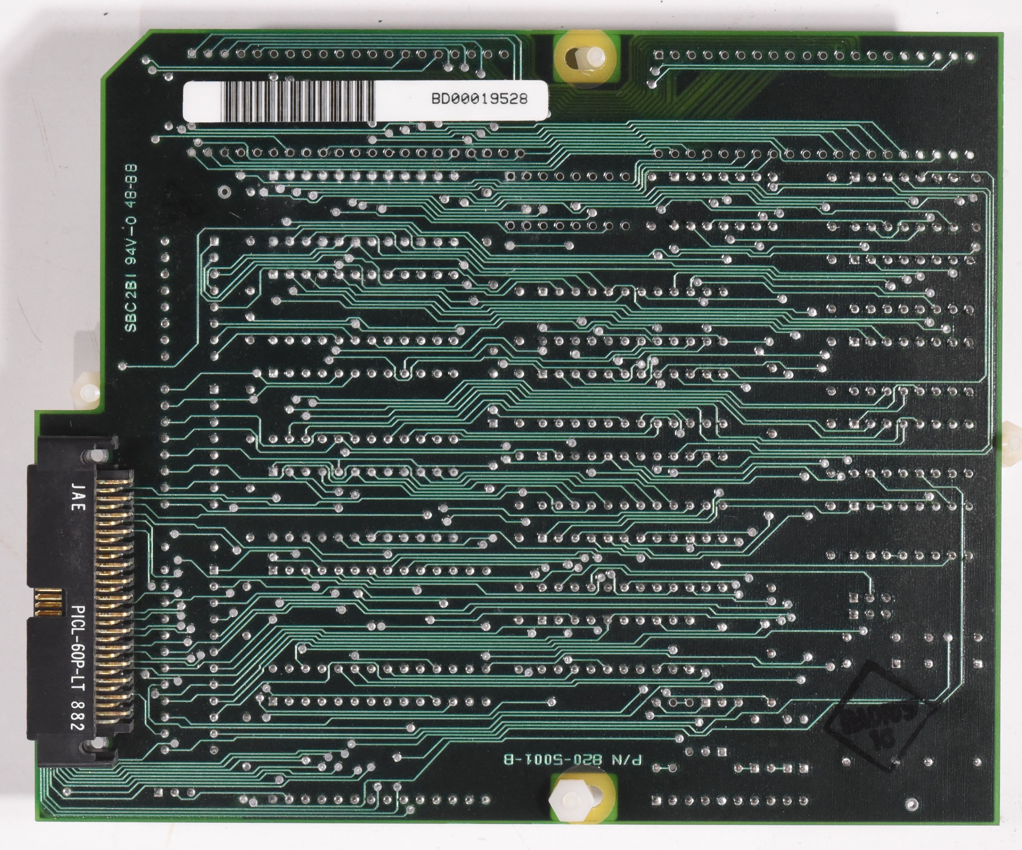

Here's a picture of one side of a full page Radius I have in an SE; looks similar to above but if you see anything that could be helpful I could disassemble and be more specific.

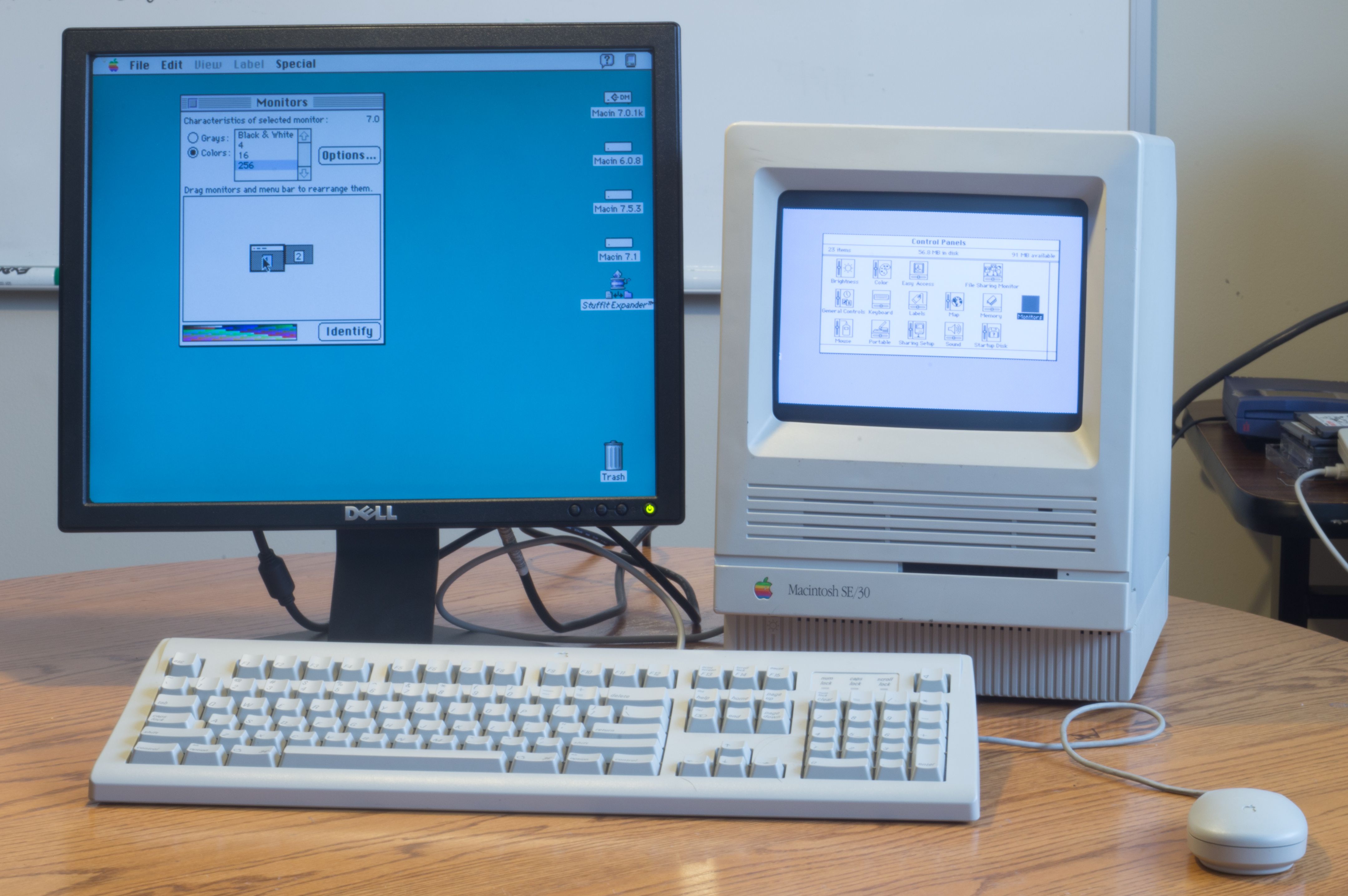

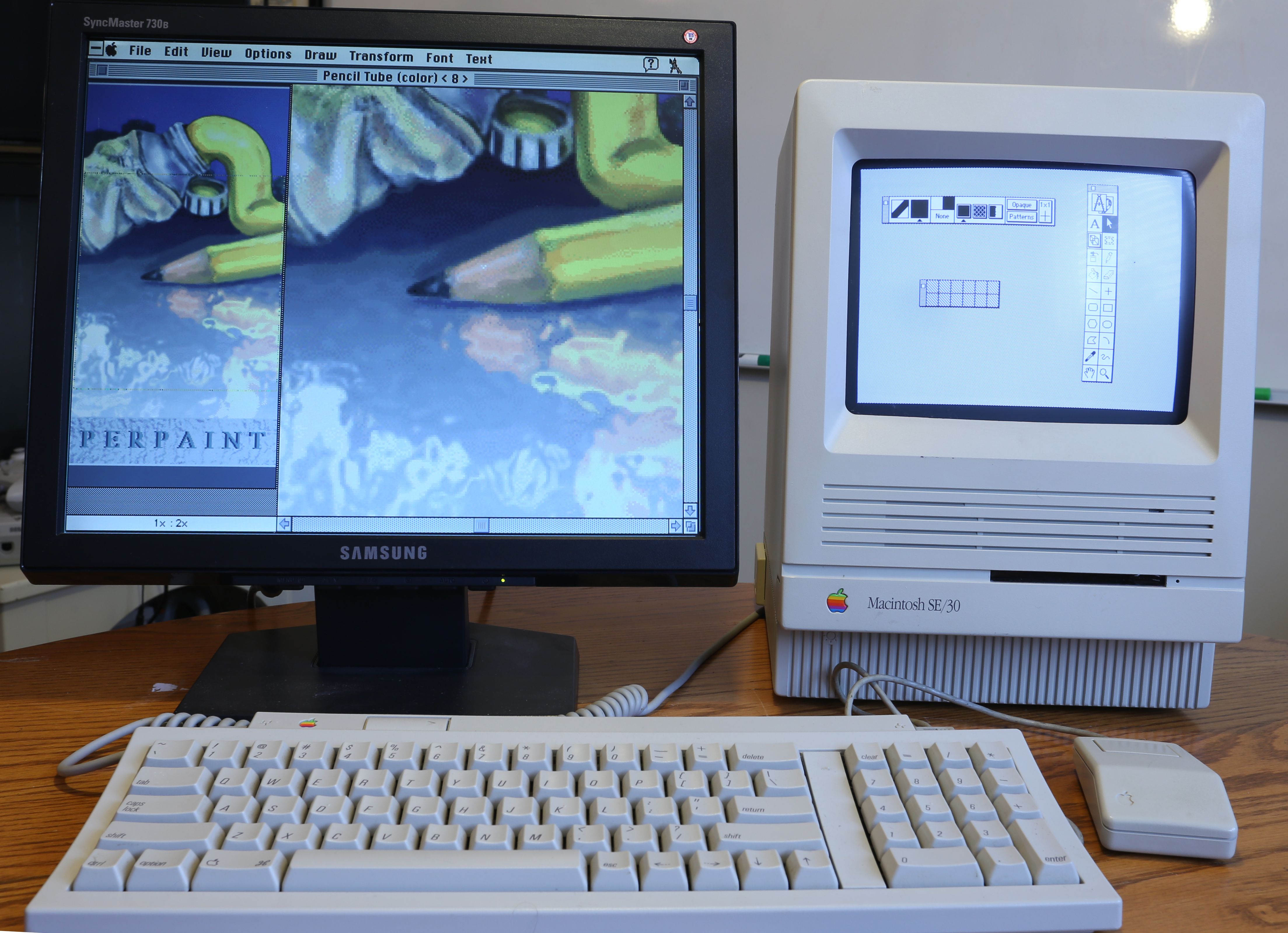

A little tangent; in about 2015 or 16 I found a local auction and picked up 2two SE/30's and a plus for about 60 bucks. It was my introduction to the existence retro/mod/support community out there. I found a thread on the other site with instructions of how to put a Radius II SI card into an SE/30 using a superMac adapter card (basically just cut off the coprocessor socket so it would fit into the SE/30 case). At the time pretty sure I got Radius II SI cards for about 12 bucks and the SuperMac adapters for maybe $6 dollars. Retrobrighted, recapped built cables....two complete SE/30 's with external monitors.......... they looked great. At the end of it I thought it was hobby but what a fun neat project then decided they took up too much space and sold them both without a second thought. Pictures from my sales listing. I will not say how much I sold them for, just looking back, two people got a REALLY good deal. Crazy.
Anyway, probably can't help you much with any designs or backward engineering but can generally follow instruction, have a logic probe, oscilloscope and solder.

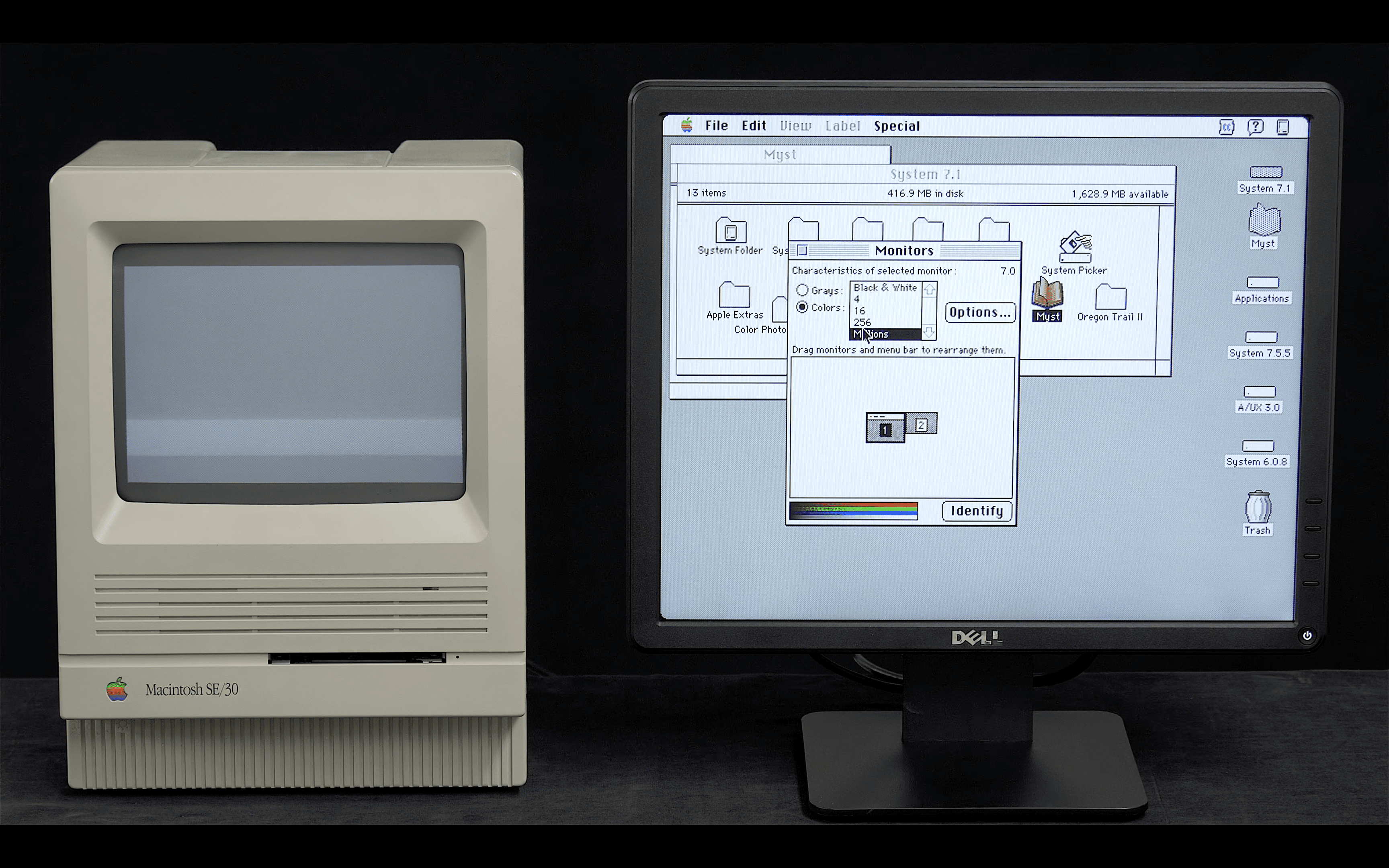

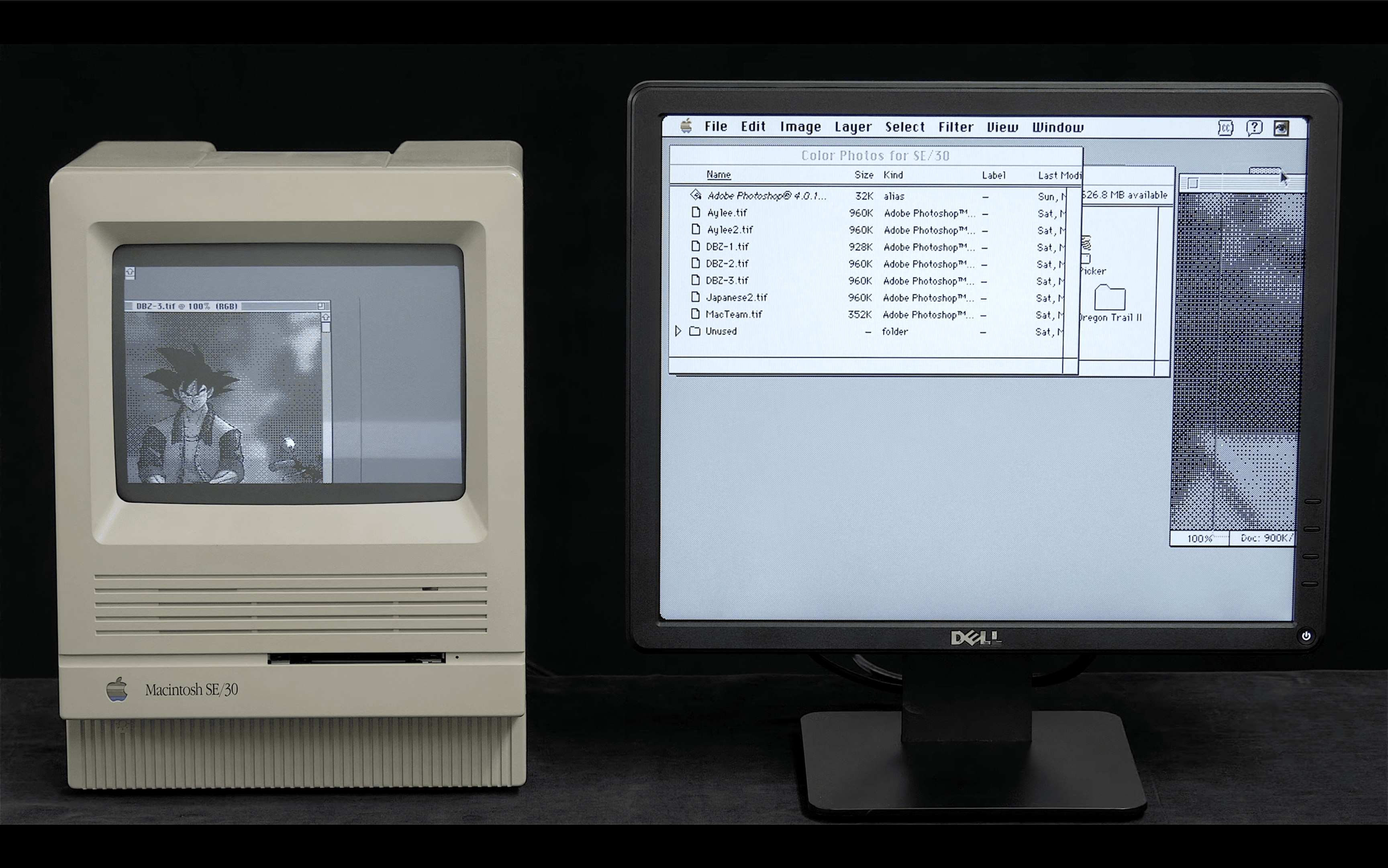

That's neat because when I use my Micron Xceed MacroColor 30HR video card with an external display, the internal 9" CRT can't display anything, as shown below...
