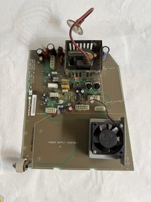

Thanks for the tip. I'm doing some searching on the internet to try and figure out what a horizontal output transistor is and which is the right one for the SE/30. I found a schematic for the Mac Classic online. The document identifies the HOT as Q3, which shows Q3 as BU406. Digikey tells me that transistor is obsolete but can be substituted by BU406G. Does any of that sound right?

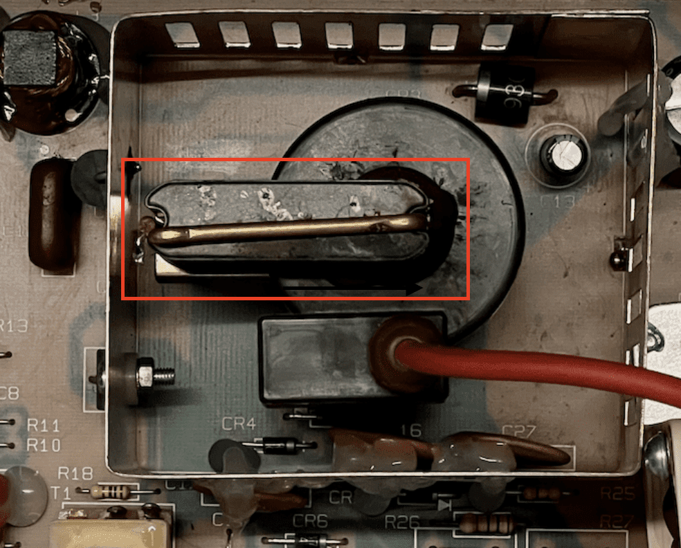

My curiosity got the best of me and I went looking for the HOT. I don't see a Q3 or a BU4906 on the analog board. I guess that means the Mac Classic is different than the SE/30. The only thing I see on the analog board that bears any similarity to a BU4906 is the item I've circled. If I read it correctly, it is a Motorola 7905CT. Reading online, it doesn't seem to function the same as BU4906 at all.
Could someone describe to me where I might find the the HOT in the photo of the business portion of my analog board? I've tried to keep the photo as small as possible. Thanks again for the guidance.

Well, that's embarrassing. You are 100% correct. Thanks for setting me straight. I'm going to go ahead and order some replacements and hope I can replace it without damaging anything. There are three solder connections and they're the poke-through kind. That and the attachment point to hold the transistor in place will hopefully help me out.

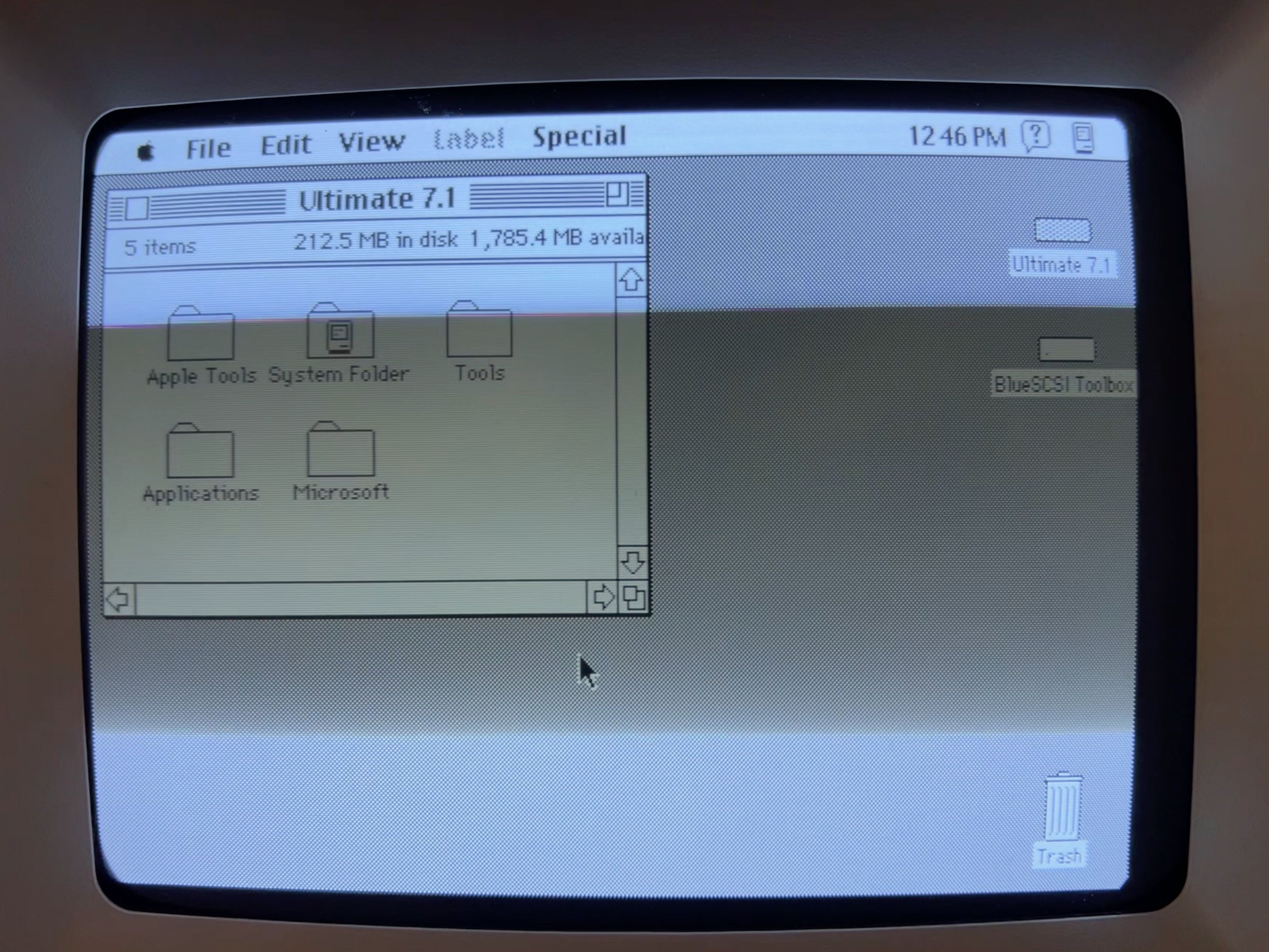

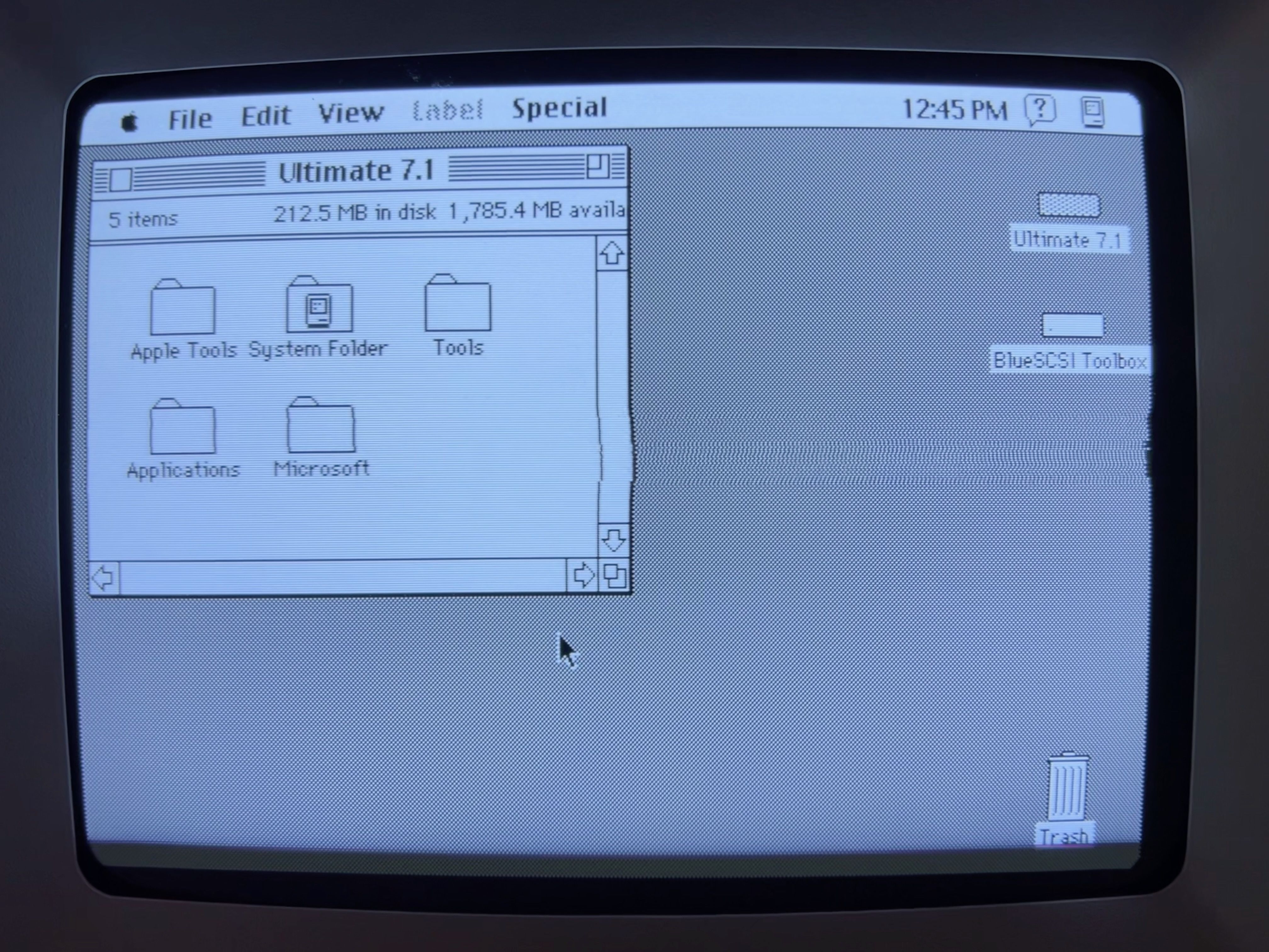

I have an SE FDHD with a similar problem to what is being described in this thread, except that the shake is a more intense, larger twitch. Also, there seems to be a faint line constantly scanning down the screen. Should I look into this transistor?

There's no harm in buying the BU406G replacement from Mouser and doing the swap. Probably best to order other things like capacitors, etc. to make the cost of shipping more worthwhile. I may buy one of those parts too because I have an analog board that causes screen issues, and until now, I always thought it was the flyback transformer. Who knows... Maybe it is the BU406.
I would also recommend posting a photo of the "faint line" you mention, or better, a link to a short video of it.

The faint scanning line is practically impossible to see in a video, due to the refresh rate of these CRTs. I don't have quick access to a video camera with an adjustable frame rate, so a picture is the best I can do. You can barely see it, but it is on the axis the arrows are pointing to. (Ignore the brighter lines on the top left and bottom right of the picture - those are from the bad frame rate.) The line does move down to the bottom of the screen, but once it does, it starts somewhat below the middle instead of the top.
