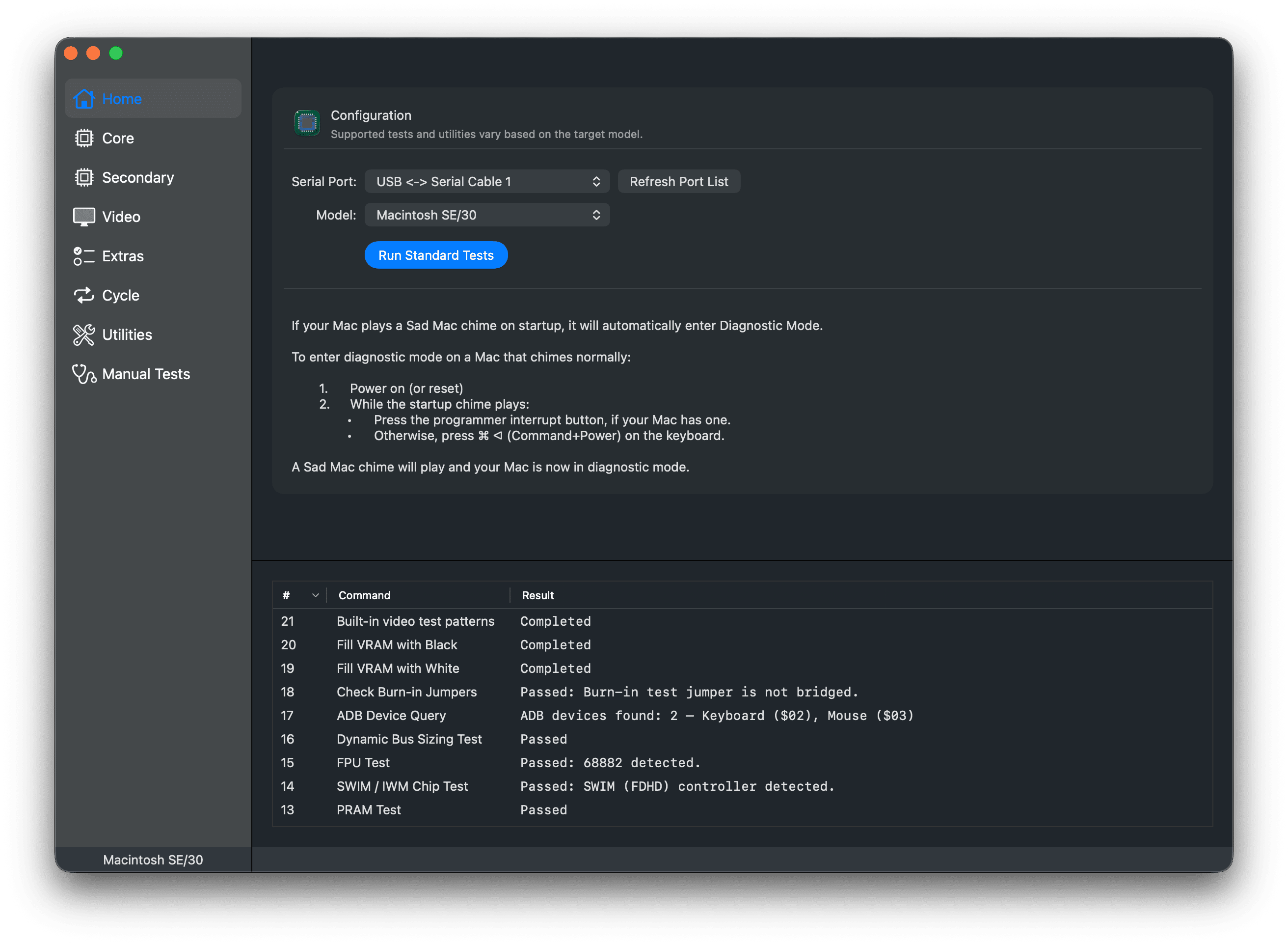

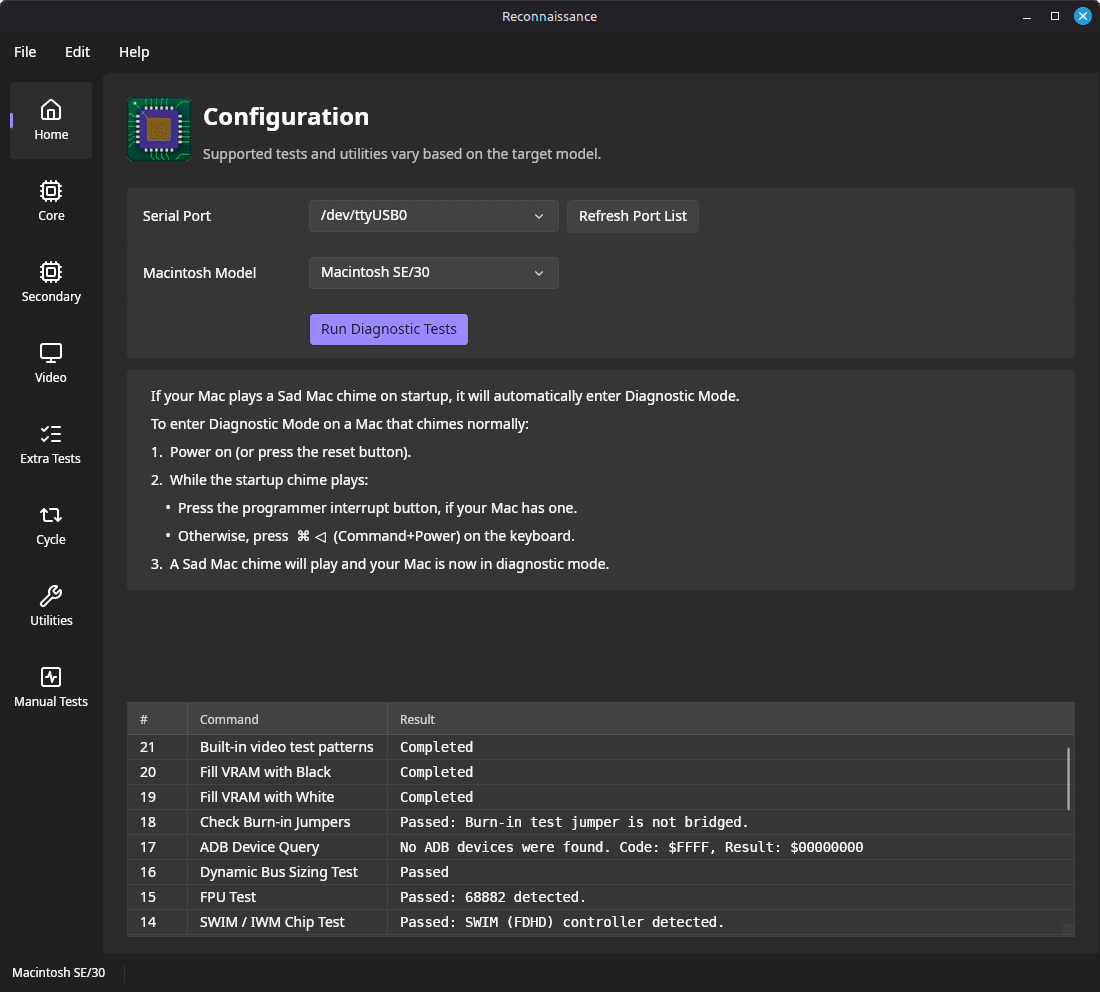

#MARCHintosh 2026 is here and I'm excited to share a project I've been working on.
You may know that many Classic Mac models have a diagnostics mode built into the ROM that you can access over a serial connection. But it's extremely cumbersome, limited, and there are a lot of sharp edges that make it difficult to do much practical with it.
Reconnaissance is a new diagnostics app that runs on your modern machine that makes it easy to run the ROM's built-in diagnostics as well as quite a few custom ones (some of which I have adapted from a certain diagnostic device that repair techs used to have access to...)
The first release supports the following models:
  • Macintosh SE/30
  • Macintosh IIsi
  • Macintosh Iicx
  • Macintosh II
  • Macintosh LC III
Support for more models (notably IIci) will be coming very soon, as well as a public release of full source code and SDK so others can develop custom diagnostic plugins in 68K assembly or C using modern development tools.
The app runs on macOS 14 Sonoma or later, Windows 10, and Windows 11. There's a lot of cool stuff to come and I can't wait to share the next update!
