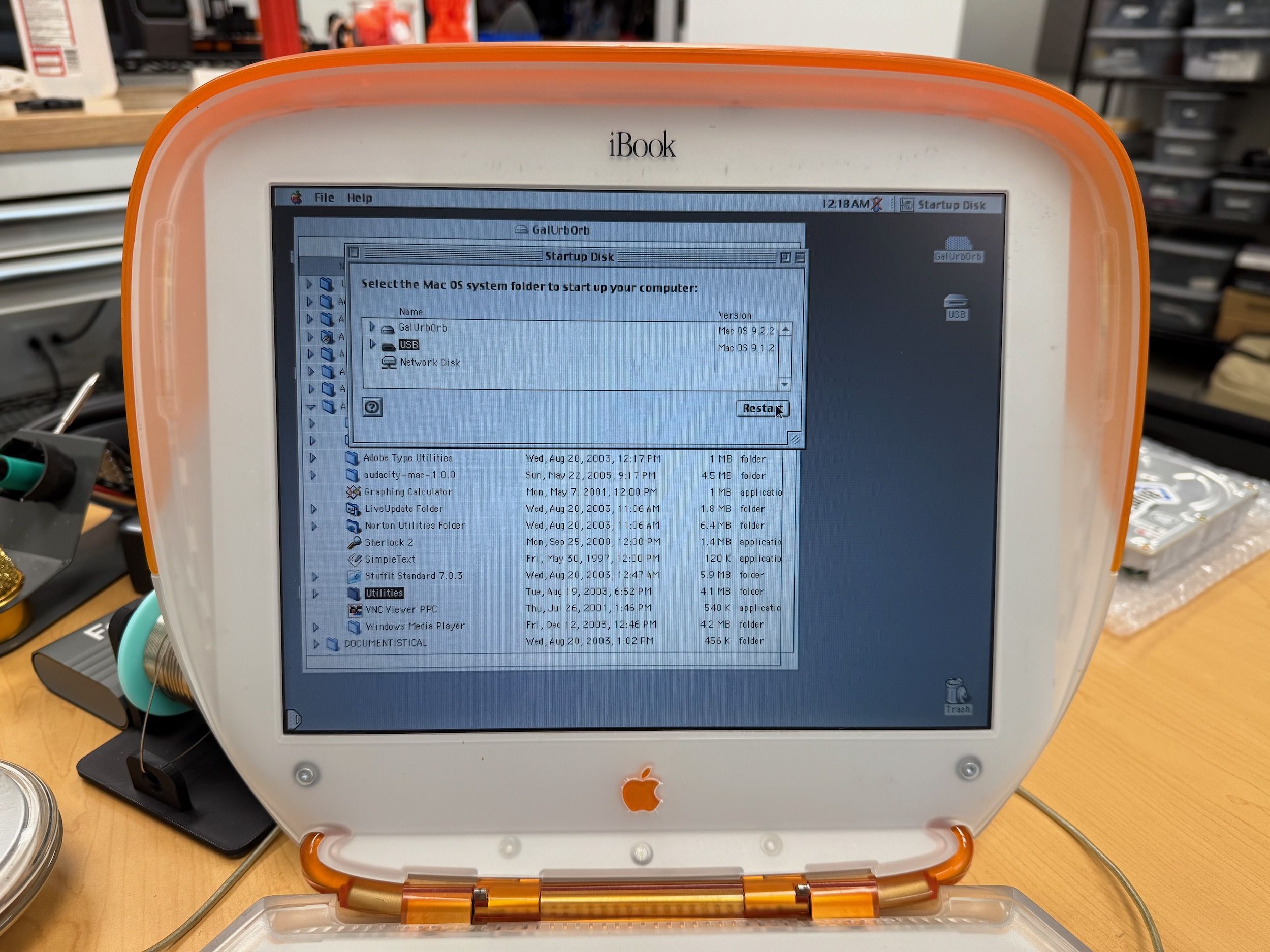

I have a first gen iBook G3 clamshell; I might be able to get the CD-ROM working but I'm not sure yet. With that, I could probably find a way to burn a Mac OS install CD (maybe 8.6?)
but failing that, is there a way to boot this thing off USB, or otherwise reinstall Mac OS after wiping the drive with Disk Utility?
it being an early model, it doesn't have FireWire :(

Found this which says Mac OS 9 can be booted from USB for some Macs:
https://www.macintoshrepository.org...-kit-for-booting-your-g3-g4-from-an-usb-stick
Thanks! I will try it out, maybe format a USB stick on the iBook, drag over the System Folder, and see if that just works. That'd be simplest.
I believe a plain old external USB CD-ROM drive could be used as well.
I do have an old DVD-ROM that I pulled out of a MacBook Pro years ago, I'll see if I can get that going if the USB key doesn't work. Was going to do this today... then got entirely distracted by another project!

I *was* able to boot off the USB drive, but not with the 9.2.2 Universal installer copied to it.
So I pulled out a 650 MB CD-R, used `hdiutil burn` to burn the iso to a CD, and popped it in. It was a tiny bit crunch at the start, but the mechanism was pretty happy after that. I got through the full install after zeroing the drive, and it's booting up like a champ!
I have a spare IDE CF drive adapter that I'll swap in once the HDD dies, but for now my plan is to put some of the fun old software on there like Nanosaur and Bugdom!
I posted my full log of work on GitHub: https://github.com/geerlingguy/retro-computers/issues/28
