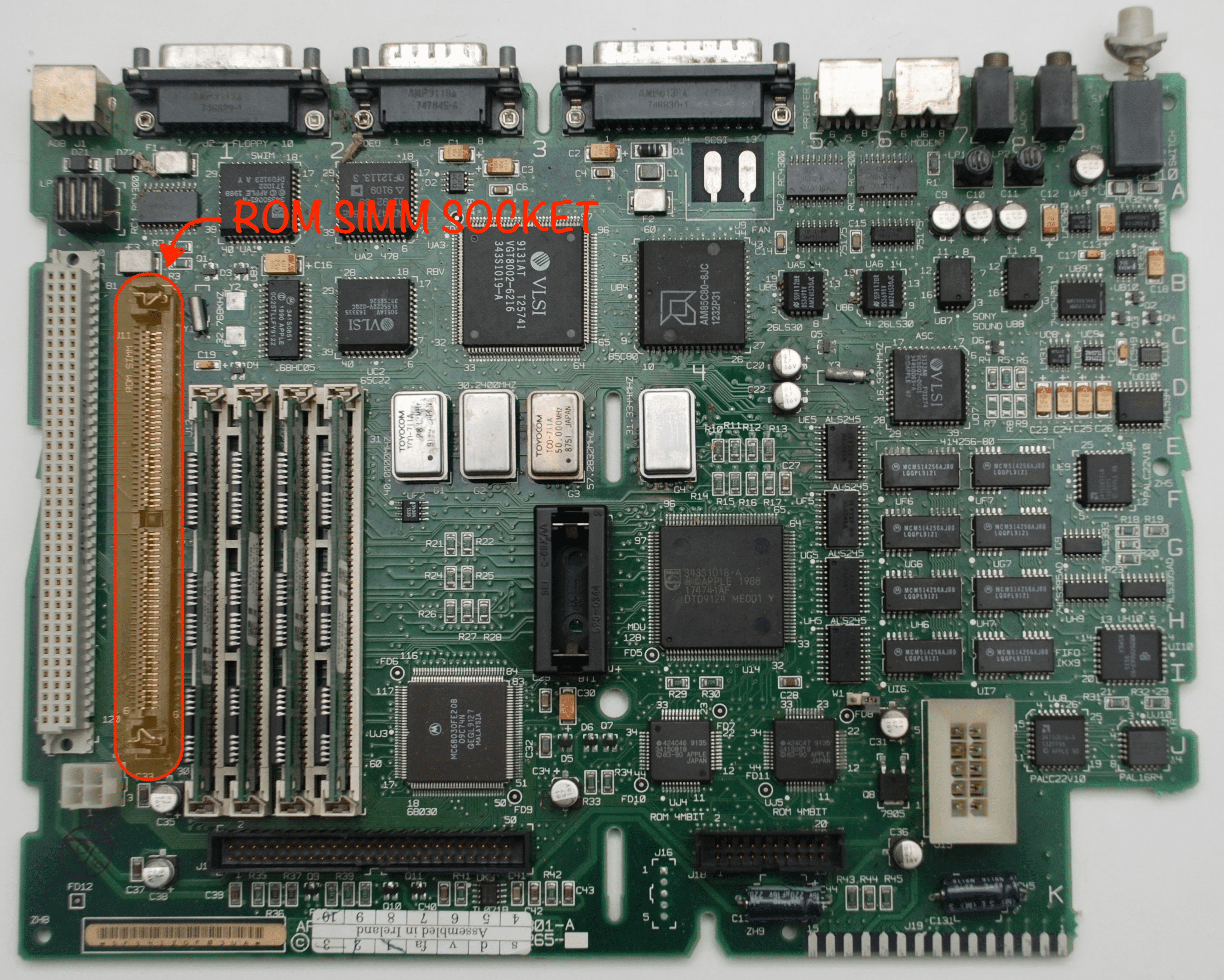

I thought the IIsi had a 64-pin ROM SIMM in the 64-PIN socket at J11 on the mobo. I looked, and sure enough, it does. Can you please clarify about the ROM soldered to the IIsi mobo?
I'd like to see a pic if you have a different revision of the IIsi mobo.

So, yes clearly, there is a ROM socket, but on your photo you can also easily spot the 2 ROM chips on the right side of the 68040.
Yes, I see those two at UJ4 and UJ5 on the right of the 68030. Makes sense now. :)
