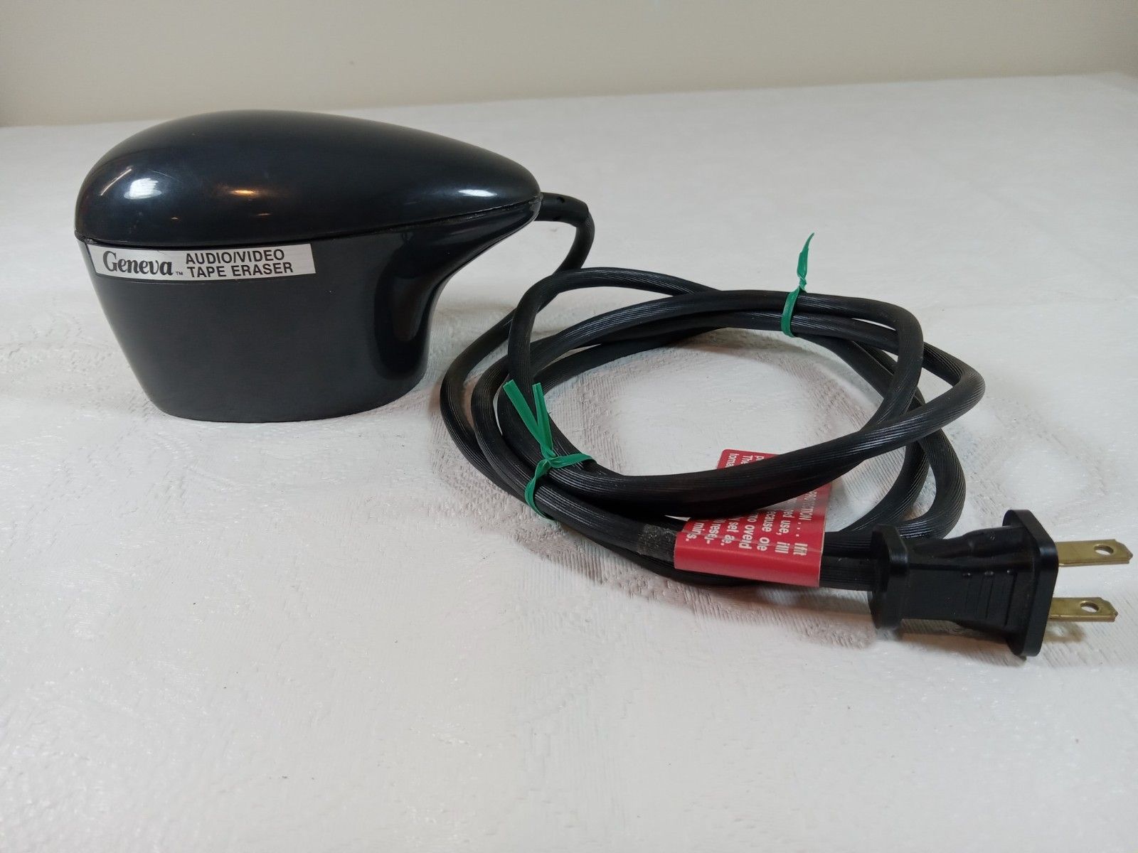

  • Electric handheld degausser / aka "Tape Wiper / eraser"
  • A blank floppy disk image (blank-floppy.dsk)
Degausser

  5. Eject disk, lay the floppy disk on a flat surface label down (away from anything magnetic or metal)
  6. Run the degausser over the floppy disk in a circular even motion. It should vibrate when you do. Release button.
  7. Flip the disk over. Run the degausser over the floppy disk in a circular even motion. It should vibrate when you do. Do not release button. Continue
  8. Slowly move the degausser away from the floppy disk in smooth, even, circular motion until you're around 12 inches away, then move it completely away straight up and turn it off. (this should take around 15-20 seconds total). (Think tornado shape)
  9. Run gw erase --hfreq - Attempt a high frequency format
  10. Run gw write --format ibm.1440 blank-floppy.dsk - Write the empty floppy disk image
    1. Success without track errors? Done! You have a perfect floppy.
    2. Failure? You can try the degaussing again, or toss the floppy.
So far, I have around an 80% success rate "fixing" bad floppies with this process. The degausser pushes the magnetic poles around on the media, and then the slow movement away (important) leaves them at an even unmagnetized state. I think these disks go bad because they get magnetized over time which prevents the drives from "flipping" the magnetic bits on the media.
Warning: Magnets will not work. They will further magnetize the disk and make things worse. (i've tried) . You need a degausser which rapidly alternates magnetic poles.
