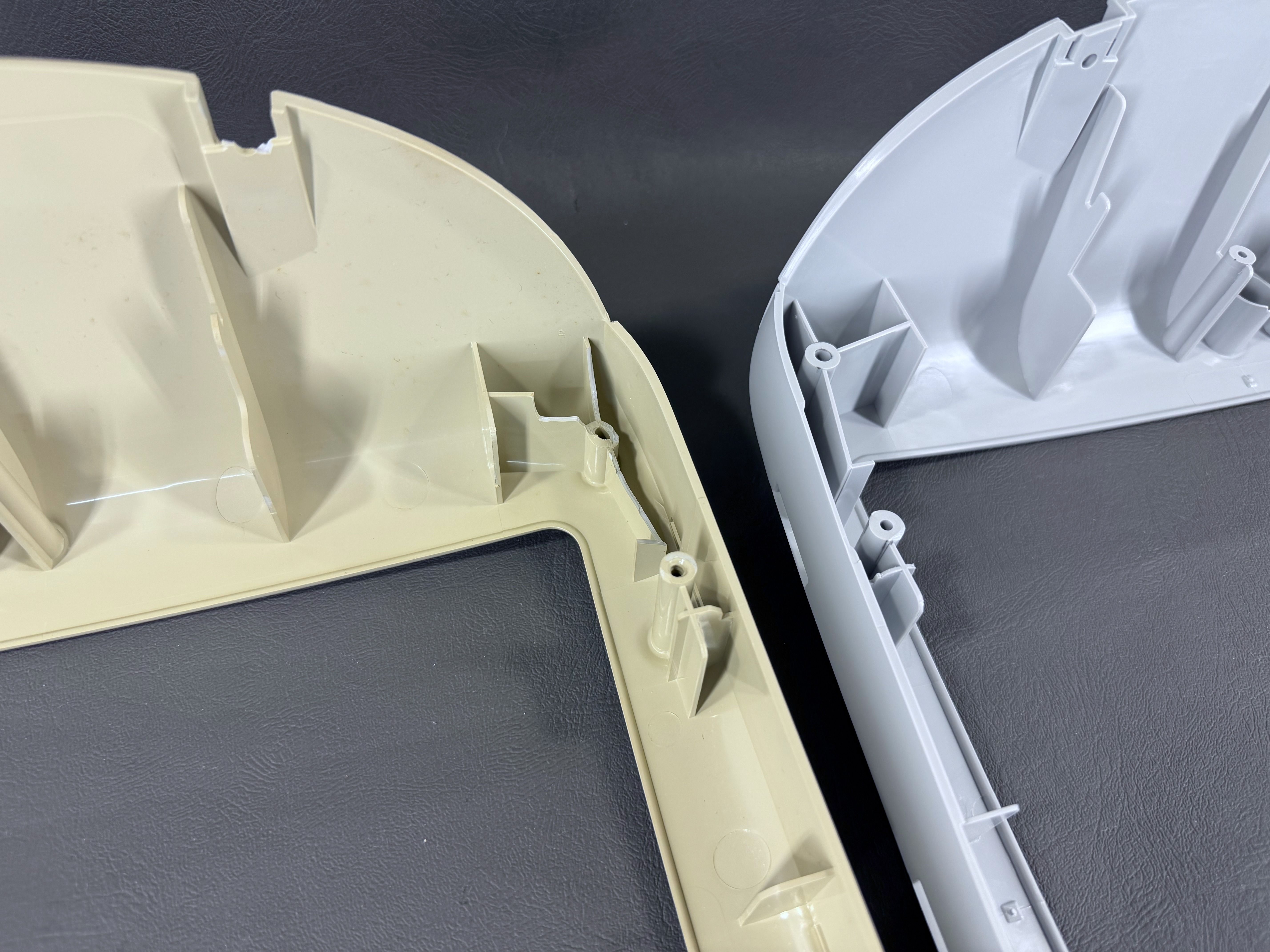

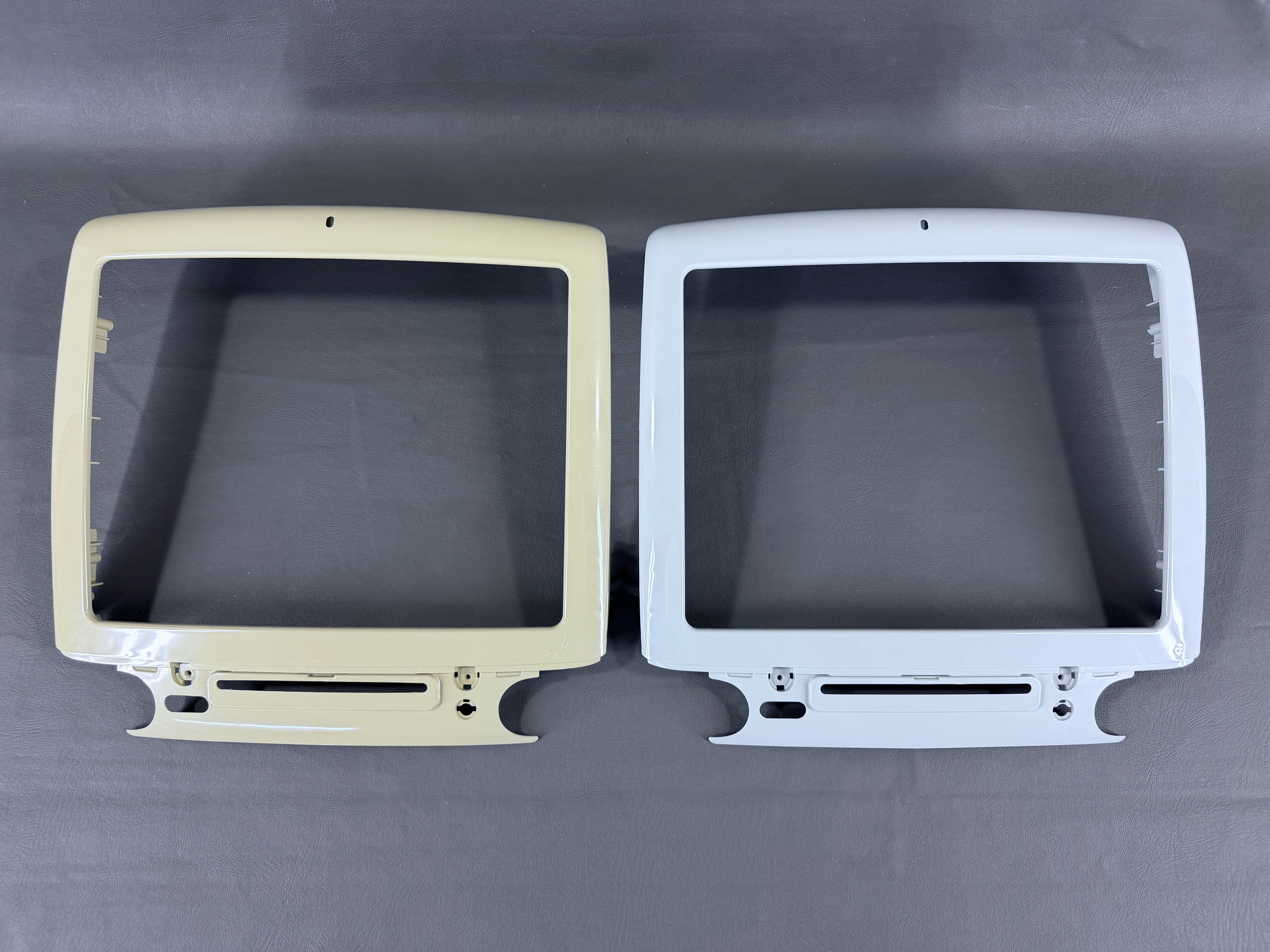

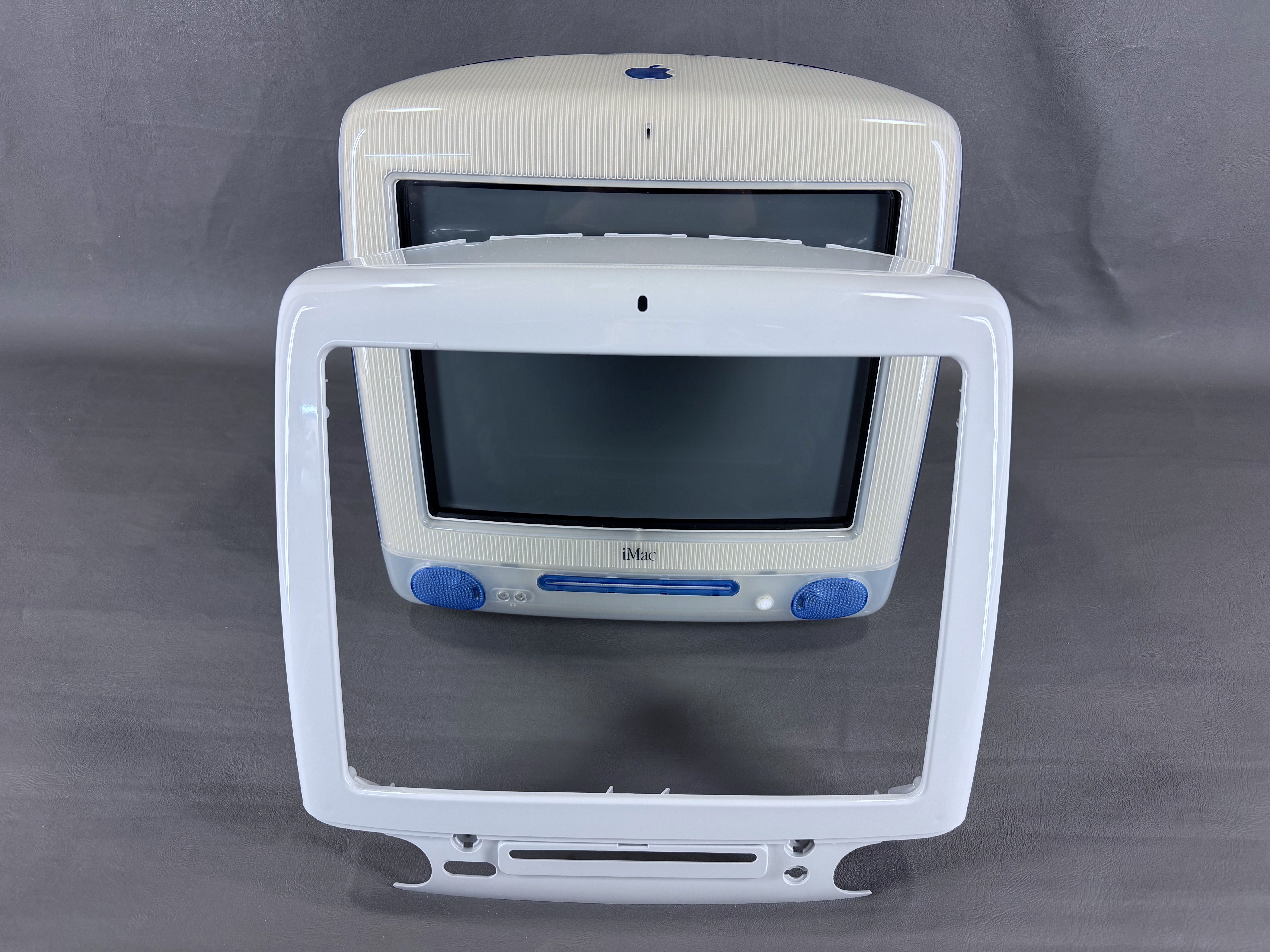

Got the new inner bezel installed. It went pretty well; took me about 3 hours (including time to document it) but obviously very much worth it. The original one was more brittle and yellowed than I'd previously known.
Old (left) versus new (right) - feat. one of several broken screw standoffs for the CRT mounts.

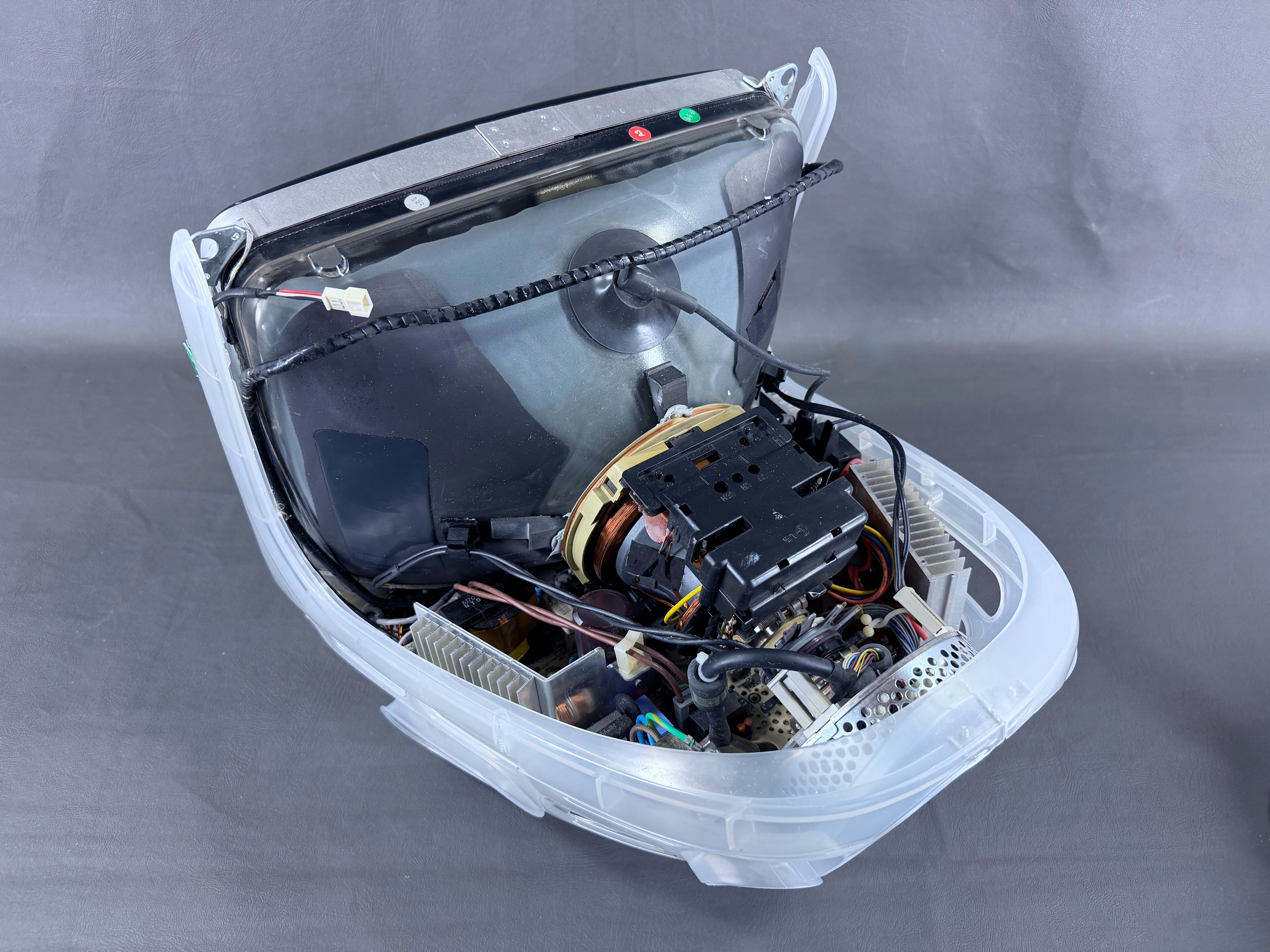

Disassembled iMac, midway through the process - thankfully CRT discharging is not necessary.

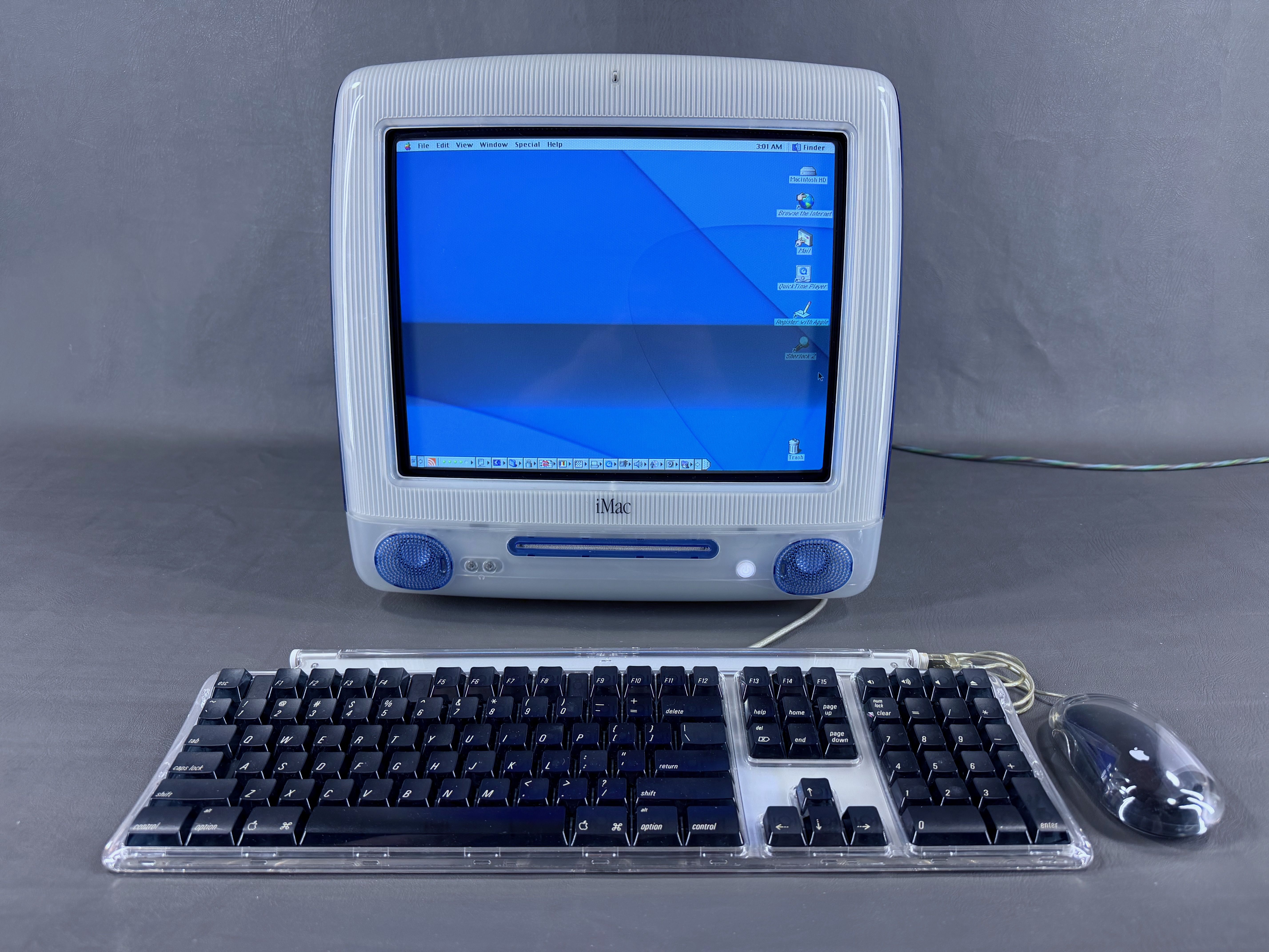

Happy Mac with new bezel installed!
