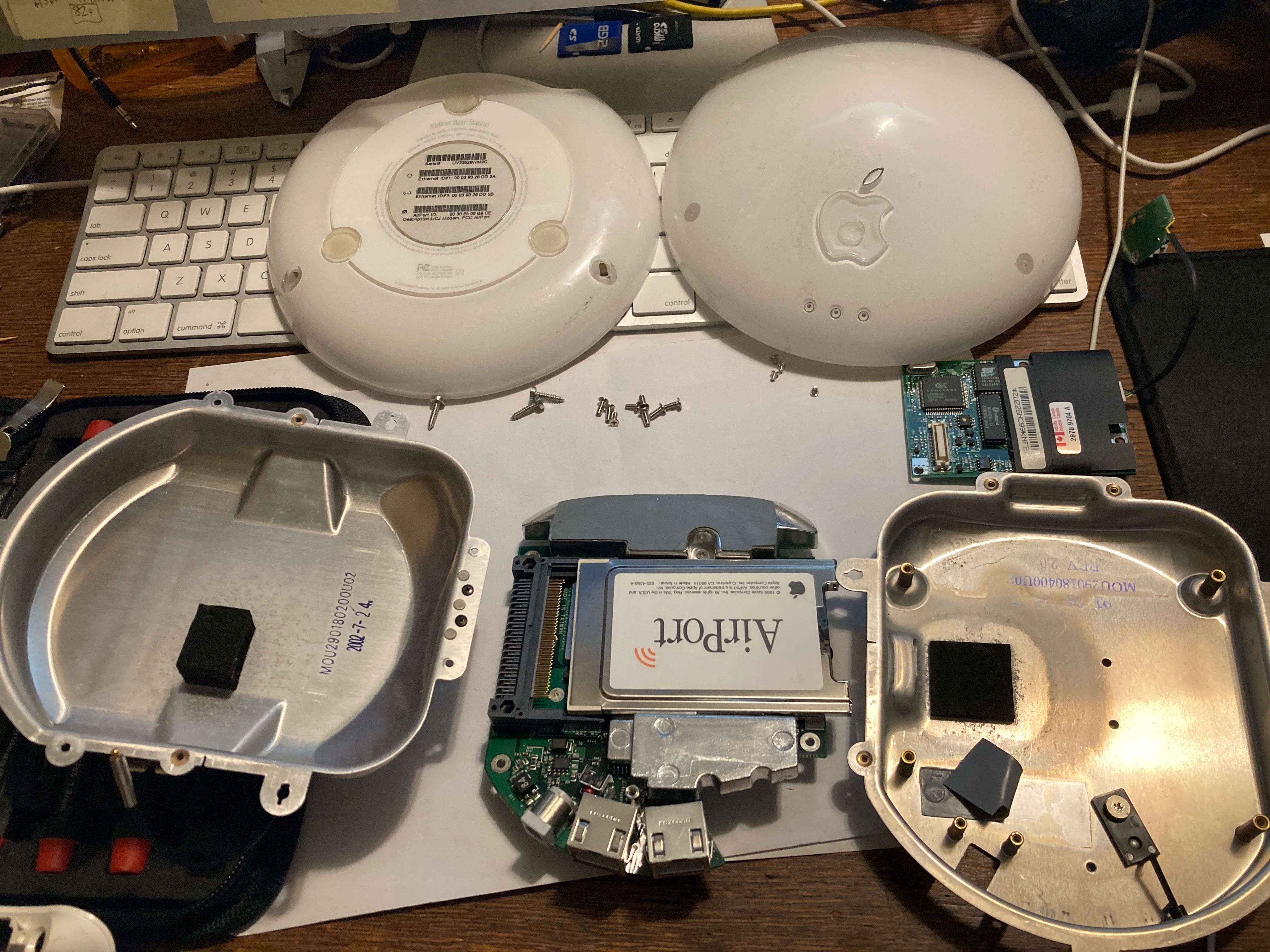

I should have another card in another machine, but I'll have to check. Good call on the pins, I'll check those, and I didn't know the base stations had cards in them! I think someone is selling one near me, so I might get it just for the extra cards/stations.
