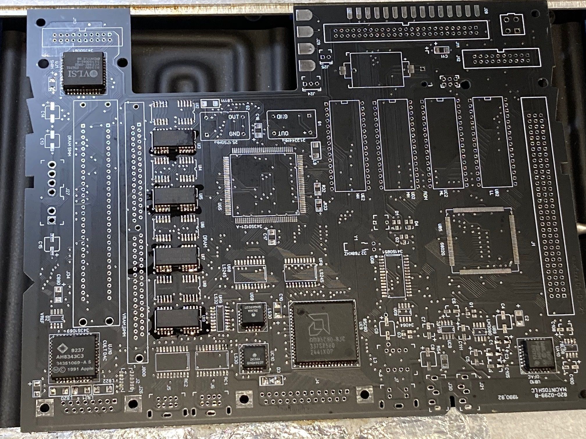

Oh don't worry, you can rest assured the very first thing I will be doing once they are ou the packet is posting a picture on here :)
Whoops, forgot that one...... :)
However, I can now post a picture of a fully assembled V1.2 board:
The good news is that it works just fine! No patch wires and no weird NVRAM issues :)
