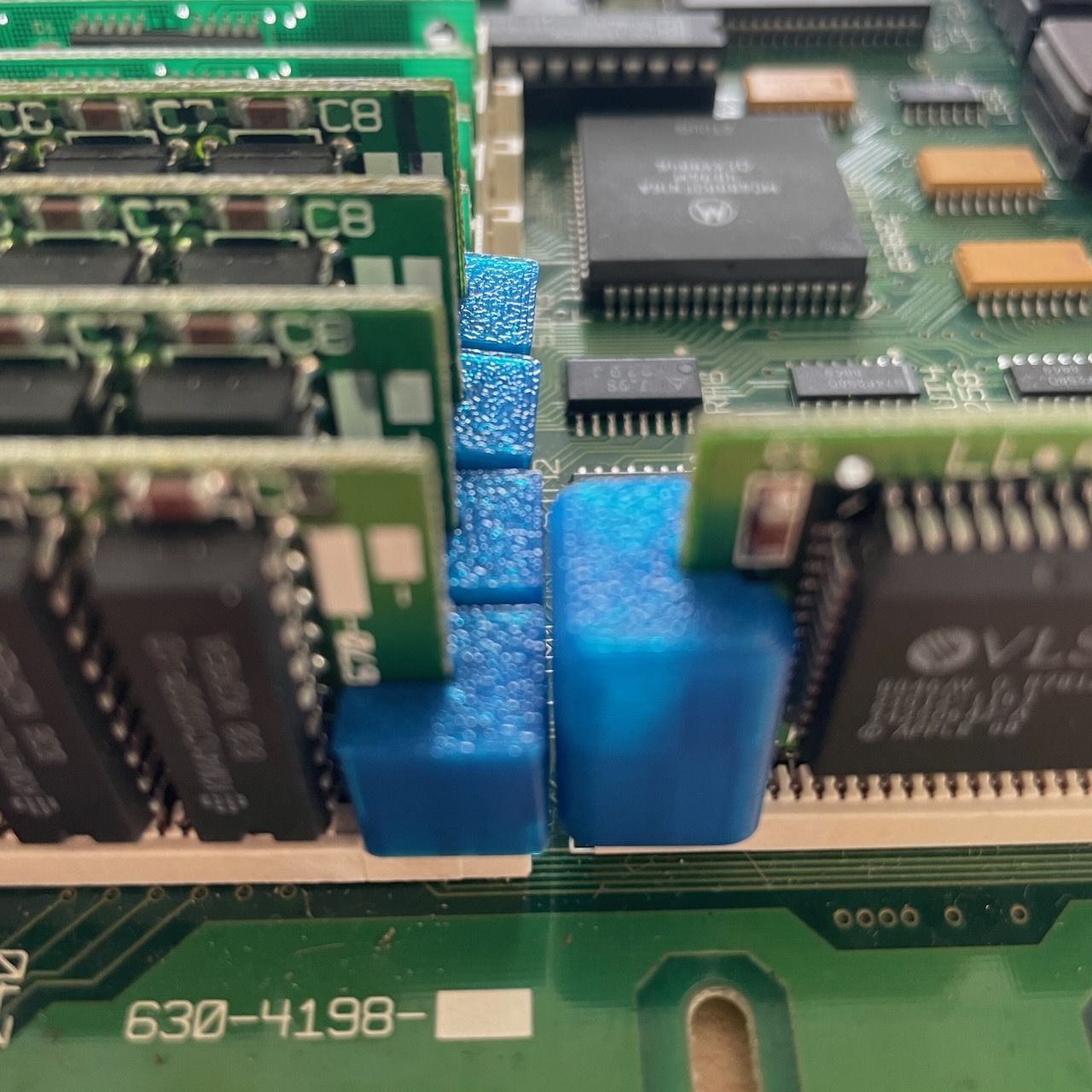

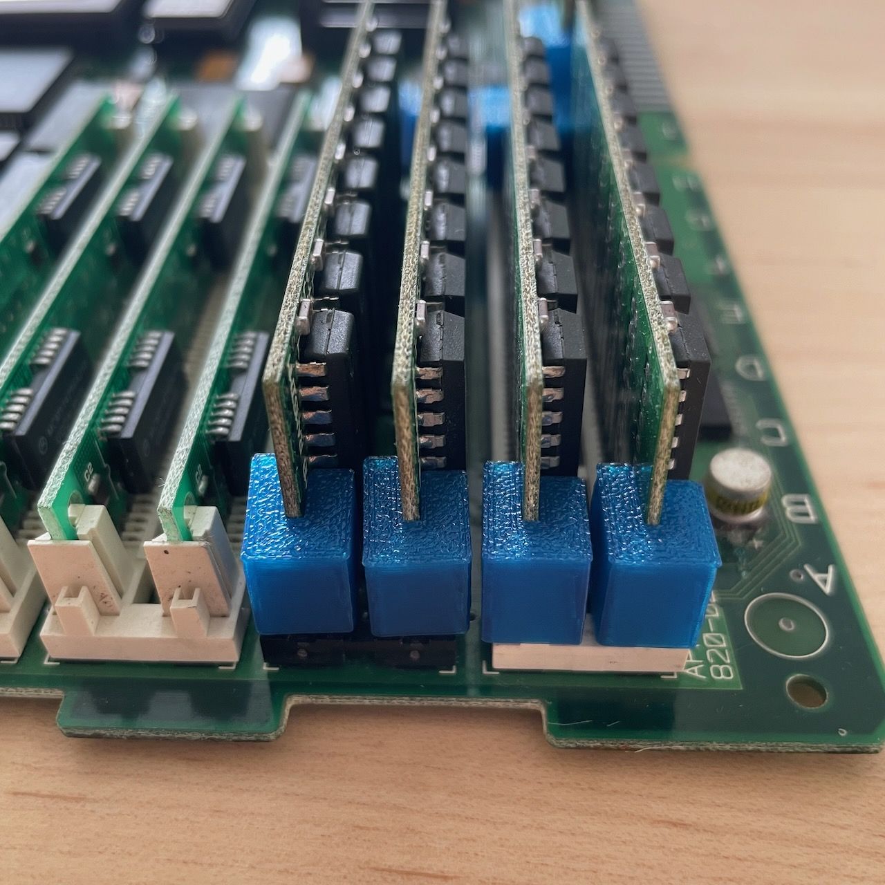

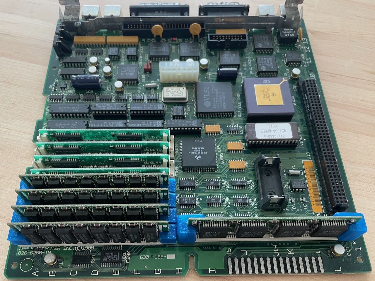

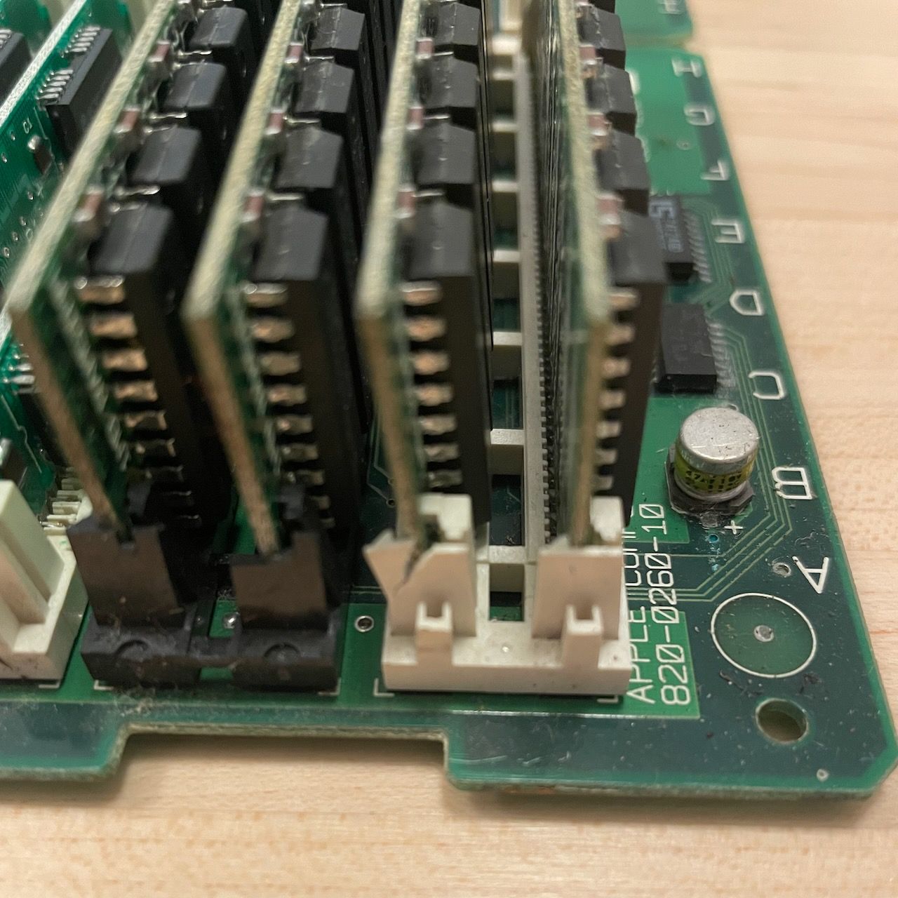

Got a "new" SE/30" that I'm going to mod with @zigzagjoe Color LCD kit and while the ROM SIMM clips aren't broken they seem to be barely holding on. The ROM SIMM was really leaning. Printed the type B" v2.3 one and it feels much more sturdy now!
It did have one broken RAM SIMM clip, so printed up a set of those too which again work like a charm!
These were a super quick print on my Bambu Lab A1 mini. I used Polar Filament Premium PLA, snug fit in a good way.
Thanks @PotatoFi!
