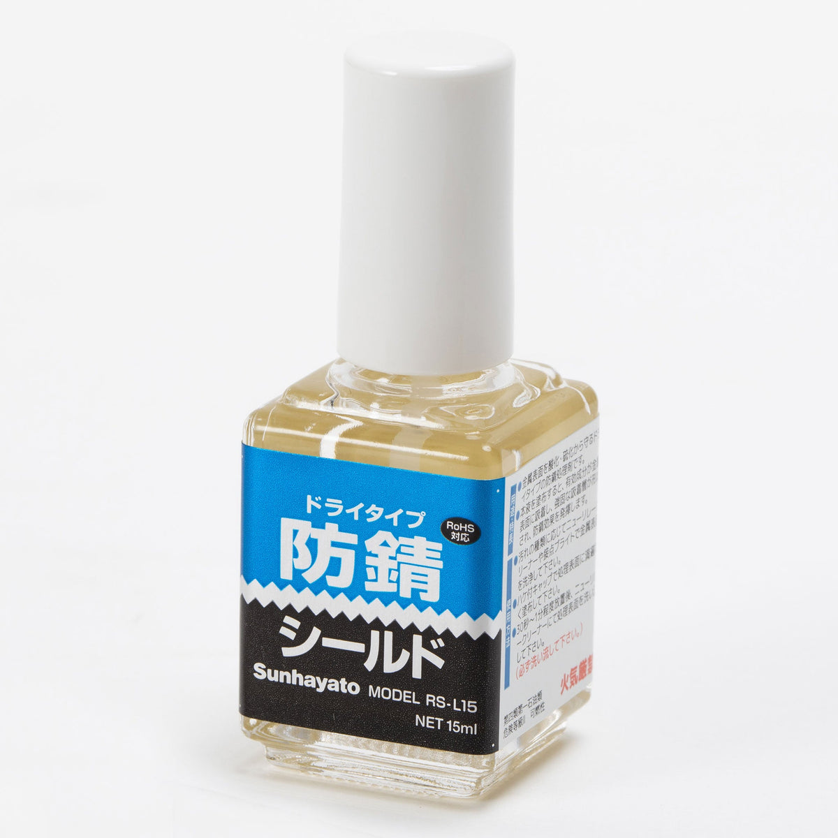

Working on restoring an SE/30 that had some light rust on the logic board. The rust spread to the metal bar that goes across the board. Part number 805-0905 -B I have managed to desolder this bracket/brace/shield from the board and scrape all the rust off. Before I reinstall this should I coat it with anything? paint it?
According to JDW in his SE reloaded video he coated it with some electrically conductive anti-rust stuff. I've tried to order it but I can't get it shipped to the US from Japan.
Any other suggestions on what to use on this to prevent rust before I reinstall it?
