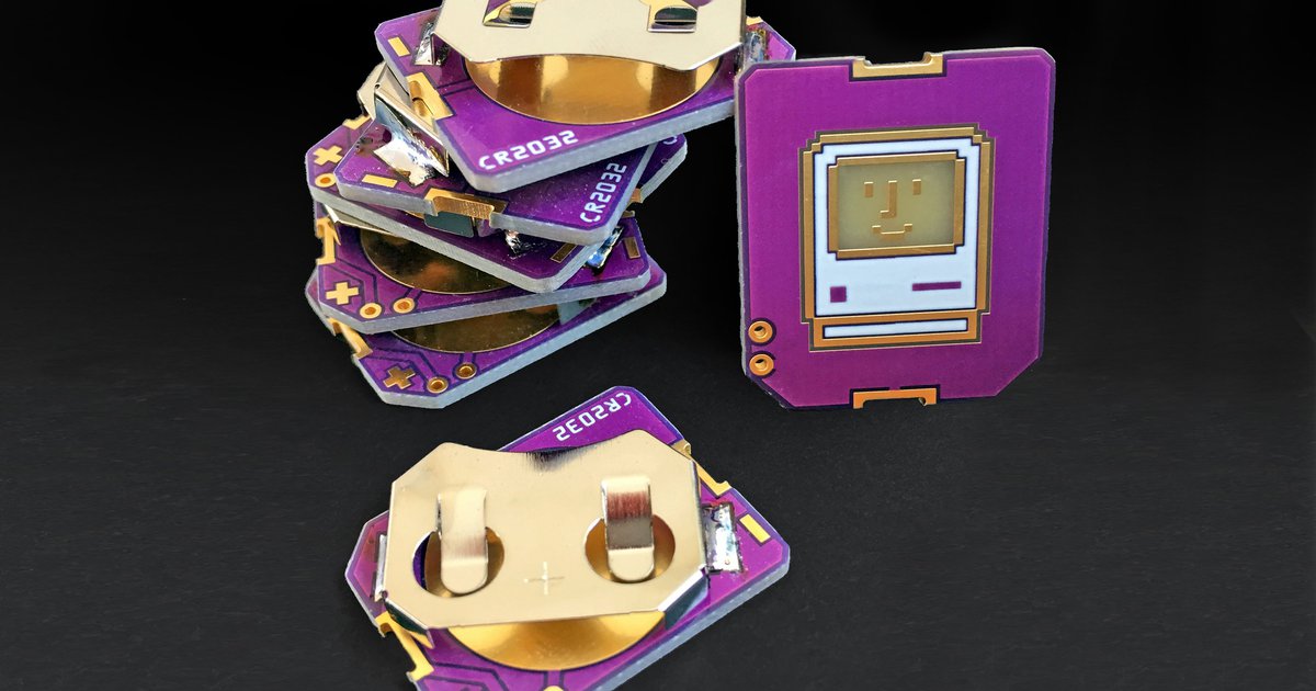

I have taken the precaution of replacing the PRAM battery with one of these:
