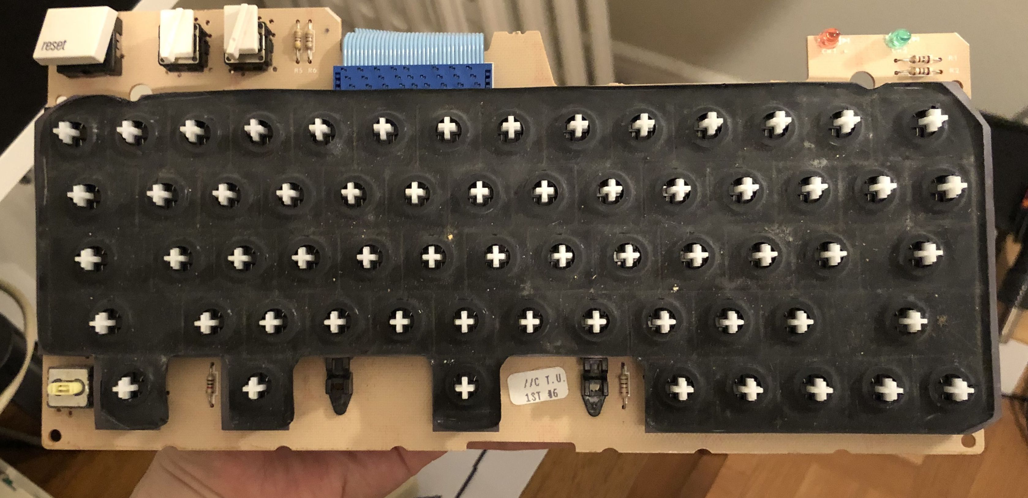

My IIc's keyboard comes with this dual layer of rubbery sheets inbetween the keycaps and switches. A lot of the 'mushy' feel of typing on the keyboard was due to this thing, and removing it made the tactile response from the switches significantly better in my opinion.
Do you all keep the spill guard in place on your machines? Do you know of any drawback from simply removing it?

Get rid of it!
There's a new world of tactility waiting for you once that cursed, degrading "spill" guard is tossed into the trash.
If that rubber mat was going to save anything they'd install one into the Alps units as well haha (but they didn't)

Confirmed: life is better once you remove the mushy spill guard. Of course, this only applies to those of us with the unfortunate Atlanta Photociruits keyboard. I believe I left the thin and more resilient black cover while removing the gray and degrading spill guard.

Thanks for the advice! This is what I assumed, but you never know what secondary purpose a component may have (such as the RF shield acting as the ground plane for SCSI/audio etc. in certain mid-90s Macs.)
I had extremely low expectations for the quality of the IIc keyboard after hearing all the rumors. Mine's supposedly the 1.D type with "USw LZQW01" switches. It's not the worst keyboard I ever typed on.
