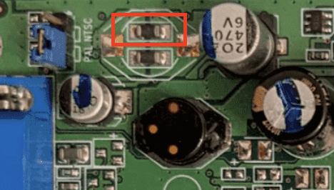

So I tried this, and it didn't work sadly.
I don't actually see how it could though, given those two links are both connected together (so removing one would not break the connection) and they appear to be ferrite beads, not resistors - they certainly have zero resistance so at the very least are jumpers.
Any thoughts on this? (Btw the machine did boot, just scrambled video as before).
EDIT: I may try removing the other link as well, just in case.
EDIT2: I haven't removed the other one yet, but looking at the non-Pro mod, those two beads/links seem intact, so I'm not sure it is a good idea..?
V.Yakob
Sep 6, 2023
95
34
Syktyvkar
Too bad, I was hoping it would work. Thank you for checking it out.
But, you can find Radeon 9200/9250 128 MB and also flash it. I've had experience with 9250 - it works. Just pay attention to the design of these boards, also not all are suitable for Resistor mode.

I still think this card is probably able to be reconfigured though, this area looks like a feature config section, similar to the others mentioned in the linked page above:
But without schematics for either (or both) types of card, I have no idea which maps to similar features.
I'm hoping someone who used to fix cards like these will stumble upon my post :D
