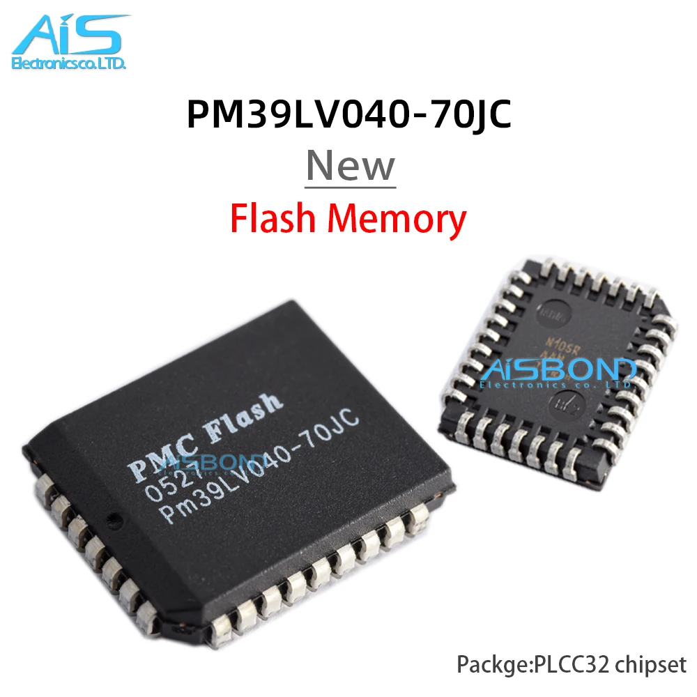

WARNING: I've been hearing from people who have ordered cards that the EEPROMs have been changed out with ones that are INCOMPATIBLE with the OS 9 flasher. You might be able to still flash these with the flashrom method, but some of these chips require 12v to program, and therefore the only option you have is using an EEPROM flasher. Sucks, but that's the way it goes, I guess. Just be aware when ordering a card that you may not be able to go this the easy way. There's still no harm in at least trying the OS 9 flasher, but just don't be surprised if it doesn't work.​
(You can also just peel off the SATA RAID sticker on the EEPROM and google what EEPROM you have and see if it can be programmed on-card and just stick it into a PC and hit it with flashrom. Components change all the time, sadly, and there's no telling what each card might be equipped with.)
This warning does not mean you need to buy a new EEPROM for the sole purpose of flashing your card to work with Macs, so long as you have a 128K EEPROM. This just affects how you go about flashing the card.

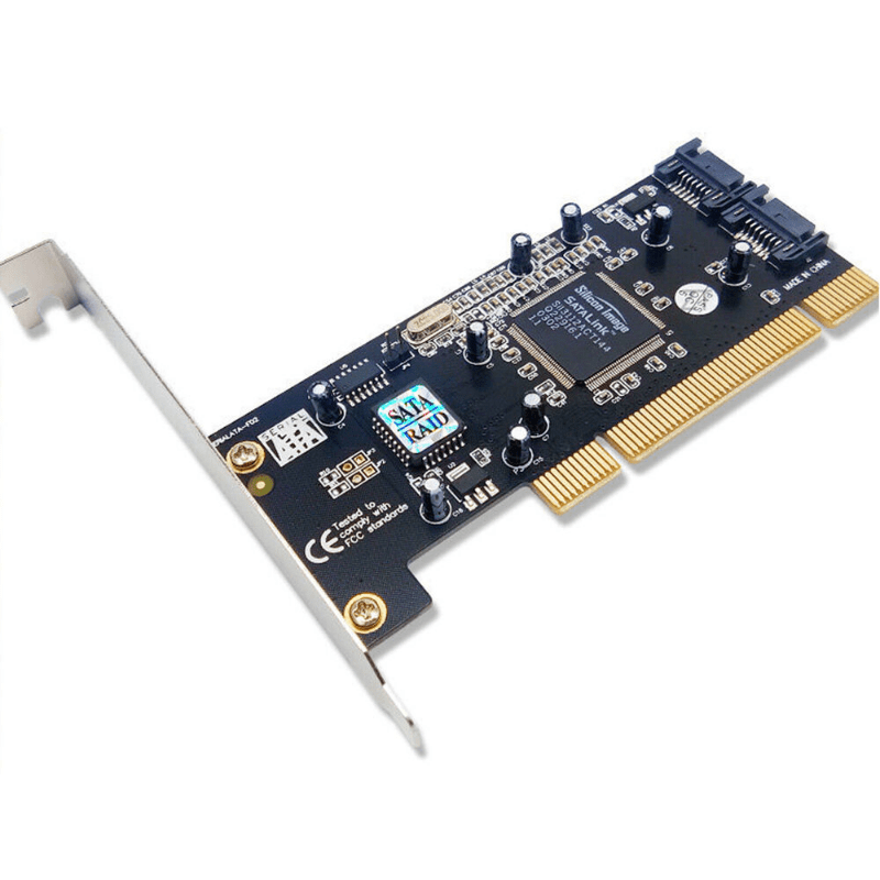

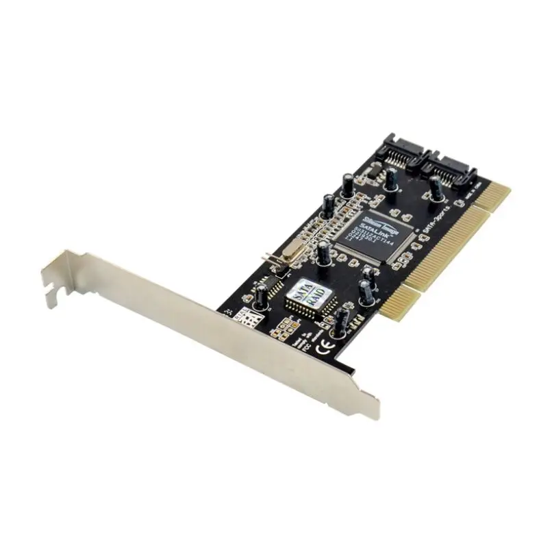

First, you're going to need an SIL3112-based SATA card. You can find this in a few different ways. Action Retro showed off this strange combo card with an SIL3112 onboard, and that worked fine. You can also just buy one off AliExpress or eBay, they come on generic boards with a cheapo ROM slapped on. These cards will do, but they can be a bit finicky as they're not exactly built to the best standards. The best luck I've had all around is getting a Startech branded SIL3112 card, but those aren't exactly the most common, either.
For AliExpress, it might be wise to gather up some members on the forum (or Discord) and do a group buy for cards. That's up to you, though.
Once you have a card in hand, though, you have multiple routes. Prior to dosdude1 busting the whole thing wide open you only really had one route, which was buying a specific chip and flashing it in a programmer, then swapping the chip with hot air. However, dosdude1 has done some incredible work and now pretty much any 128K chip should work (with some edge cases) for this. He compressed the ROM down to fit on smaller EEPROMs, and patched out the chip ID check. This means you no longer need the specific EEPROM that the original 1S2 ROM was looking for. Yay.
dosdude1 also did did some patching work on a flasher utility (that FirmTek made) to allow it to flash these cards all within OS 9. This means--so long as the EEPROM on the card wants to play ball (and--I'm assuming--isn't blank so the Mac can "see" the card) you can just flash the card without ever having to touch an EEPROM programmer or soldering equipment. Nice. It's kinda like the old way of using flashrom and a Windows PC, but a lot more user friendly.
The components used to build these cards can change at any time, but as of the last revision to this guide, I used the flasher app on a Power Mac G3 minitower to flash an AliExpress card perfectly fine. I've heard of some EEPROMs requiring a programmer to write to them, so if the flasher app fails (potentially for this reason?) you'll have to go it the hard way.

(You'll need to go this route if you opt to replace the EEPROM on the card with a blank one.)
Requirements:​
  • Some level of soldering experience
  • A hot-air rework station (I used a cheapo one for this)
  • A soldering iron (preferably a decent one)
  • A programmer (I used a TL866II+ but anything that can write a PLCC32 EEPROM and has compatibility with whatever chip you use SHOULD work)

At this point, you're done with the programmer. Hopefully. Get the chip out, it's time to stick it on the card.
Putting the chip on the card​
I prefer hot air for this, for both removing and installation. I got out my iron and wet the joints with some fresh leaded solder to lower the melting point, then set my crappy 858D clone to 360c on full speed and got to work, and after about 45 seconds or so the chip came right off the board.
After which I took my iron back out, wicked up all the solder, then fluxed and tinned the pads back up.
I put some more flux down, aligned the chip with the tinned pads, and used the hot air once again to install the chip, giving it about a solid minute at the same temp as before. This was enough to make a solid connection for me, but YMMV.
After a quick douse with some electronics cleaner and 91% IPA, I had a clean, flashed SATA card.

PSA for AliExpress cards, if you have trouble/weirdness​
If you buy one of these and it ends up either not working or working partially (in my case, the card only worked in a New World Mac, not my beige G3 or 9600), check the soldering on the card. Whoever or whatever assembles these cards does NOT do a good job, and in my case, both AliExpress cards I had suffered from cold joints, and in the case of one of them even had a pad completely missing from one of the capacitor locations. Bodged it all up and it works great now, even on the 9600.
Wick up the solder and reapply some new stuff with some flux and generally you'll be good to go. I wouldn't be surprised if some of these cards end up shipping with bum capacitors, either. But thus far, haven't heard of any.
Also, unfortunately, these cheapo cards have some...not good voltage regulation. It's enough to pass muster in something like a Power Mac 9600, G3s of varying vintage, and some G4s, but some machines really sensitive to this may not work with these cards. In my case, none of the three cards I have work in my Digital Audio G4. But my Startech-branded one works perfectly fine.
I've heard of people bodging in better voltage regulation to get the cards to work on these more sensitive systems, but I've not looked too deep into that, only known that people HAVE done it.

Generic chinese-made 2-port Sil3112 SATA RAID PCI cards typically come with a 1Mb EEPROM which you can flash with WeibeTech firmware for use with OSX. The flashing can be done on card without removing the EEPROM. The WeibeTech kit includes a flash utility that runs under OSX. But you can also extract the image and flash with other tools. Since I don’t have a PC, the most convenient means for me is to use the open-source flashrom project (https://github.com/flashrom) under Linux. It’s also supposedly ports to OSX but I haven’t tried this. I run Debian on my G3s. WeibeTech is also bootable for OSX.
The real goal though. as xodium discusses, it to flash the FirmTek SeriTek1S2 firmware. This includes open firmware and driver support for Classic MacOS as well as an OSX driver. The first snag is that this firmware is larger the 128kB (i.e. 1Mbit). So you have to replace the EEPROM. The second snag is that FirmTek only supports the three 4Mb parts lists. I first thought that this was a restriction imposed the the flasher tool, but it turns out that the driver code also checks and aborts if it doesn’t see the right rom id. At first, I tried an unsopported EEPROM and I managed to find a way to patch the OSX driver to work .. but it’s *really* painstaking and I never found a general way to do this.
So using an acceptable EPPROM is vital. All three are 3.3v parts but the card probably comes with a 5v part installed. This aspect wasn’t mentioned by xodium. Fortunately, most cards can be configured to supply either level to the EEPROM .. you simply need to adjust a shorting link (or 0-ohm resistor). See 68kmla link above.
I used a generic Chinese 2-port Sil3112 SATA PCI card from eBay. It cost about $18 including shipping and was delivered in about 3 weeks. I wound up installing a socket to futz with various EEPROMs. But that was fairly tricky since there wasn’t really enough space. I used AM29LV040B chips from Utsource.
I used my TL866II+ programmer but I avoided using Xgpro under Windows (remember: I don’t have a PC and running a VM is a pain). Turns out there’s an open-source minipro project to do the job. You can build it for current MacOSes or, even more conveniently, install it using Homebrew. Minipro doesn’t have a fancy GUI but it’s a command-line interface is more my style.
I also have a 4-port Sil3114 card. Originally, I flashed it using the SIIG-3114-R1 flasher under OSX. This provides OSX support and is bootable .. but like WeibeTech, there’s no classic MacOS support. So, I stuck a socket and a 4Mb EEPROM on that too. FirmTek have 4-port firmware but I’ve not had any success with this firmware and card.
Finally, note that *BSD and Linux systems support these satalink cards without special EEPROM requirements. I run NetBSD 9 and Debian 8 on PPC Macs.

Just did this mod and worked great! The Three issues I ran into were - I lifted a pad when I removed the chip, dont put any pressure on the chip when heating, just let it start to flow then pick it up. Second was the sockets melt before the solder - so if you dont have a heat plate dont bother. Last was you can not boot off a 2tb volume, it just restarts after the happy mac (just make a smaller partition and boot off that)
Exact items I purchased
SATA Card ($6.88)
Flash Chips ($4.00)
So for under $15 shipped (if you can solder and have a programmer already) you have a really great solution to replace the drives of any PCI based Macintosh with an extremely fast & modern solution
Edit:
Ran a speed test in FWB on my Desktop Beige G3:
SATA: 44MB/Sec read, 46MB/Sec write.
Stock IDE: 8MB/sec read, 7MB/sec write.
A 5.5x speed up in read, 6.5x speed up in write.

I ended up grabbing a card off of eBay and I bought a MX29LV040CQI-70G from Digikey. So far, the system is booting just fine in OS 9.1 and OS 9.2. However, the OS 10.0 and OS 10.1 install disks don't see the solid-state drive and the OS 10.2 install disk gives me a kernel panic. The system also wouldn't work with my Radeon 7000 installed (OS 9.2 gave me an "error type 11" on boot). I will say this G3 has a tendency to be temperamental on a good day, so some of this could just be related to this computer. I will continue to fiddle with it over the weekend.
Oh, and a big thank you goes to speakers for pointing out the 5V EEPROM variants. The card I bought off of eBay also had a 5V EEPROM. I relocated the 0 Ohm resistor on the card from R25 to R24 which did the job nicely.

Due to the generosity of one Garth Beagle I actually received another one of these cards to mess with. Actually, two. Because he couldn't get his original one to work. And sadly, I think we got a bad batch. Programmed the chips fine and at first one of them came up in OS 9 just fine, but it would randomly drop off the drive connected to it. The other one just wouldn't come up at all. Garth noticed some dodgy soldering work on the cards themselves, wondering if they just weren't well assembled.
I know Joe's Computer Museum and Eric Helgeson have both bought cards (from the same seller, if I recall) and have had great success, so I guess it's really luck of the draw. If you're buying these from AliExpress and can afford it, buy multiple because there's nonzero chance you'll end up with a dud.
Or find the name brand ones stateside. Startech sold an SIL3112-based card and that's the one I originally used and had success with.
Or maybe as LastCarbon said, my G3 is being a fickle beast, as that's the test system I'm using. (Trying not to mess much with the 9600, as it's going to be the star of my VCF West exhibit and I really don't want it breaking down...)
Also, experimenting a bit, someone elsewhere mentioned that the SIL3114 is just a SIL3112 with 4 ports, so I decided to see what would happen if I soldered one of the 3112 EEPROMs to the card with the SeriTek firmware. Ended about as well as you can expect. (Nope, no workie. I want to try this with an SIL3512 next, though, but I am loath to mess with that card as it's ticking along just fine in my MDD...)
