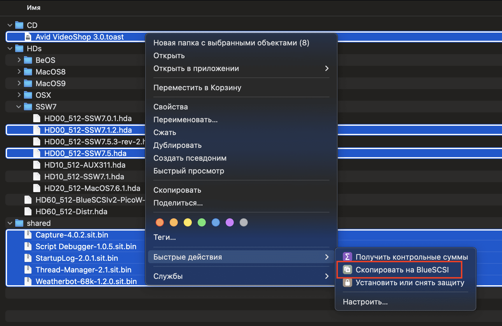

Select the necessary files and call the command through the context menu.
Before copying, if you need to create bluescsi.ini and directories, then copy.
It seems to me that since I started using this script, I no longer encountered the problem of fragmented files.
