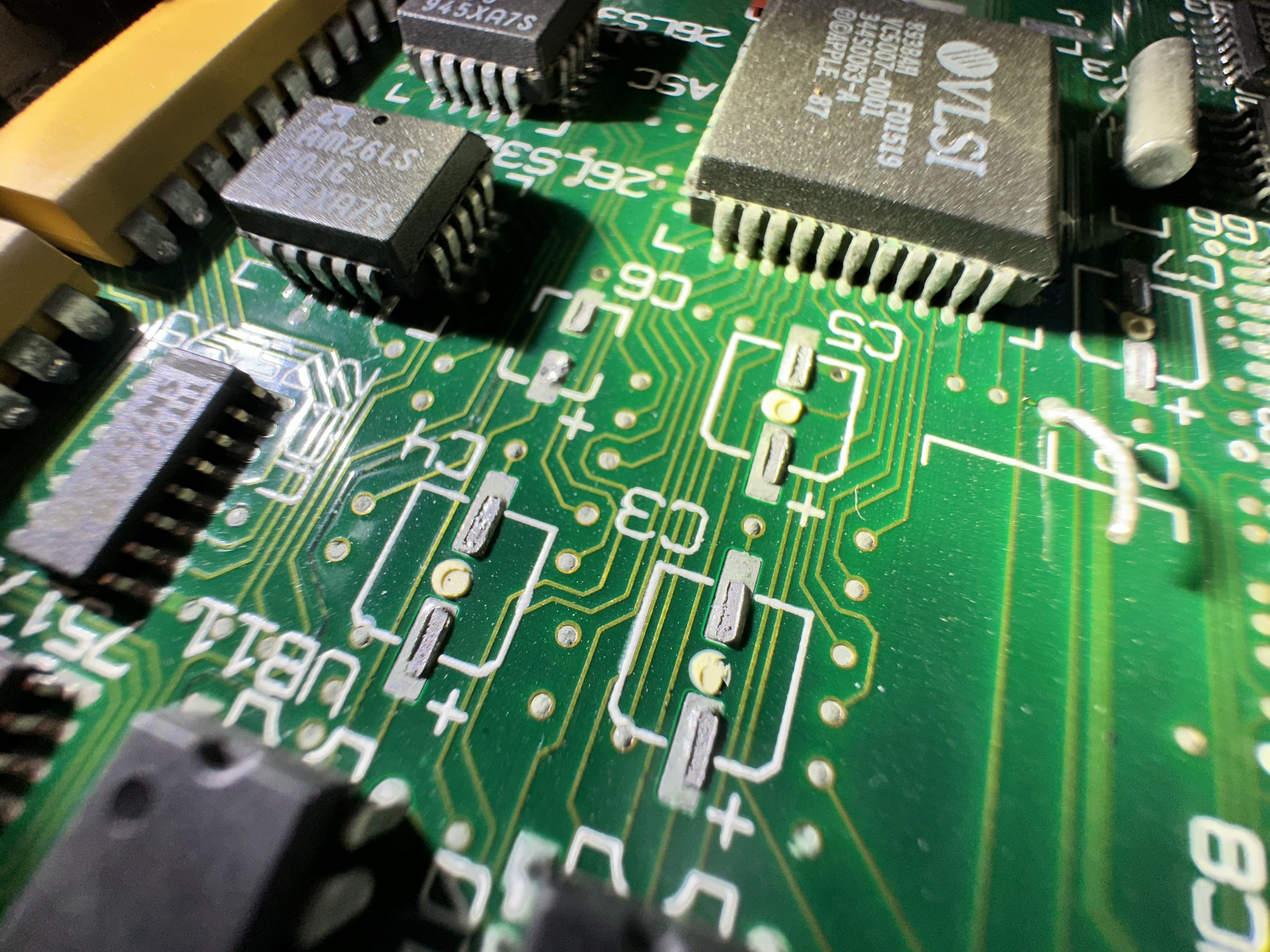

Hi
My first recap and I have a question on pads. I desoldered the old capacitors using a hot air station. The result of one area is shown below. My question is what are the smaller raised rectangles inside the larger pad? Remnants of the capacitor? Or is that a part of the pad itself? Thank you!

I wouldn't recommend using hot air station to remove those caps. The type with yellow plastic wrapped on them will explode when exposed to heat, when they don't violently explode the rubber seal would expand out and make a mess. The other type with ratings printed on top is usually more resistant to heat but still I had a few exploded on me. Now I use pliers to twist them off then clean the pads with iron as suggested above.
Btw it seems the pads aren't heated enough and solder haven't melted yet when you pulled the cap off, therefore you can see those rectangle marks
That’s what i thought. I did it outside since i don’t have proper ventilation. It took some time for them to come off.
