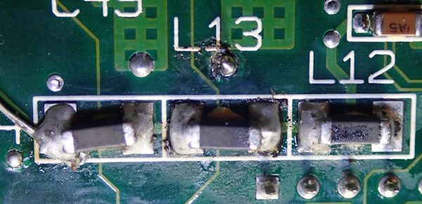

I measured the oscillator (Y2) and noticed it was only active when I pressed down. I replaced Y2 without improvement. I carefully measured everything going into Y2, and discovered power (5V) disconnected and reconnected when I pressed down, but power at the main motherboard connector stayed solid. Ah ha! A cracked trace or component leading to Y2.
By measuring the continuity each step of the way until Y2, I found inductor L13 was cracked at one end. I replaced it from a battery bombed SE/30.

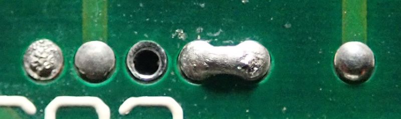

Carefully measuring them revealed address lines A12 and A5 were combined. Nothing is going to work with bad address lines. Consulting the Bomarc schematic, I found that A12 and A5 are used on video chip UB8. That's one of the areas I reflowed lazily.
Turning the board upside down revealed a solder bridge. Solder flowed out the bottom of a hole and bridged to the next hole. Oops.
Removing the blob with desoldering braid resulted in a happy Mac chime!

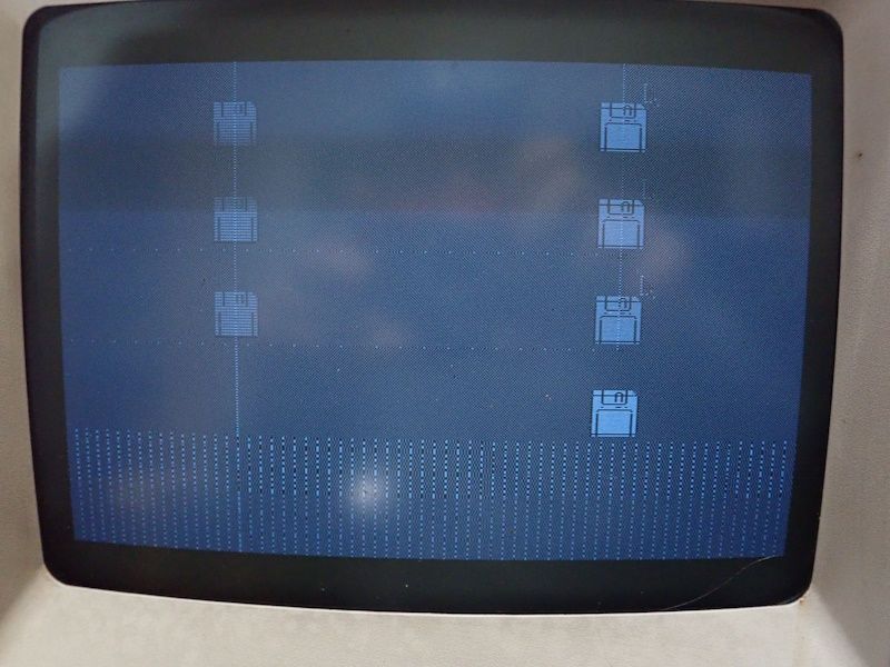

3. Double vision. Multiple images.
What the what?
Multiple copies of the startup icon and mouse cursor appear on the screen. Lots of flicker. However, the horizontal and vertical size and placement of the screen is good. And, the images aren't stretched or condensed.
Fortunately, a post on the other forum by @KhanTyranitar and @Bolle provided a really strong clue.
Pins 2 and 14 are shared for UA8, UB8, UC8, and UD8. On my motherboard, there was an imperceptible break in the trace for pin 2 of UB8.
Adding a small wire to connect the trace fixed the multiple image problem.

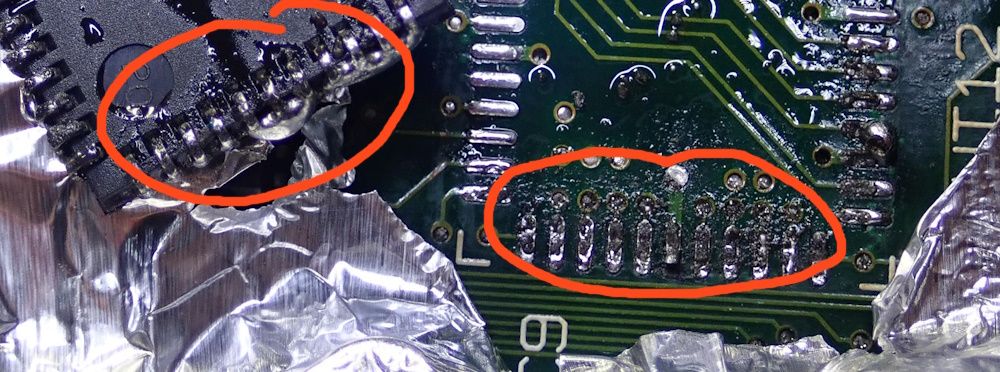

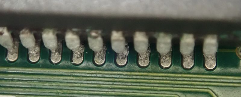

Well, this is obvious. UI12 (the SCSI chip) is near leaky capacitors C8, C9, and C10.
Learning from my earlier mistake, I decided to completely remove the SCSI chip with a hot air gun, to make sure everything was fully cleaned. Boy! I'm sure glad I did. It was gross.
After cleaning and reinstalling the SCSI chip, the SE/30 happily booted from the SCSI drive. It ran and passed all of the Mac Test Pro tests.

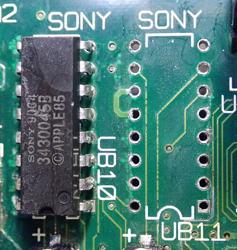

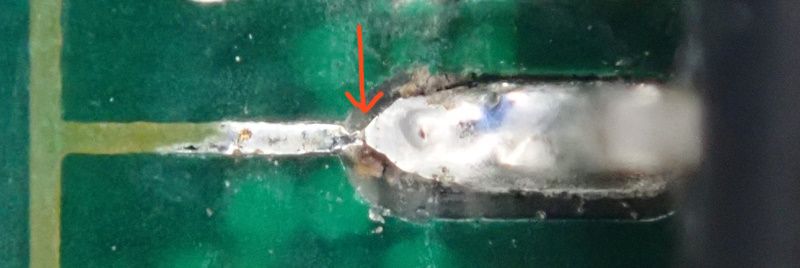

Using the Simasima guide, I measured both reset pins (pin 5 on UB10 and pin 5 on UB11) on the Sony chips. They are distinctly separate. UB10 responded almost immediately after power up, but UB11 did not. Finally, UB11 changed state and that's when the Mac chimes.

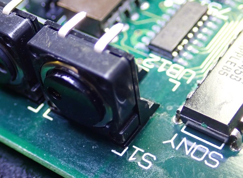

During this diagnosis, I noticed pressing the reset button (S1) wasn't doing anything. Measuring the resistance of S1 indicated a steady 300ish ohms whether it was pressed or not. Clearly the reset button is damaged. As it was desoldered, a lead just fell off due to corrosion. I replaced it with a new old stock button.
6. Still long time to chime
Replacing the bad reset button did not fix the delay until hearing the startup chime. I check all the traces and nearby capacitors for continuity. Finally, I figured if the reset button was internally corroded, perhaps UB11 was as well. I desoldered it, cleaned and checked underneath, added a DIP socket, and swapped in UB11 from a battery-bombed board.
With that, this SE/30 board is fully functioning.

Is it safe to say that the coming out of reset delay was caused by the sound chip? I'd be interested in whether it causes the same symptoms on a completely different board. Probably worth keeping the IC regardless, as they're hard to come by.
David Cook
Jul 20, 2023
130
172
Yes. I socketed the original board. Based on your question, I swapped the original chip back in, and the delay reappears. So, the Sony chip is definitely damaged. The pins are clean. So, it isn't corrosion causing some resistance which might act like an RC delay.
