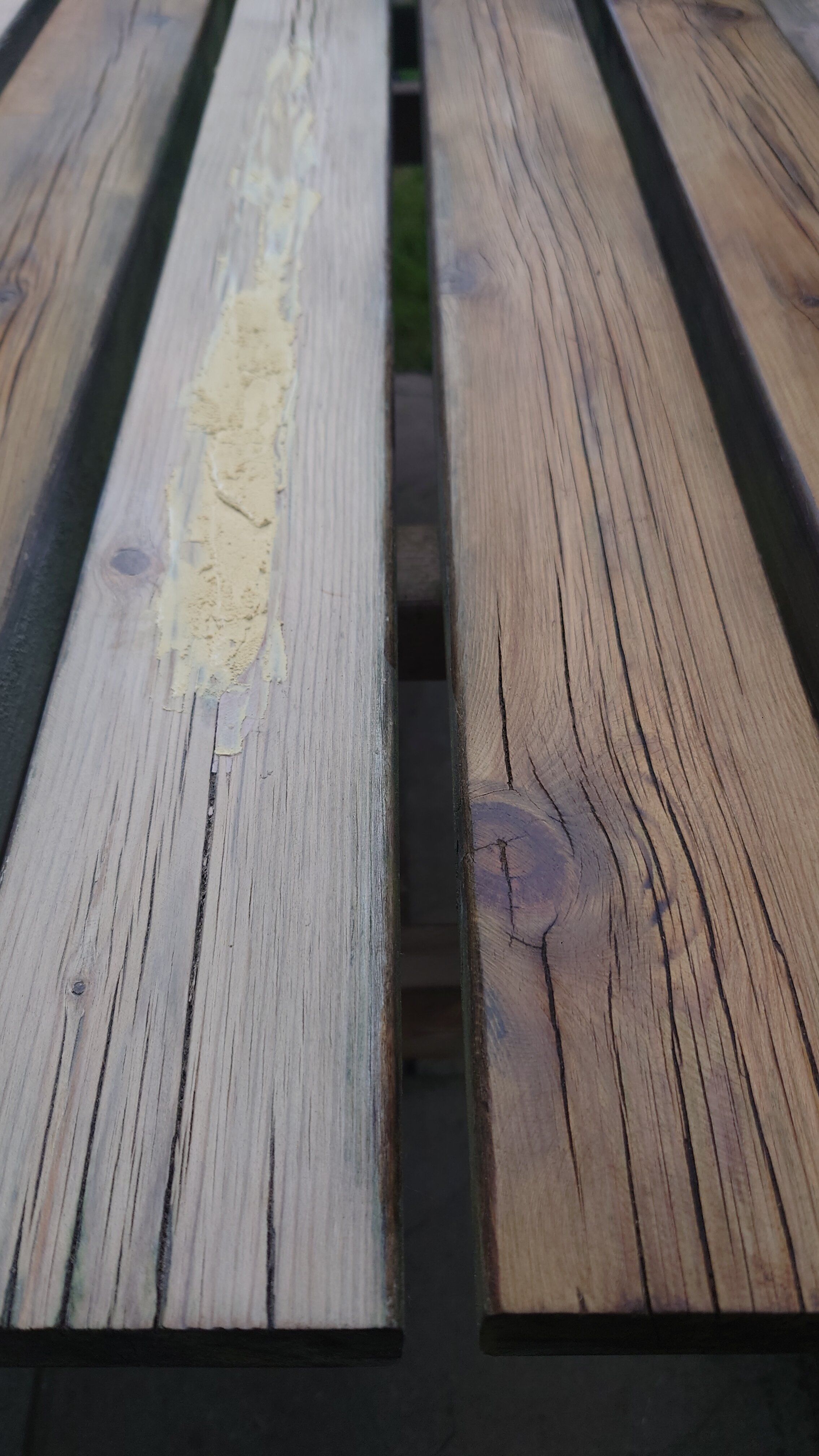

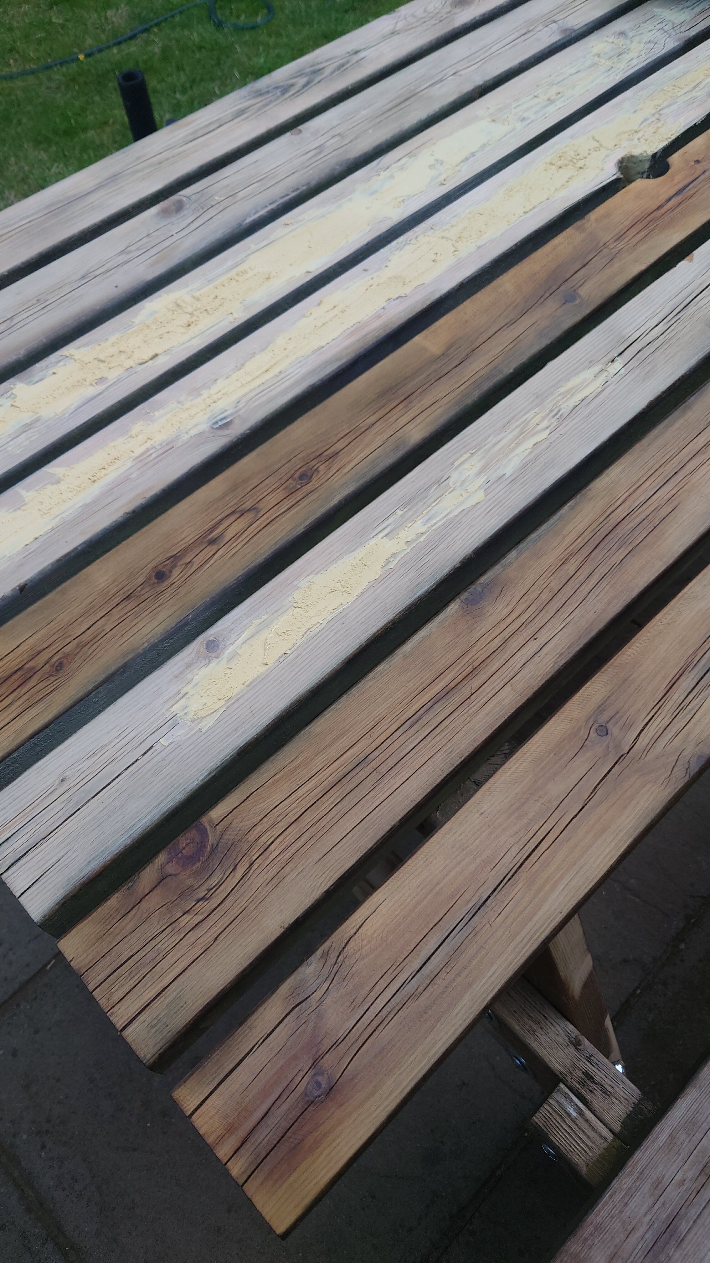

Unfortunately I didn't take photo of the table beforehand, and only took these towards the end of the work - you can see here the table after the wood filler (Ronseal High Performance wood filler) had been applied but not yet sanded. I started on the un-fillered planks with BriWax as a test, and liked the end result...a lot!
View attachment 17445 View attachment 17446

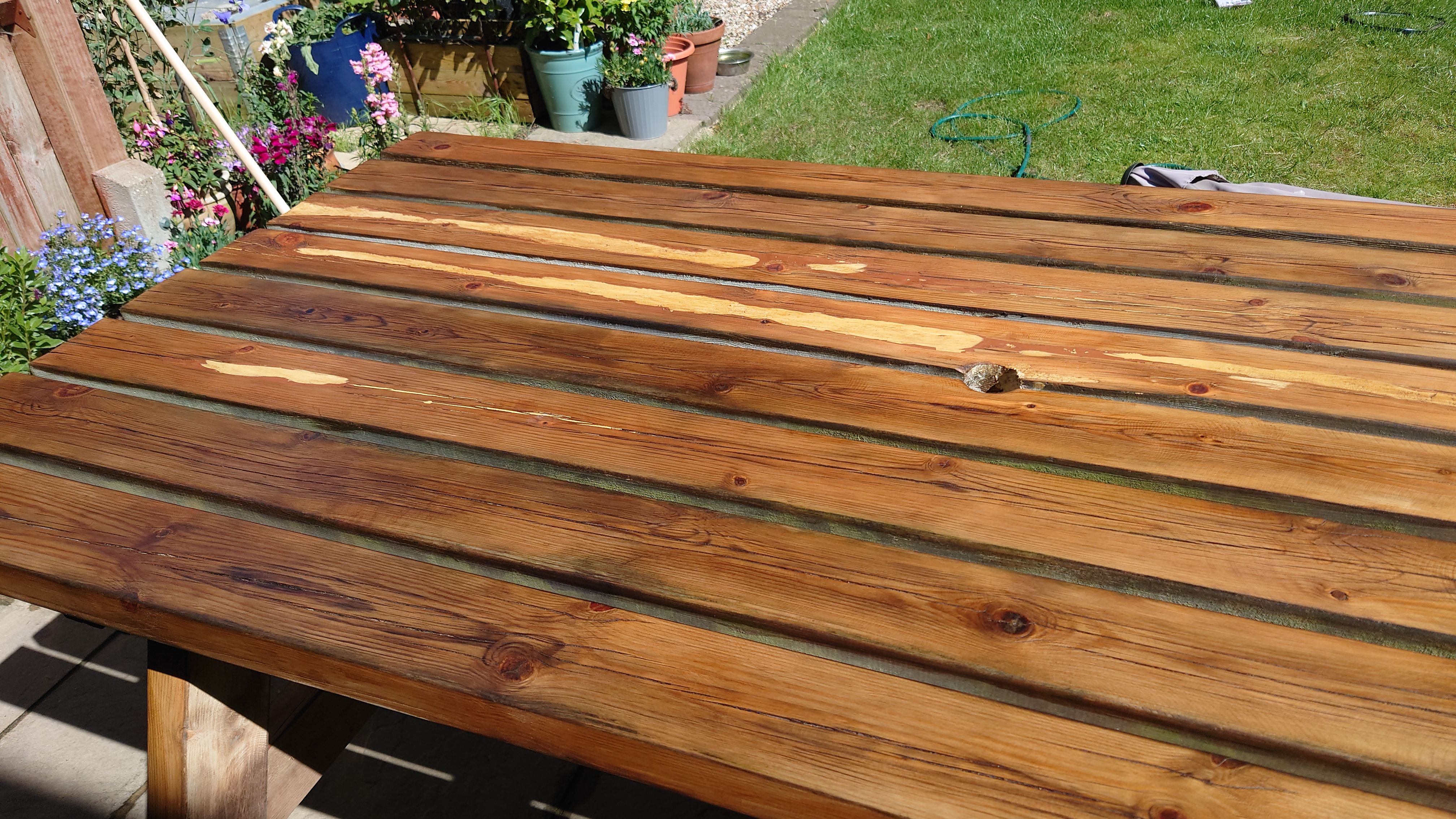

I then sanded down the filler with a 40-grit sanding disc on an angle grinder, there were a few small dips but overall ended up about as level as could hope for. Luckily it was a nice sunny day (a rarity in the UK right now) so the wife and I spent an hour waxing the table with more BriWax and steel wool. This is how the table looked after it's first two coats and a buff with a microfibre cloth.

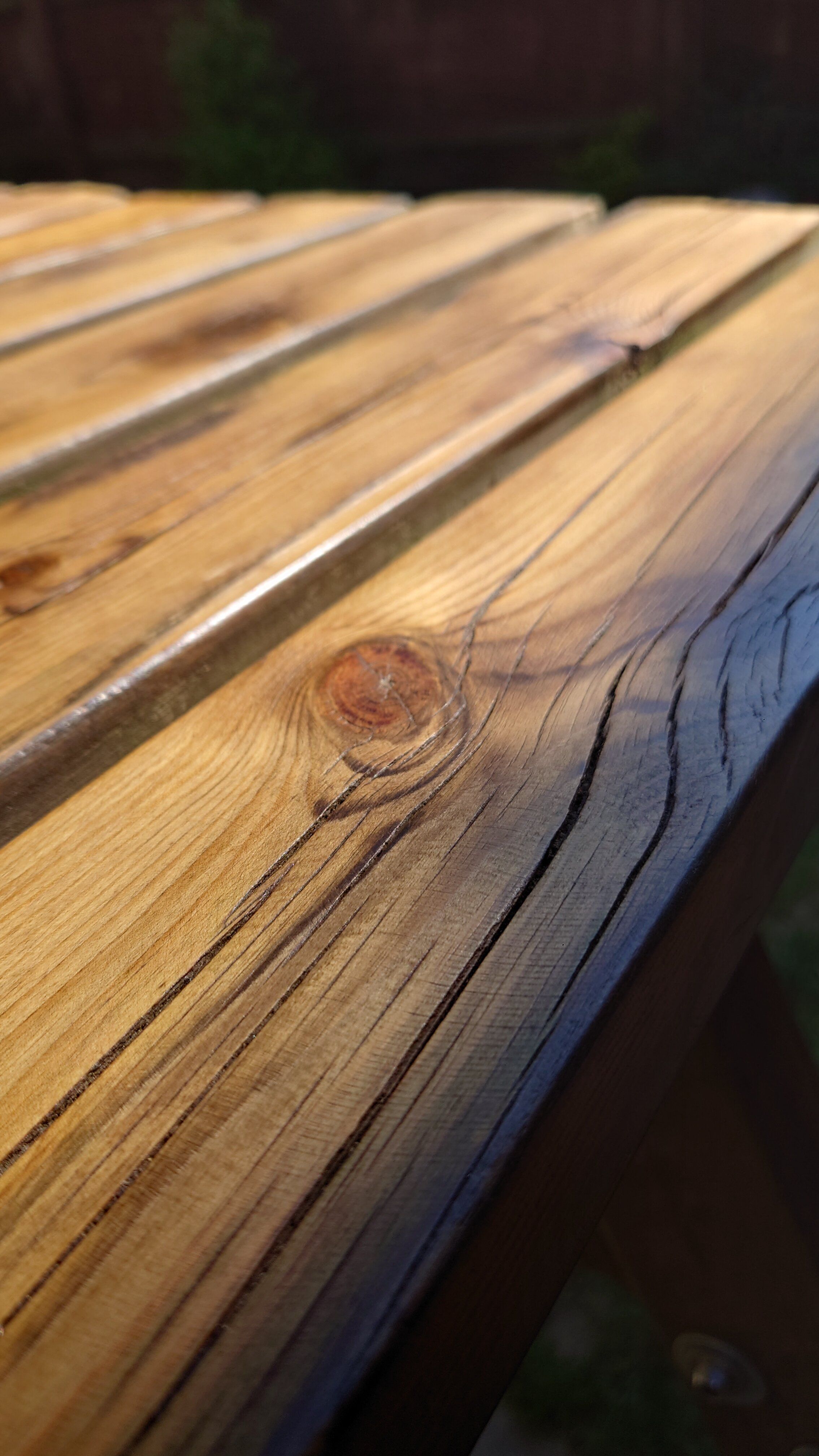

After a third coat of BriWax, this is what the wood looks like up close....PHWOAR LOOK AT THAT KNOT!
Even though BriWax is not an exterior wax, more meant for furniture - its done a tremendous job on the table and now it is, to a certain extent, water repellent - it just glides across the surface and wipes off. The following weekend we went a little further and ended up sanding down and waxing the bench seats for it as well just because it looks so good.
