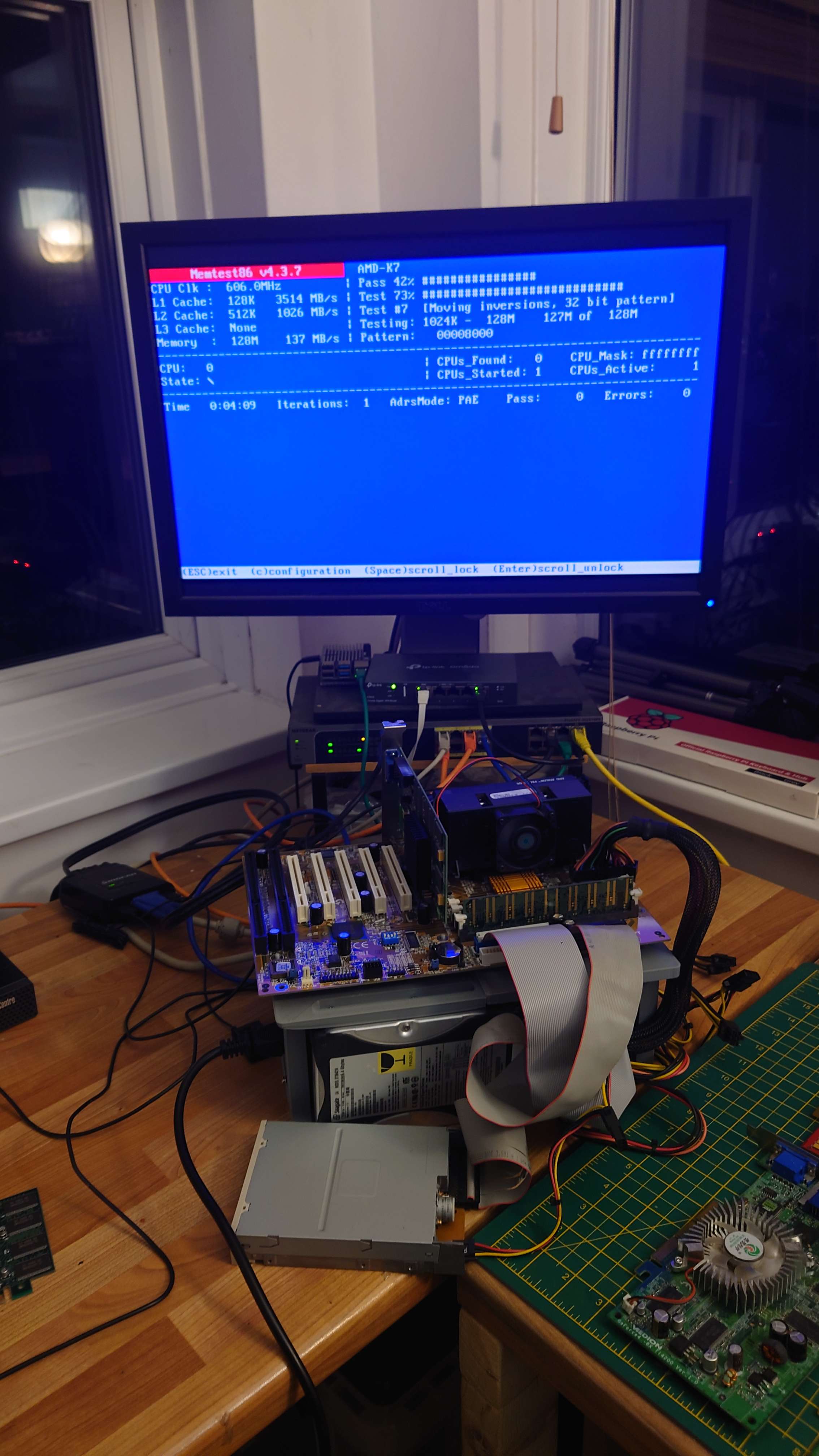

I had enough SDRAM in a box to give it plenty (2x128MB PC100 sticks), already had an AWE64 sound card and PCI Network card, @mitchkramez sent me a 32MB Diamond Viper V770 nVidia Riva TNT2 (period correct!) and after 3D-Printing an ATX Testbench to set it up, i found a 6.4GB Seagate IDE drive and a floppy drive and connected it all together.
Made a Windows 98 boot floppy and made a Memtest86 v4 floppy and...
It works! Literally first time boot up, it worked! As you can see, I used Memtest86 for a few passes to see if it was stable and it was. As this board was new in the box, it's never been powered on and the capacitors are in minty fresh condition.

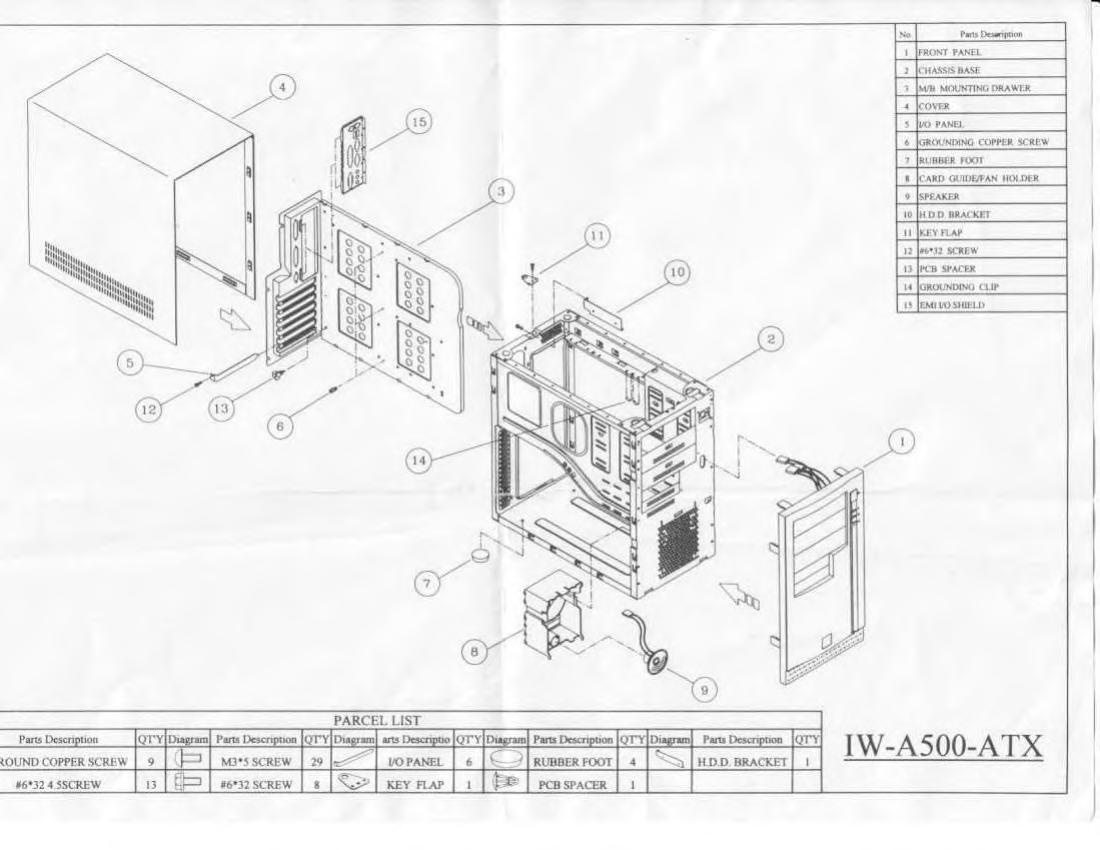

Ah crap! I've got a Hitachi GD-2500 DVD drive on order for £7 from eBay which should allow me to install Windows 2000 from scratch, then it's a case of shoving it all back in the InWin A500 case that @Stinkerton18 rescued for me from an eWaste auction...
