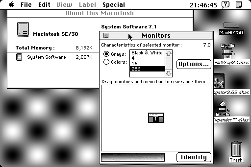

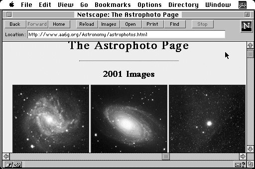

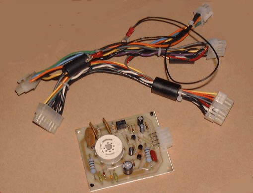

I wonder if a mod on the video neck board allows greyscale on the SE/30? 🤓 For example, I found this on a mirror of one of Gamba's web pages:
SE/30 GrayScale Adapter
I realize that Bolle did make a clone of the Micron and the video neck board. Yet, is a complicated video card needed?
