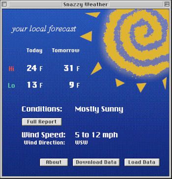

Hey what's up, I uploaded a proof of concept type of version of my new Classic Mac OS app SNAZZY WEATHER to my website. Just gets super basic weather info from today and tomorrow and displays it with a background I felt was befitting the graphic design sensibilities of the before-times. Take a look, and if you try it out let me know if it actually runs on anyone else's system!
Made with the venerable REALbasic on my dear PowerBook Pismo.
Download, source code and more info on my website: here

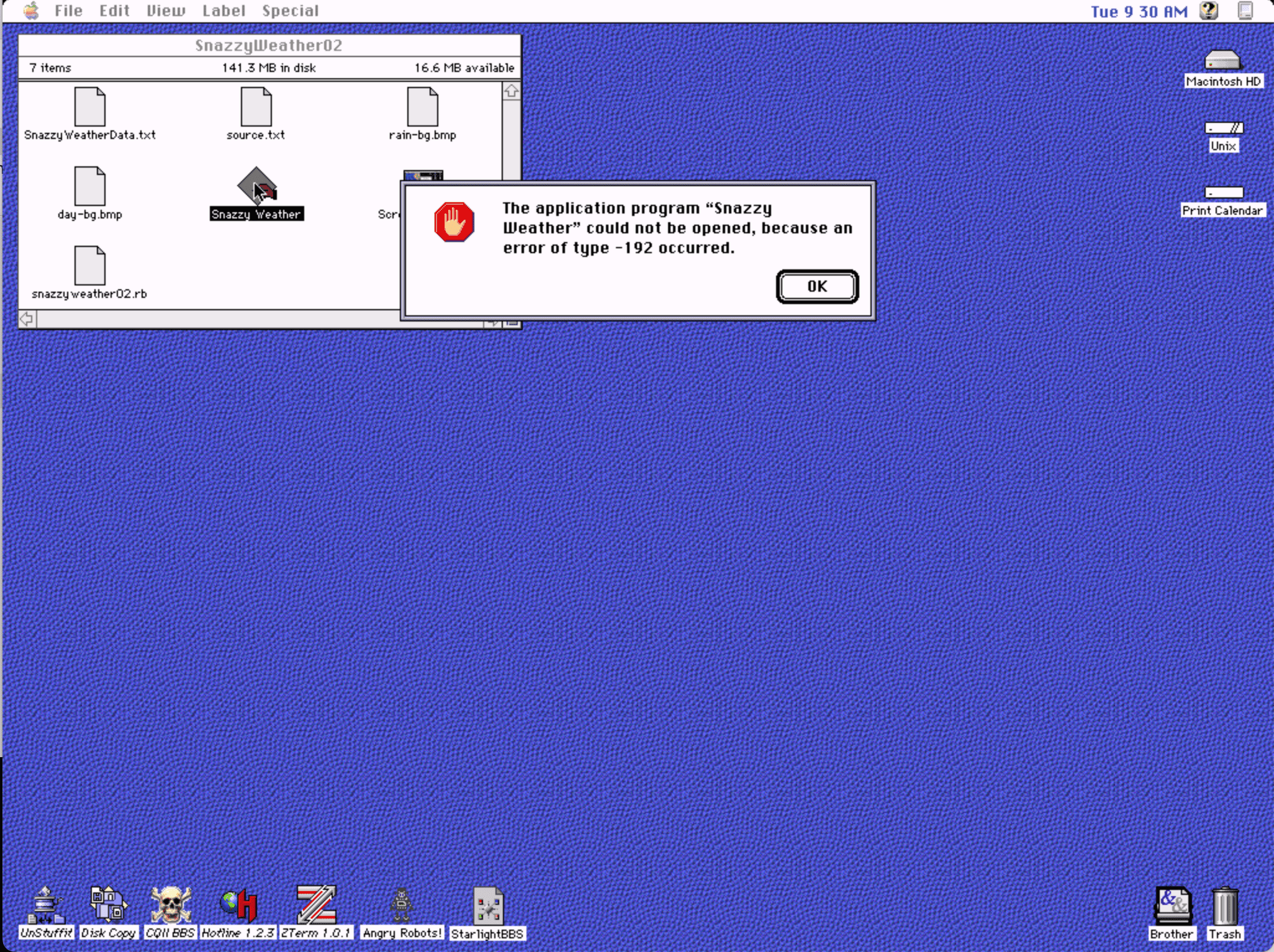

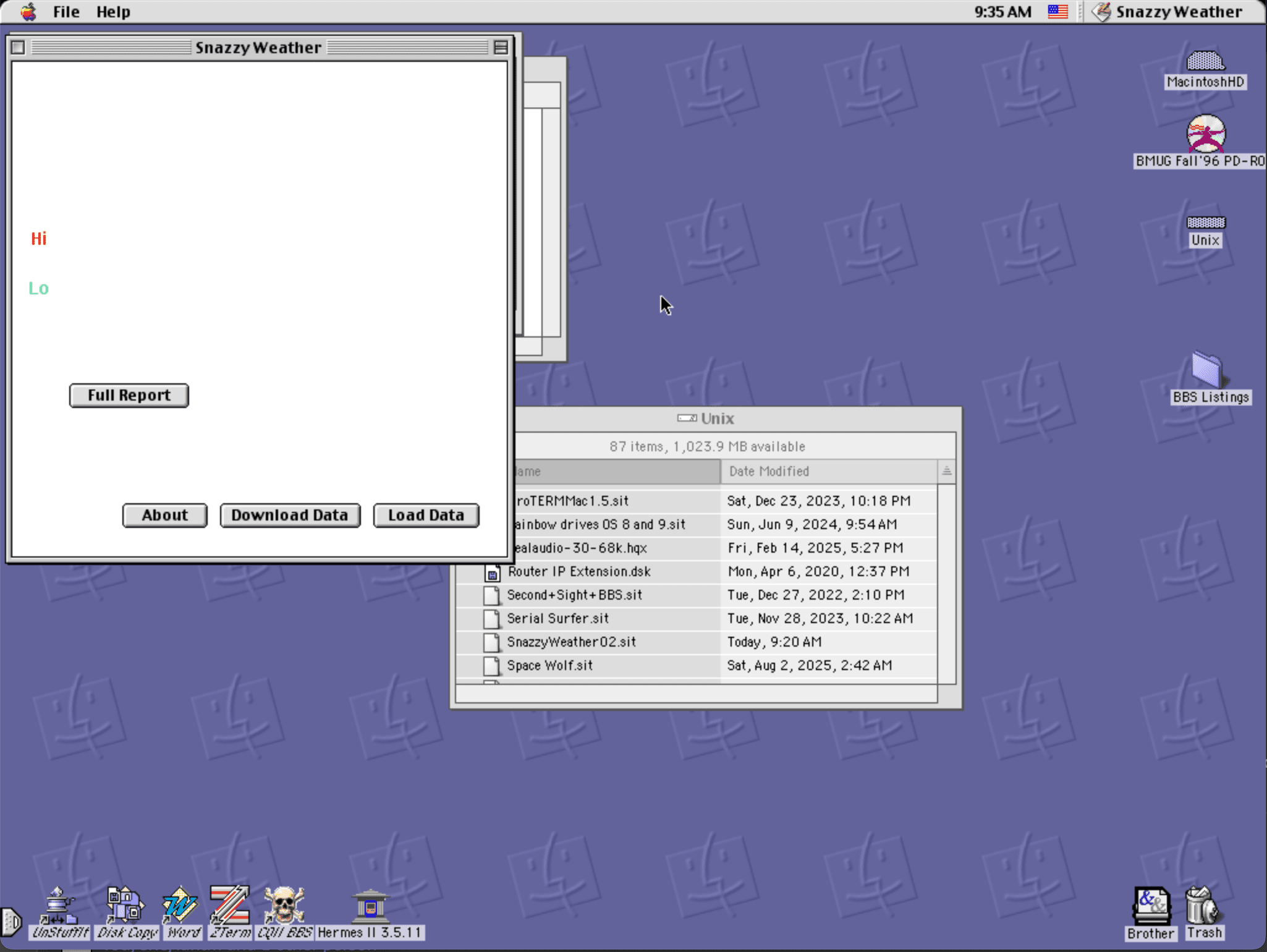

It crashes on launch in OS 7.5.5 with the Basilisk II emulator and doesn't display properly in OS 9.2.2 with SheepShaver.
Screenshot 2026-01-27 at 9.30.32 AM.png Screenshot 2026-01-27 at 9.35.09 AM.png

@jojo2k nice work! REALBasic is a lot of fun.
What version of REALBasic did you compile the app in? 68k machines/emulators can only run apps built on REALBasic versions up to 3.5.2. REALBasic versions above 3.5.2 can still build apps compatible with System 7 etc. but they only support the newer PPC CPUs.
I have to compile separate 68k (RB3.5.2) and PPC (RB5.5.2) builds to support both CPU types on my apps.
Regarding the no display in OS9, it could be something to do with the canvas and control ordering. REALBasic can do some weird things with ordering and sometimes hides/shows things you're not expecting it to do. Check the control order of each item, and make sure the canvas/background is 0/1 and everything else is above that.
